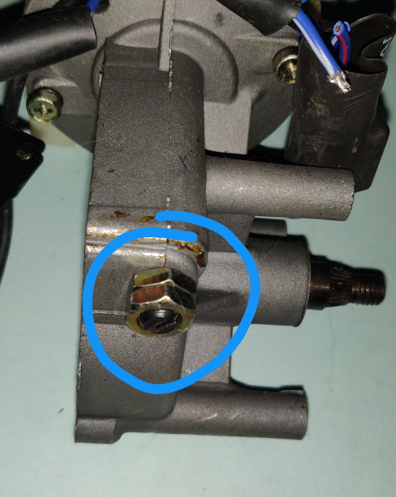

    I have checked my rig, 1 motor has play on the lever or shaft. There is setscrew that I can play with to eliminate the play but it still has it. How do I adjust more if the setscrew touch to tip of the worm gear?
    21,511
    150,686Coins
    +11,018 / 55 / -2
    All wormgears have some play, for lubrication purpose: https://www.xsimulator.net/community/faq/wormdrive-backlash.293/
    What set screw do you mean and why do you think it can reduce wormgear play, can you please post a picture?
  7. deeph46
    deeph46 Member
    Mar 17, 2023
    109
    612Coins
    +15 / 0 / -0
    2DOF, 3DOF
    This setscrew...
  8. Kevinski
    Kevinski If it doesn't fit, hit it until it does.
    Feb 17, 2023
    189
    Jack of many trades, mastering some.
    Australia
    363Coins
    +121 / 0 / -0
    There are worm drive motors (specifically related to sim builds) that have zero lash. So if you choose the right worm drive motor you won’t have the end play issue. I would consider a full metal worm and gear for this application with a slight trade off in the gear box being slightly noisier than plastic gears.

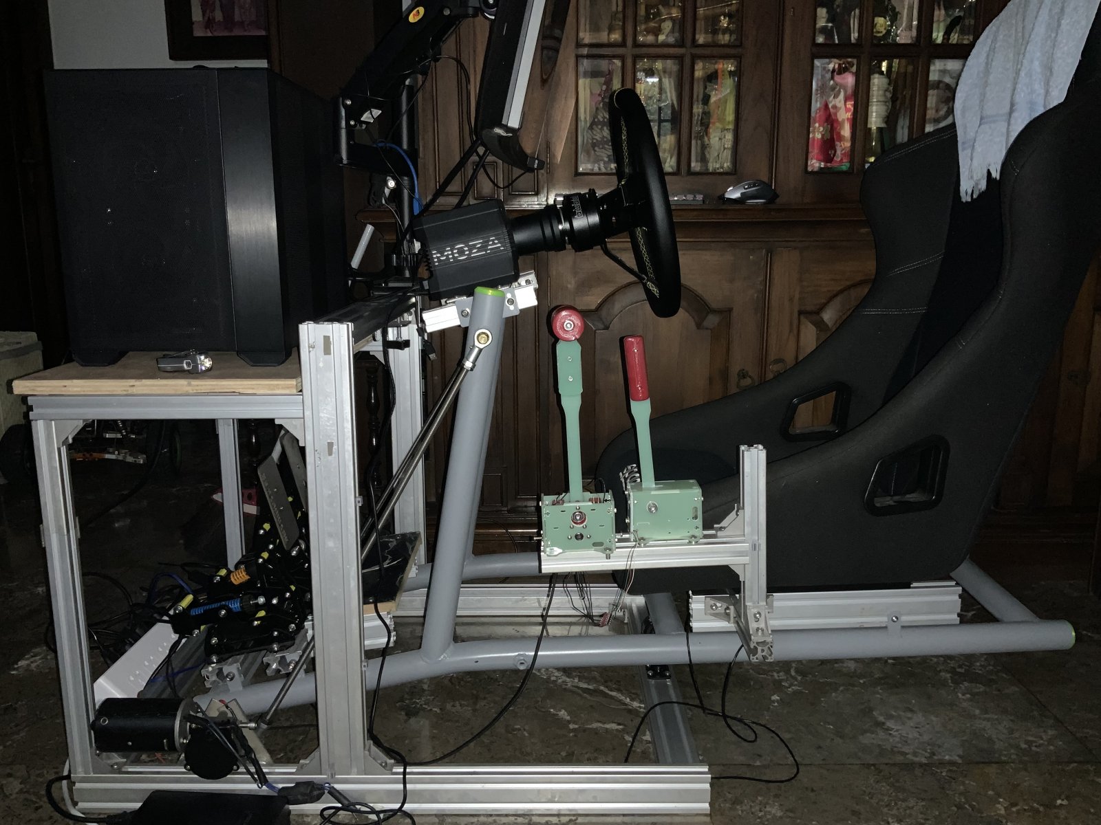

  15. deeph46
    deeph46 Member
    Mar 17, 2023
    109
    612Coins
    +15 / 0 / -0
    2DOF, 3DOF
    Here is the picture...wiring still like a noodles though lol
  16. Kevinski
    Feb 17, 2023
    189
    Australia
    363Coins
    +121 / 0 / -0
    @deeph46 Nice mate. Looks nice and compact. Some nice peripherals you have going on there as well. I'm waiting on a Fanatec csl DD 8Nm wheel base, Club sport wheel rim with a universal hub, some Club sport V3 pedals and a club sport 1.5 shifter. Decided it was a bit silly having a kick ass motion rig with a G27 wheel and pedals. How's it all working for you? Are the motors moving you around ok? It looks like a pretty small uni joint you are using there. Bit hard to see in the pic.
  17. deeph46
    deeph46 Member
    Mar 17, 2023
    109
    612Coins
    +15 / 0 / -0
    2DOF, 3DOF
    Yes, want to make it as small as I can. I actually can make more smaller footprint by cutting the pipe behind the seat. And it cost me around $200 (just the motion parts) for my motion rig. Using 3/4" pipe and 3060 aluminum profile. I want to add 3rd axis for heave in the future, for a while I really love how 2DOF performed.
    You also get great peripherals though. I was using G27, Thrustmaster T300 and Moza R9 for the DD. R9 doing great for me, lots of torque with 9Nm. It can break my fingers lol..
    Motors are also doing great right now, noticed some plays but minimal. Still using my previous motors with plastic (Nylon?) gear.
    Yep, the uni joint is pretty small but it handle pretty well. It was joint from steering post I believe.
