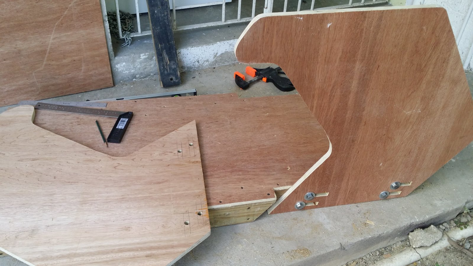

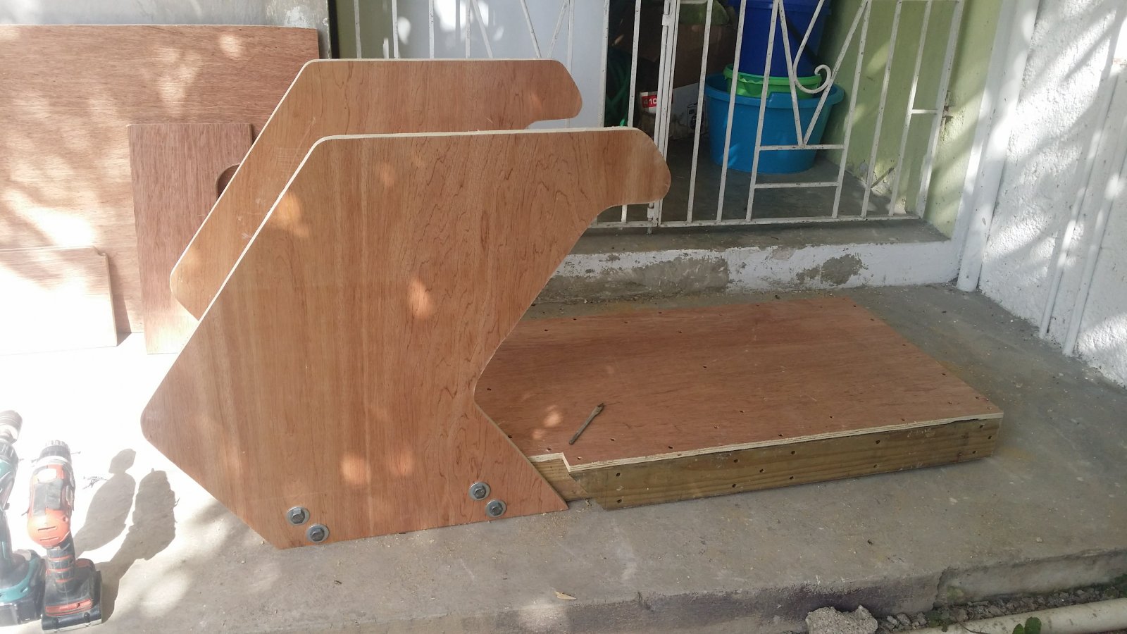

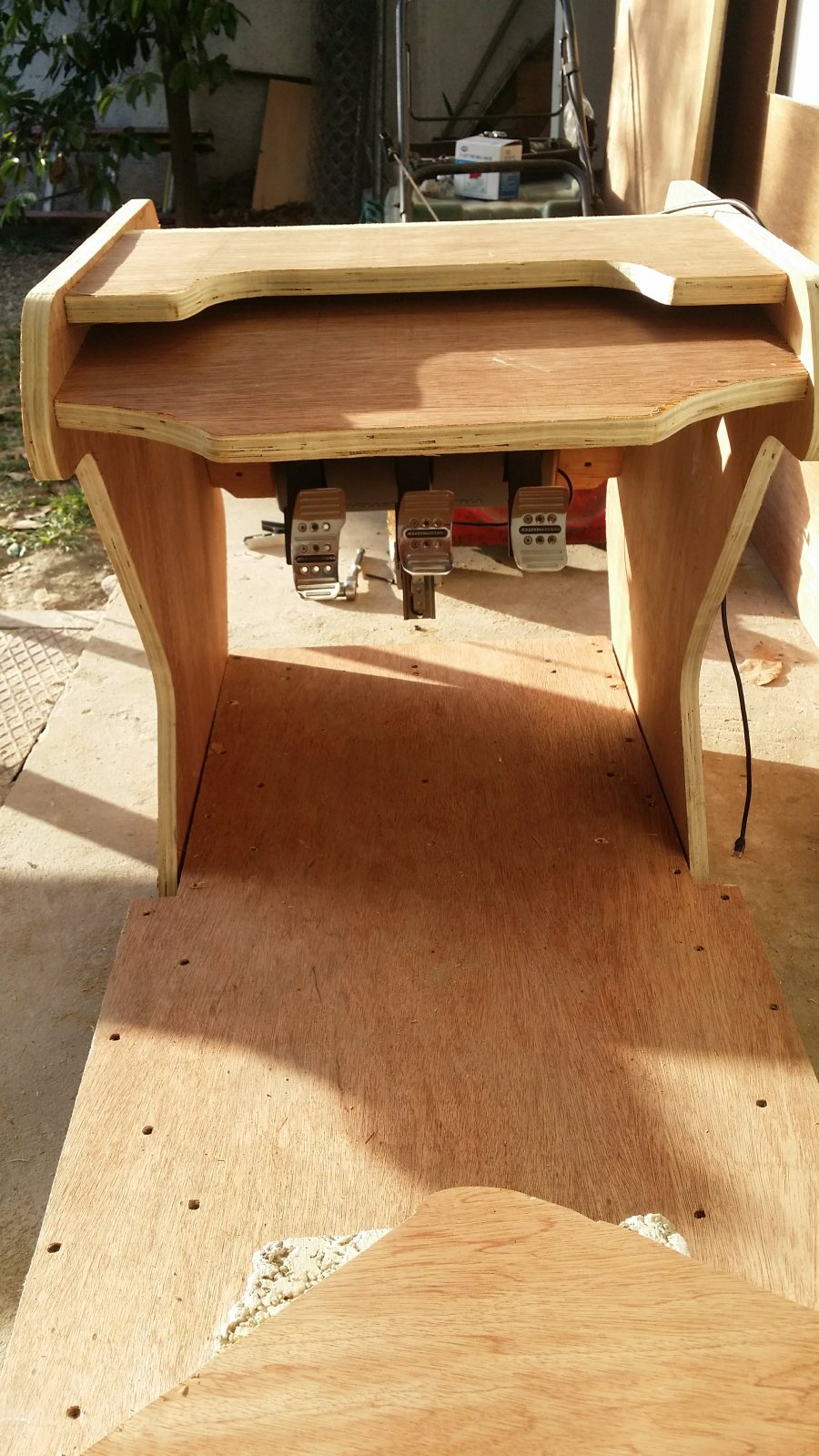

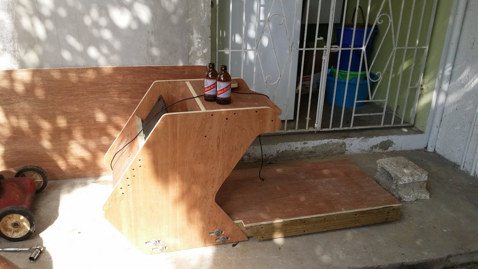

    Hello all, I have been sim racing for quite some time now. Probably around 15 years or more. I started out with some cheap off the shelf no name wheel and currently have a Thrustmaster t300 alcantara edition with bodin solutions load cell brake mod and th8a shifter mounted on a playseat revolution with transducers and sim commander. I am ready to take the next step to motion, I have been searching around the internet for a few years now and been looking through forums on this website for about a year and this website has given me the confidence to finally attempt this. I have a Ricmotech RS1 cockpit that I will be converting to a seat mover and will later add traction loss.
    Here is my progress so far.
    20180310_152041.jpg 20180311_105953.jpg 20180311_152226.jpg 20180311_171236.jpg 20180318_145150.jpg
    Here is a list of items I have ordered.

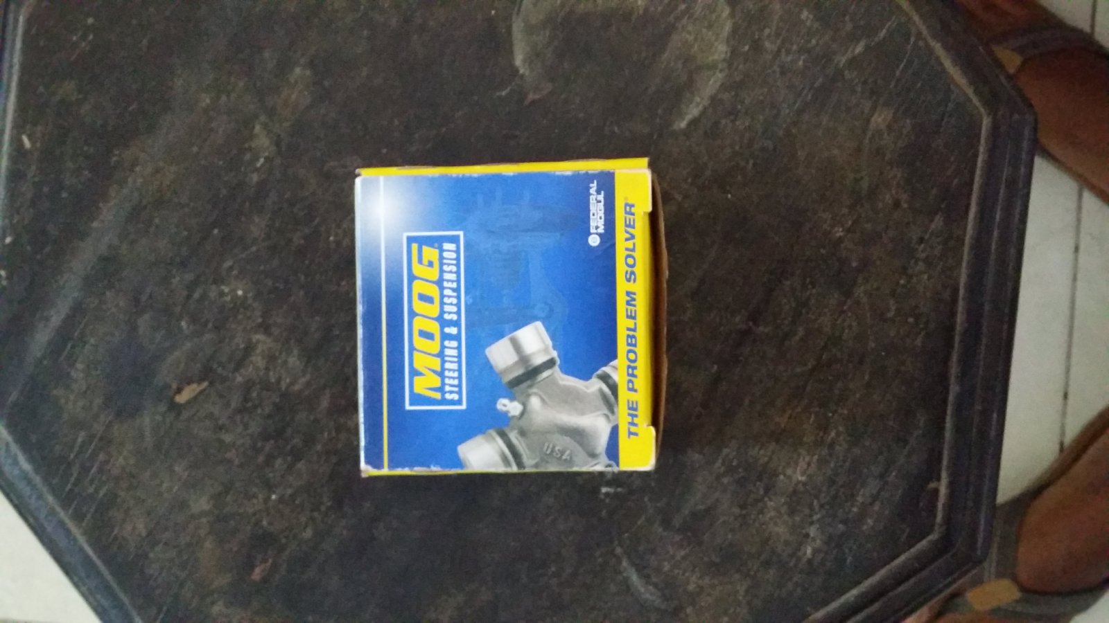

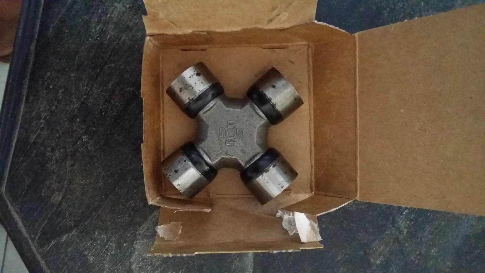

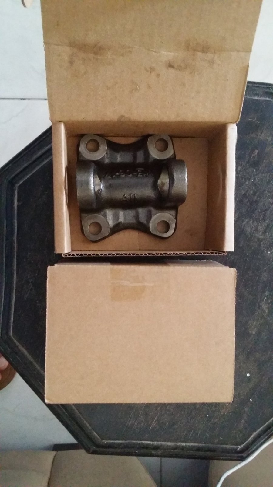

    1 U-joint Moog Precision 5-153X (Arrived)
    https://www.ebay.com/itm/369-Univer...ash=item3f9406c1fa:g:NjoAAOSw1JhZZRZ7&vxp=mtr

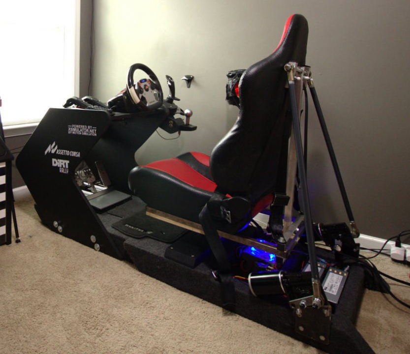

    This build is going to look REALLY familiar to me :)
    I sent a reply to your private message about my specific measurements. Really excited about seeing your build come together!

    If I do it will have to be very low profile to still be able to slide under my desk for when friends sensitive to VR sickness come over and I only have about 2 inches to play with. I think it'd basically be a fishing boat seat swivel (similar to amazon.com/Attwood-17720-Boat-Seat-Swivel/dp/B001O0D6SI ) set up under the pedal area on a triangular plywood base that sticks out wider in the rear to act as a track for it to slide on.
    I feel like there's a better design out there, let me know what you come up with too.

    And I highly suggest a flanged pillow block bearing over a lazy susan for TL pivot.

    I was gonna get a lazy susan, but I will take your advice. What size pillow block bearing do you recommend adn do you have any to any?

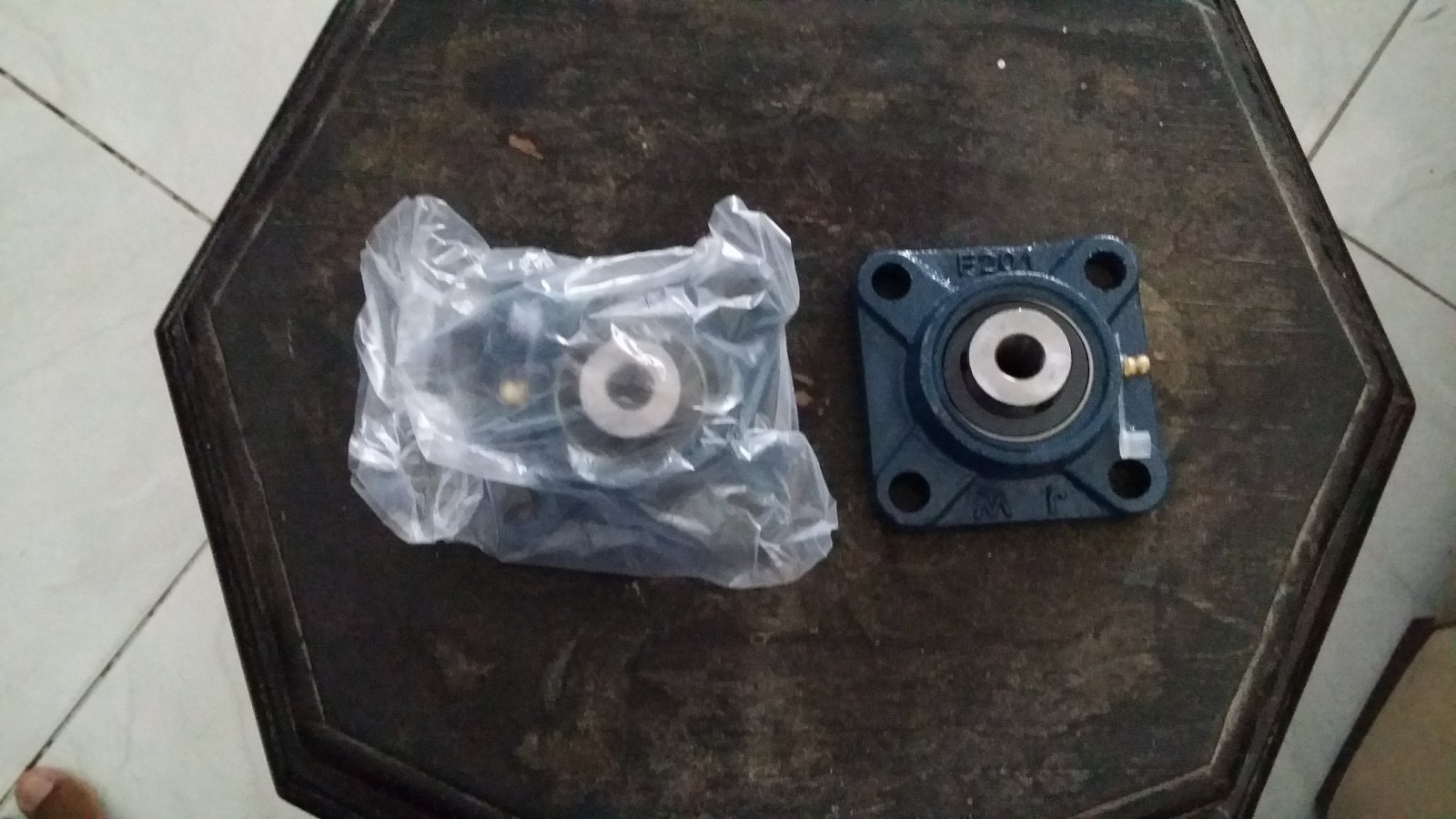

    I saw on another build thread, that he was gonna use a 1" pillow block bearing. Does that size sound good because I have found a couple reasonably priced. So I would have 1 as a spare as well.
    I also see where he was gonna use stud mounted ball transfer 1" instead of casters, is that good, because I also found some of those at a good price as well and would get 4, 2 for front and 2 for rear.
    Still not sure about the electronics side of things, that's where i'm having most difficulty understanding and deciding whats best for what i'm trying to do.
  8. Nick Moxley
    Nick Moxley Well-Known Member SimTools 2.0 Beta Tester
    2,746
    19,891Coins
    +2,458 / 29 / -2
    Yes 1" Flanged pillow block bearing will be fine. You will Not need a spare on that bearing with the use we are using them for.
    Im not a fan of those "ball transfer" They are meant to be used with Many Many Units, where as with our setups unless you set it up as such, you will be maxing out the weight loading on them and it wont be as smooth as bearing supported Castors.

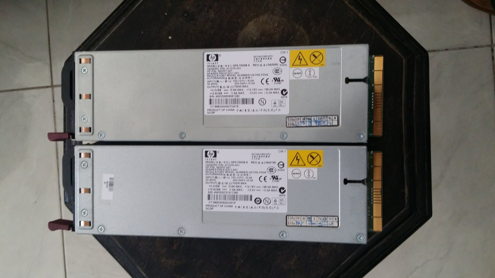

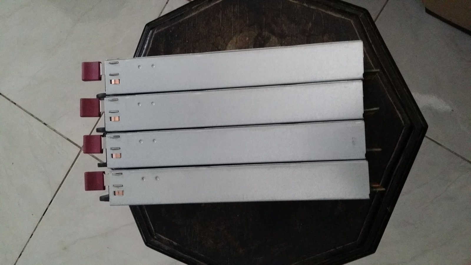

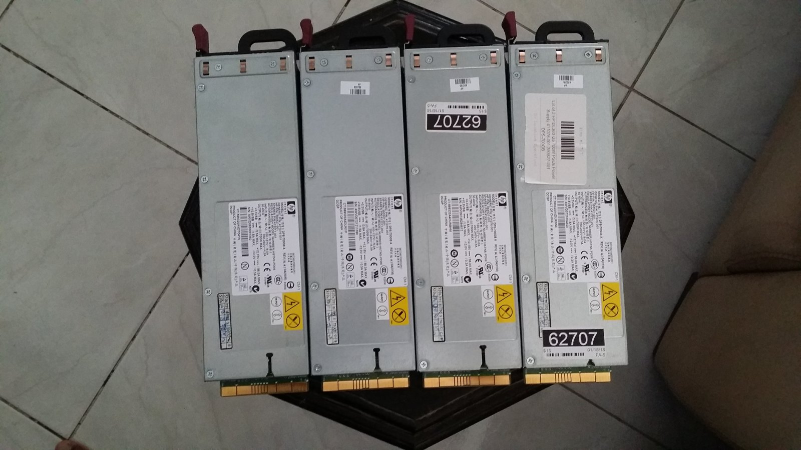

    I currently have 2 HP DL 360 700 watt power supplies. Can these be used in parallel to power my 3 motors or do I need to get another power supply for the traction loss motor?
  12. Stephen Robotham
    Stephen Robotham Member
    Feb 16, 2018
    94
    jamaica
    264Coins
    +36 / 0 / -0

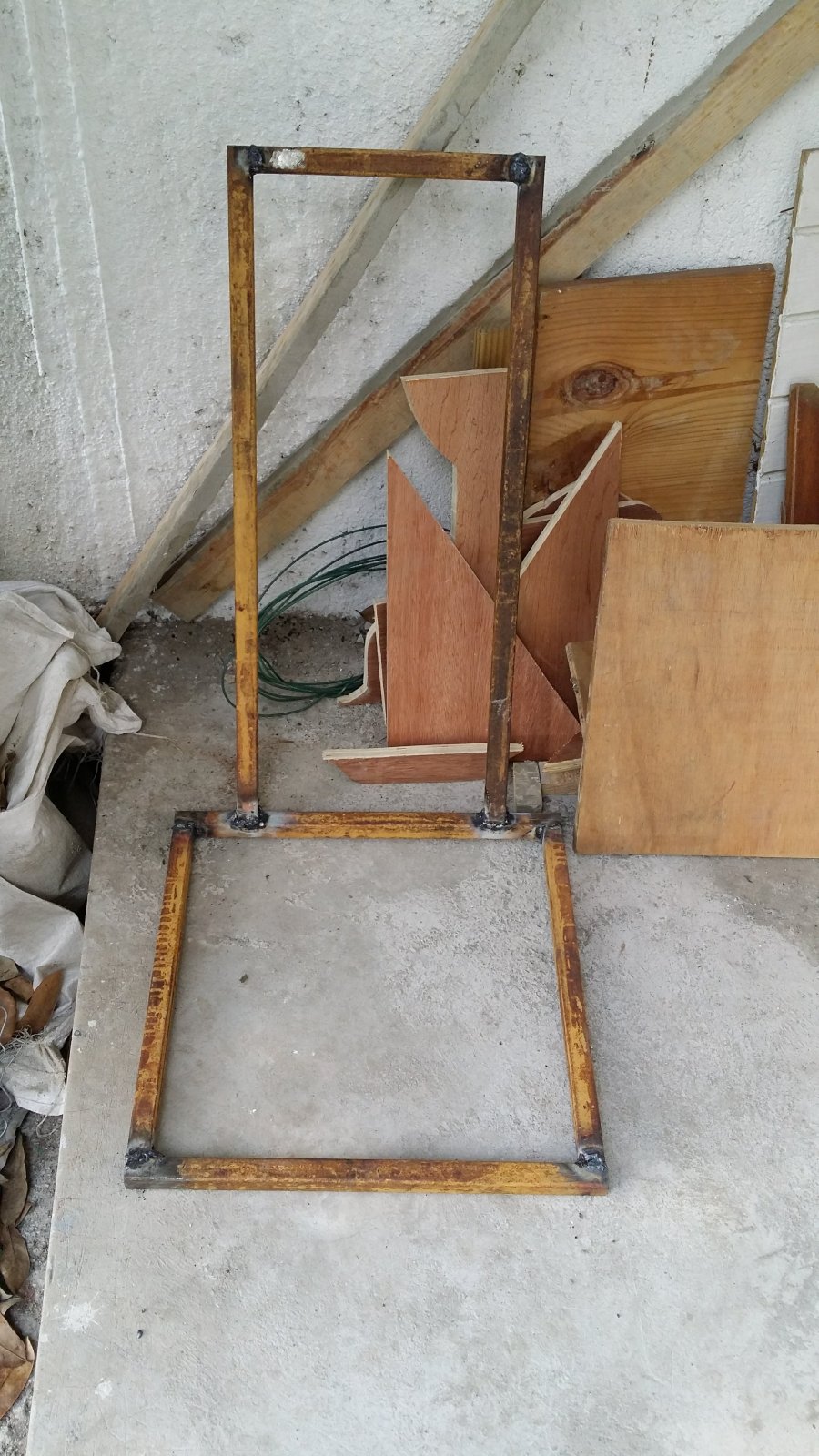

    Okay, I never received any response to my last question, so I just ordered 2 more power supplies. Better to have too much than not enough. I have finished welding up a seat frame (actually bought a welder and started teaching myself to weld just to do this). Hopefully the welds will be strong enough, if not I can just do them over.

    2 HP DL360 (DPS-700GB) 700w power supplies in hand and 2 more on the way. Should be getting some more parts today.

    I missed the notification for that question! Yea, I would have recommended going to one per motor, if for nothing else then ease of wiring - hooking up server power supplies in parallel can be a little funky unless you find a manufacturer wiring diagram or another member's build that shows how to connect them in parallel. The 1400w from two of them should be enough even with power spikes for three motors if you do find how to wire them in parallel and need to save space though.

    I now have all power supplies in hand with one as a backup.

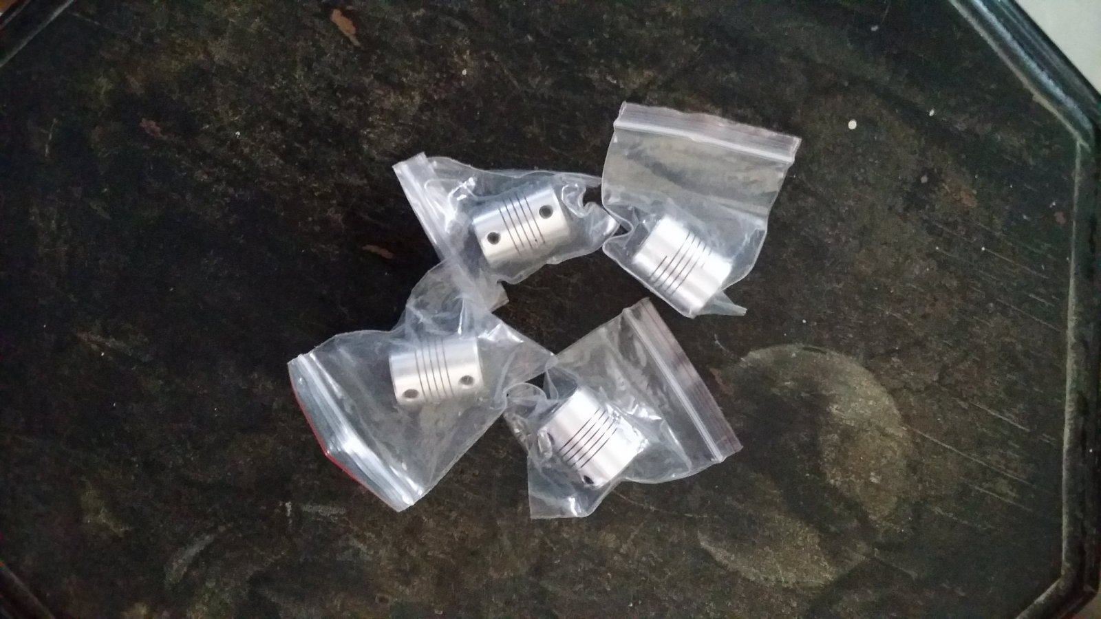

    Couplers are here waiting on the pots and motors.
