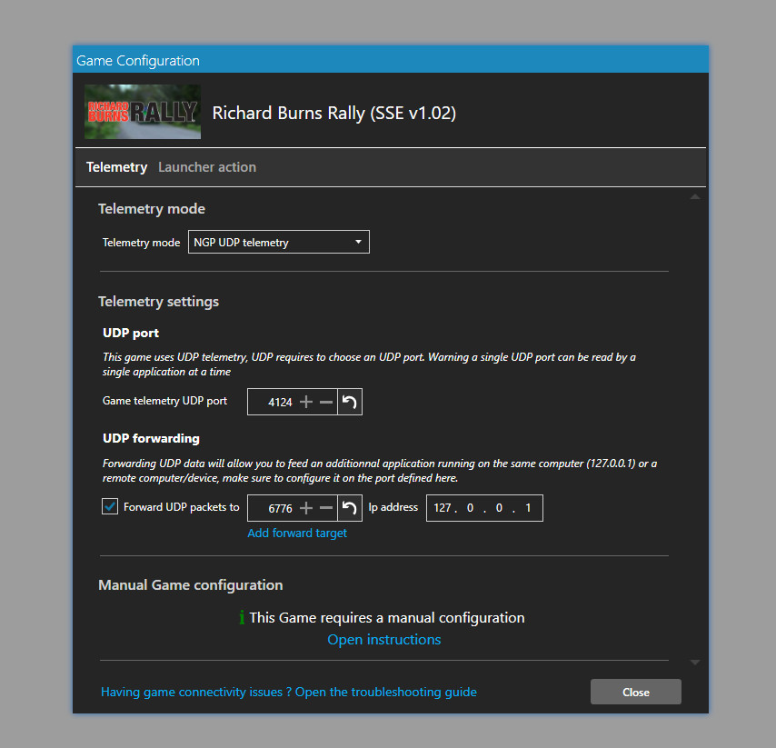

  8. fernur246
    fernur246 New Member
    Feb 3, 2021
    16Coins
    3DOF, SimAxe
    Hello.. Any luck getting rbrpro to work with sim tools ?

  10. jonathan22
    jonathan22 New Member Gold Contributor
    Jun 27, 2019
    - 56Coins
    I already got it to work for me. Inside the rbrpro directory, there is a game folder in which the base game is, if from there you open the executable .sse it loads all the rbrpro configuration and the movement works. I have a shortcut of this executable and I always launch from this
  11. Bulletpup
    Bulletpup New Member Gold Contributor
    Jan 3, 2021
    29
    117Coins
    +10 / 0 / -0
    This is how I ended up figuring out how to make it work too...I'm disappointed that I can't just push the normal launcher. Everything works, VR Motion all your settings you set up seperately in the RBR Pro launcher.
    In case you are looking for it it is in the "Game" subfolder after you right click the launcher folder and click open files. Then you basically launch the game by the sse version not the no_sse version.
    I contacted one of the support members through Facebook and said I shouldn't have to do that. I didn't used to have to do that. Not until one of their updates stop letting it work for me. It was literally one day it worked, the next, nothing. That workaround seems to be the only thing that works with simtools. I even messed around changing the port numbers in RBR pro and couldn't get anything to recognize.

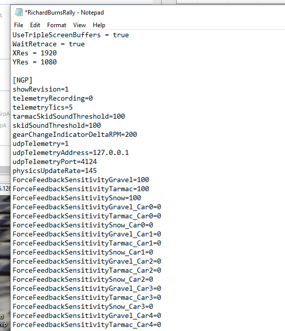

  15. soplilloracing
    soplilloracing New Member
    Mar 28, 2017
    España
    85Coins
    Hello..
    where is the game folder richard burns configuration to change the udp?
    The same thing happens to me one day it stopped working and I'm going crazy

  16. Krzysztof Dej
    Krzysztof Dej Active Member
    Jun 3, 2020
    315
    Poland
    1,100Coins
    +74 / 0 / -0
    If u have rbr pro I heard that pro is making config files default always when game starts so I recommended to install rbr without pro or rbr with Hungarian plugin. This file is called Richard burns rally. Ini in main game folder

  20. Krzysztof Dej
    Jun 3, 2020
    315
    Poland
    1,100Coins
    +74 / 0 / -0
    I don't use pro. Carlo is making money for free game and not his mods mostly. I far i know pro rewriting all config files when start game so it's may be problem. I recommended to install clean rbr and rbrcit program ( u can downloaded all cars, sounds, and ngp) no need to pay Carlo
