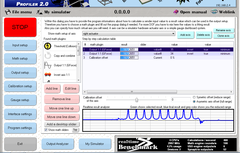

    I get weird values from Roll(Effect 35) when i drivin straight line or when i cross that line.
    Is the plugin roll value calculated same way than rfactor plugin example?
    Code:
    // Compute some auxiliary info based on the above
    TelemVect3 forwardVector = { -info.mOriX.z, -info.mOriY.z, -info.mOriZ.z };
    TelemVect3    leftVector = {  info.mOriX.x,  info.mOriY.x,  info.mOriZ.x };
    // These are normalized vectors, and remember that our world Y coordinate is up.  So you can
    // determine the current pitch and roll (w.r.t. the world x-z plane) as follows:
    const float pitch = atan2f( forwardVector.y, sqrtf( ( forwardVector.x * forwardVector.x ) + ( forwardVector.z * forwardVector.z ) ) );
    const float  roll = atan2f(    leftVector.y, sqrtf( (    leftVector.x *    leftVector.x ) + (    leftVector.z *    leftVector.z ) ) );
    const float radsToDeg = 57.296f;
    fprintf( fo, Pitch = %.1f deg, Roll = %.1f deg\n, pitch * radsToDeg, roll * radsToDeg );
    Bad englis, sorry!
    EDIT:
    This is screenshot when i driving circle and cross that weird line two times in round.

    There are two roll values in the rFactor Plugin. You may have better luck with 30

    No, Roll in effect 30 don't tell vehicle body roll example when you stop non horizontal road.
    I tested rfactor example plugin and i get steady roll values when i drive circle.
  15. bvillersjr
    bvillersjr Active Member
    Oct 11, 2008
    1,174
    Ohio, USA
    438Coins
    +23 / 1 / -0
    Yes, obviously vehicle body roll is different from the typical roll value. When I responded to your post, the image was not present. You have definitely located a bug if that was driving in a circle. What type of simulator do you have that makes it worthwhile to represent body roll?

    Simulator is Frex with X-sim.
    In real word when i drive car my seat follow road pitch and roll and i want same in simulator. 34 Pitch works great.

    I agree that roll and pitch are valuable, but body roll in a 2DOF? It's an interesting experiment if the value is available.

    In my opinion, body roll and pitch is maybe only values what 2DOF can simulate real?

    Most people prefer to use the roll axis to simulate lateral g-forces in a 2DOF SCN5 setup for car racing.
    But it should be no problem to use vehicle roll data instead, if the game outputs such data.
    Or even both effects mixed together.

    Yes, body roll and litlebit lateral g-forces to create some effects.
