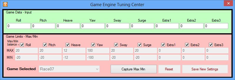

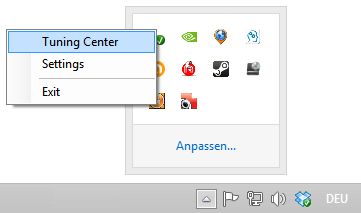

    Right-click on the GameEngine Tray Icon GameEnginTrayIcon.jpg and select Tuning Centre Open TuningCentre.jpg
    A window opens with lots of data:
    Click on Capture Max Min and then on Reset
    Run your game and drive an average round without crashing.
    Save New Settings and Stop Capture
    Now you should have greater movements of your sim.
    NB: The lower the MaxMin values in Tuning Centre Game Limits, the stronger the movements.
    Have a try.

    Hi @bartez81
    Have a try with the Tuning Centre approach.
    If you see changing numbers in the "Game Data - Input" fields, you're on good track. Most probably you will only have to adjust the Max/Min values to get proper motion.
    If you see no flickering data in these fields, please let us know.

    Ok a have no data in Tuning center.
