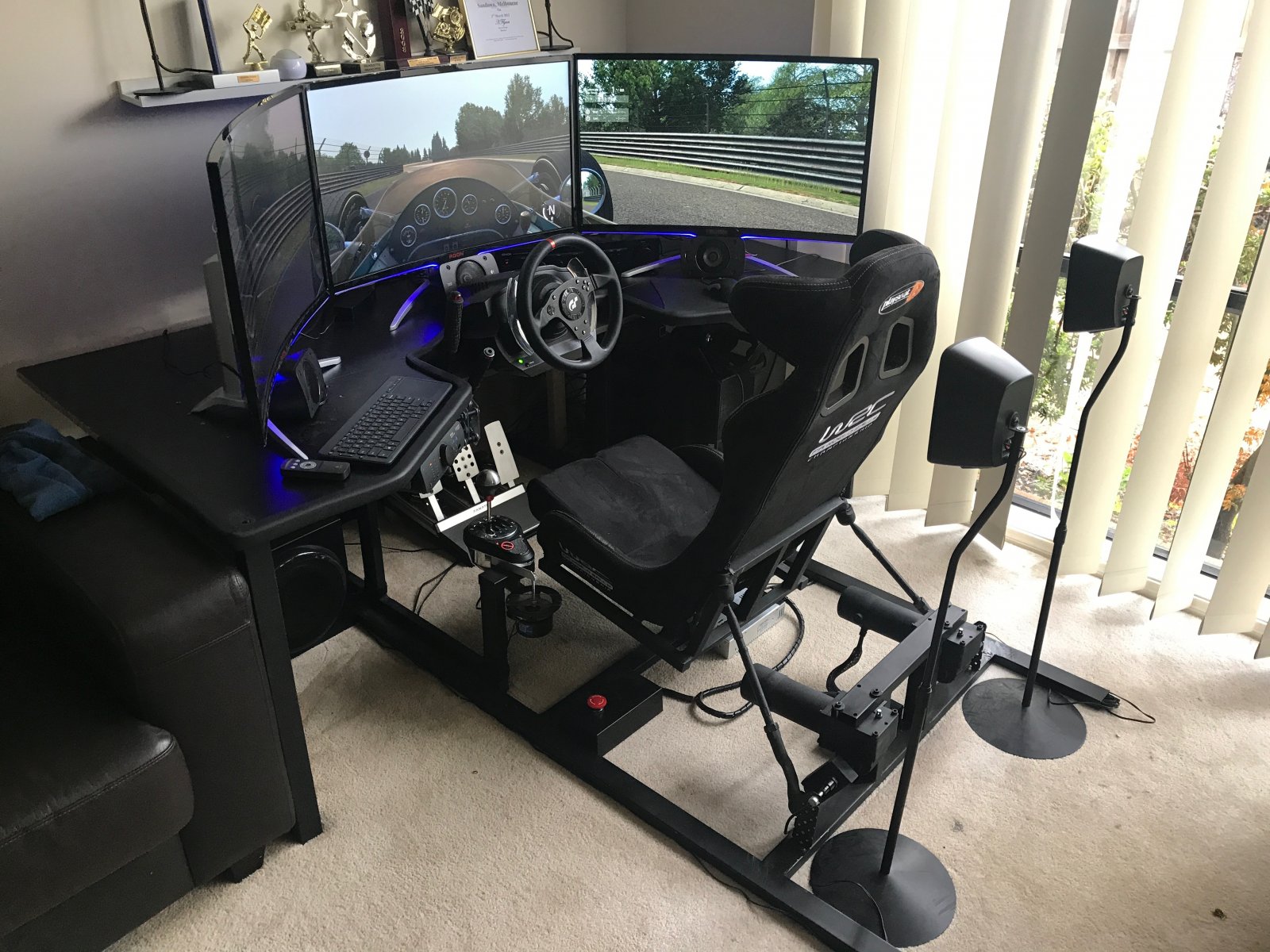

    Hey guys,
    I am using simtool 2.1 Everything works well except I noticed which ever axis i reverse the direction introduces unwanted jerks in that axis. All motion is really smooth until I reverse one or more axis.
    Things I tried:
    reverse motor direction in code.
    Reinstalled simtools.
    reinstall windows and simtools.
    Upgraded pots to hall sensor pots.
    Upgraded wiring to shielded ones.
    I did the change from arduino uno smc/serial sabertooth 2 x 25 to XPID arduino mega/sabertooth 2x32 for packet serial support and lcd.
    I still have the same issue when reversing any of the axis, whichever one with a tick in DIR checkbox becomes jerky, when testing or in game. I can therefore only have a smooth sway or a smooth surge, but never both.
    Has anyone else experienced the same problem? or can suggest what I overlooked?

    Other things I noted, the virtual axis does not move when the seat jerks. There is no unwanted movements when testing in SMC utils. or before reversing any axis.

    @AeroMicky ,
    We need more info.
    Like what game is being played? (if any)
    What do your axis assignments look like?
    What do your interface assignments look like?
    Please post some screen shots when you can buddy.
