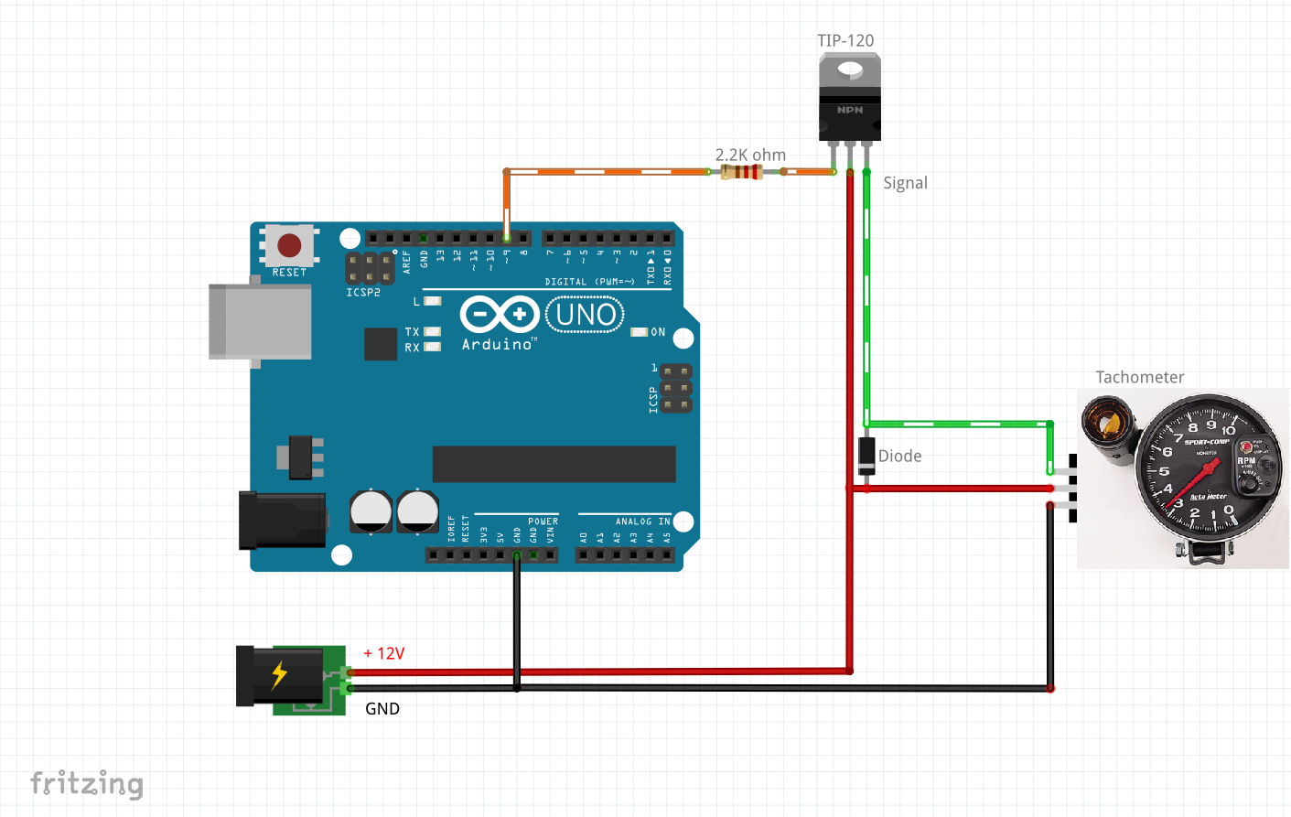

    Hi , I got a problem with my rev burner project. I made the connections, arduino coding but my gauge is not working. I uploaded a video on Youtube. My schema is attached. I hope you can help me. Thanksss
    btw, thanks to @jamesdio for the project ;)

    It is really hard to see setting via a video, can you please post screenshots instead.
    What version of SimTools are you using, as GamDash needs a Pro license for SimTools 2?

    Thank you for reply. I solved the problem. I didn't make a space between TOHEX + PAD 4 0, so I put a space. And I didn't start game engine and game manager, so now it's working.
