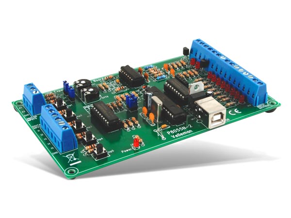

    HelloI have 3 cards VM110 / K8055 Velleman unused.
    I also have an Arduino Due card 3.3v I am trying to interface for signals
    2 Output DAC to 0v to 10 volts
    4 Digital OutPut minimum

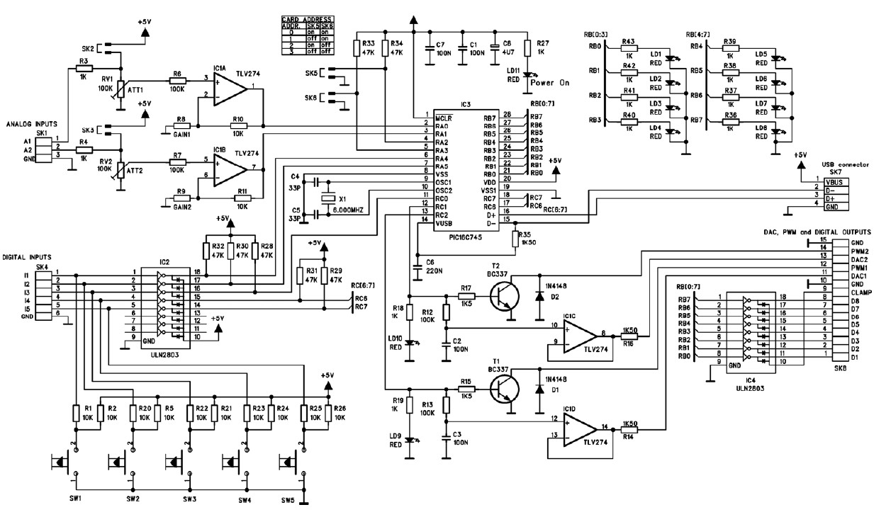

    :!The main idea would be to wire the Arduino on the support of the PIC 16C745:
    1) Remove the PIC 16C745 8bit (IC3)
    2) Supply the card by 10v pins 1 and 4 of the USB socket of the VM110
    3) Connect the RC1 (pin 12 of the PIC) and RC2 (pin23 PIC) to 2 pins PWM 3.3V Arduino Due
    4) Connect the RB0 to RB7 (Pin 21-28) for 8 digital output pins of the Arduino Due
    In order to get in OUTPUT 0V to 10V, it would also modify the IC TLV274IN amplification ratioAccording to the future needs, it could possibly also be wired INPUT the VM110
    Have you ever considered such changes?
    Thank you tell me your experience possible return
