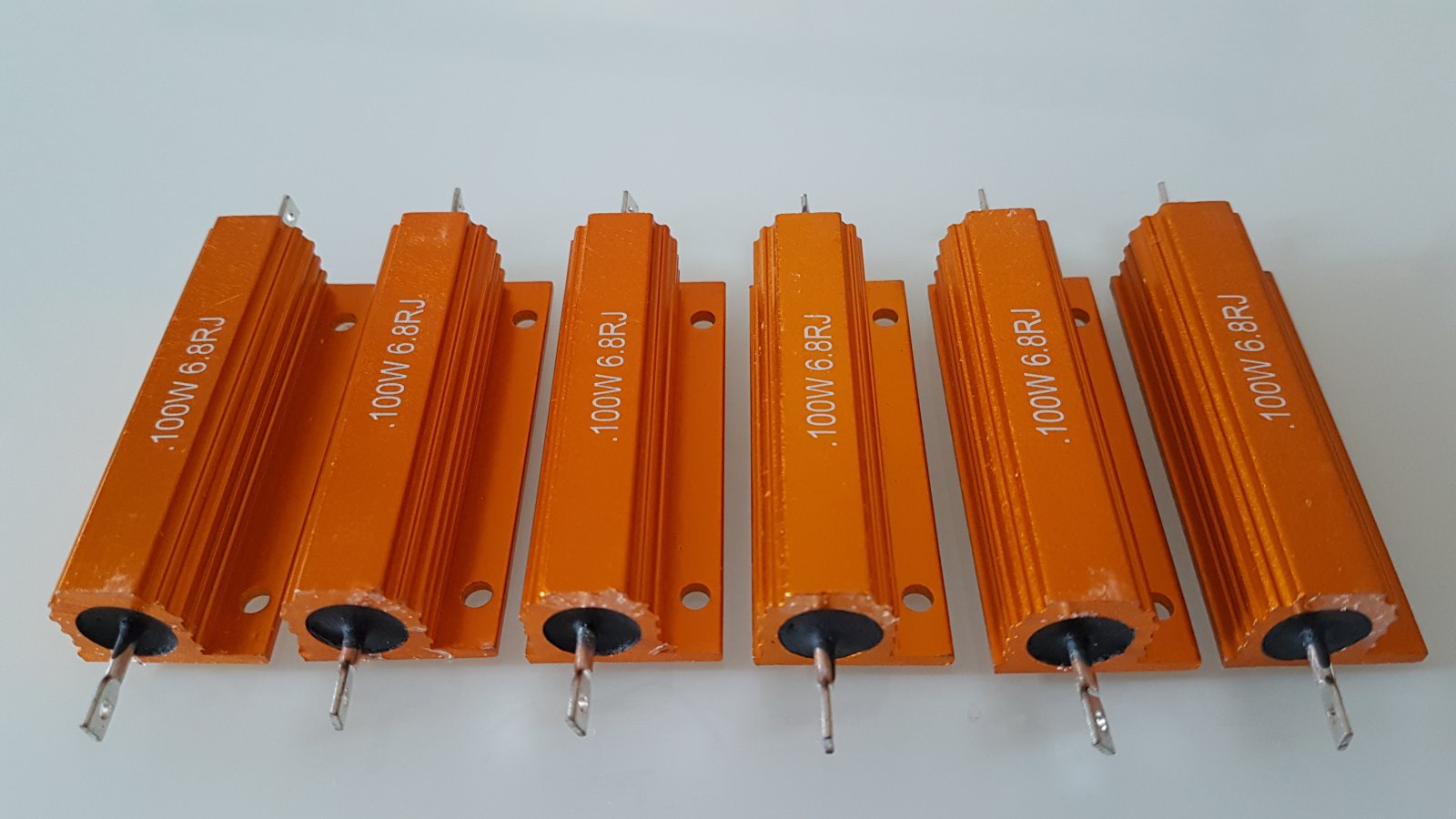

    Hi Gigi, this is the link of the same subject discussion.
    https://www.xsimulator.net/community/threads/sabertooth-2x32-uno-rev3.12391/
    Same your problem, n. 3 engines and n. 2 power supplies with the same features for DOF 3.
    I purchased n. 6 metytere resistors in pairs in parallel of 6.8 ohms 100w.
    https://www.cariatielettronica.eu/1...100-watt-corpo-in-alluminio-100w-100watt.html
    Hello
    Fabio

    The 6 ohm resistense are hard to find, I don't know why.
    I'm not an electronics expert.
    The value that is closest is 6.8 ohms, I asked a store in my city and he told me that it's fine.
    Hello

    Hi bixler13, thanks for your post.
    I bought these:
    https://www.cariatielettronica.eu/1...100-watt-corpo-in-alluminio-100w-100watt.html.
    N°2 resistor 100w 6,8ohm each in parallel for each motor mean that total resistence is 200w 3,4 ohm. I also asked to dimenson enginering and they answered me that my choice is ok. For 4 motors I bought 8 resistors

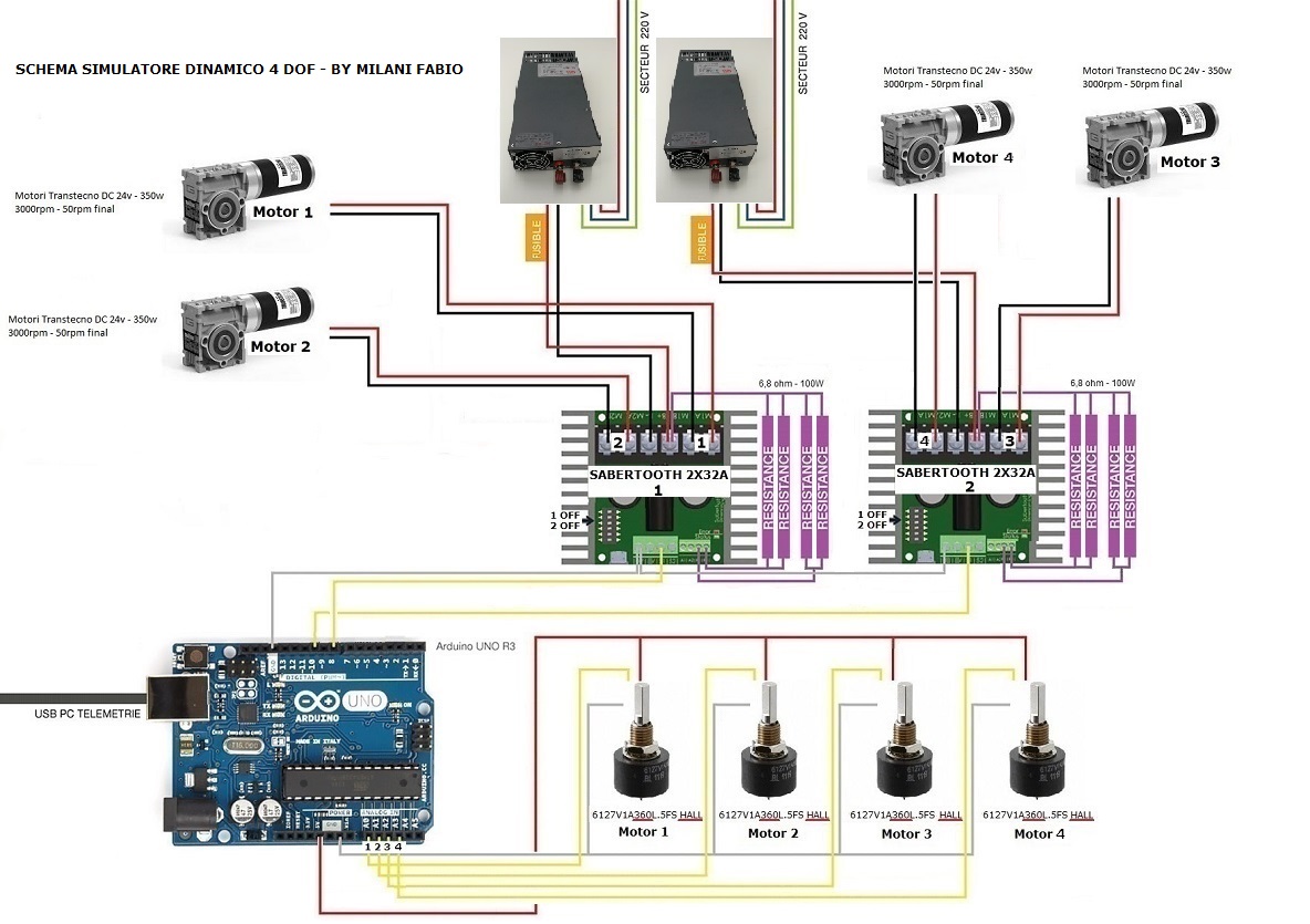

  9. Milani Fabio
    Milani Fabio Active Member
    Feb 21, 2019
    105
    Italia
    714Coins
    +74 / 2 / -0
    Regardless of the power of the motors, Sabertooth can discharge a maximum of 8A.
    I mounted 2 Sabertooth 2x32A with 4 350w 24v motors.
    I put these resistors and everything works fine.

    for the quick reply. Since I stumbled across the 8A myself. I also considered the same structure with 2 6.8 Ohm 100W. The resistors are not that expensive in this size. Thank you for the picture with the structure makes it a little easier

    I really like your design which fits my project quite well.
    Can you tell me something about the Wire Gauges?
    Which Gauge did you use for the following connections?
    - Motor to Sabertooth
    - Cables between the resistors
    - Cables to Power Supply
    - Cables to potentiometers
  12. gigi
    gigi Active Member
    Nov 16, 2013
    466
    900Coins
    +139 / 1 / -0
    2DOF, JRK, 4DOF
    Please excuse me if I am late in replying to your message. I abandoned that project a long time ago to move on to actuators. The thickness of the cables is very important only for connecting the motors to the Sabertoth boards. I don't remember the exact diameter, but I remember using the cables and connectors that are normally used to connect solar panels. Another important thing in my project was to place a heat sink on the boards and also a PC fan to cool them. In this way, even with intensive use, the cards remained at a temperature never higher than 40°. As regards the cables between the potentiometer and the board and between the resistor and the board, very thick cables are not necessary
