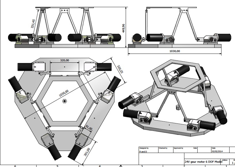

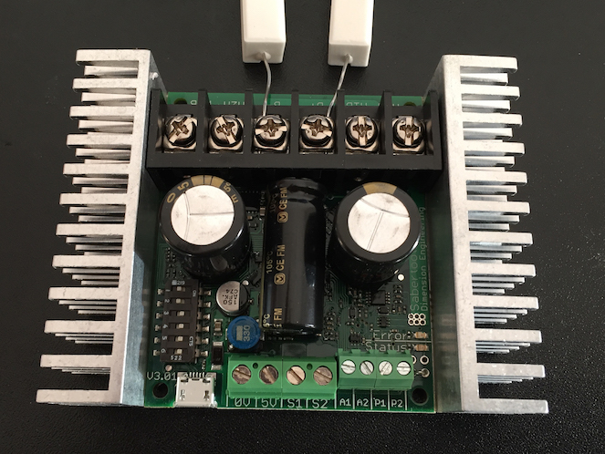

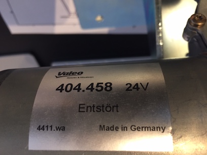

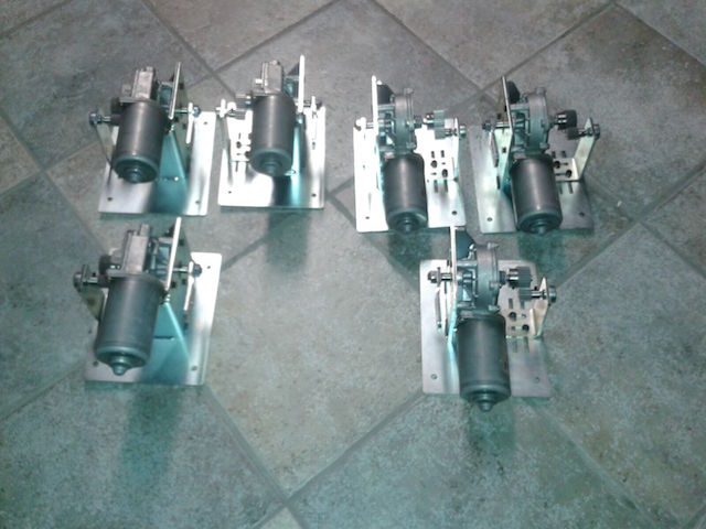

    I should take pictures of what I already have, maybe I can get more help. I had already welded the two hexagonal bases one large and one smaller, I already have the six motors and power supplies

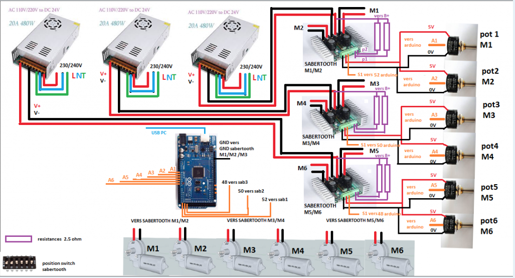

    What I have is this
