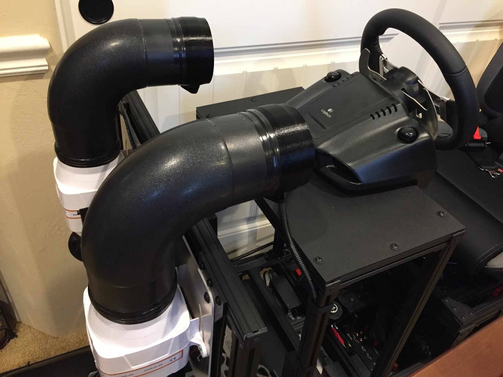

    @FoxONe42 - yep - two axial flow bilge fans. I bought my setup from @Avenga76 back when I was just exploring this stuff. Now I see how easy it is. The Sea-Flo bilge fans are 4" so for a more compact install I mounted them vertically and used 4" elbows to turn the wind horizontal. The fittings on the ends are flow straighteners with a simple honeycomb vane pattern in them.
    As others mentioned, Game Dash just exposes various sim variables and provides an interface to control things based on those variables. In this case it is an Arduino with fan control software and a Monster Moto shield that controls the fan speed with a PWM controller.
    Wind is great for sims especially if you like open cockpit cars and aircraft. Even for closed cockpit flying and driving, I still use wind - just with the variable divided down a bit so the effect isn’t near as strong, but in VR the breeze is welcome. What I'd love is for airplane sim plugins to expose the canopy open or closed status to crank the fan speed up when you open the canopy but that’s dreaming. Some sims don’t even expose the speed variable like @BlazinH mentions.
