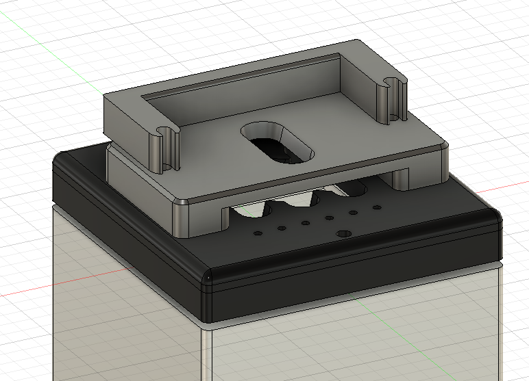

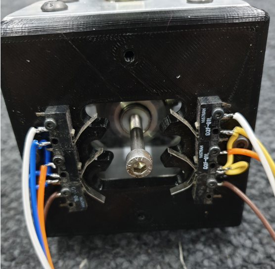

    For those of you that might not know, the shifter in my profile pic was designed and built be me just over 10 years ago. Well now I have lots of other toys and refreshed my sim so I decided to refresh the shifter too. I have covered some of this in my motion sim build but thought it probably deserves its own thread.
    The old one was bulky and heavy (about 3kg!) and I was never fully happy with it. Going to a motion sim, I wanted to make it lighter and more compact.
    Here is the design and final product. I am happy to share any design under the Creative commons Attribution-NonCommercial-ShareAlike 4.0 International (CC BY-NC-SA 4.0) license. i.e do what you will with it but no commercial use of my design or derivatives and I must be credited in any derivative works.

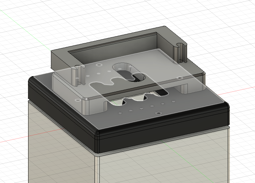

    Here is a 3d drawing of the main components - This was mainly done for dimensions and designing the shifter plate so it does lack the main shifter shaft and rod end etc.
    The base plate has 2 options - One for 6 position H pattern and the extra plate limits it to a sequential shifter. The extra U shaped part is to hold the sequential plate in place. Simply remove the U part and slide the sequential plate out of the way (down) and you are back to H pattern.
    I use an external button for reverse because it's rarely used. I have not come across any 7 gear H pattern cars in sims yet...

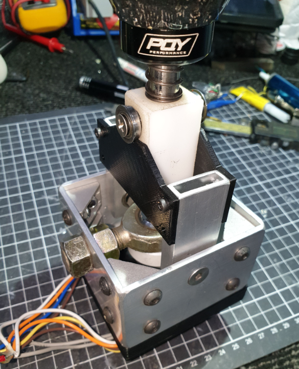

    Main parts:
    Main frame 50 x 20 x 3mm Aluminium angle - Bunnings (cut using miter saw)
    Uprights - 25 x 10 x 2mm Aluminium square tube - Bunnings
    Bearings (6) - 14 x 8 x 4mm MF148ZZ Flanged bearing Aliexpress
    Main shaft 1/2" stainless tube*
    Rod end is 1/2"* (Better off getting a female version for neater finish)
    Random spring to go over shaft
    Some hard wearing plastic also required for the buffer and bottom collet*
    25 x 25 x 50mm Square delrin block*
    All other parts are 3d printed
    The intention was for the frame to be welded or braised (which would look so much better) but I ended up using some mini square brackets I had laying around that I initially bought for my 3d printer.
    * Recycled from my old shifter
    ** The plastic parts can probably also be 3d printed but YMMV, main concern would be the bit contacting the rod end, mine is Teflon.

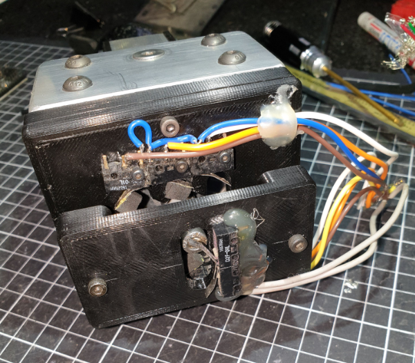

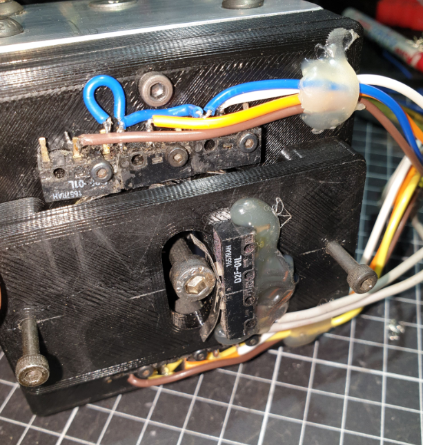

    For the electronics I am using an OSH Studio loaded STM32F1 controller running the V15 firmware (V16 seemed to have endless issues)
    I have mounted the 6 micro switches over the gear slots and added a tiny bit of high density foam (think yoga mat) to the actuators with contact adhesive. This assists with positive engagement of the switches. The micro switches are very small. D2F-01L if you need dimensions.
    2020-08-10_19h55_46.png 2020-08-10_19h54_22.png 2020-08-10_19h53_29.png 2020-06-08_20h10_20.png
    *Missing from pics is the U part and some covers for the top of the uprights.
    This just bolts to an arm I added to my sim and is extremely durable and still very light. Even with the heavy shift knob, this is only about 1kg.

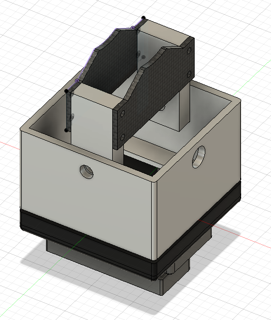

    I do plan to replace the 'ramps' with carbon fibre once i can be bothered with the CNC machine. So far the 3d printed ones have held up astonishingly well but i do see them failing in the future.
    If there is enough interest, I may complete the 3d model properly to give a full breakdown of parts but that's several hours of work (for me at least, i'm not a guru at Fusion360).
