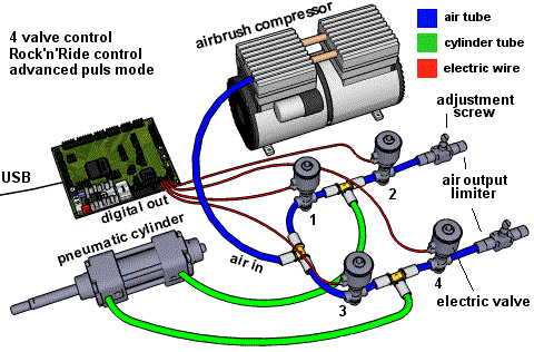

    However, my working setup is an old pneumatic RnR chair, using the digital outputs of the Velleman, just like the picture attached.
    I do realize that not many people use the switched digital outputs like this for pneumatics anymore. I see there is a SimTools plugin for that board, but only for the DAC pins for motor control, understandably.
    I also see that there are many people using Arduinos and such for control now, but I don't know how to design sketches and the like...is there a cheap and easy drop-in replacement option for my setup already available?
    Thanks in advance!!

    It basically pulses the corresponding valve(s) to move the cylinders at different speeds. Hopefully this explains, based on the photo attached above. (I am probably not the best to explain these things):
    The pressure will be split into two separated valve input ports. Every valve is a “unpowered closed” valve which will not throughput any air if there is no power on the valve coil. If you will give valve 1 and 4 power, the compressor air will flow in the right cylinder chamber and the left chamber is opened. This will produce a movement of the cylinder piston to the left. If you are closing valve 1 and 4 again and open valve 2 and 3 the movement will be reversed. The airflow limiter on the outputs will control the movement speed for left or right.
    The softmotion/pulsemode idea with 4 valves per cylinder (realized for Rock’n’Ride)
    all valves are closed
    only right valve connected to compressor, air left will be compressed and a slow movement to left is generated
    valve right closed, valve left opened, the air will move out very slow, because the new pressure is missing from the right side.

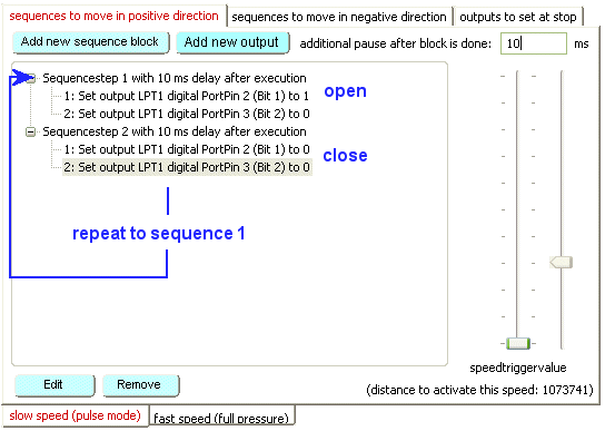

    With the pulse mode function you are able to drive sequences of enabled valves. A simple explanation is if you like to add a second speed without a second pressure. You can simple switch the valve 10 ms on and 10 ms off which results in a slower motion. With this trick you are able to simulate a slower speed and add this speed for accurate movements that are not far away from the current actuator position. This solution only works with the 4 valve/actuator solution shown above.
    (I don't know if a move and hold function is built into SimTools, I assume so, but would be needed):
    The move and hold function will not always poll your simulator and waits for new ingame values. This is good for pneumatic systems. If the driver moves left or right the simulator will also move because air cylinder are very easy compress able. If the simulator moves, the software will normally move against this. This would be a endless moving. If a “move and hold” function is activated it will move the actuator to its end position and waits not for a new simulator feedback but for a new ingame value.
