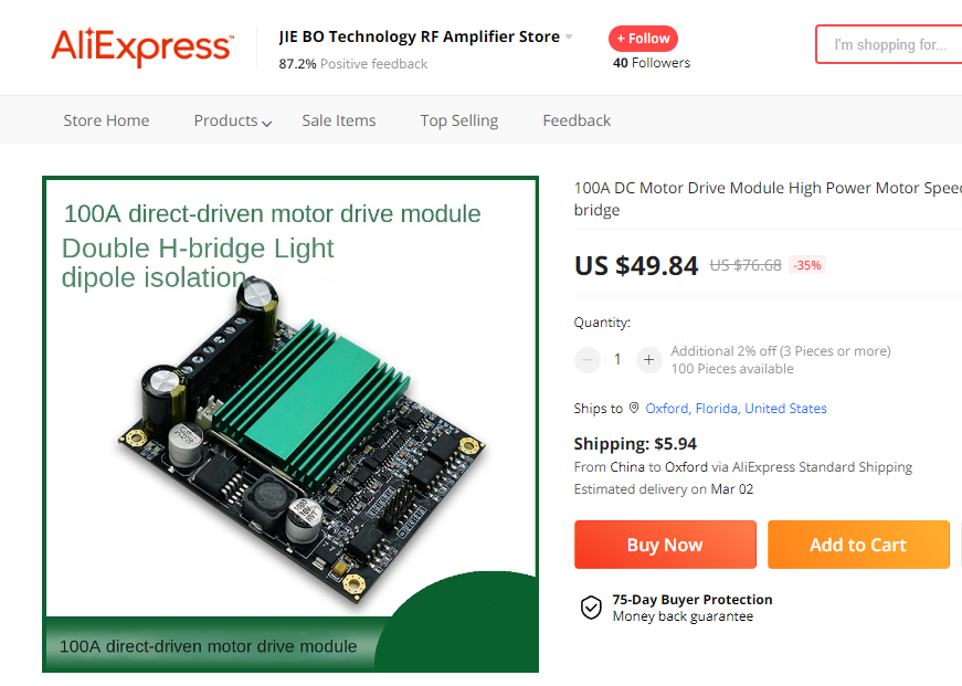

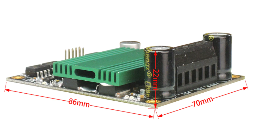

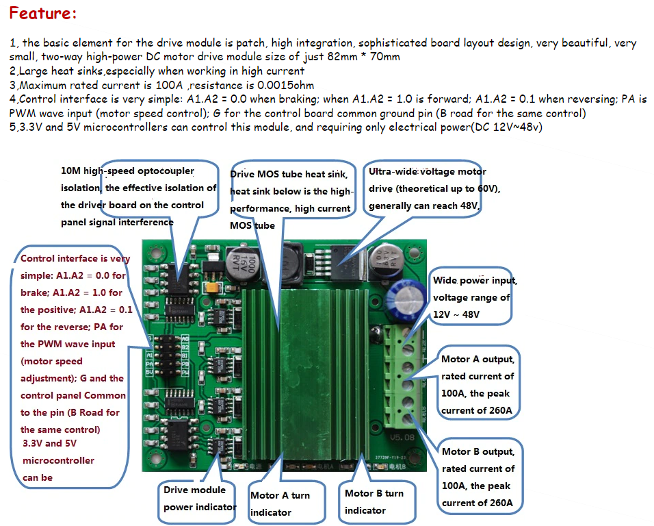

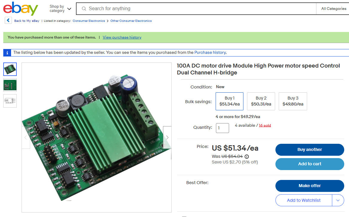

    If you are searching for motor controllers that are reasonably priced and capable of handling high amp loads, I can enthusiastically recommend the following controllers. They are available on ebay and aliexpress for around $50 US. I purchased 3 of them after burning through a bunch of cheap $15 IBT2's. These 100A controllers have been working flawlessly for me so far. They advertise that they can handle TWO 100A continuous loads, with spikes up to 260A momentarily. Though I have not tested that capability, I have been using (3) 40AMP 12V motors for a while now and the controllers have never gotten hot, in fact only just barely warm. Also, I do not run fans on them. Just holding them you can tell how much heavier, bigger, and higher quality they are than the IBT2. Even with (2) IBT2 in parallel, I would still fry the IBT's, but no issues with these! Give them a shot if you are running into issues with IBT2 or other motor controller overheating. Specs appears below along with a wiring diagram I made for connecting the controllers to an arduino. Big shout out to Gadget999 for telling me to have a look at these!

    100A and such a small heatsink?

    I use a fan and thermoswitch on mine
    100A at 24v is 2.4kw per motor !!! A lot for a motion sim

    I just ordered this controller on your recommendation and feedback in usage. But because this does have any type or serial nr finding examples for this is quite hard. Does/can someone here provide me an example arduino code that fits the schematic as shown in the first post?

    Hi CoolZero, I just use the standard SMC3 utilities with an Arduino Uno R3 clone with the sketch set to Mode 1 (which is the default I believe) and it works great. Let me know if you have any other questions!

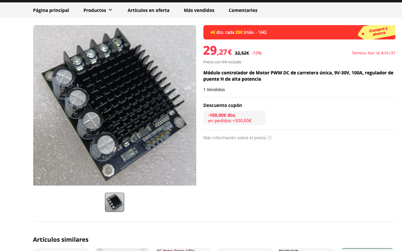

    Hello, good to see this product. Thanks to that I searched a little more and I found this:
    It seems to be the same one but single channel instad of dual channel. The channel-price is better if buy the dual channel but for those who want drive three motors maybe install one single channel for each motor is better solution, IMO for these reasons:
    1) You can connect two motors to one dual channel and one to a second board, in this case you'll have one free channel that you paid for it and will never be used. I'm not confident to install two 750W 24V motors to one dual channel.
    2) Buy three dual channel, one per motor, is "costly".
    My tougth is to go ahed for three single channel, what do you think?
