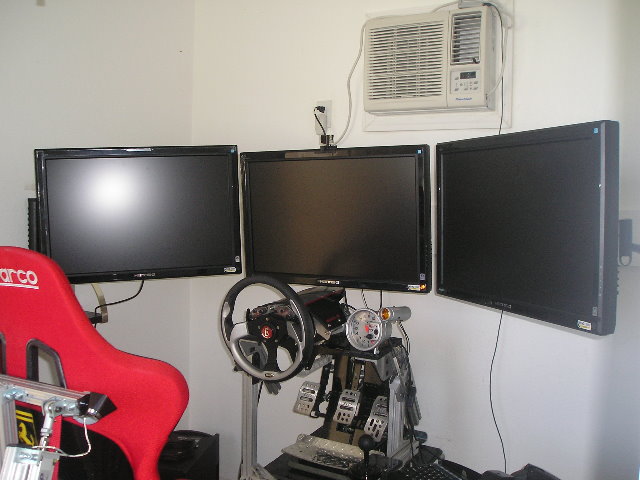

    I have a triple screen set up and tried the Fresnel Lenses option but it is not working out as I had hoped.
    Ideally the Frex canopy is the way to go but as it is sooooo expensive it is not an option so I went looking for rear projection material.
    My thinking is to I fabricate a curved screen made from rear projection material and mount it in front of the sim projecting from the rear.
    The problem I see is the outside image will be distorted probably key stoned to unacceptable proportions and the image will be strong at the center and faint towards the outer edge.
    Obviously the latter is depending on the amount of curve I use, if this is a viable idea I need some help in determining the curvature vs. length vs. Height of the screen.
    In addition to the above concerns the PJ will need to be a fair distance from the screen to allow for an adequate spread of the image and avoid hot spots also space for me is limited (Take a look at my setup photos)
    So I was thinking to angle the screen upward about 15-20 degrees in such a way that the PJ can be mounted above and aim down much like the Frex canopy. I just will not have the elliptical effect that the canopy offers but something similar.
    This again raises keystone issues so before I splash out on some screen material any thoughts or suggestions would be greatly appreciated

    I am using 2 X Nvidia GTX295s in an SLI config and went with the Mviewtech MV103 HDVEPro over the TH2Go.
    The resolution is set at 3840 X 1024 for each monitor; this was set in the Mviewtech software and also shows up as the default in the Nvidia panel.
    I am also playing with over clocking the video cards and i7 processor (just for fun) with the set up I have I really do not need to.
    I do have a mechanical tach that I used with the Frex software... that may still be an option as soon as I figure out how to use in with X-Sim
    I am going to be experimenting tonight with the MV103 software to try different resolutions for each screen, as the instrument cluster RPM meter is right on the break (between the screens) in Grid also the images look too detached from each other .
    Hopefully I can manipulate the resolution on each screen to offer a better triple image spread.
    I will fire up Grid tonight and post the image that have at 3840 X 1024 and then try different settings on each screen.
    If the MV103 can display different resolutions to each screen any suggestions to what to start with? As the software has about 30 settings for each screen and I do not want to spend hours trying to find one that may work.

    I look forward to seeing some pictures. It's interesting because I own a Hanns-G 28 as well... Would it be possible to make some video footage too ?
    A friend of mine is thinking about selling his Hanns-G :D , so only one screen would be missing yet !

    These monitors should display good 16:10 1650x1080, only by using the TH2G digital...
    Have you tried it?

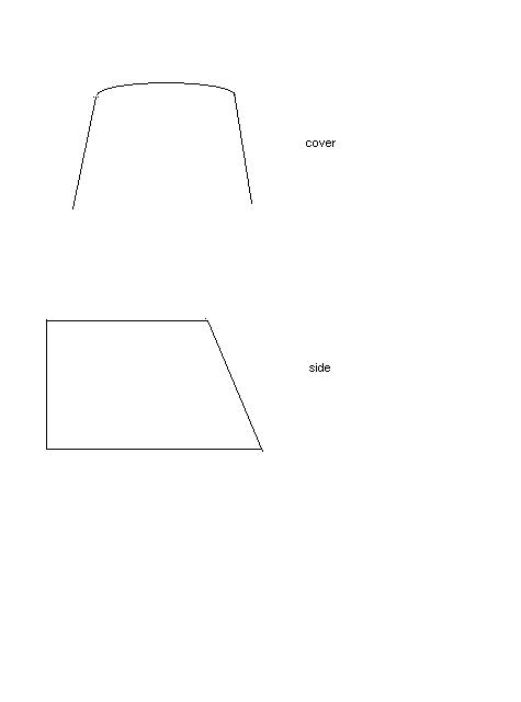

    the dom is a nice piece but to big for use on a simulator.a rearprojektion are better if you have the right size.i have make a paint were i mean is the best screen design for race.you can use the soft were raceray have say or you projection mast go over a mirror were is a littel banding.or you make only a black mask beside the projection.
    or in any years this onehttp://www.golem.de/0801/57135.html

    I will try to get some video up tonight if you look at my photos it gives an idea of how the set up looks

    I use a Mviewtech MV103 HDVEPro over the TH2Go as I was hoping it would allow me to set different resolutions on each screen to customize my views, but I tried last night and when I set a different resolution on one screen I lost the display completely then spent 30 minuets trying to get it back (as it was the default screen for the pop up Nivida tool box)
    I am hoping that is was just my choice of resolution that caused the failure and willl try your suggestion of 1650X1080.
    I will also get video or photos of GRID up tonight to show the detachment of each screen.

    OK I have come to the conclusion that this looks like a good option as far as imaging goes http://www.vcsims.com/vcsims-racingsimulator.html
    I spoke to the manufacturer but they will not sell just a screen, so I would like to attempt to construct one.
    As I am using a FREX with a custom cockpit I was hoping to follow the same mounting style that VCSim uses
    As a prototype I need a projectable ridged surface that is bendable I was thinking a 5mm thick plastic sheet or even a thin sheet of plywood or a similar type of wood. I can bend it to the correct shape and the fiberglass the back to make a rigid screen then and coat it with this http://www.projectorscreenstore.com/PSS-Projector-Screens-Paint.html
    As it will be a forward projected image Nimas sketch is too extreme so what are the optimum angles for a short throw PJ?
    Should I go for a gentle bend say 5-10 degrees across the whole screen or have a flat back and bend in the outer edges.
