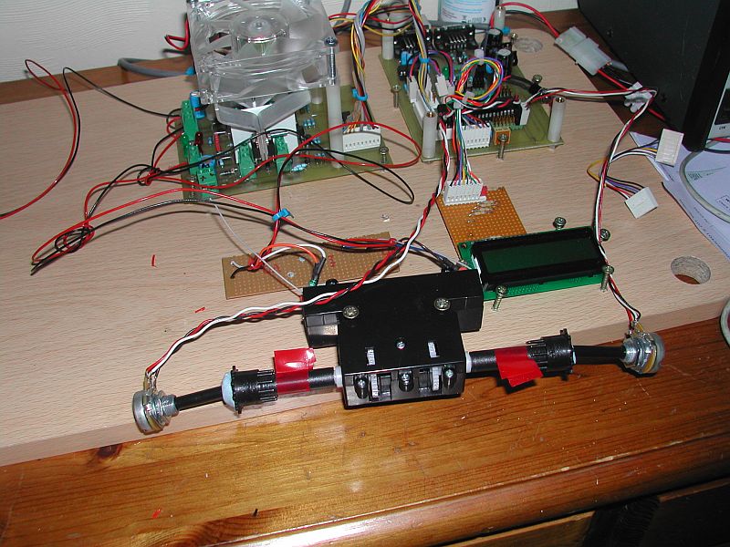

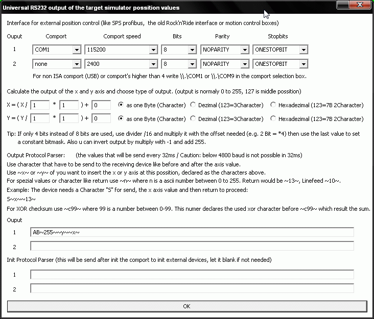

    Hi Thanos or any other sim member out there Know where can i find a profile for LFS using your AMC Electronics and DC motors ..have sucessfully tried the X-sim 1.6.9 setup and other than an intermitant Comms Problem the system seems fine so far .. would like to try out X-sim2 but the sample files supplied dont seem to include the DC Motor Option (*.Rn2) ?? Can anyone post a Screen dump showing the USO settup for Dc wiper Motors Please. been skipping through some posts and noticed that someone else had a similar Comm's Problem ie does not alway repeatedly link up with the USO Output when pressing the start button on the profiler ? the main thing for me is im on the right track and bit by bit my baby is taking shape and should have a Video as soon as the mechanical bits are connected to the Electronics :clap:

    Here is a screenshot of the USO settings about AMC1.5 for the old x-sim profiler:
    The RnR profiles can be still used as usual!! The only change needed is on the USO...
    The old USO had a minor bug that in certain cases did not synchronize with AMC. I located the issue on the com buffer of the AMC that was filling with junk characters if the profiler was sending data before I power on the AMC.
    The solution I found was to STOP the profiler from sending data, RESET the AMC and then press the START button on the profiler. After that I could STOP the profiler and START it again anytime as long the AMC wasn't powered off in between...
    I did not encountered this buggy behavior on the new x-sim2 profiler USO, so I guess that Sirnoname fixed it along some other issues we had during early beta period...
    Best Regards, Thanos
  6. wannabeaflyer
    wannabeaflyer Active Member
    Jul 31, 2008
