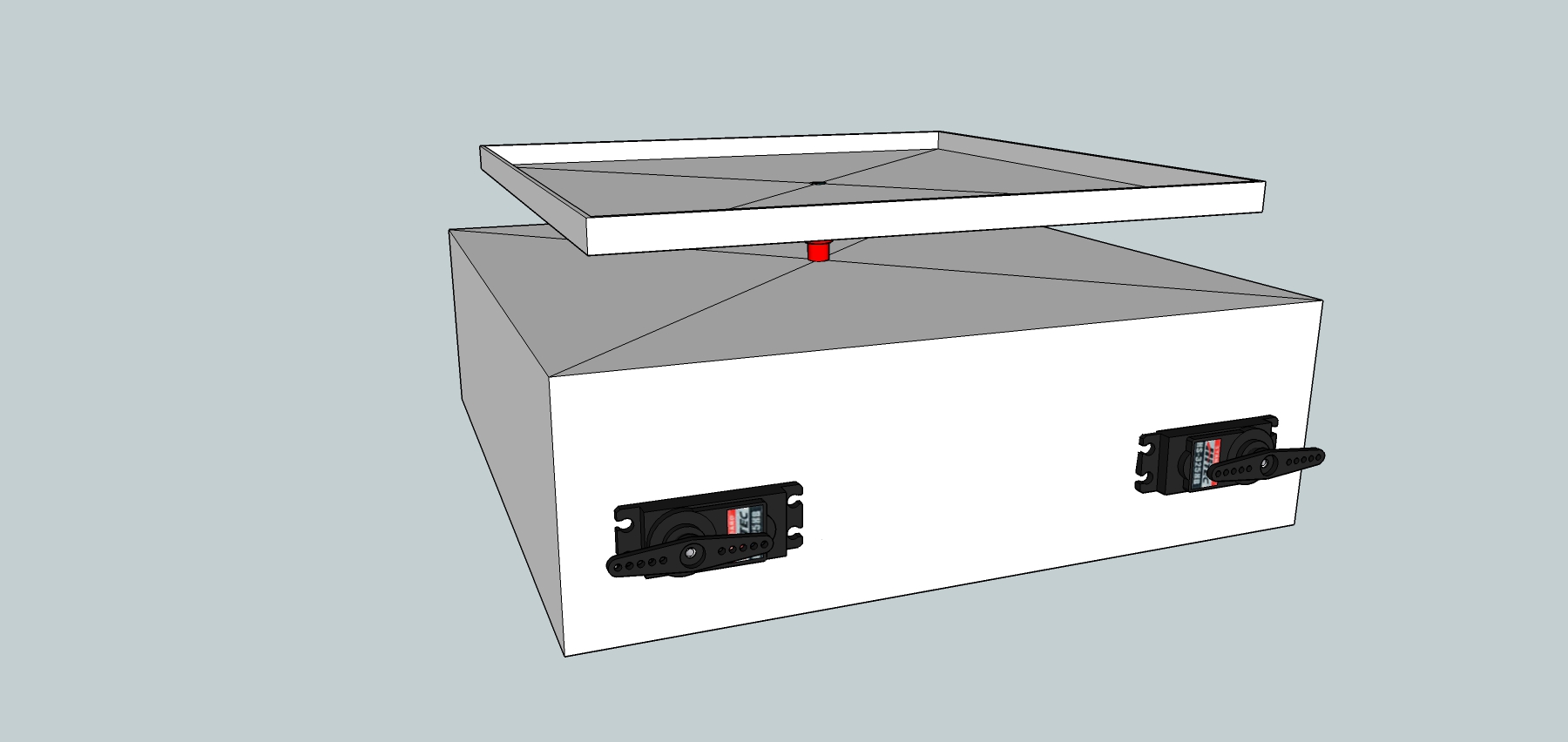

    This was my first step in building a sim.
    I decided to build an RC model so that I may learn how to use the software and develop a motion sim.
    Components include:
    2x Futaba FP - S148 RC Servo's.
    4x Clevis's to suit RC Servo Horns.
    2x Rod to suit clevis's.
    1x Uni Joint for 3/8 Socket (cheapest uni joint I could find).
    1x 1.6mm zinc sheet (main box to mount servos in and top for model to sit on).
    1x Ardunio UNO R3.
    1x 6v power pack.
    Some patching wire to connect servos to Arduino.
    Ok from here I bent I cut 2 squares out of the 1.6 zinc to create to open top boxes with the dimensions of 225x225x10 (Top for model to sit on) and 255x255x80 (box to house servos and Ard. )
    From there I welded the uni joint in between the two as per my google sketch.
    Now the top moves as a sim base would, I cut in and inserted my servos as per my sketch, position them so that a connecting rod from the servo horns to the top tray are near vertical.
    Then I created a rod with two clevis to join the servo horn to the top tray.
    Wired the servos to the Ard as below
    Not shown is power pack attached to Ard. to help with the amp draw of running two servos and the usb cable to run the model from Sim Tools
    Ok from here I needed to write a custom code to drive the servos with the commands Sim Tools will send it
    RC_Sim_Model.zip
    Then set up Sim Tools to drive the servos in game.
    Pics of Sim Tools set up.
    Everything rewritten for Sim Tools no longer usable in X-Sim3.

    All updated with code and wiring.
    Sim Tools ready.
