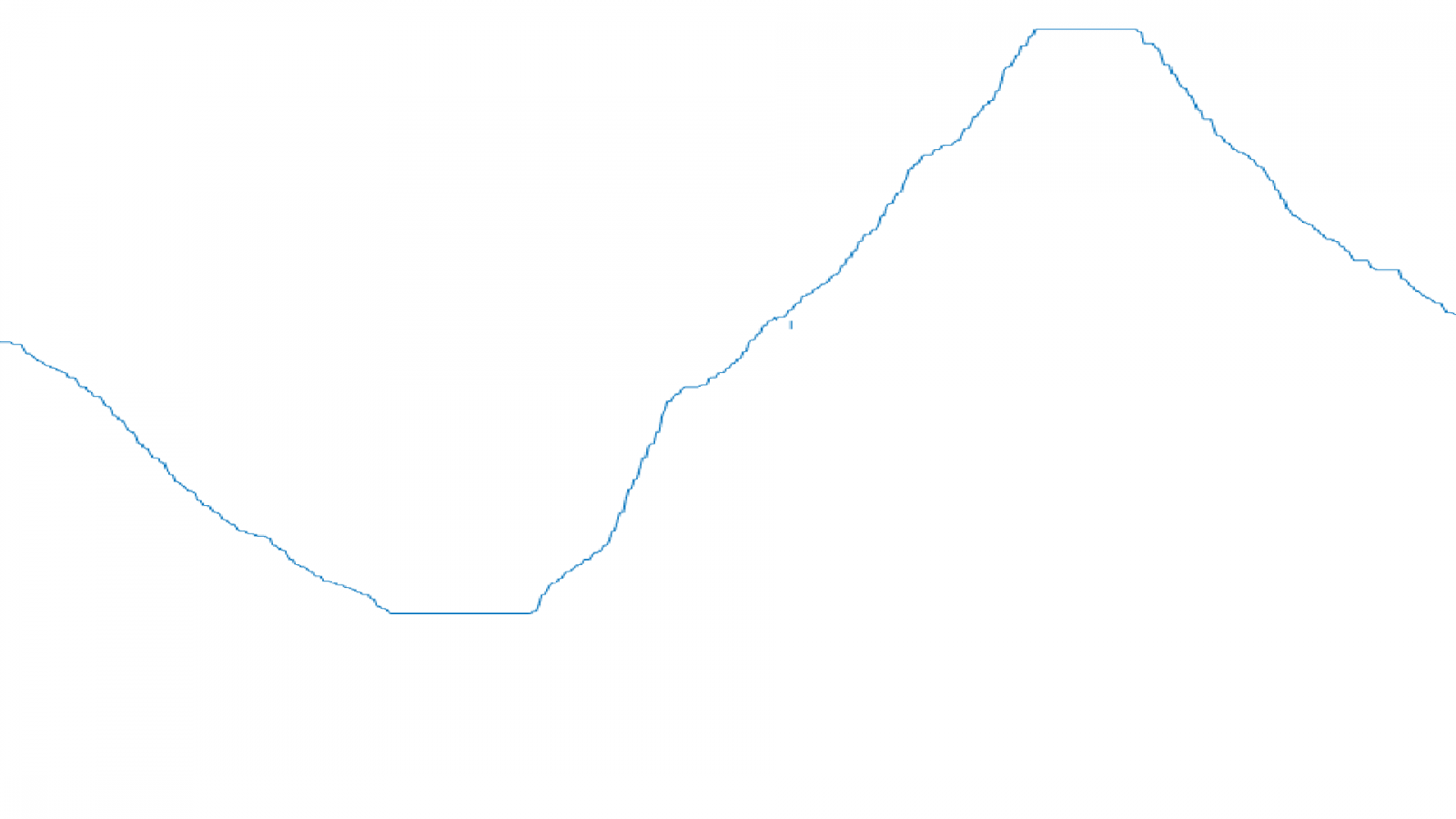

    I have a problem with the output data from simtools. I am trying to build a 3dof platform and I need the raw data from games. which means I want the exact roll pitch etc values from the game. I have tried to read the data from LFS and simtools both. here are the graphs :
    this is data from LFS directly :

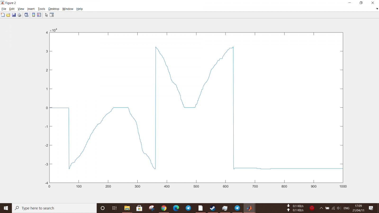

    and here is the data from simtools: (the left chart is roll & pitch positions and the right one is surge sway & heave accelerations :
    these are from fairly the same motions ( ofc had to run LFS twice but tried to keep it similar to each other)

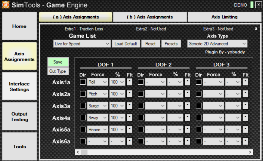

    the simtools data is very noisy and actually doesn't seem right. below is my axis settings :

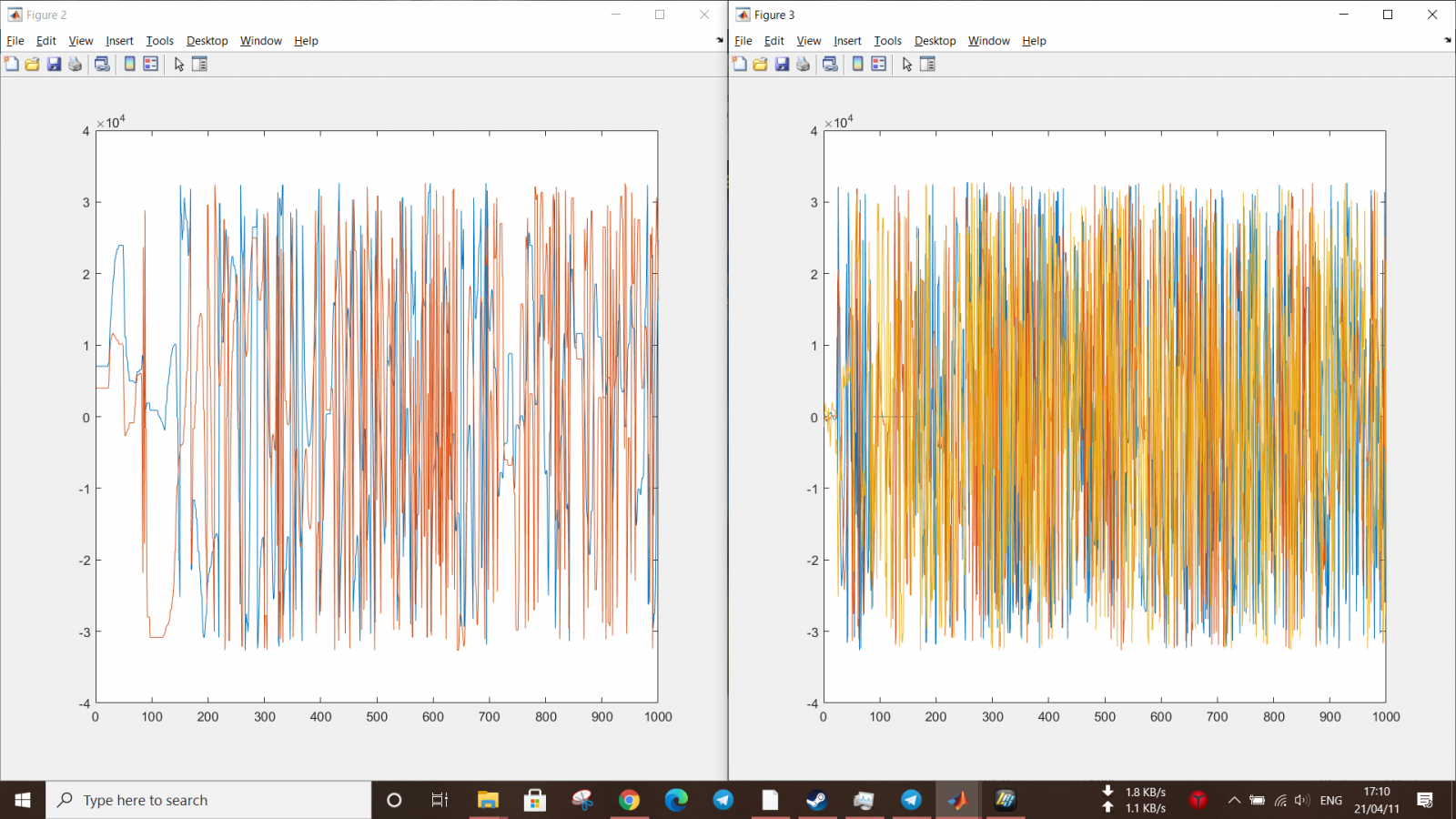

    the thing is I tried to check the output and see if the axis1a value is equal to the raw Roll value. so in the "output testing" tab I switched it on and captured the values. I dragged the bar from 0 to -100 then to 100 and back to 0. here is the result:

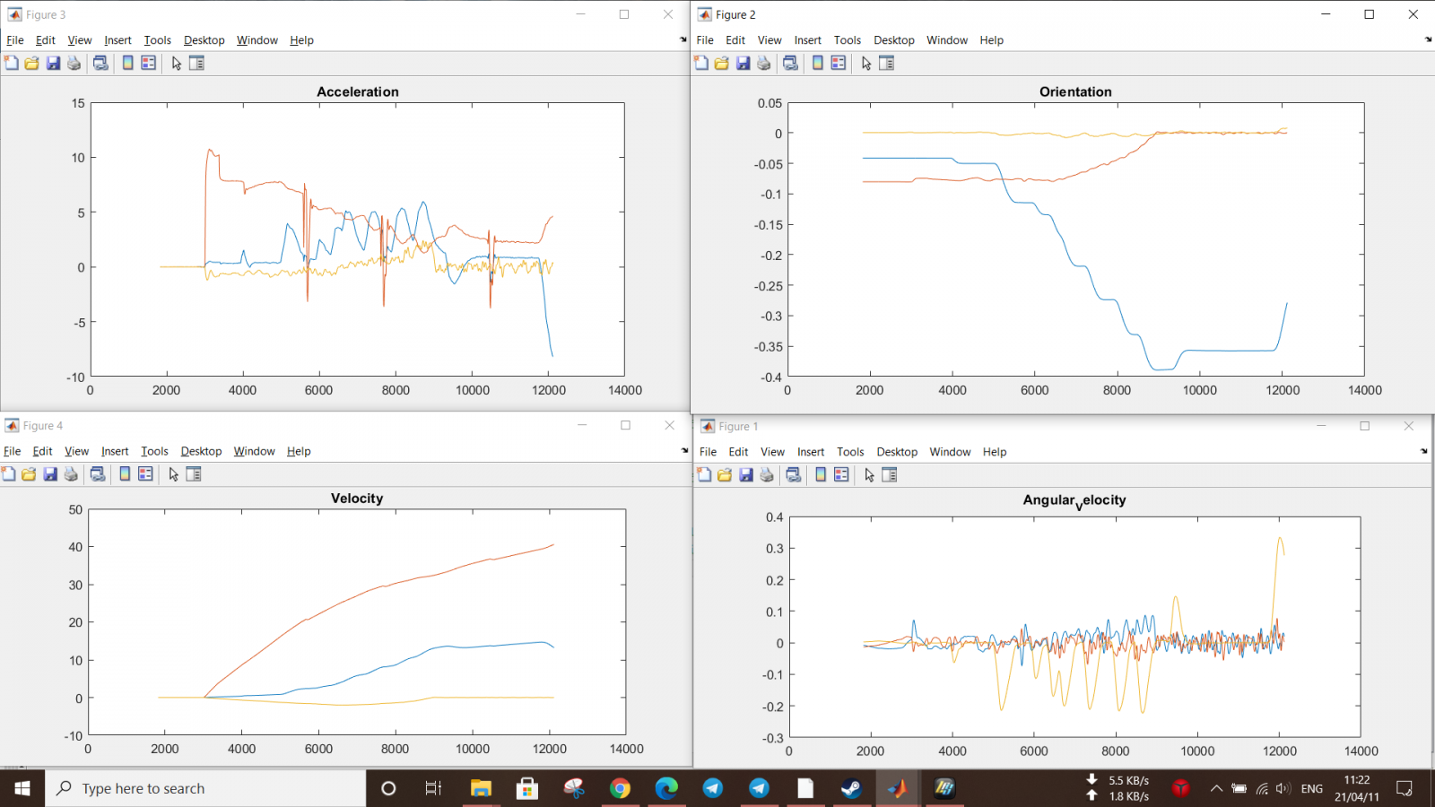

    as you see it is a bit scrambled. what I was expecting is this :
    to summarise it I should say generally there are two problems :
    1. getting the raw data correctly from the game (i wonder if it is possible)
    2. having it in the right format (like the latest picture not the one before it)

    All the outputs from the games are automatically sent thru the Max/Min stage before being handed off to the axis assignment settings.
    So the output from simtools will depend on your Max/Min settings for the game.
    I think what may work best here is to write a custom interface for simtools that knows how to communicate with your sim.
    For example, if you set the max/min to -180 and 180 for Roll, and then set Axis1a to 100% for Roll in your axis assignments.
    You can then in your interface forward the axis1a (Roll input - which will be a number between -1 and 1 at this point) as (Roll * 180) giving you a output you want that matches the game.
    Hope that makes sense.

    Without having even the slightest clue about SimTools, from the graphs you posted alone I get the impression that there might be two problems involved:
    1. Unit conversion (degrees <--> radians) and...
    2. A well intended (but for a car sim completely pointless) anti-rollover-function.
    I have analyzed plenty of motion data in my own software, and these two features in combination could explain those graphs.
    I would go one step further and say: If you told me that you were going to use a unit conversion from rad to degrees and are also using an anti rollover function that expects radians, then I would expect EXACTLY those kinds of graphs.
    First you should find out in which unit the game is sending values and in which unit SimTools expects then.
    Then disable the anti-rollover function if you can. This might not be possible, if it is baked into the plugin by the creator who had the best of intentions.
    Set the Min/Max values in Tuning center to a value that is significantly higher than any value you can ever expect to see on that respective channel. Just to be sure this doesn't interfere.
    And I hope you will post your findings here, because I would love to solve this.
    Cheers,... Dirty
  6. Dirty
    Oct 15, 2017
    736
    All the way up front.
    7,835Coins
    +864 / 2 / -0
    If you look closely, in this image...
    ...the values range from negative pi to pi (-3.14 to 3.14).
    AND they seem to "roll over" from neg pi to pi.
    Imagine if you sent values to this function that are 57.296 times bigger (thats the conversion from rad to degrees), you'd see 57.296 rollovers in that image and "57.296 rollovers" is pretty much what I see here:
    Does that make sense?
