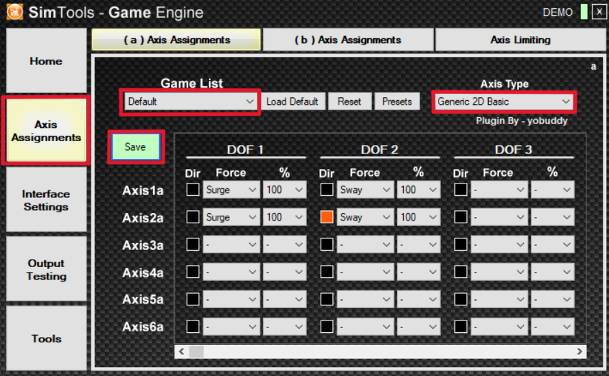

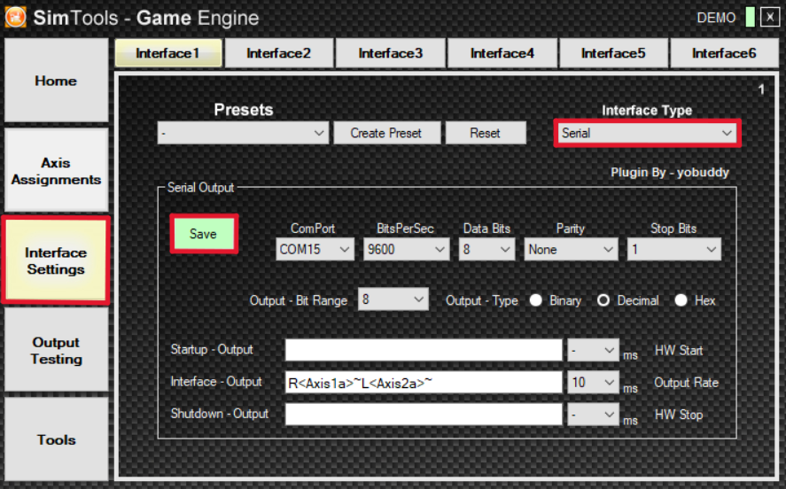

    Dear community
    I'm making a motion simulator prototype using an Arduino and a steppermotor.
    Whenever I startup 'Output Testing - Axis Testing' or Live for Speed, the motor starts moving randomly without responding to the sliders at all. This is because random values are being sent to the Arduino. If I check 'Output Testing - Virtual Axis' while playing LFS, everything looks normal.
    The code I use is a modified version of RCModelSimtools by eaorobbie. I use the same settings necessary for using said code.
    I can't seem to figure out where the random values come from, let alone how to make them stop interrupting with my prototype. It may have something to do with dotNET SDK. Since after I downloaded it, everything worked fine until I had a lunch break and came back. Without touching my computer or changing anything else, the behaviour became random once more.
    I don't know what to do, please enlighten me with your knowledge. I tried reinstalling Simtools and everything dotNET-related as well as turning off selective suspend USB.
    PS: This project is school related and should be finished by friday :/

    Thank you for responding so quickly. I've tried lowering the percentages but sadly, the same problem occurs. If you'ld like to see the problem in action you can search for Kilimoenipa Pointser on youtube and watch the video called 'Simtools problem random data'.
    The OLED-screen shows the first couple of mapped positions (0-25 equivalent to 0-180°) being sent to the Arduino. As I've stated before, the setup did work for a bit. It even responded as one would expect while playing Live for Speed. Using a stepper is in fact more challenging than using a servo but I don't think this is relevant to the problem at hand.
