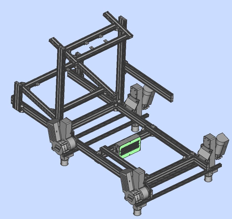

    A little over a year ago I built a 2dof motion simulator that has been running great, however I have been wanting to build a 3dof simulator for sometime but didn't have the right inspiration.
    https://www.xsimulator.net/communit...uilt-with-slim-tarp-motors.12923/#post-171607
    Recently I observed the SimRig SR1 motion simulator platform, which uses worm gear motors to drive what appears to be a rack and pinion system. It looks very efficient and affordable.
    It has 70mm of travel and uses a 500w power supply with a max payload of 175kg. Guessing they are using around 120 watt motors.
    I am thinking with better motors (150 watt plus) I would comfortably be able to do the same thing and either step up the payload, or speed.
    My research so far has lead me to believe a JR dragster rack and pinion would do great.
    They have 3.5 in of travel (90mm) and lock to lock is achieved with 7/8th turn.
    https://www.arcracing.com/1401-rack-pinion-horizontal/
    This leads me to believe that a 100 rpm motor will achieve around 100+ mm/s of travel.
    What results has anyone gotten with a similar set up and what suggestions does the community have if I were to go this direction?
    Big questions I have are:
    Motor wattage?
    Motor Speed?
    Motor Torque?
    Best way to mount together?
    Thanks again for the help/support.

    I am confident in this format. It seems simple and easy to replicate.
    I think we should do an open source project "based" on Simrig Sr-1. We will use 3d printer, aluminum openbuilds and engines common to be found all over the world (truck cleaners).
    What do you think of the idea?

    I think the rack and pinion design is overlooked
    There is a type with 2 racks opposite each other and has double the movement ;)
    Its also cheap to buy the rack and gear
    A steering rack may be suitable and some of them are already electically powered

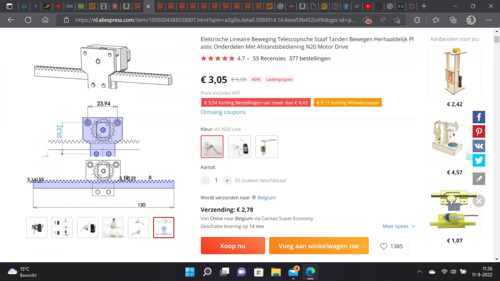

  14. Gadget999
    1,977
    12,066Coins
    +488 / 10 / -0
  15. Benmk1
    Benmk1 New Member
    Mar 25, 2023
    18Coins
    Why the double rack?
  16. Gadget999
    1,977
    12,066Coins
    +488 / 10 / -0
    Longer actuator lengths
  17. Benmk1
    Benmk1 New Member
    Mar 25, 2023
    18Coins
    But doesn’t that means you need about double the force?
  18. Gadget999
    1,977
    12,066Coins
    +488 / 10 / -0
    Use a different gear ratio
