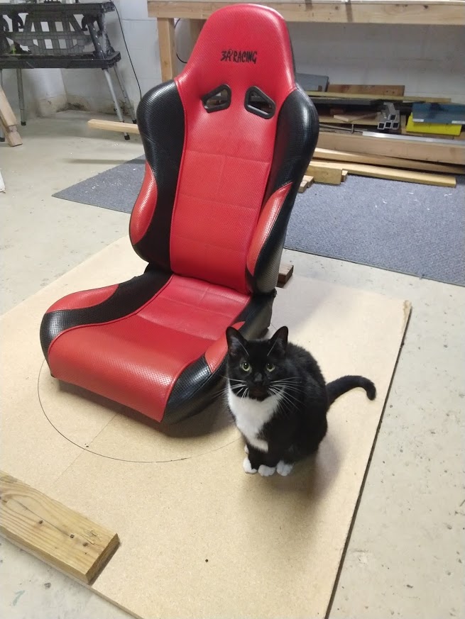

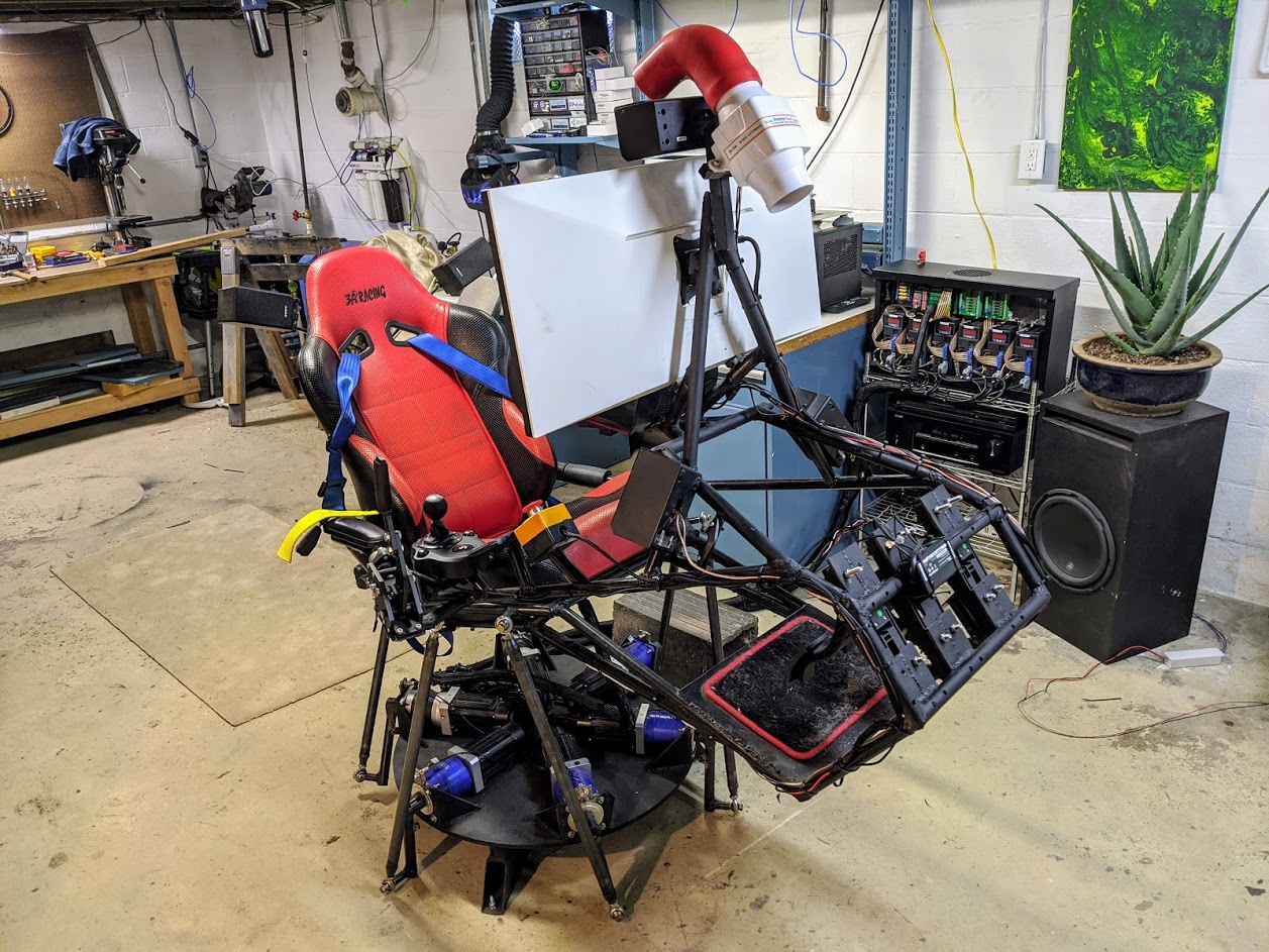

    3A racing seat - I got it for $50 off of Facebook marketplace...~25lbs. Its was originally adjustable back, though I welded it together for more strength as I did not trust the back.. not collapsing. This fit the requirement of cheap and have the harness/belt through holes above the shoulder. I may invest later on a nicer one,.. as this one went through the fabrication process along with the motion platform... and now has.. many burn holes....

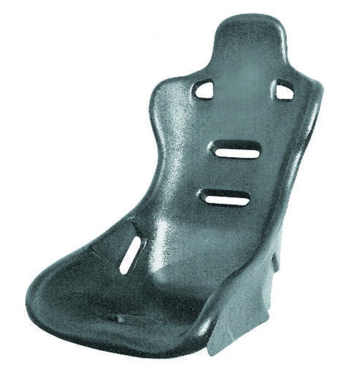

    I sold my race seat with the race car so I think for my sim I'm going to try the Jaz Turbo Pro. It's about $110 USD. I thought I read that it only weighs about 10 pounds or 4.5 kilos but I don't remember where I read that.

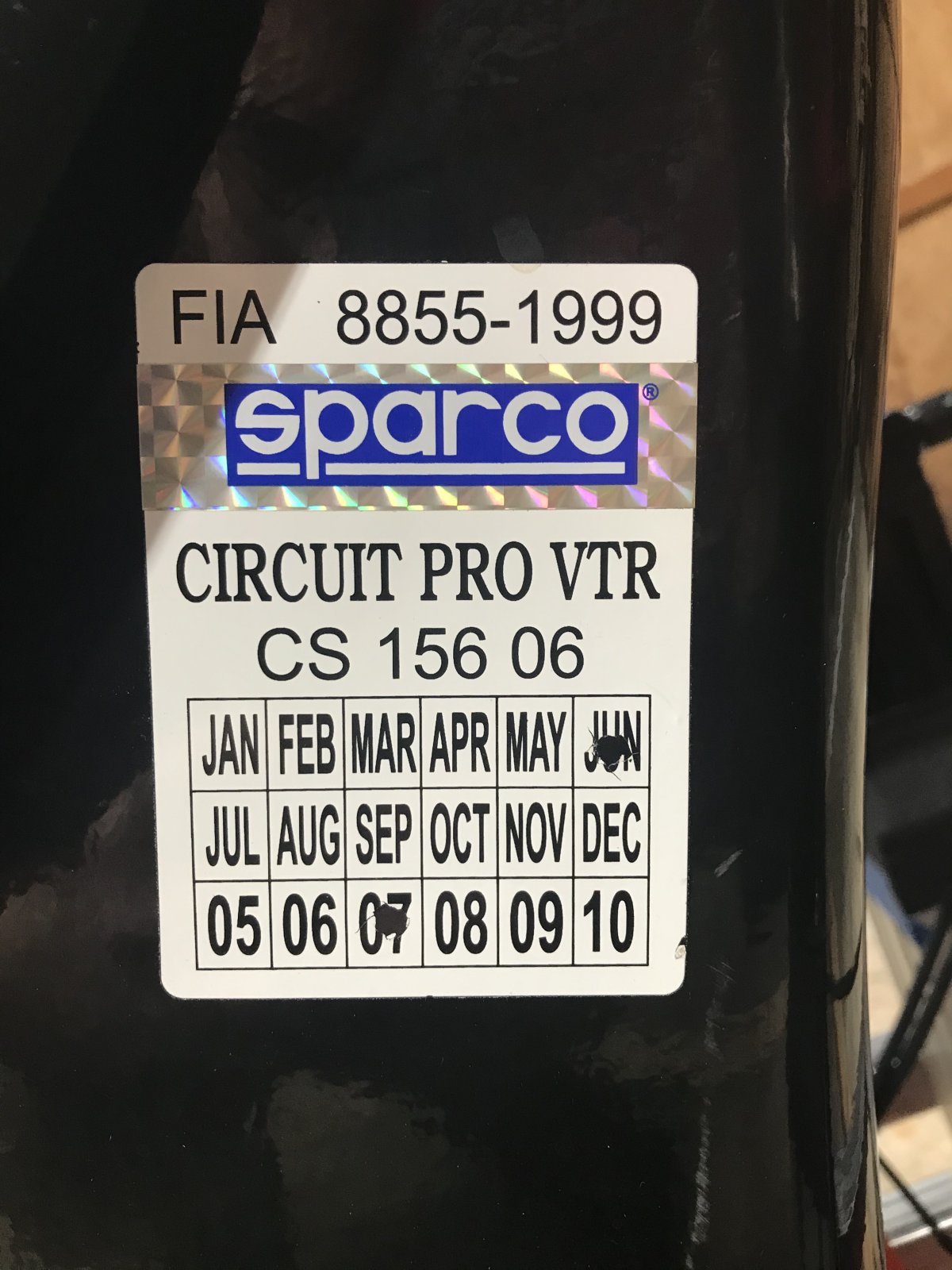

    If you want a proper racing bucket seat, used is a really good way to go. Racing seats eventually "expire" (vibration, sunlight, and chemicals eventually weaken the shell, and newer seats have newer safety regulations), making them ineligible for competition use. At that point, they're basically garbage to a race team but will work just fine for sim racing for many many years.
    I'm using my old Sparco Circuit Pro that expired in 2007. Hasn't cracked on me yet, but I just added motion so we'll see :p
    Because these seats have a limited life, I have seen some just completely torn up. You can buy replacement cushions and covers for a lot of expired seats, or take it to an upholsterer.
