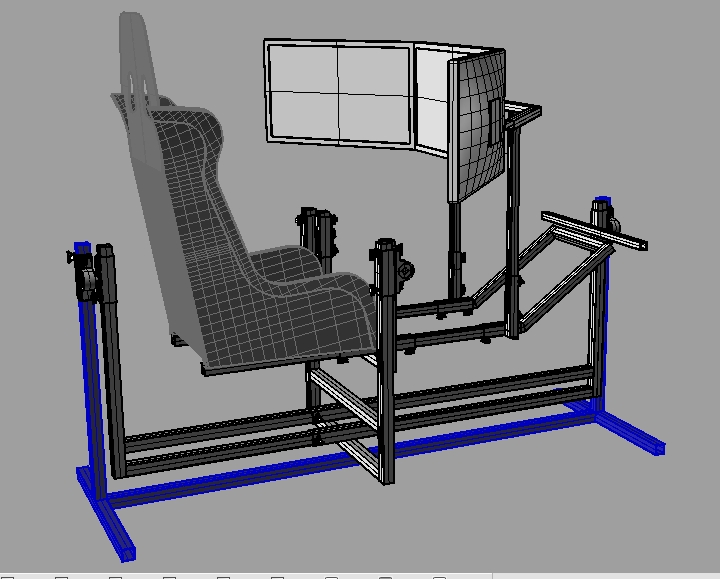

    Hi all.
    This is the beginning thread of the construction of my proposed Motion Simulator.
    I have been researching the web and particularly this forum for a while now, and have now
    settled on a design brief that suits my needs.
    I wanted a sim that offered a reasonable amount of pitch and roll. This will hopefully
    allow me to have a sim that is suitable for iracing as well as flight sims. (Also I dont want shake the guts out of the monitors!)
    I will be constructing everything myself.
    Electronics: Motion control - AVR Motion Controller (AMC) by Tronicgr
    Frame : from thin walled RHS steel tubing
    Seat: Ply seat - Seat design by Deriy
    Wiper motor motion: Similar to Erichan Cessna flight sim
    I will be posting the construction progress as the project takes shape.
    Here is pic from the CAD model of the proposed sim.
    As you can see I have made an effort to make the mechanical system completely adjustable.
    This should allow for fine tuning of the centre of gravity, both vertically and fore and aft.
    I may at a later date provide a adjustable counter balance for those occasions when someone other than myself is using the sim.

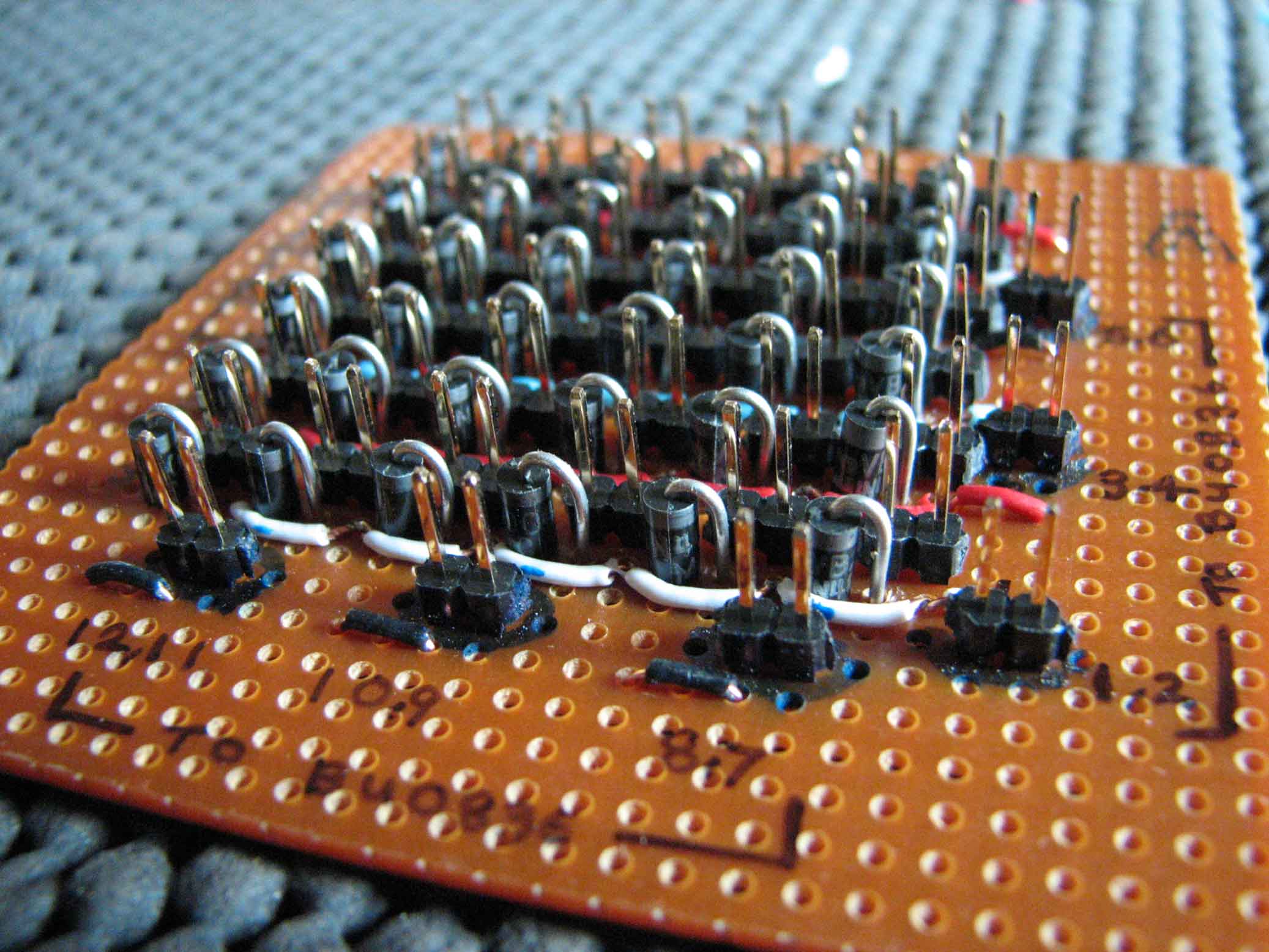

    I have made up a 32 switch input matrix (plus hat switch) that will interface all 32 switches to the Bodnar BU0836-LC.
    This card allows all pairs of wires from each switch to plug into this board using standard header plugs of RC servo type plugs.
    Easy to add a switch or button - just plug it in.

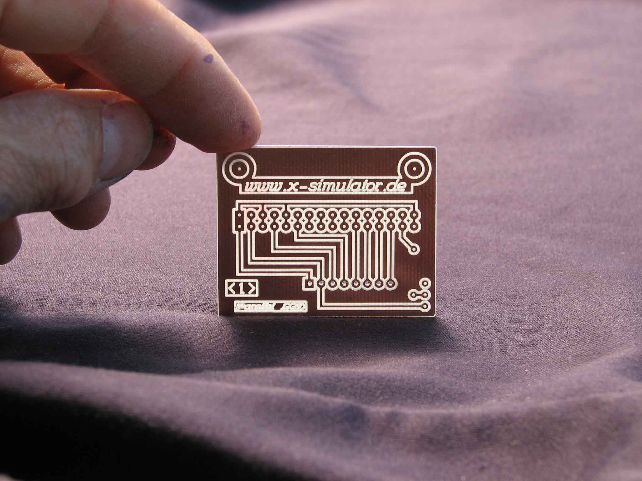

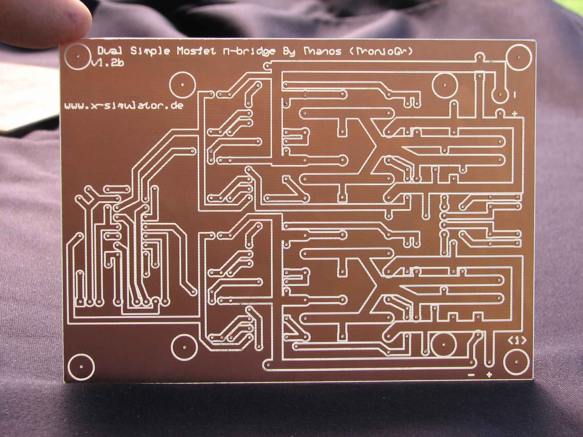

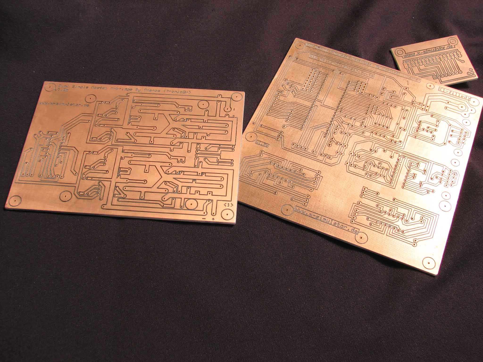

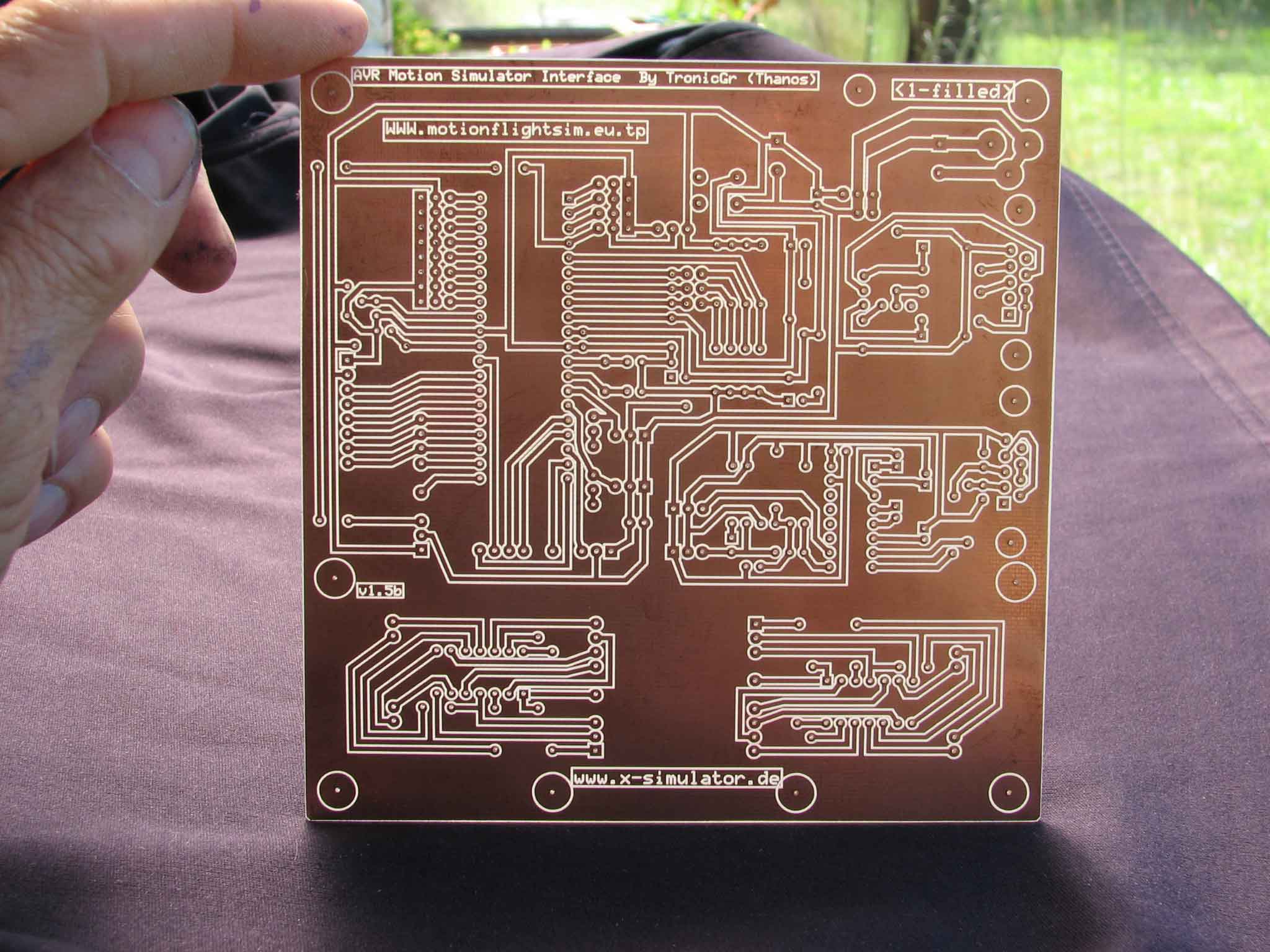

    Just completed the engraving of the PCB's
    I used a CNC router rather than etching. I drilled 0.8mm holes using the cnc, and will manually re-drill any holes that need to be bigger as the need arrises when assembling the board.
    Bruce

    I have noticed that on another thread that a few PCB builders would have liked files suitable for engraving the PCB's as per the previous post.
    I have tried to attach the DXF files of the Controller, H Bridge and LCD board in this post, but the forum will not allow me to attach a DXF to this post. :(
    If anyone would like these DXF's I can email them directly to you - just Message me.
    Please note, These are my own conversions of the original PDFs, please double check them before you use them - I have been known to make a mistake now and again :D
    I redrew most of the track lines to make it suitable for CNC engraving on my CNC machine. The idea was to remove as little of the copper as possible. The boards shown in the previous post wer cut using these files.
    The AVR Controller Board DXF is suitable for engraving with a 60deg engraving bit, with an on-line cut 0.1mm depth of cut.
    The LCD Board is engraved in a similar manner.
    The H Bridge Board is suitable for a profile cut with a 0.1 offset (bigger) with a 60 deg engraving bit , 0.1mm depth of cut. ( this makes the tracks slightly wider. Note that some of the tool paths will overlap slightly, but this is OK as it is removing the copper between the tracks anyway!
    If you are able to drill the track pads with the CNC with say a 0.8mm drill it will be easy to enlarge some of the holes by hand during assembly of the components.
    Hope this is of some use to anyone with access to a CNC Machine.
    Bruce

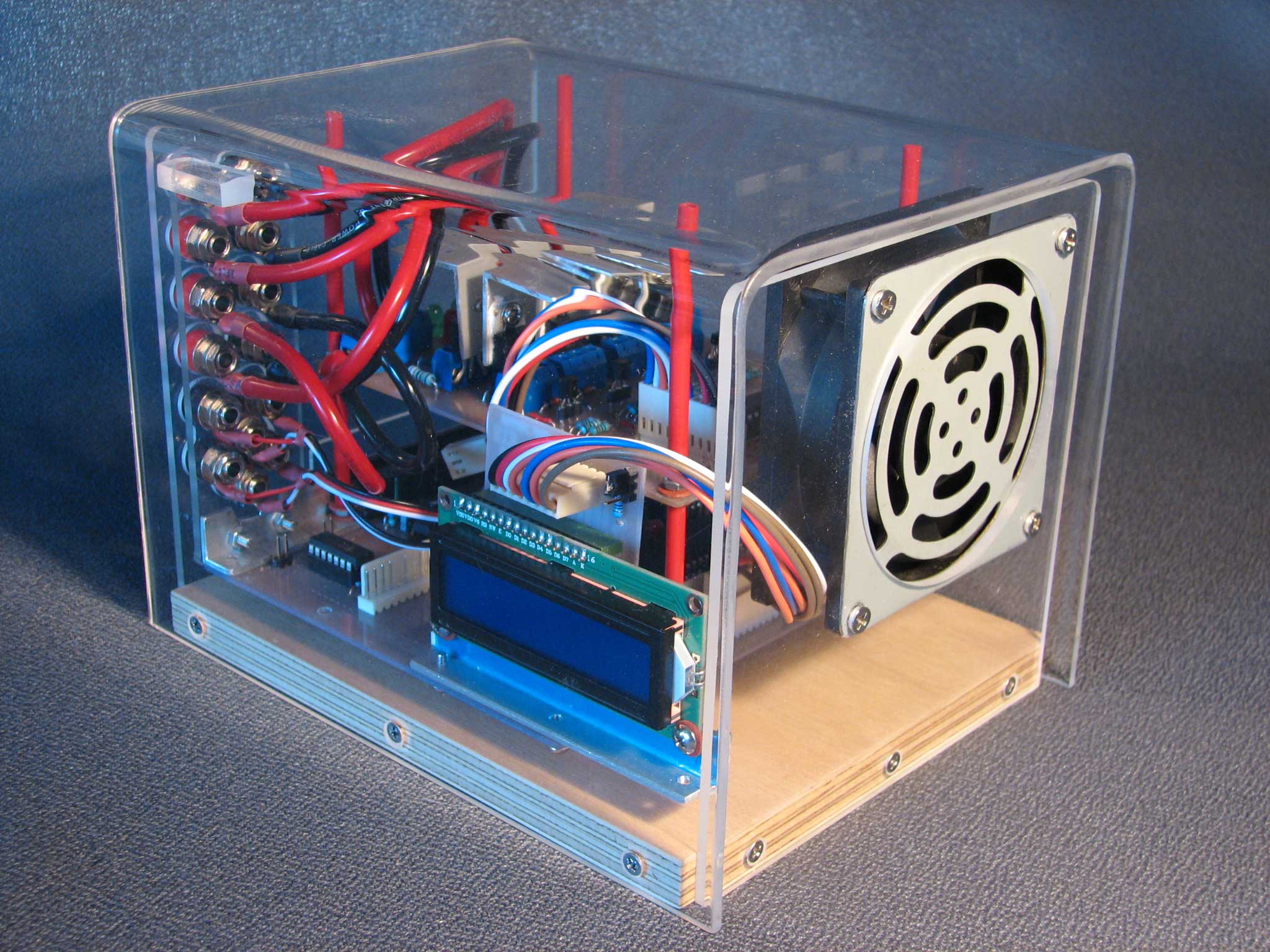

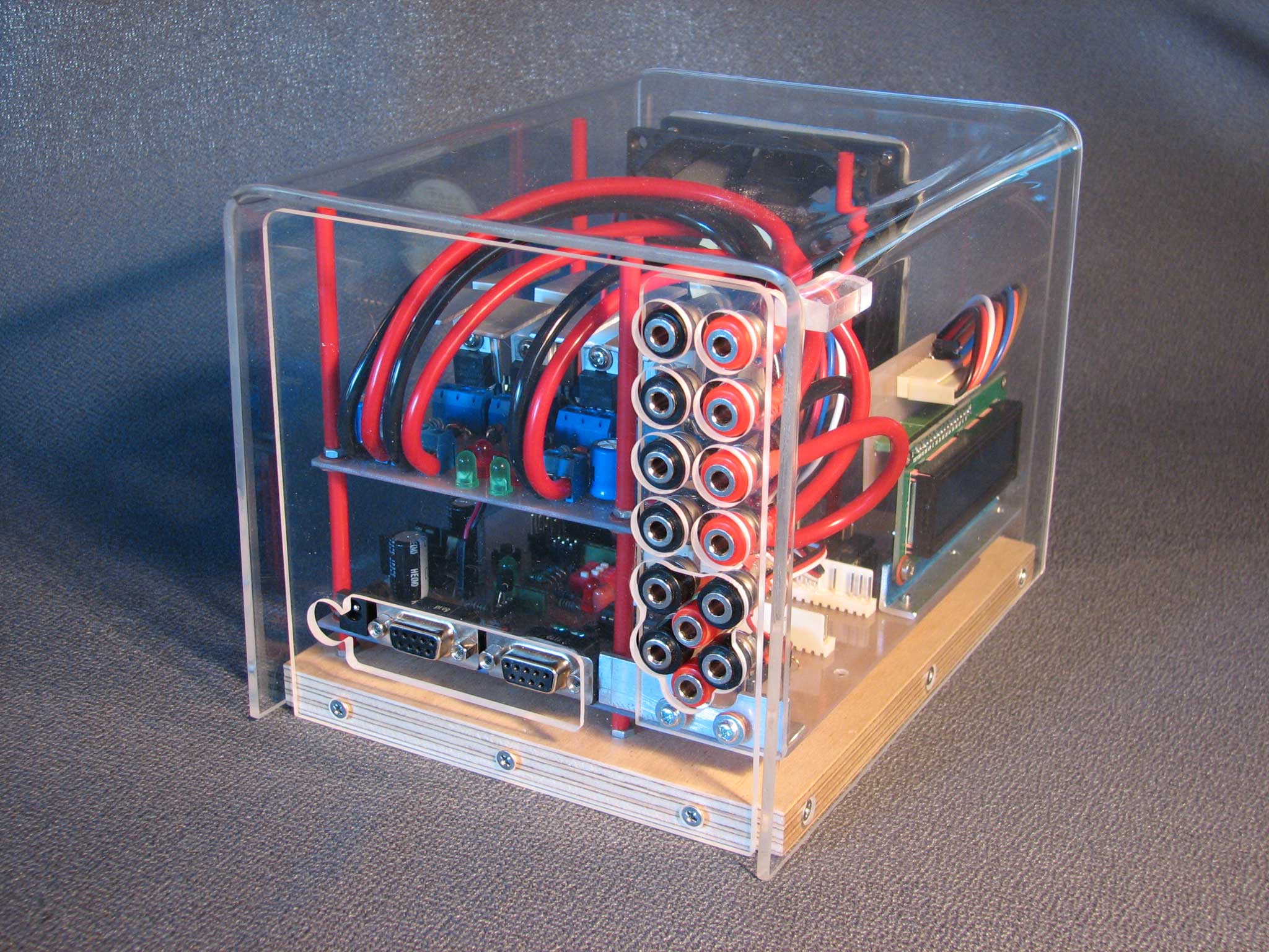

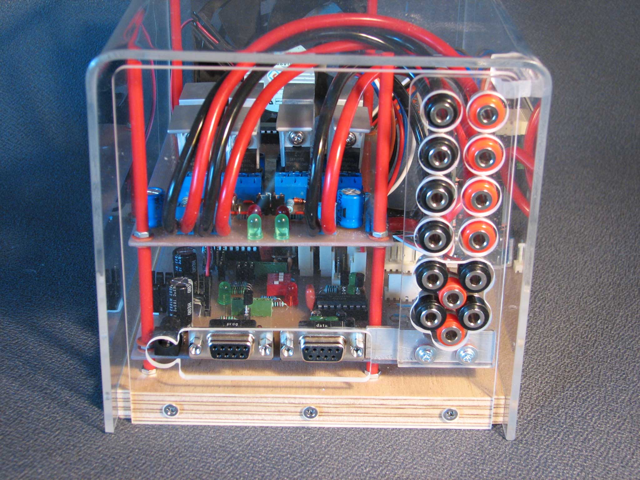

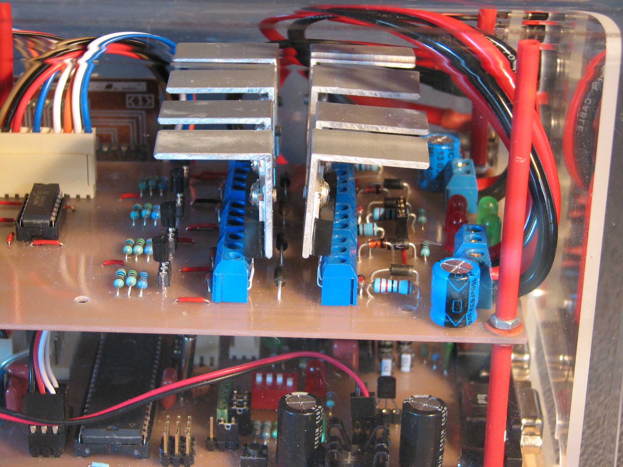

    Finally got the AMC up and running after a few teething problems of my own doing.
    As you can see I have housed the original AMC 1.5 in clear acrylic - sort of an electronics sculpture :)
    At least you can see whats inside!
    I have built the whole shibang with all the spare outputs and redudencies etc... - expansion??
    After all the problems I had getting my first AVR running it is now very satisfying to see it has all worked out fine.
    (All the problems were from one tiny track I missed in my Cad files for the PCB)
    Thanks for all those who gave me a push in the right direction. I have learnt heaps about AVRs on the journey.
    Now it onto the next stage of construction. :cheers:

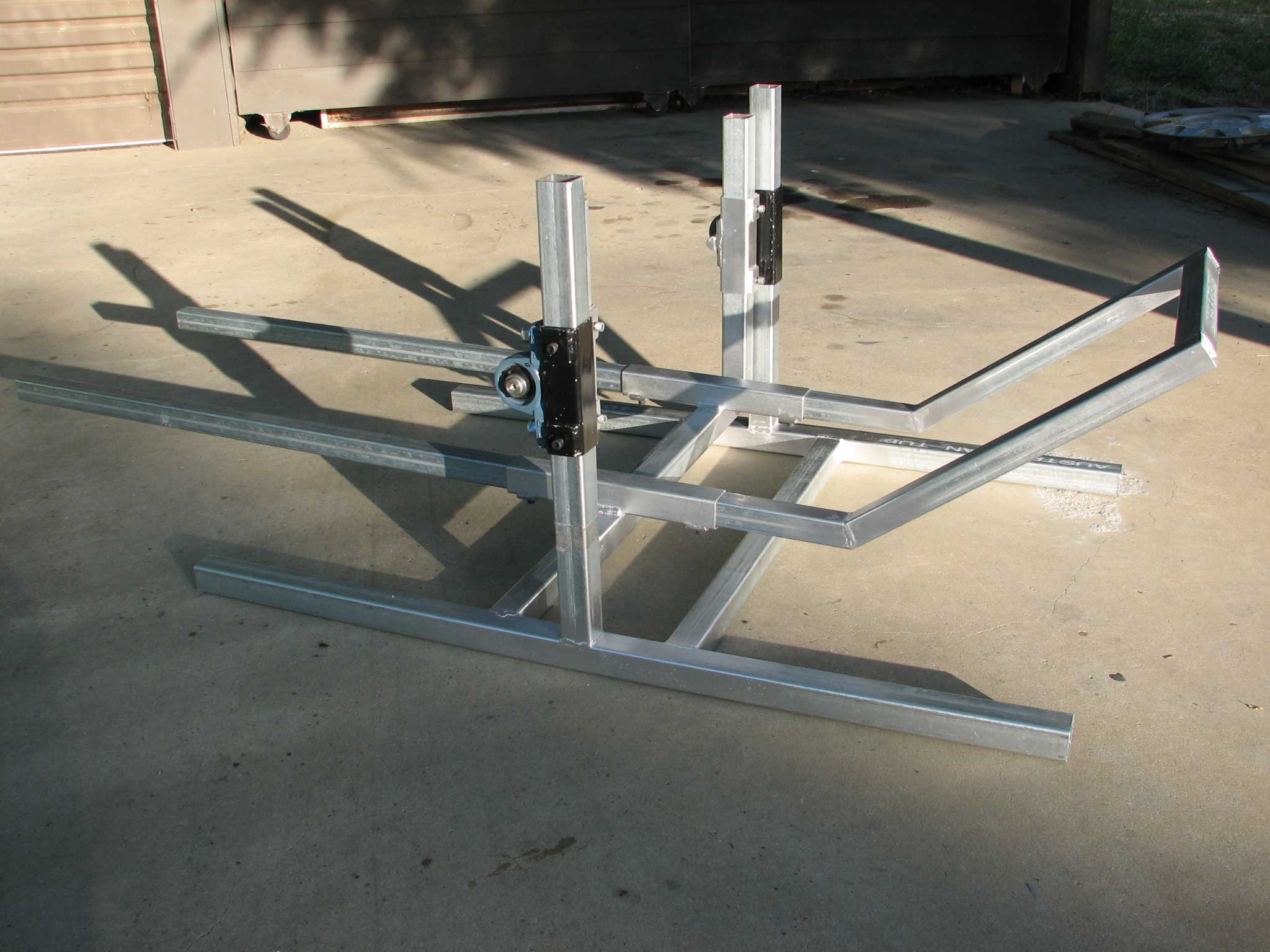

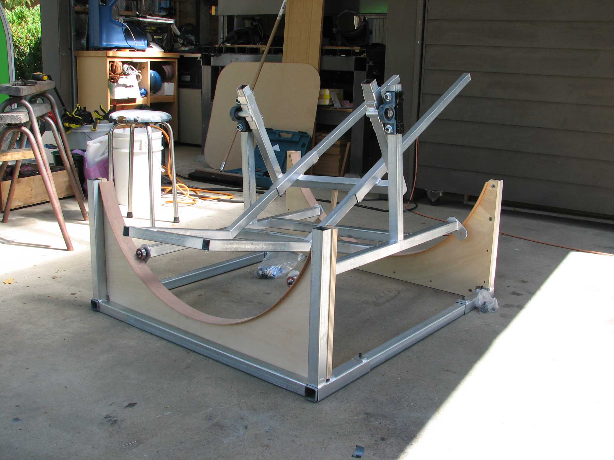

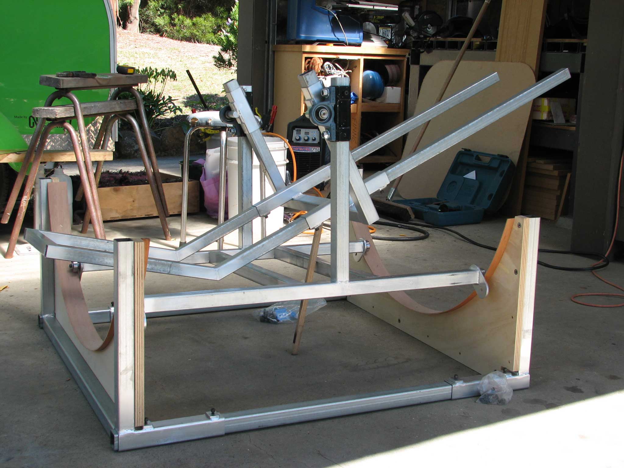

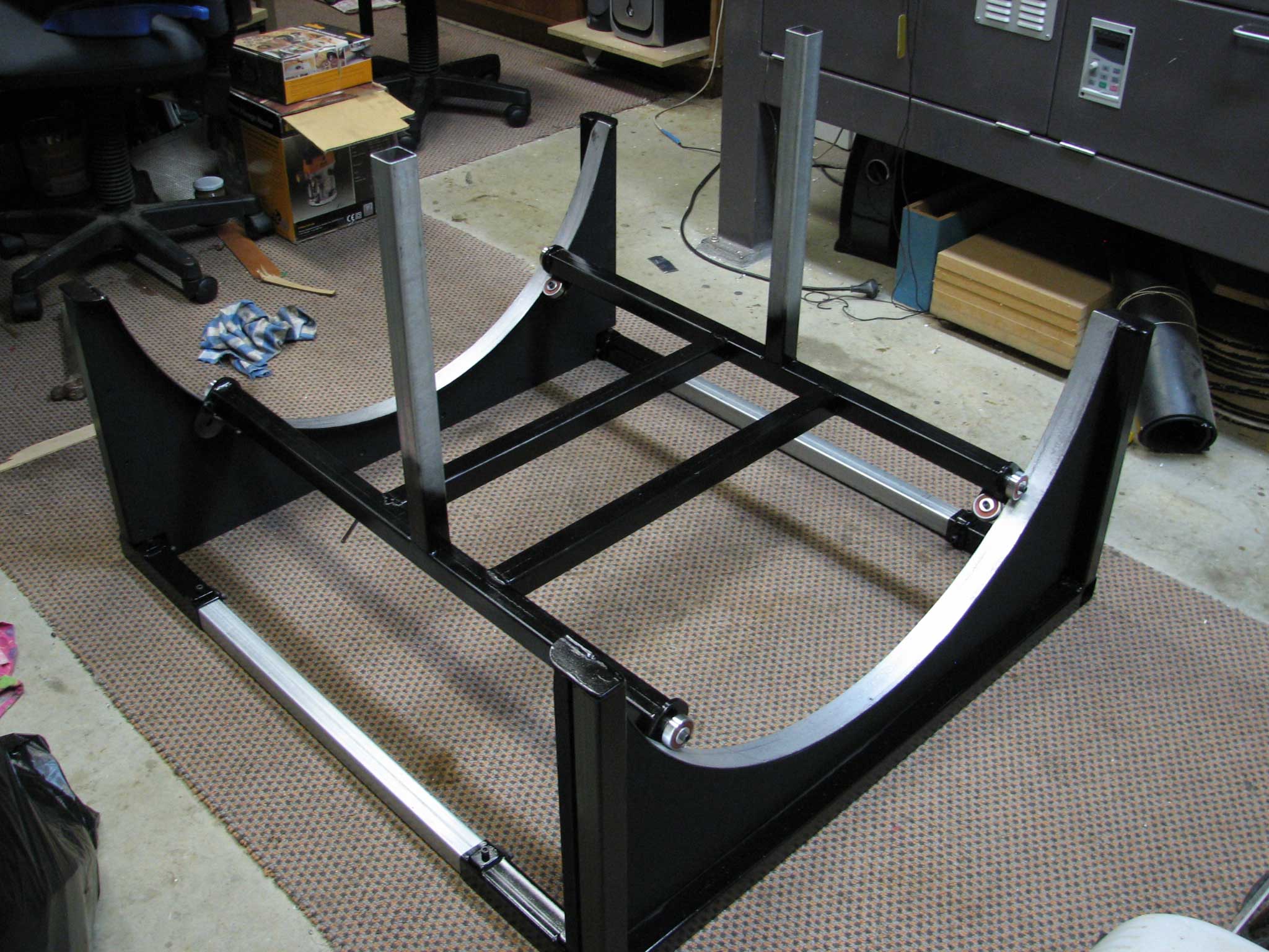

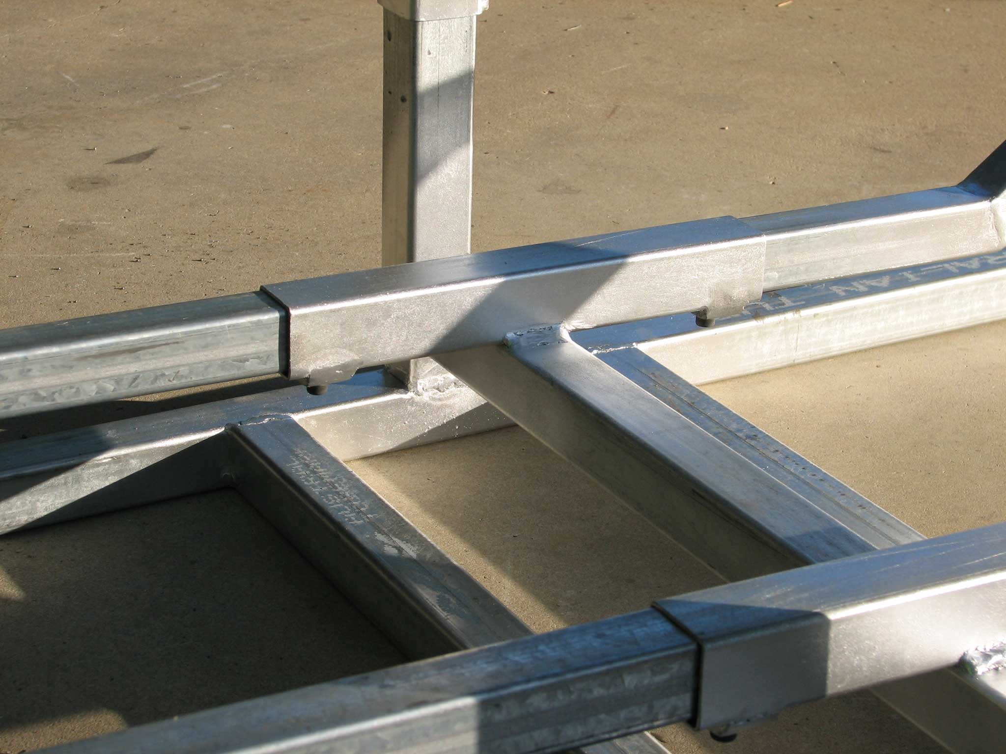

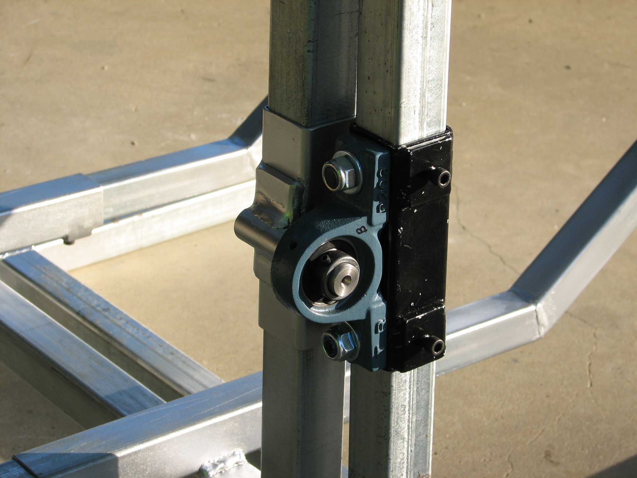

    Started construction fo the Sim Frames.
    (Note : I have modified my roll axis ideas - this will become evident in future posts.)
    The pitch frame is identical to my original design. You can see some detail of the adjustable balance/ pivot points that I have
    incorporated. This will allow me to fine tune the balance on each axis and minimise the static loads on the wiper motors.
    Once everything (including the me) is assembled and balanced, the excess steel will be trimmed off.

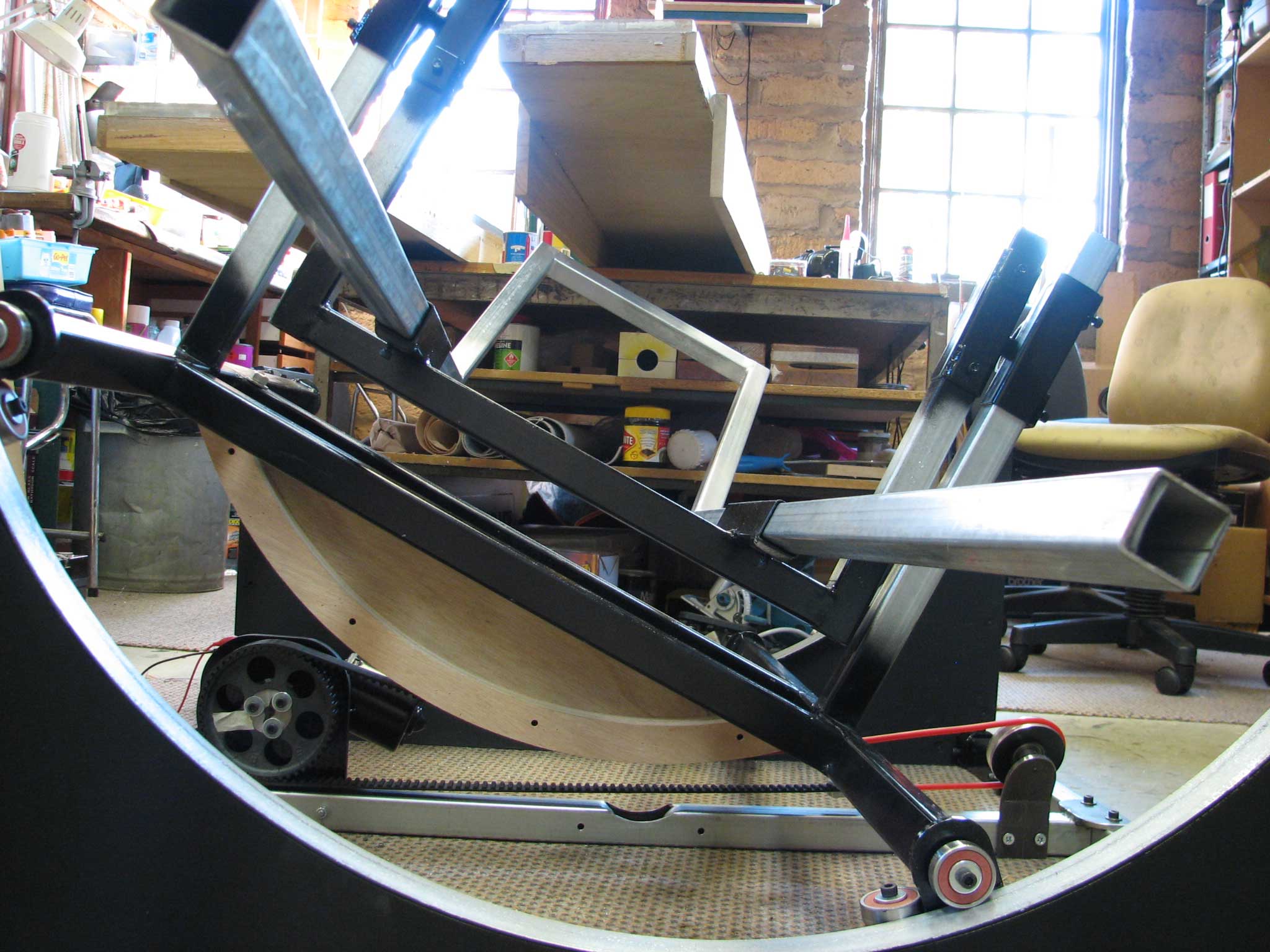

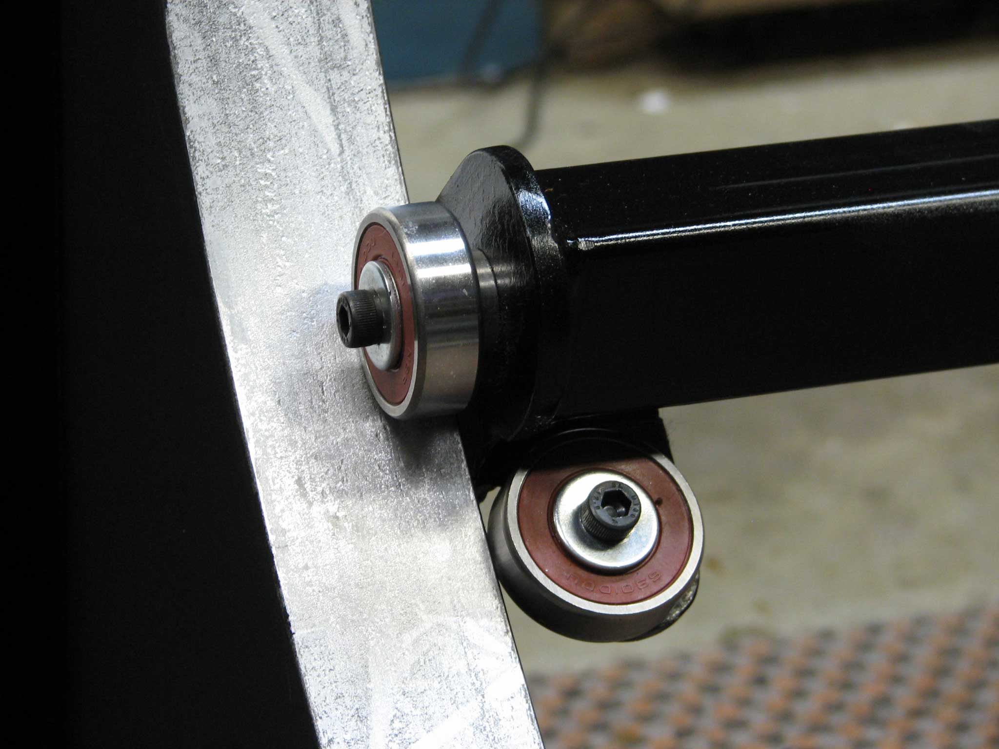

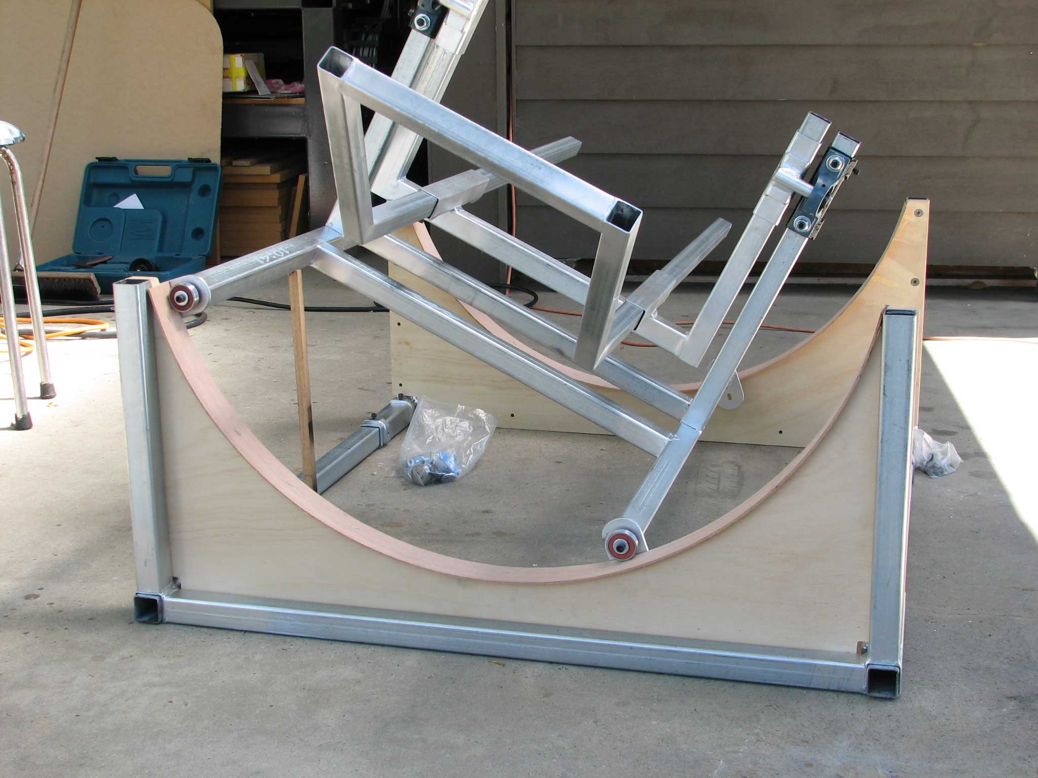

    Progress on the Roll Frame bearings.
    The bearings will roll on a steel runner (where the 3mm ply is in the photos). Another 2 sets of bearings will be fitted under the runner and on the edge of the runner to make the roll frame captive. The runner will be rolled to accurately conform to the arc required.

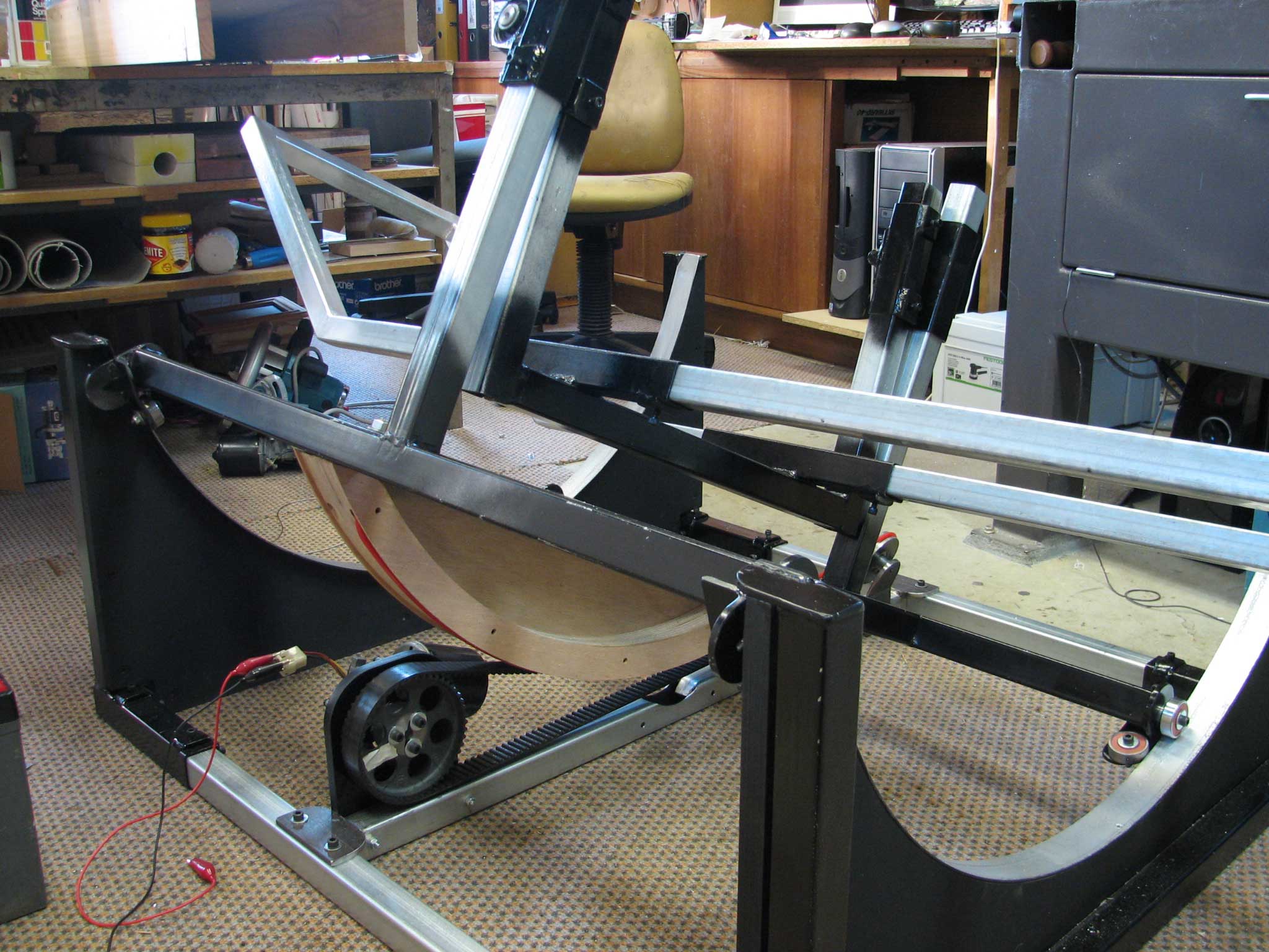

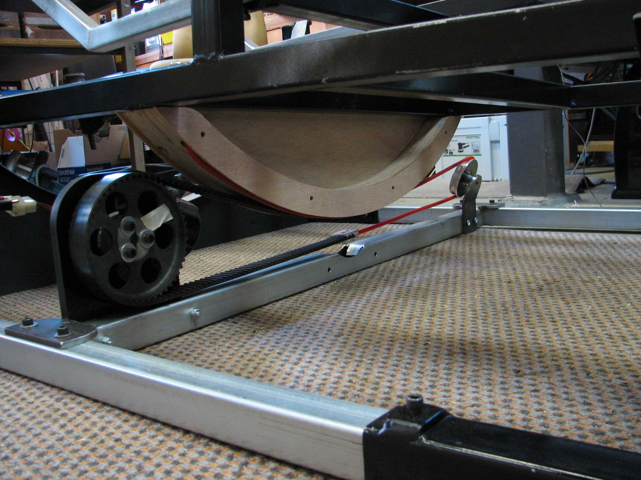

    The next challenge is to implement the motor/belt drive system onto the roll frame.
    I have an idea I am working on, which will not introduce any slack in the belts as the angles change. I should be able to use the same system on the pitch axis as well. I will always post to the forum when I make progress.
    I have more or less completed the roll axis bearing system last night. I did not roll the flat bar as intended. Instead I cut an accurate male former sized to the radius less the thickness of the flat bar. Using clamps I then pulled the flat bar into the curve using the curved former. Once in place I then welded the ends to the main frame. (not to hard to do requires accurate formers etc.)
    Bearings hold the frame captive. Provision has been made to add another bearing under the rail to hold the frame from lifting ( this may not be needed)
    The frame does roll very smooth and free! :D

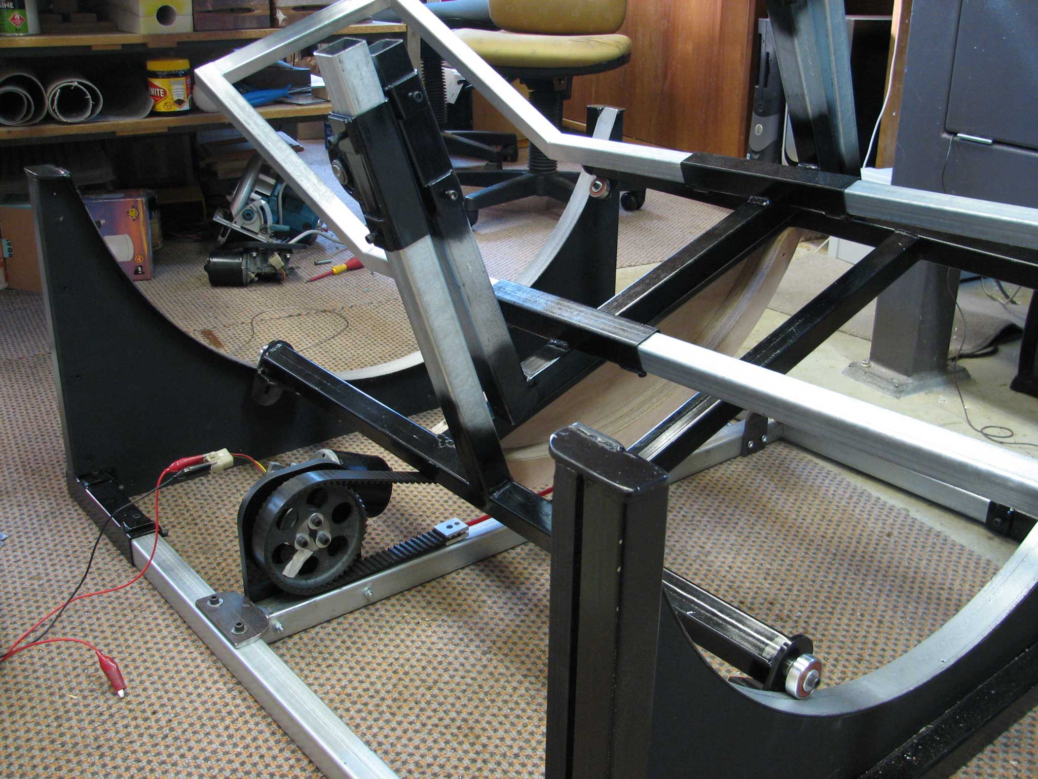

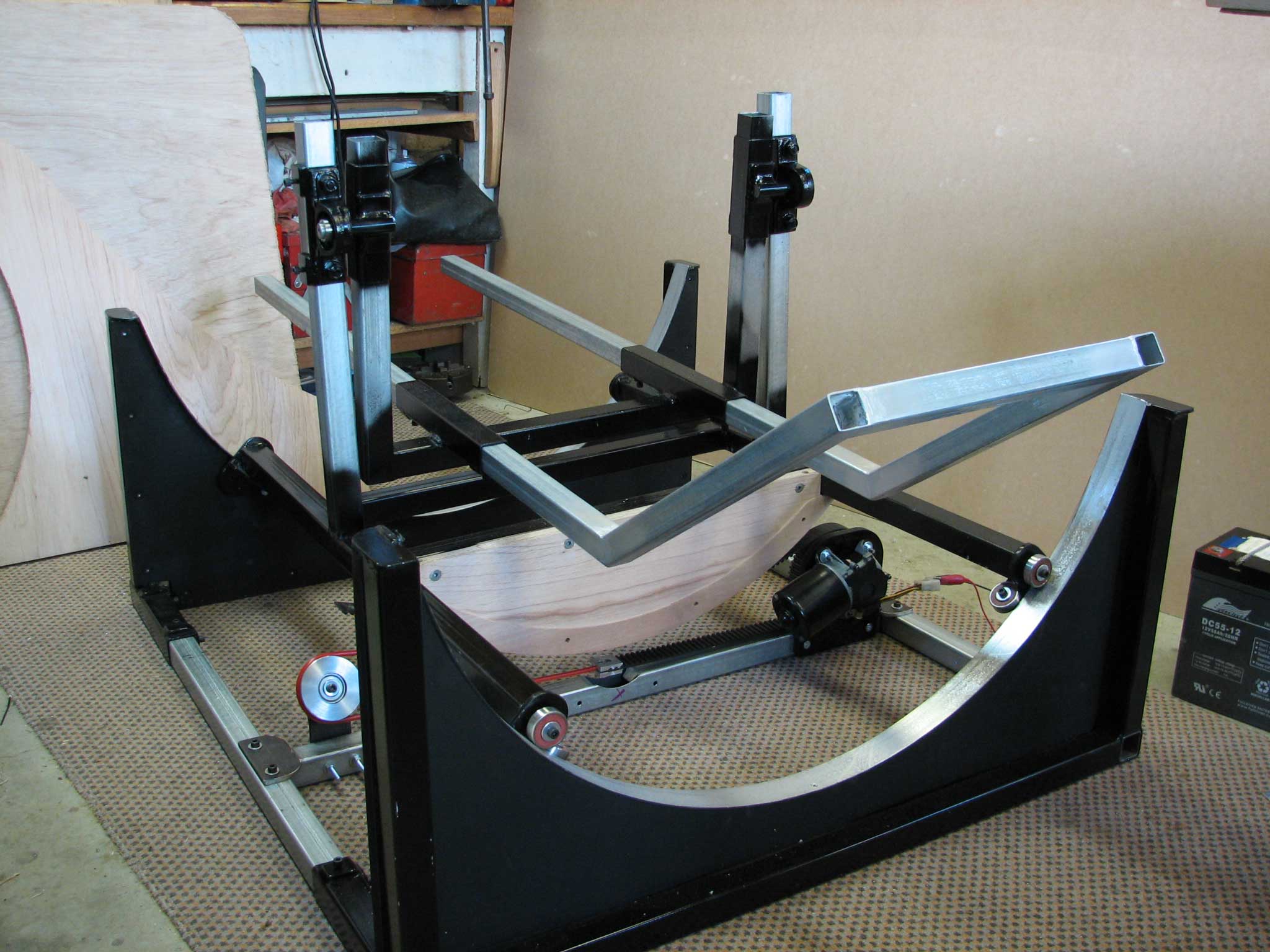

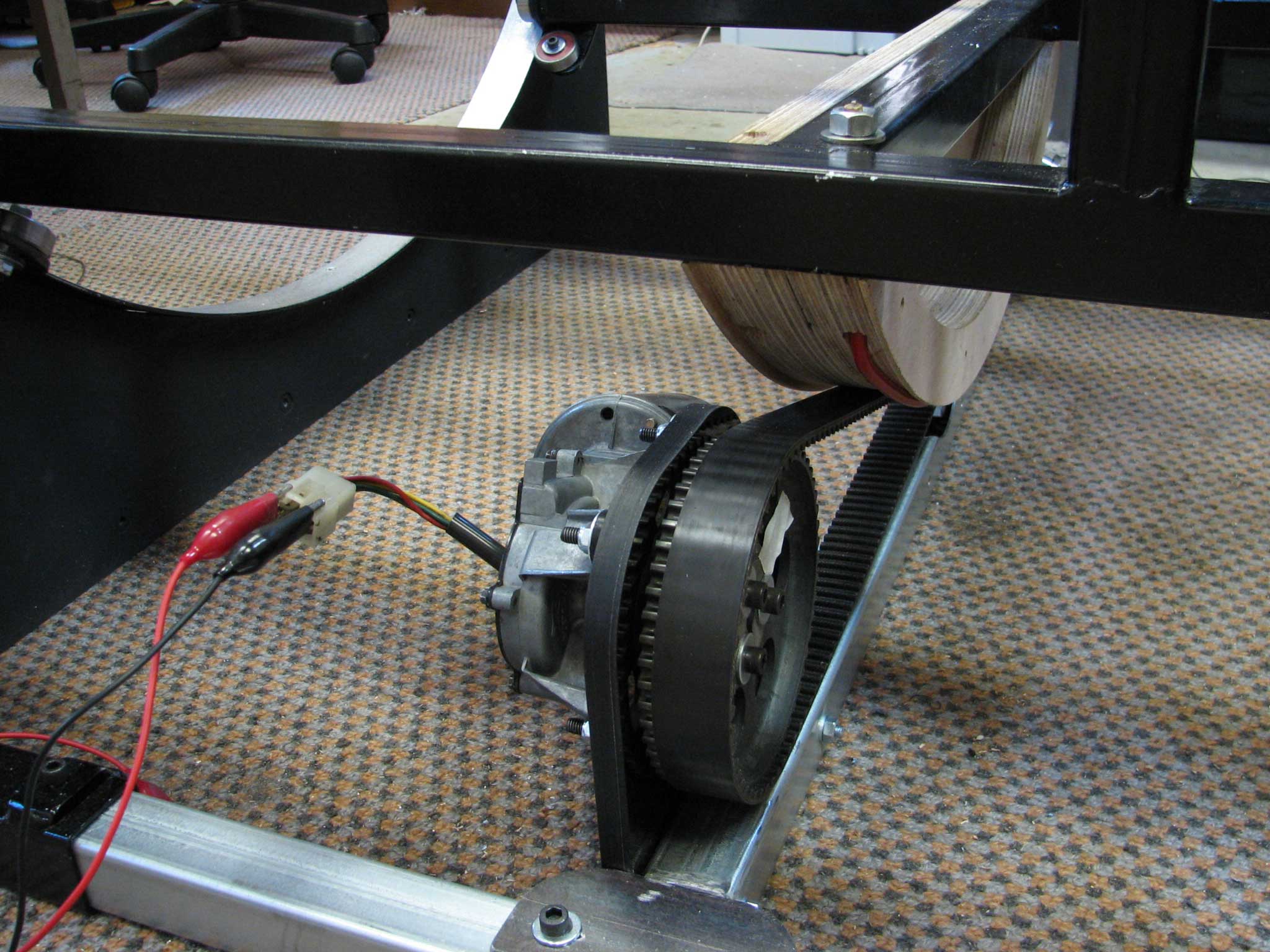

    I have made some progress on the Roll Axis motion system. :clap:
    The system I have used does not introduce any belt slack as the frame rotated. The plywood belt guide has been cut to the same radius as the center of rotation. The and play can be adjusted via a thread and nut system at the cable end.
    (note - the pulley angle needs some minor tracking adjustment)
    The red polyeurethane round belt is sleaved over a stainless steel cable. I am hoping the wipers will have enough power when every thing is assembled and balanced. If not I may have to find a smaller timing pulley or use some more powerful motors (thanks bfst).
    The roll axis is certainly very responsive with the 120mm pulley but the motor only rotates about 1.25 turns from end stop to end stop. (I think I recall somewhere that about 3 turns endstop to endstop is better for wipers?? - although this would make the movement allot slower)
    I will be a relativley easy job to mount larger motors if required.
    More experiment to follow :)

    Done a bit of an online search to find out the torque that can be delivered by a wiper motor.
    Apparently a average wiper can deliver about 13.5 to 17.5 foot pounds (18 to 23.5 Nm) of torque running on 12v. They also draw about 14 to 16 amps when stalled? Please correct me if I am wrong? ( nearly always sometimes I am wrong! :yes: )
