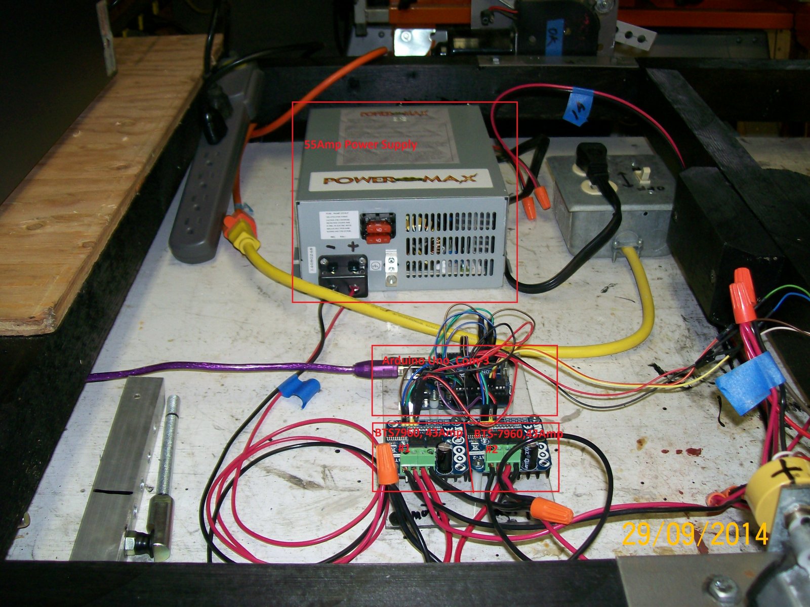

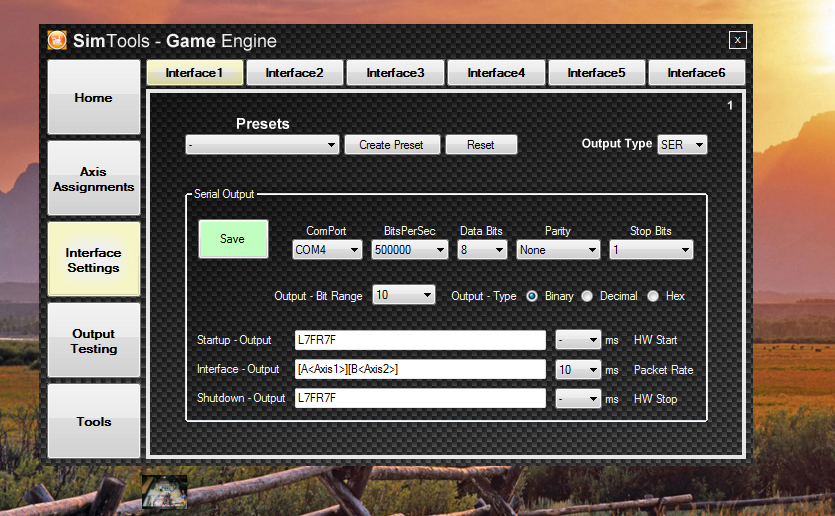

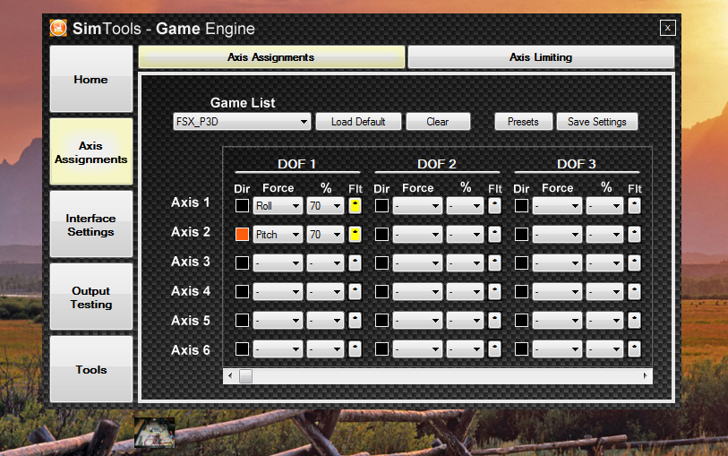

    Hello all, I have completed my motion platform for flight simulators ( FSX & DCS) and I was wondering what setting/settings I could change to make the platform more responsive to my joy stick control to control my pitch and roll? My next question is would I get better response using the Moto Monster board rather than the BTS, 43 amp H-Bridge board?
    Thank You
    Terry.

    Hi Terry!
    Where can we find more information about your setup?
    the only information is your Hbridge reference and this is not enough to guide you for improvments...

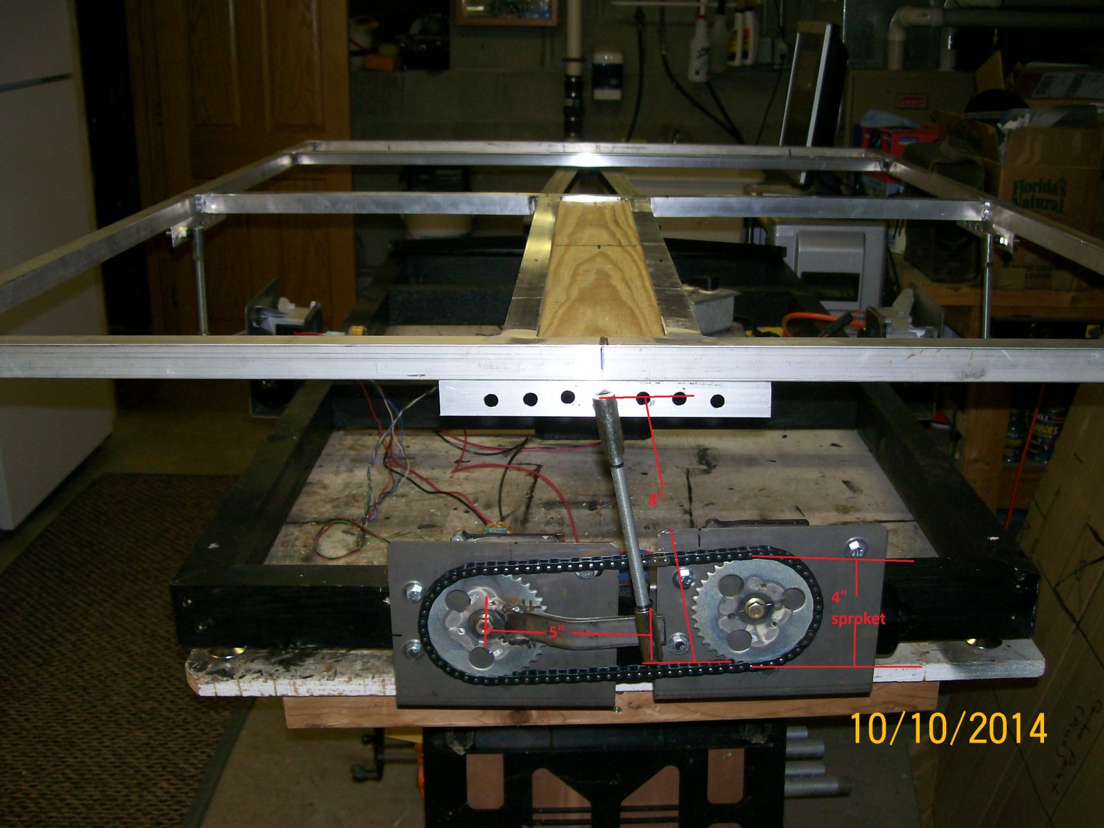

    kind of motors? length of motor lever? kind of board (Arduino? Thanos?) your setup in Simtools....

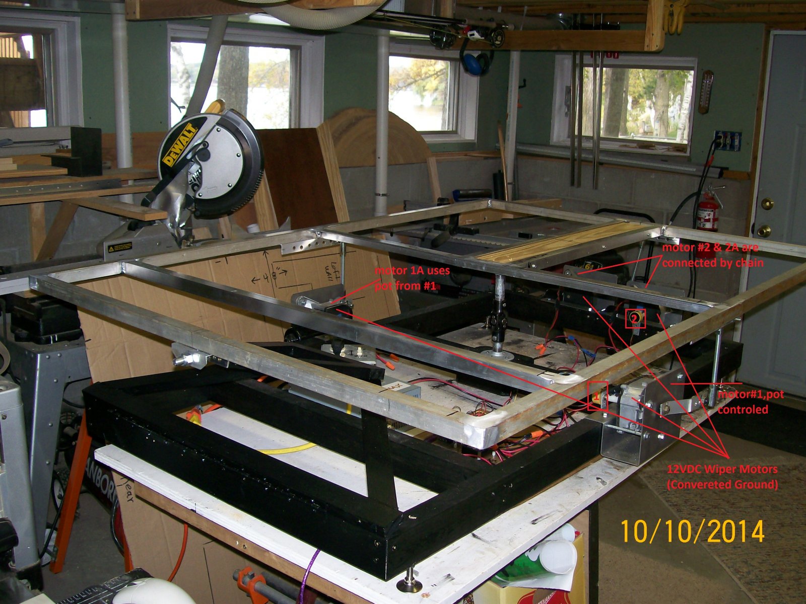

    Hello Mat, The motors are 12vdc wiper motors, #1 and 1A are independent of one another and #2 and 2A are connected together with a chain (see pictures) I am using SMC3 along with your 2DOF program.
