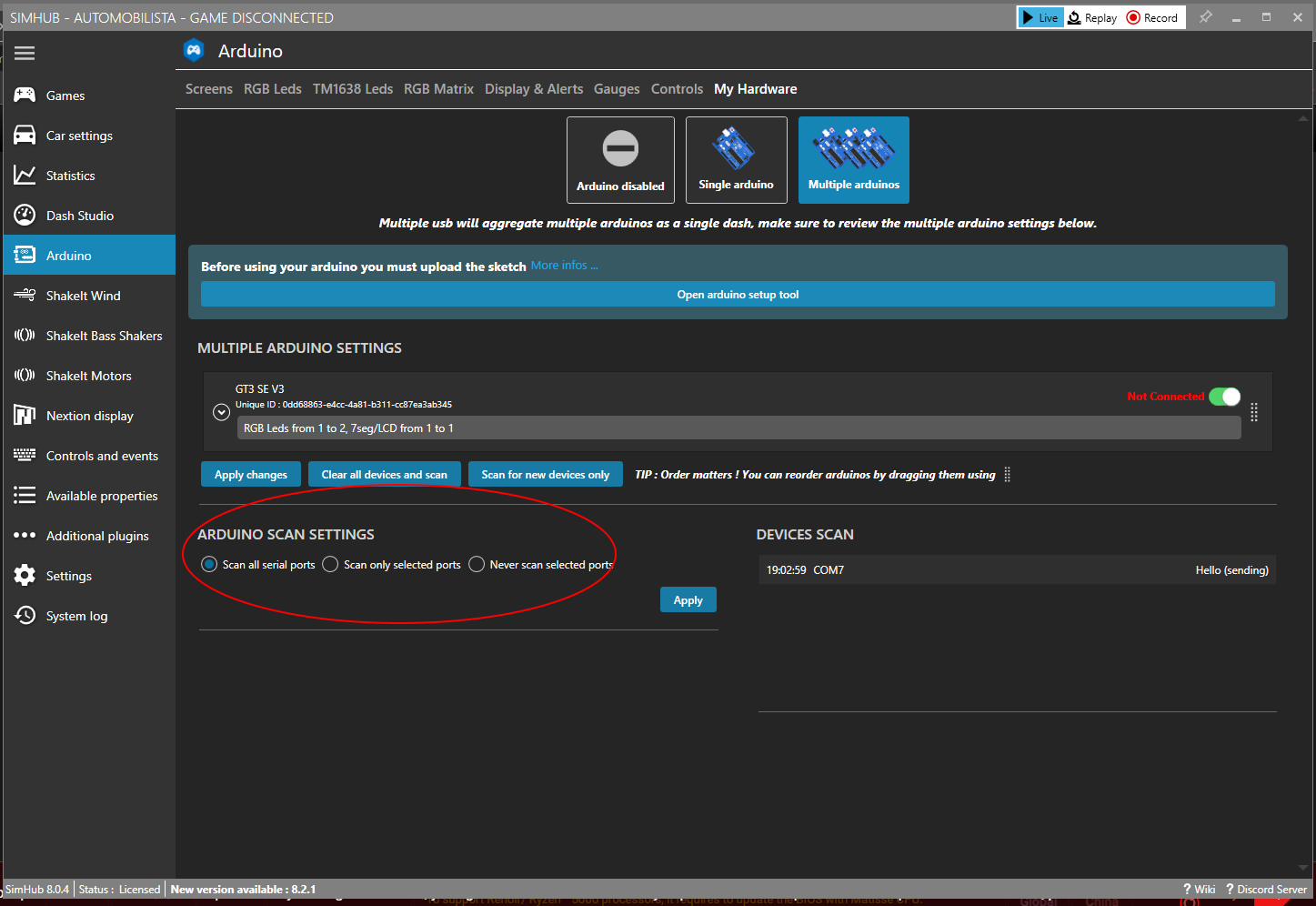

    Ok thanks Noorbeast, I have disconnected the thanos4u and hooked it up to my laptop. So there is no blinking red on the tx led. When testing output in Simtools tx led goes solid, so this seems correct.
    Disconnected everything from my gaming PC and only hooked up the thanos4u.. still blinking red on the tx led :thinkmmm
  8. bob williams
    bob williams OSW sfx100
    Apr 18, 2012
    119
    IT
    Ermelo, Netherlands
    89Coins
    +45 / 1 / -0
    Found it!
    It was Simhub scanning COM ports.
  9. edoardo2010
    edoardo2010 New Member Gold Contributor
    Jun 4, 2013
    - 408Coins
    Hi, I confirm. Same thing happened yesterday. I disabled the Com ports of the engines and the problem was solved. Thanks for the valuable input.
