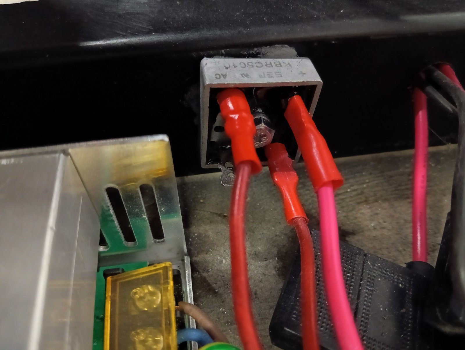

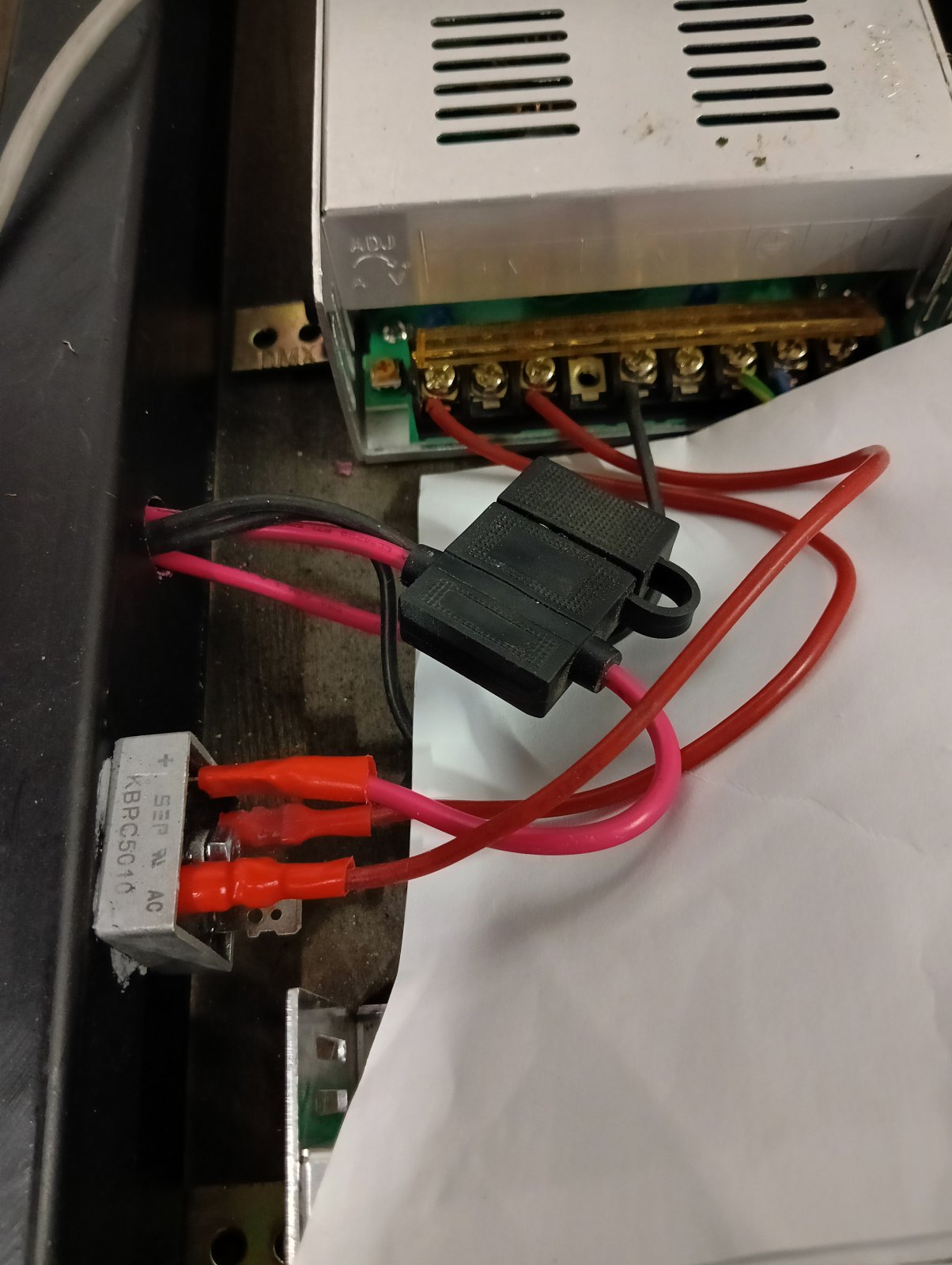

    For reverse current protection, KBPC5010 diodes at the output of the power supply connected according to such a scheme will suffice:
    Power supply 24V connect to both AC pin , positive pin KBPC5010 connect to positive pin motor driver, negative pin KBPC5010 not used .
