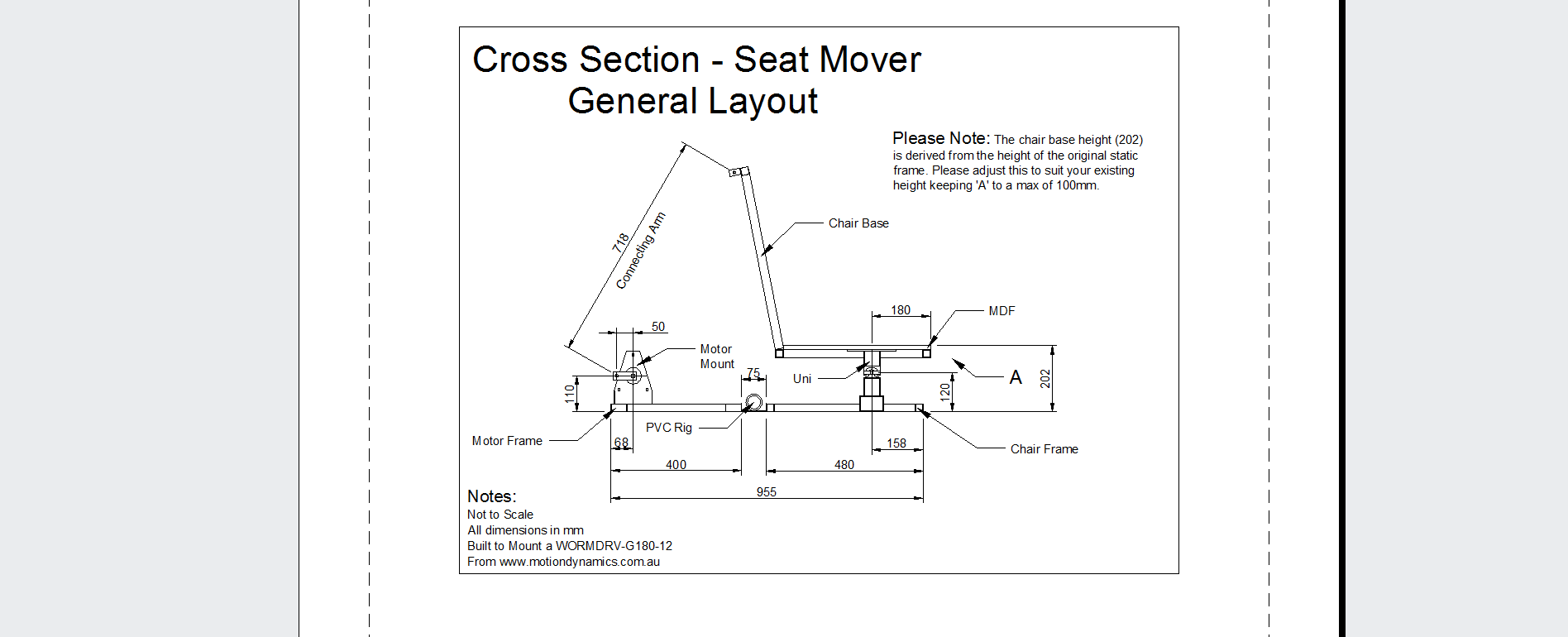

    Ok 3dof with a heave, ie 2DOF covering roll, pitch, sway, surge and simulating heave. Then add a third axis to capture the sway for a rear traction loss setup.
    All can be done for under $1000 dollars with card that are off the shelf , Jrk12v12 on Big Worm Gear motors.
    And can be used with our new software.
    Example of a 2Dof Seat mover built for $600 (Chair piece only) that can be adapted to any static sim, just needs a yaw table under the whole unit and you have 3dof for a fraction of the cost and its all 12v electronics, defiantly a DIY option anyone can build.
    P.s this could be done for scn5 too, but triple the price.

    Ok Simxperience is a very good system, and is commercial, software here has been developed to be used by use DIY guys, a replacement for the aging software we use from another site. There is a post where you can ask to be included in the beta test, but by the time your ready hopefully we would have released this to the public.
    Ok scn6 can handle a greater load and are a little slower, they push the 200mm/s mark when loaded on a sim, my dc motors are pushing way past that speed.
