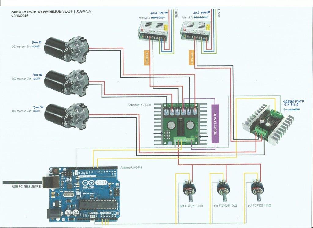

    Hi guys,
    I found this scheme that seems to fit perfectly with my project.
    I modified the characteristics of some components.
    The engine is still being chosen, waiting for the price, if OK I choose TRANSTECNO 300 / 350w 24v 3000rpm - final rpm 50
    - arduino UNO REV3
    - 2x32 sabertooth
    - 24v power supply - 1000W - 41A
    - FCP22E 10K potentiometer
    I would like to ask you experts if everything is ok?
    If something is not right, please indicate the right component.
    If everything is ok, I proceed with purchase ...
    Thank you.
