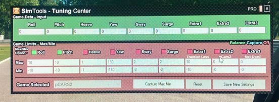

    My question is I have the Pro version of Sim tools software and want to operate a DOF Reality MP2 seat mover with these other software. I have already setup the seat mover and output tested with the slider and everything works. I have uploaded game plugins and the Game manager and Game engine show not connected and I am not sure how to initiate the Sim tools to start in game. Does anyone have a tutorial on how to setup the MP2 seat mover with the Sim Tools. I have added a link to a YouTube video of my setup with the DOF MP2 seat mover in use. I would like to use both the PT actuator and the MP2 together, thanks for any help.

    Be mindful that mixing software is likely to create port conflicts.
    It would likely help if you posted pictures of all of your settings, including the Tuning Center while the game is running.
    If SimTools Output Testing works as expected, is the game patched for motion, with a motion profile configured in Axis Assignments and other software temporarily shutdown?

    Here are the pics of the settings and nothing else is running, just sim tools. I didn't get any inputs when I was in game.

    yes, I have shared memory set to PC2, UDP frequency set to 1, and UDP Protocol version is set to PC2

    Try UDP OFF.

    I have figured why the Sim tools wasn't working and it was my fault of course. I was following the 2 PC setup and not the single PC setup for the IP address. Now I can get the Sim tools to work with PC2 by itself with the DOF Reality MP2 seat mover and I got Sim tools to work with Sim Racing Studio software and the PT actuators. I tried using the Sim Commander 4, Sim Racing Hardware, and Sim Hub and the Sim tools makes 2 beep sound and disconnects all motion and other telemetry devices. I used the 2.0 USB cord from the DOF Reality MP2 seat mover to the PC directly with it's own dedicated USB port but I get the same issue. The 2 beeps isn't the same sound as a USB disconnect sound, does Sim tools work with Sim Hub or Sim Commander 4 software? Thanks for your time.
