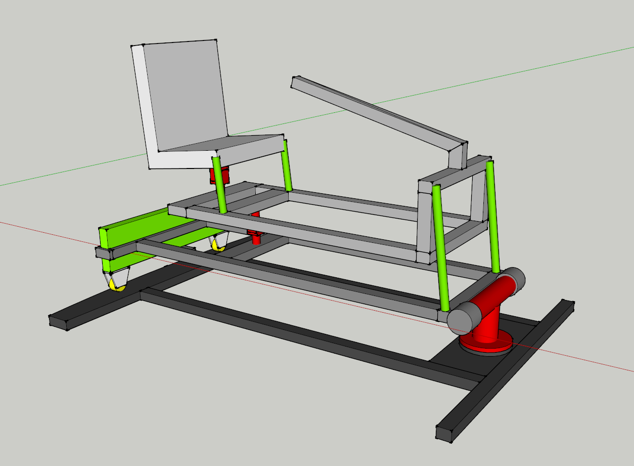

    I was thinking to design a rig separating the forces as much as possible, hoping for the most realistic feel. Like what you were saying about having heave on a separate axis to avoid effect being washed out in other axis(s)
    What I mean by this is;
    a seat mover (for surge and sway)
    on a motion platform holding the seat, wheel and pedals (for pitch and bank of the track)
    on a final frame (that heaves and possibly yaws the platform above it)
    I am making a rough drawing on sketch-up, and will post it tomorrow to give a better idea what I am thinking. It sounds cool to me, but I'd like to see what you guys think of the idea. I may be totally out to lunch...

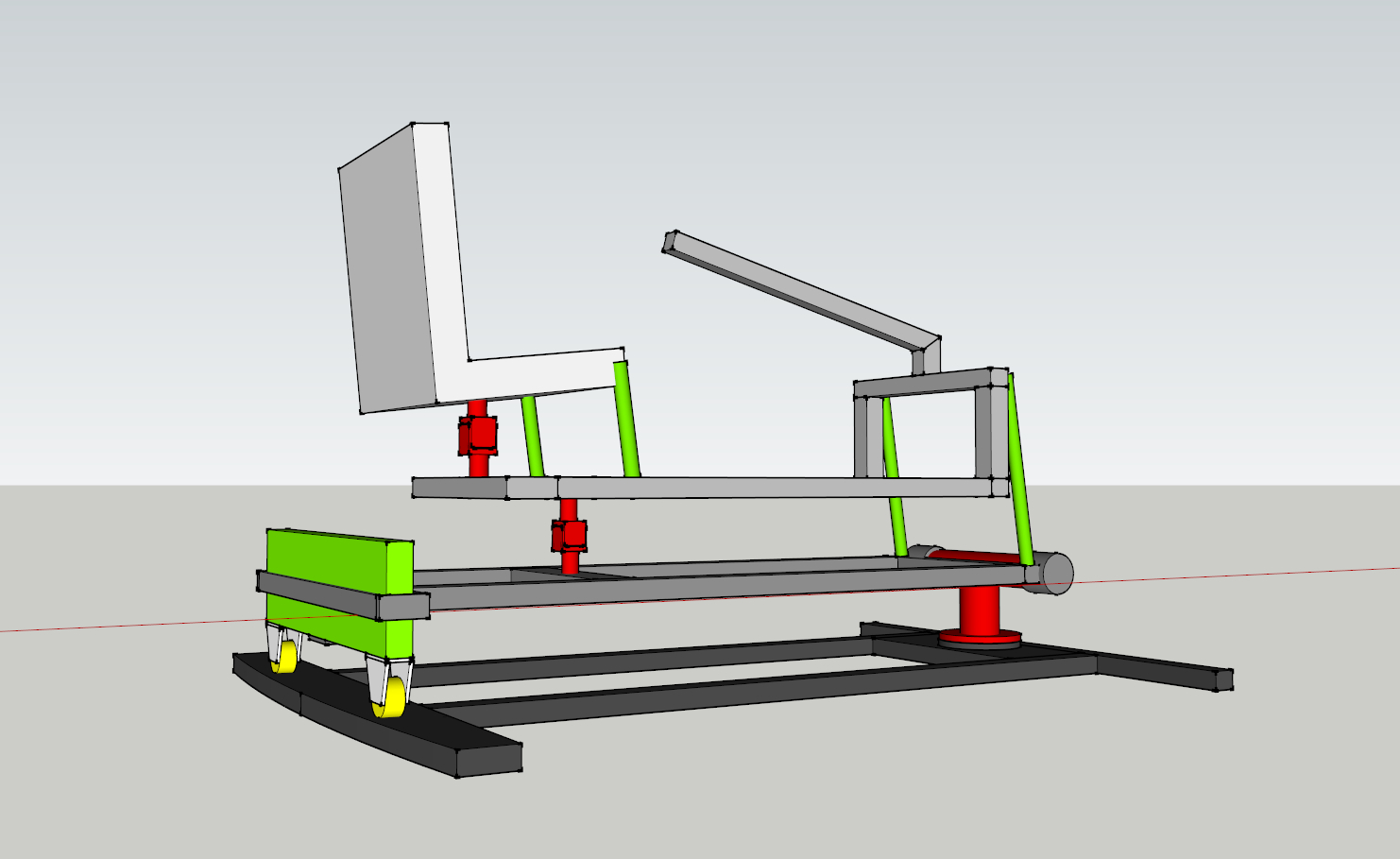

  13. jimmcquade
    jimmcquade Member
    Jul 11, 2014
    51
    Canada
    272Coins
    +8 / 0 / -0
    Here is a rough model of what I have come up with so far.
    The green objects are the 'movers', and the red are 'pivot points'. I did not draw in the motors etc, just trying to get broad idea down in a model. The green box at the back will not actually be a box shape, it just represents the mechanics of the 'heave'. There are a few different ways I can achieve the lifting motion which I am working on now, but I am looking for any ideas you may have that you may want to share. That is really the only area that is not worked out yet.
    The front red 'T' is a up/down pivot axis for the heave, and also rotates for the sway. I could also use a ball joint in place of the 'T', but I think the 'T' would be more stable when things get moving a lot. Feel free to critique the model. Thanks

  14. bsft
    looks good.
    Just a thing about the front up/down heave, if you intend to lift the entire frame in a up/down motion, you would need a 4th frame under it again with 3 or 4 powerful motors and a spring to compensate under the centre to allow direct up and down lift.
    The 3 point is more for sway and would have to stay stable, just allow side to side movement.
    Generally its a great concept, expensive I think to build, but a great concept.
  15. jimmcquade
    jimmcquade Member
    Jul 11, 2014
    51
    Canada
    272Coins
    +8 / 0 / -0
    The front of the rig will not move up/down. Just the rear will move. The front is where the pivot point is for the heave. The horizontal cylinder on the red 'T' a rotation axis for the rig to heave up/down in the rear only. So the rear part of the rig slides up and down the green rectangle in the back. Sorry the drawing is a bit primative. As I progress with the model I will make it more clear.

  16. SeatTime
    28,370Coins
    +2,844 / 39 / -0
    The design looks like a 2DOF seat mover sitting on a 2DOF full frame, although if the second frame is only for heave then another Universal joint is not required, or for stability reasons recommended.
  17. jimmcquade
    jimmcquade Member
    Jul 11, 2014
    51
    Canada
    272Coins
    +8 / 0 / -0
    Yes, a seat mover on a full frame. The seat mover gives the g-force feel, and the full frame provides the pitch and banking of the tracks. Bsft and eaorobbie were saying that a seat mover provides a movement you get in a real car, that you don't get from a full frame. So I decided to include both. The frame located under the full frame provides the sway and heave.
