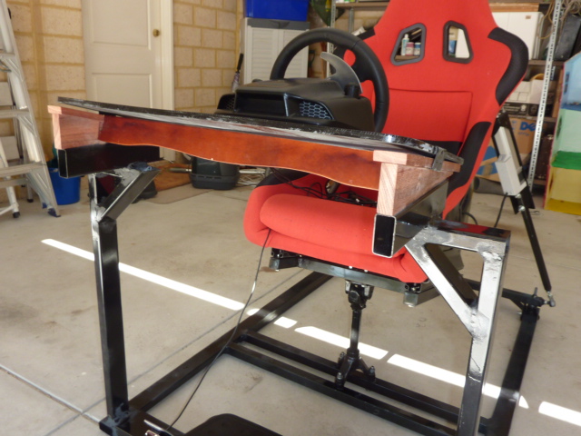

    I am building a frame for the simxperience motion kit. Does anyone know whether the forces from the following design are more realistic for kinesthesia and proprioception?

    In my opinion you need more movement if the wheels/pedals are to move with you for good feelings. In this case you rely purely on pitch and roll position to simulate G-Forces.
    The whole point behind the wheels/pedals stationary is to move only your body, simulating muscle tension in the legs and arms like G-Forces would. It also adds pitch and roll to the sensation to make it more powerful. For this type of simulation you don't need very much movement for relatively strong effects.
    Considering the limited movement and torque/speed relationship of SCN5's, they are much better suited moving lighter loads in a seat-mover setup.

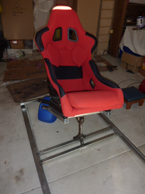

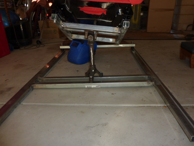

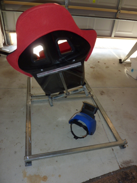

    Well I have made some progress since the last email. I have a bit more welding to do and then install the actuators which should soon arrive in the mail. I will post more once the scn5's arrive.

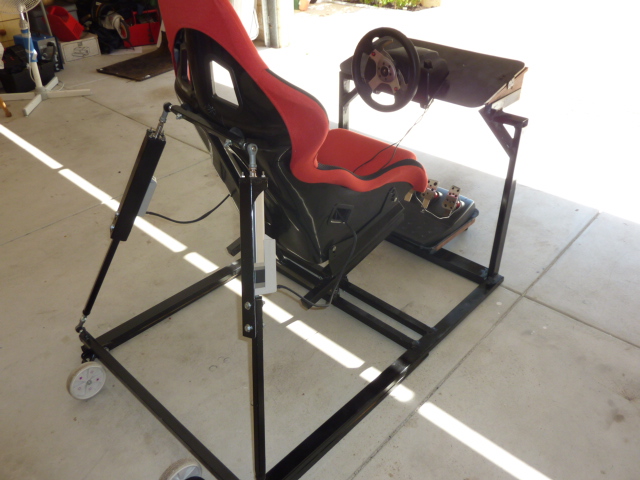

    Well I received the simexperience starter kit and have installed the actuators and completed 4 hours of driving. Absolutely brilliant! I would recommend this kit to people who are a bit short of time, have the capacity to construct a frame and want a no-fuss approach to scn5 2dof simulators.

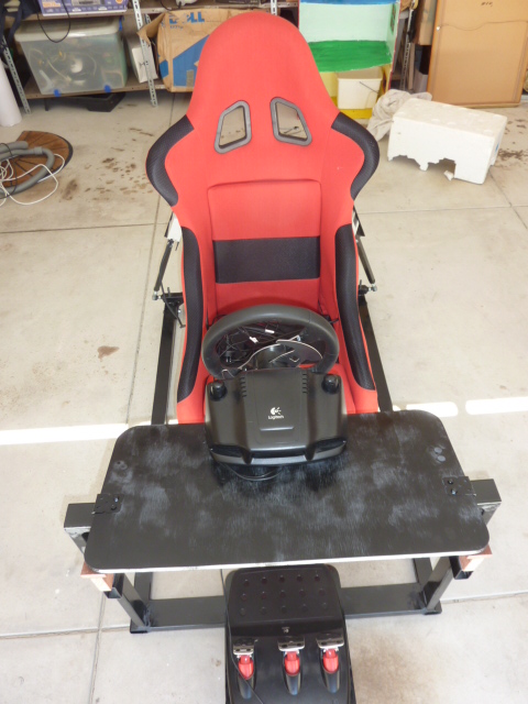

    Hello, can anyone point me to drawings/ideas for a frame that I can use/bolt onto the front of my sim seat frame? That is, a frame that is fixed to the sim base frame and not one that moves with the seat. Less materials is better for me as I need to move the seat from the garage fo the house for use so weight is an issue.

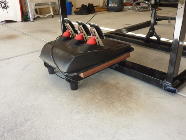

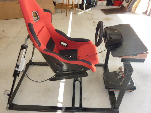

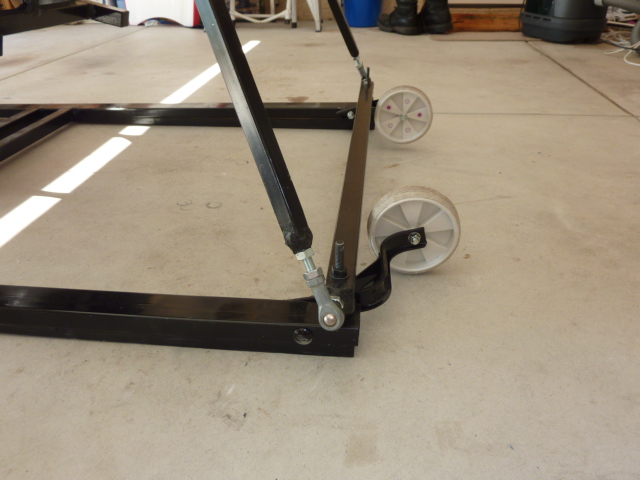

    This are almost the latest pictures prior to installation of the G25 shifter and simxperience control box. Although the top wooden plate looks a bit flimsy on some pics it has held up to the rigours of most use without a problem.
    I have used trainers wheels froma child's bike for mobility which finishes off the sim seat nicely. I have received considerbale assistance from the Australian agent and Birny from SimXperience to set up on my PC and would like to thank them for their customer service.
    I will get a youtube video going hopefully some time in the next 3-weeks. Overall, I would summarise the 2-dof sim seat as an absolutely brilliant experience for a minimal buget project, and it was also a lot of fun to design and construct.
