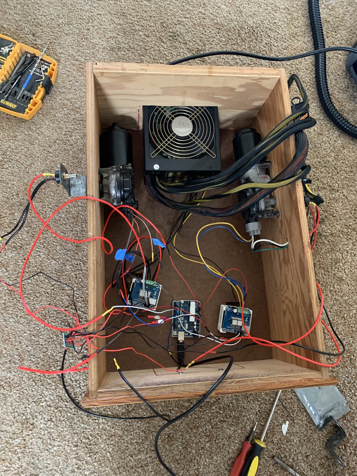

    Currently My Sim Consists of a Basic Frame , Two Bass Shakers (Front and Back) and VR. I Plan on Building a 2DOF for Now. Then Later adding a 3rd Motor for Traction Loss
    Materials I Have Aquired are 3 wiper motors for Testing purposes before my Main Motors Arrive but for Main Rig I will Use:
    (Qty- 2) GEAR MOTOR 12 VOLT GREAT FOR SAWMILL/CRAB POT PULL/FEED/SIMULATOR 75-80RPM 50:1
    Arduino Uno R3
    (Qty-2) IBT-2 BTS7960 43A
    Hall effect potentiometers 6127v1A180L.5FS
    CoolerMaster 12V 1000watt ATX PSU

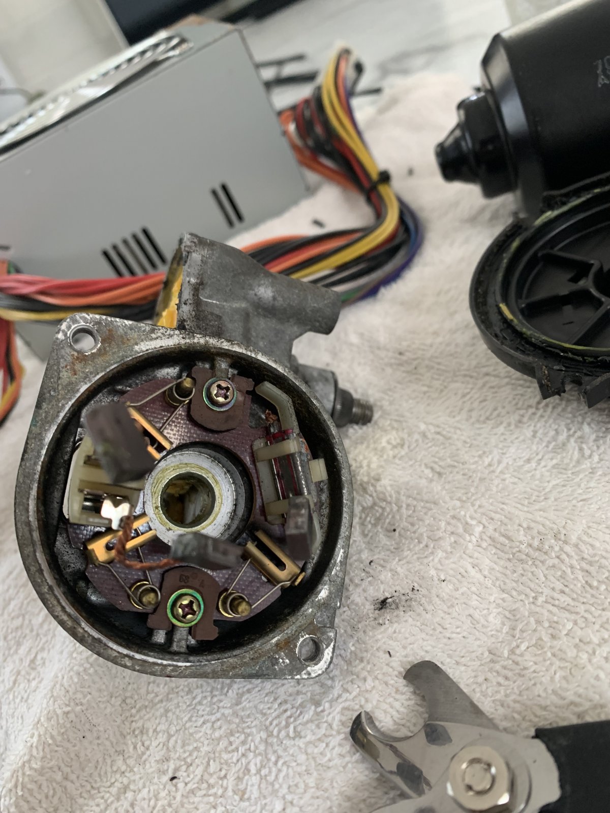

    (1st pic)I have tried to create an environment for testing my current components as well as isolated the ground on these wiper motors. After checking everything with my multimeter to make sure ground was isolated I wired the arduino, ibt’s, Hall effect pots and managed to fire up smc utility tool. Unfortunately the pots needed better mounting. Will post back soon
    (2nd pic is of wiper motor ground isolation)

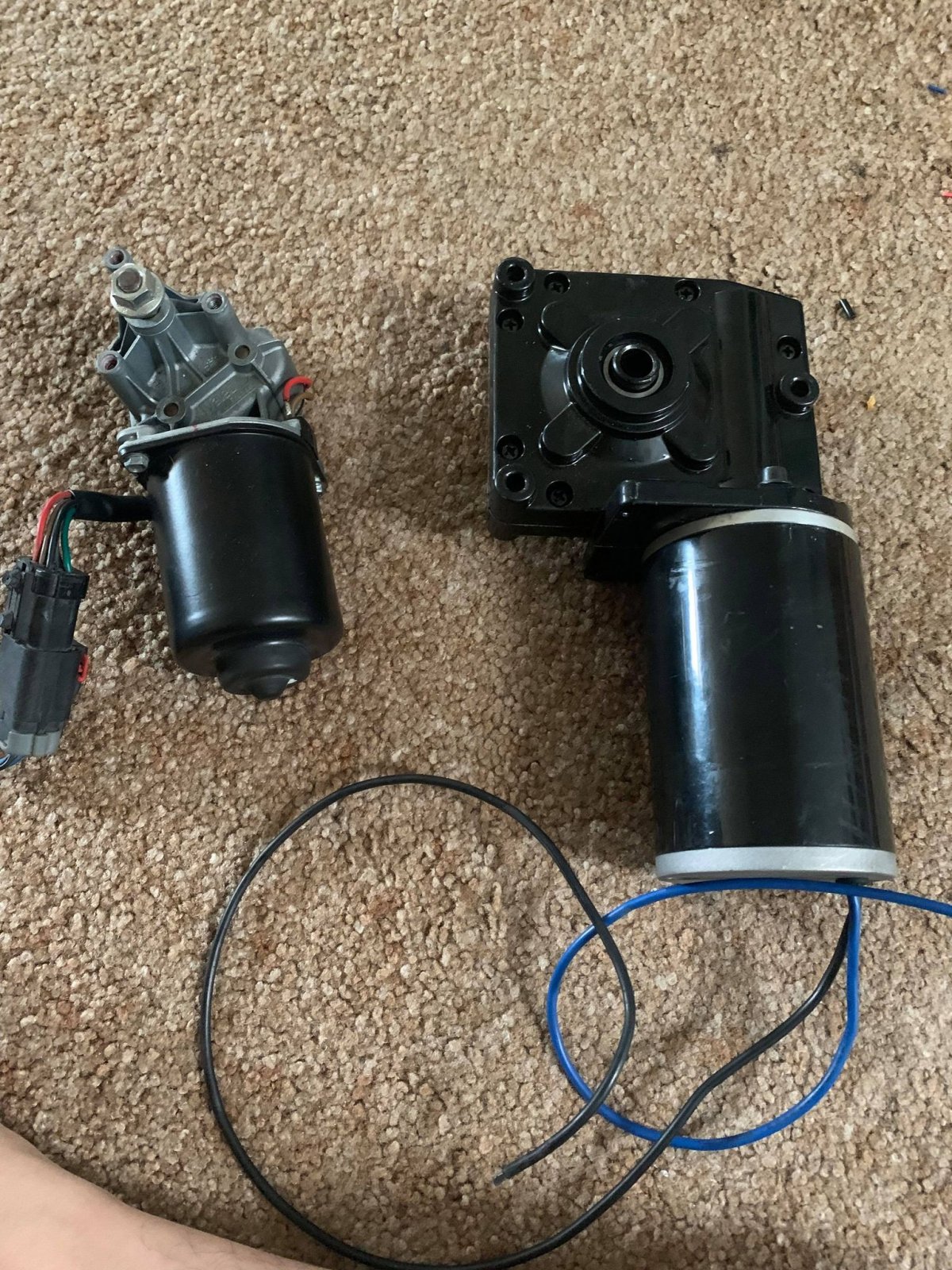

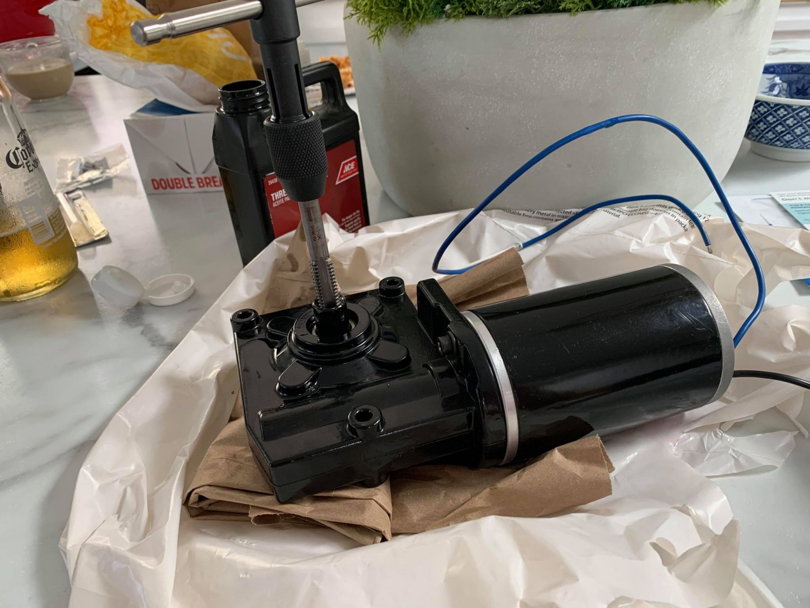

    well, My New Motors have Arrived. Here's a Pic of wiper motor size compared to new motors. I am Working on Tapping the hole so that I can Use a Coarse thread 5 inch bolt.
    the wiper motors are behaving strange with the SMC3 Utility software and I'm thinking of Ditching them since the new ones have arrived.
