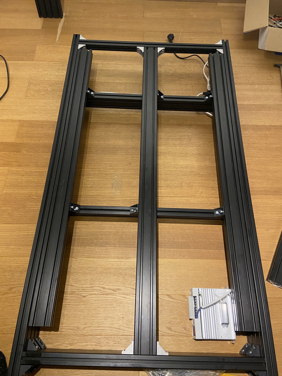

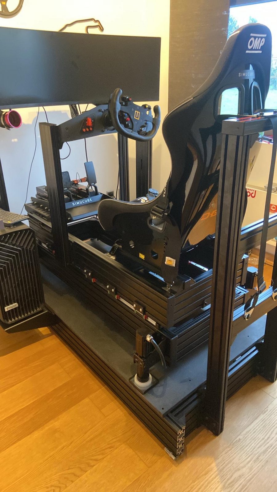

    I have a D-box 4250 and wanted to add Surge so i went with a 150mm PT actuator, one Servo and Thanos.
    I don’t like cables so i installed my rig and surge on a platform, perfect for hiding that ugly Servo.
    Now my VR and Simucube base suffer from disconnects.
    I ordered two shielded usb cables one for thanos and one for Wheelbase.
    I also ordered a bernstein plug for the power of the Servo.
    What else can i do to eliminate Emi, are the cables from PT Shielded!

    does the sim chassis have its own ground wire ?
