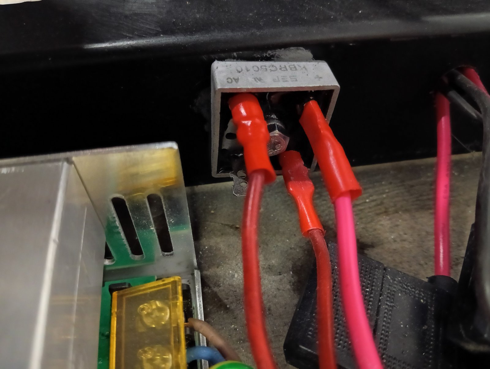

    Use diode KBPC5010
    Power supply 24V connect to both AC pin , + pin KBPC5010 connect to + motor driver, - pin KBPC5010 not used

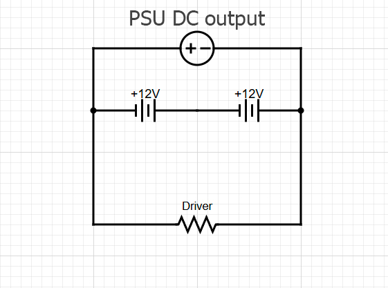

    Does Amp hour matter much? How about a
    24V 6Ah Rechargeable Lifepo4 Battery Pack Built-in 6A BMS, 2000+ Deep Cycle Lithium Iron Phosphate Battery
    Would that work? Should I use this in conjunction with the diode or is that even necessary with the battery?
    Final question (hopefully), how do I hook the battery up? Across the psu +/- terminals (parallel?)?
    PSU + to battery -, battery + to PSU -, and then battery + to driver + and battery - to driver - ?
    EDIT: Oops, just noticed that battery can only do 6A... but if it was, say, 25A, would tat work? Or does the amp not matter because the battery doesn't need to drive the motor? Although my ammeter only showed a max of 5a with a partial load, but I'm not sure how accurate that is.

    What is the second red wire connected to the second AC pin? Another output with the same polarity? Why would that be used?

    yes, from the power supply connect 2 times the power supply to the AC pin

    I doubt it would work. Those LiFePo batteries have an internal battery management system to protect the battery. So it has to limit voltage and current and that's not what we want. A "good old" lead acid battery can take a lot of abuse. If the PSU voltage is in the range of 12 to 13V it self-regulates and can run in parallel to the driver without further protection (except for a fuse).
    If the voltage never goes above what the PSU can take (usually there are caps rated 16V) the diode is no longer necessary.

    It's a 24V system, a 12v battery would still work?

    Ah, no. You need 2 of them, of course. Sorry

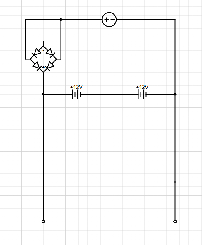

    So would this be the proper way to connect? And I believe I read in the other post that I won't need a fuse if the PSU amperage is close to the motor's stall current?

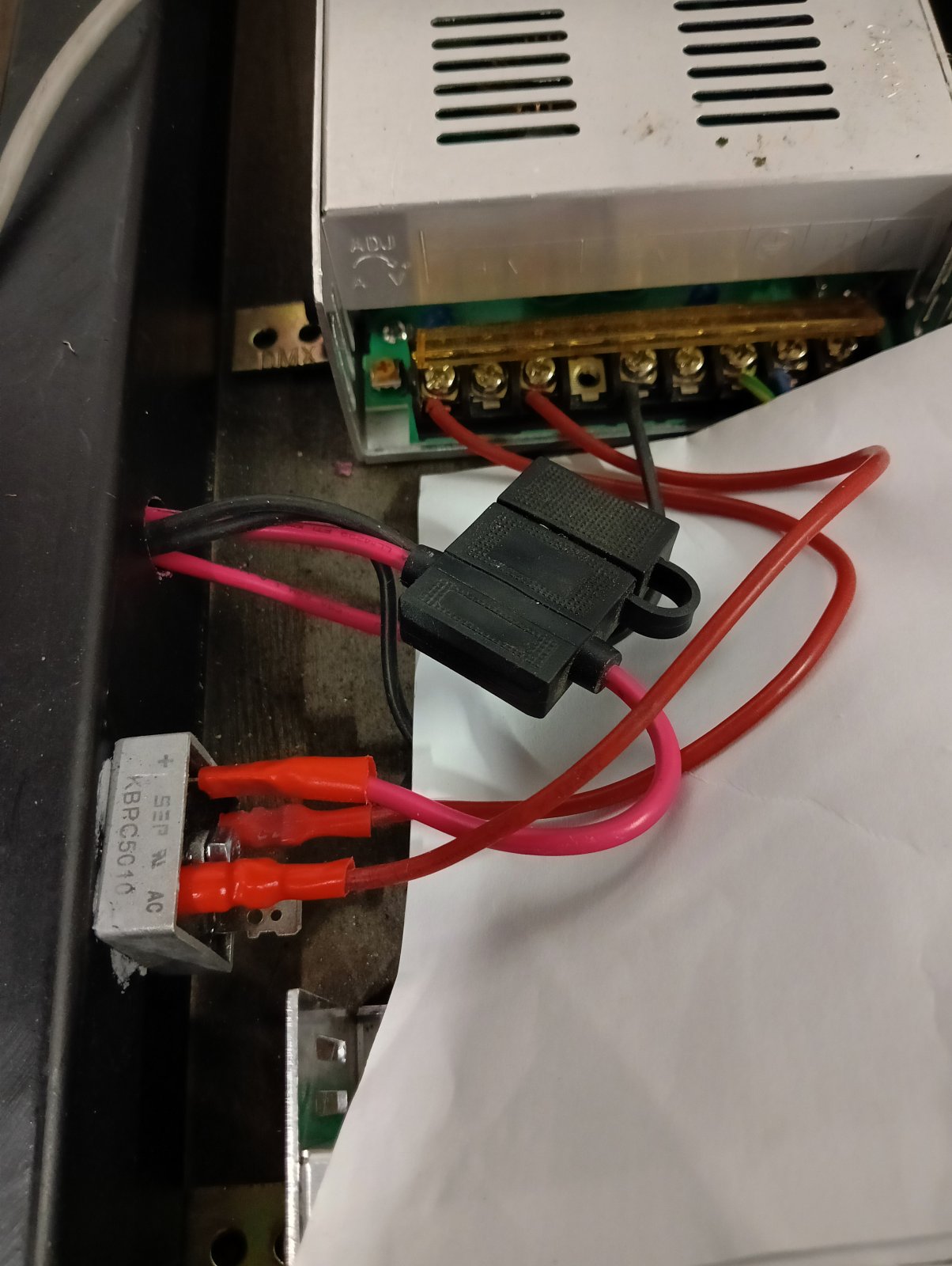

    I updated the diagram to include the rectifier... could you please let me know if this is correct? I have all the components and am ready to assemble and test, but I want to make sure I don't blow something up. Does it matter which side of the PSU the diode is on?

    Got impatient and gave it the ole' college try. Everything is working! Now to strap the other motor back on and rig up some push rods.
