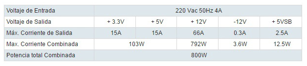

    I'm having some problems when using an ATX source to power the motors of a 2dof.
    I have two motors that, according to their documentation, consume 17A. I did not measure it, so I'm not totally sure.
    I bought an ATX source of 800W, in its inscription says that for the 12V it throws 66A. I converted it according to the tutorials.
    I tried to power the two motors but when you want to reverse, the source goes turn off. I imagine it is the moment where they most consume.
    I made the decision to buy another source to use only one PSU for motor.
    The problem is that after a minute of use, the source turned off.
    Any ideas ?.
    According to its specifications, each PSU throws 66A by the rail of 12V (has a single rail).

    The motors will generate significant power spikes, particularly during fast reversals, which can trip PSU protection.
    You can try including a battery.

    This could be a ground isolation issue. Many motors just ground the negative, having 2 motors when 1 reverses it is then a 24v circuit tripping the supply.

    @gigi, I have not done it yet. But I have in mind buying a car battery of 80A or 120A and a charger with auto charge cut. Meanwhile I use the PWMmax at 210 (with SMC3).
    @Matthew, I'm not using wiper motors. The motors are well insulated. It is a power consumption problem. For me, the 66A that PSU says are not real.

    Ok some thoughts here. You are using a pc power supply. Many of these supply 12v over multiple rails. The rated amps are a TOTAL of those rails. Each one has ocp of a lower current. Are you sure it is single rail?

    In the specifications of the PSU, it says "single rail" and 66A in the 12V.
    The motors say 17A, but I do not have an ammeter to measure the peaks.
