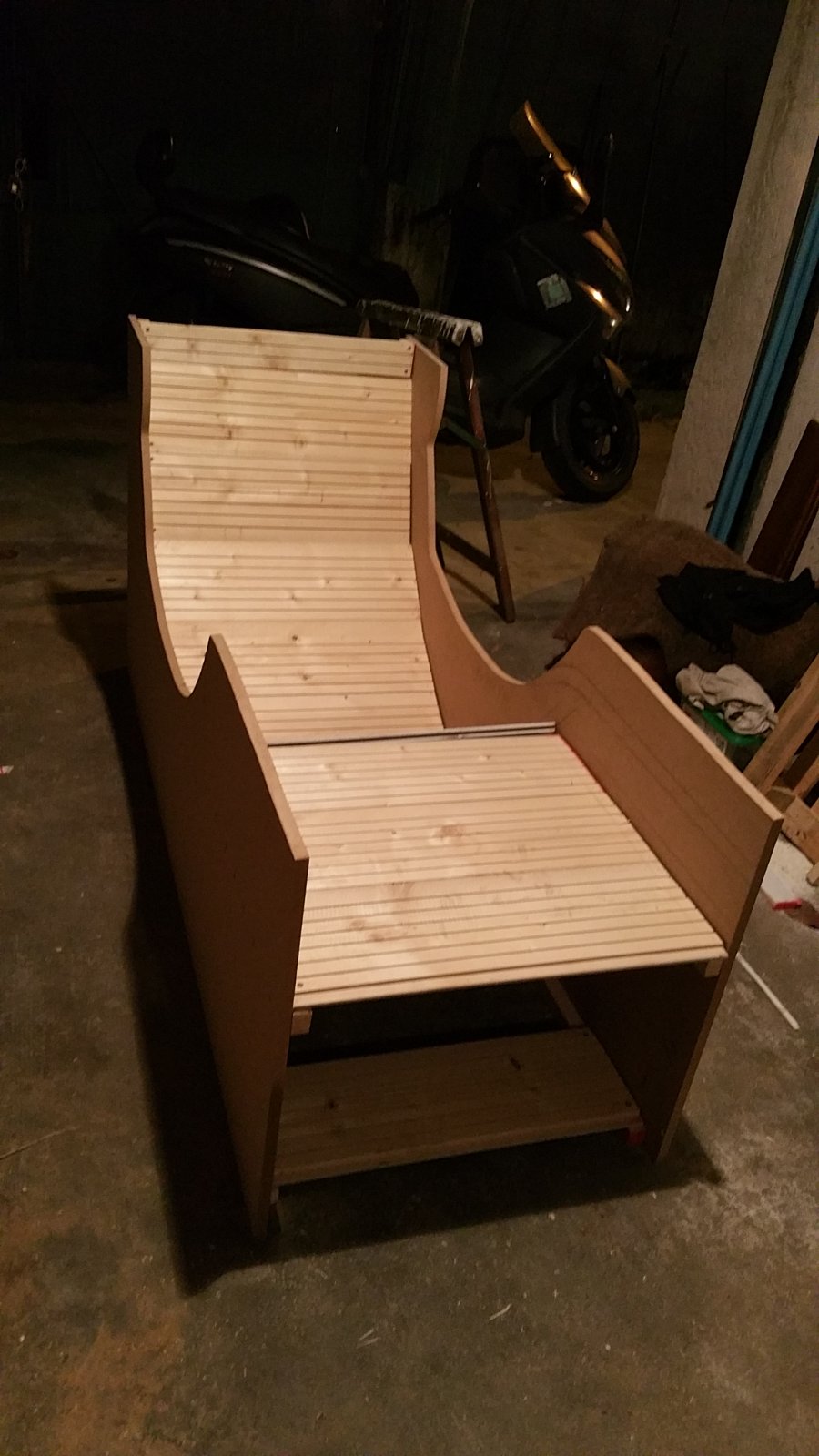

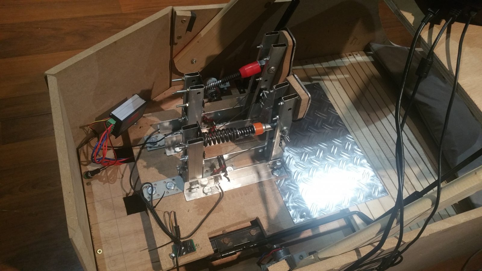

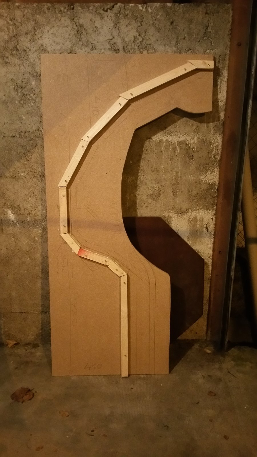

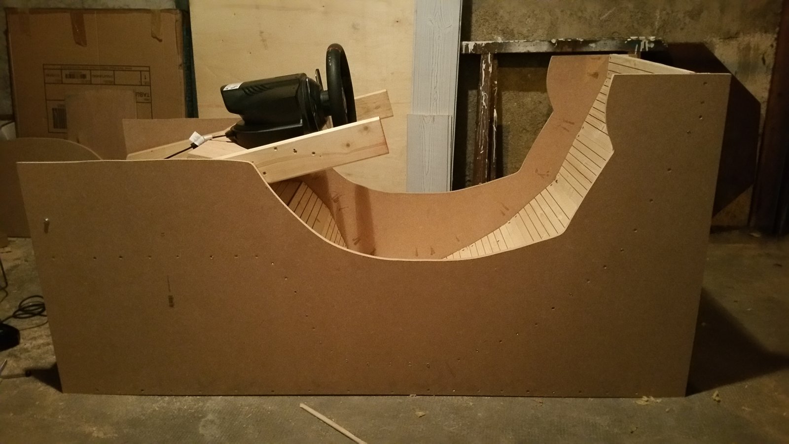

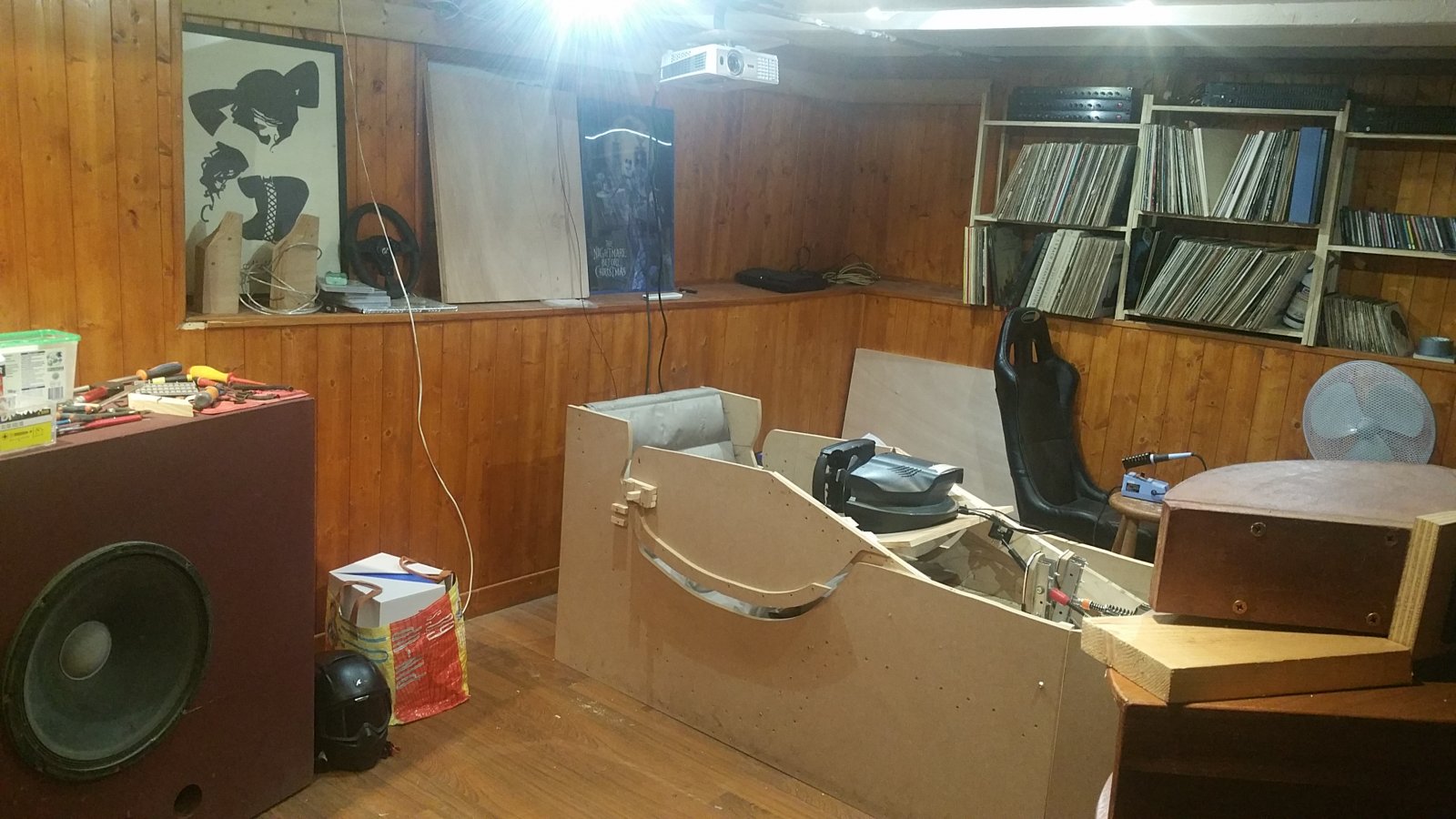

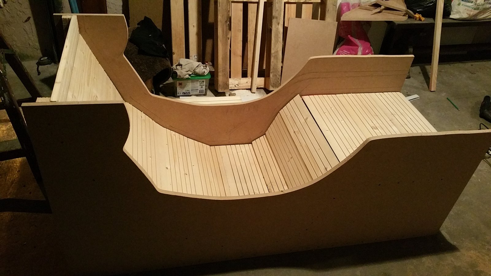

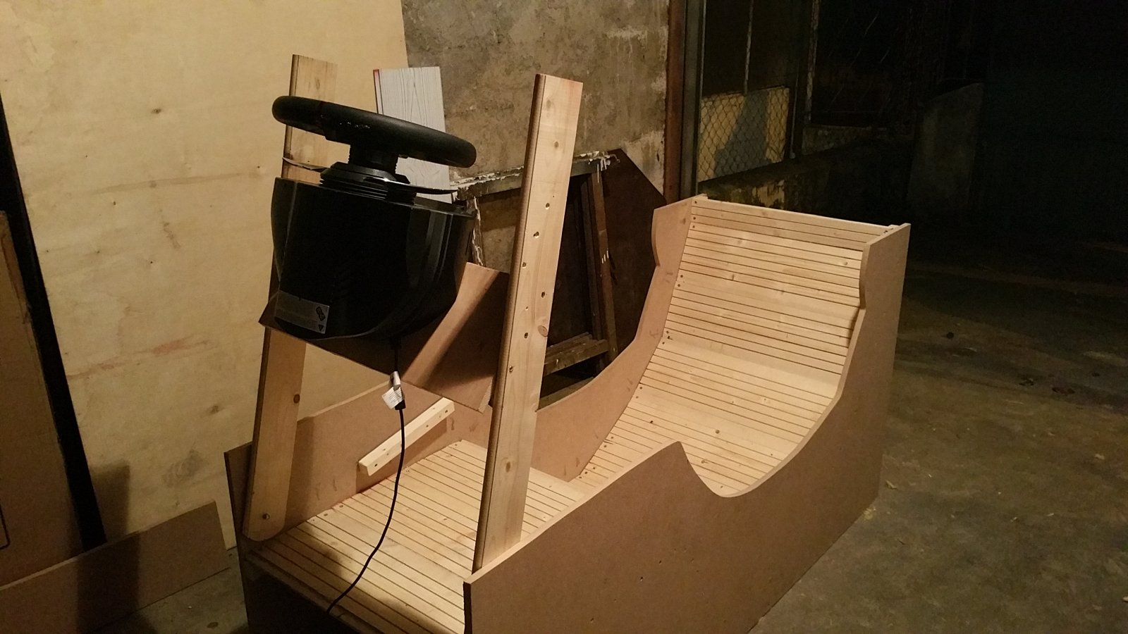

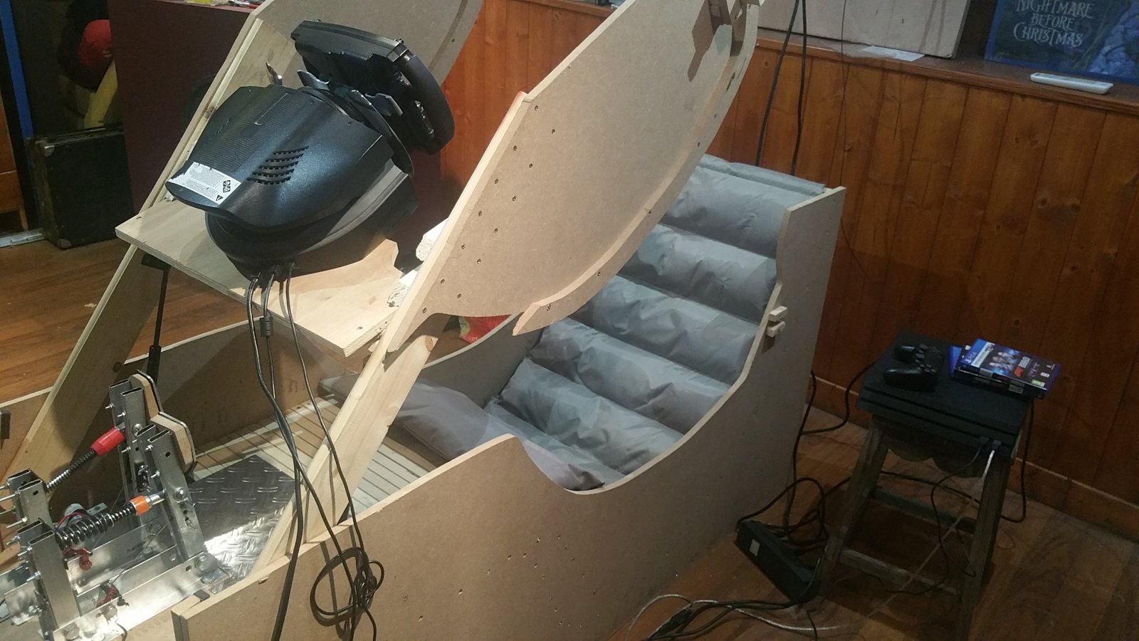

    Hi everyone
    Here is my turn, the time has come to launch me. First of all I would like to thank all the people who share the information on the forums, which MINE!
    I was able to chat with the SIMUKIT person, "wanegain" and "MOMOCLICK" then I read and reread the 3DOF tutorial.
    I started by buying various pieces that I will try to value.
    • A full HD short-throw projector with low latency = 450euros
    • Reflective canvas for video on Aliexpress of 3X2m = 50 euros
    • Thrustmaster T500RS steering wheel with pro pedalboard used = 270 euros
    • A PS4 pro with virtual helmet of opportunity = 400 euros
    • Used car seat sliding rails = 20 euros
    • Dashbord software from stryder-it.de for samsung note 4 = 13 euros

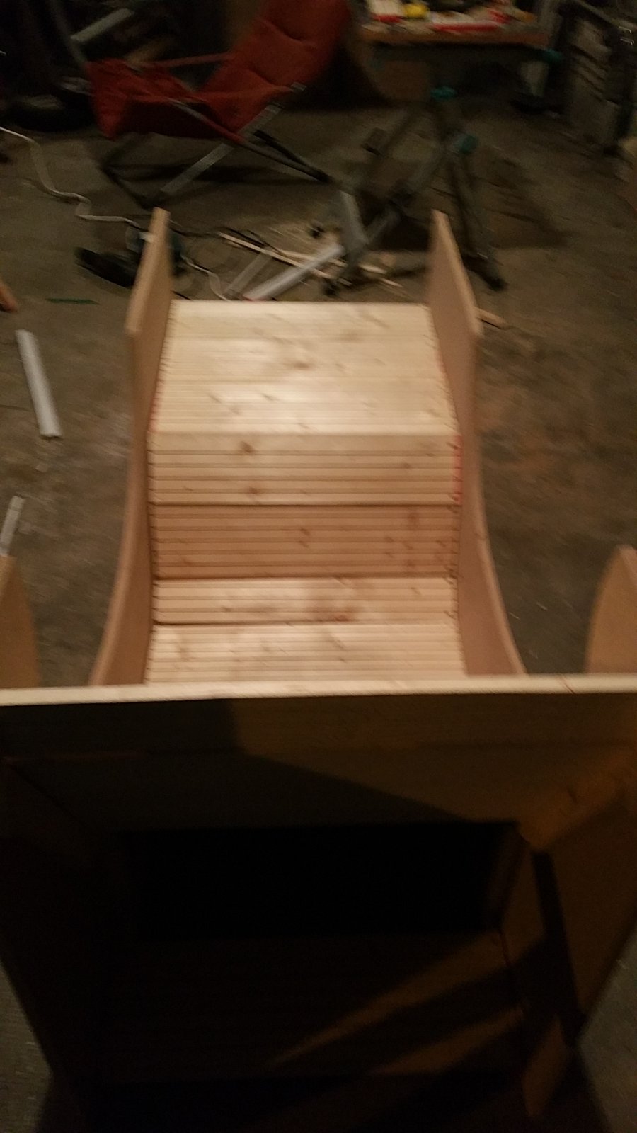

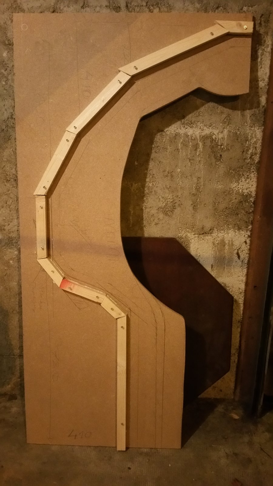

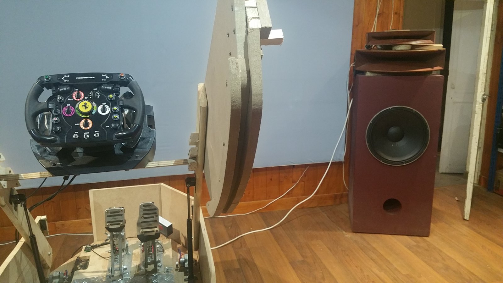

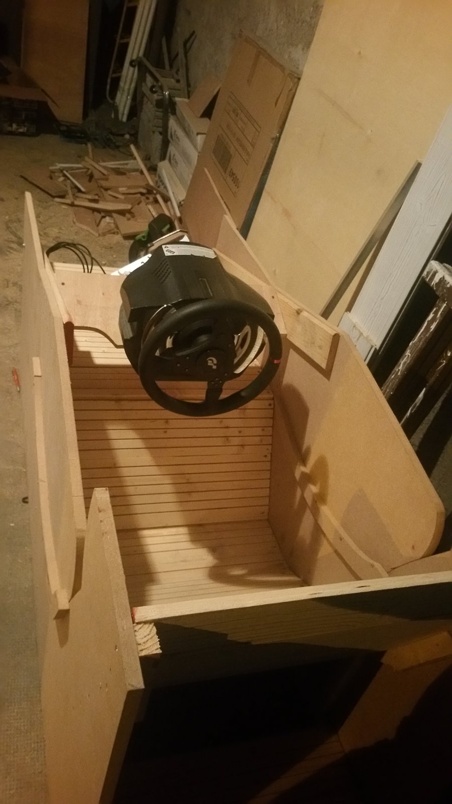

    First step: create the static mode
    I started building a static wooden cockpit. As the crankset did not fit, I made my own crankset but using Thrustmaster's pedal electronics card. Everything is mounted on sliding rail to suit the size of the player.
    I installed vibrating motors servocontrolled to the accelerator (inverted). The PS4 sends back the sound via an HDMI splitter switch -optic. I set my internal wifi network by opening the port UDP 20777 to allow the transfer of telemetry to the application Dashbord on my laptop samsung note 4. I positioned my mobile phone on the wheel. So I have all the running parameters in direct view, I can focus on the plot.
    Result: it's nice, but it does not move!
