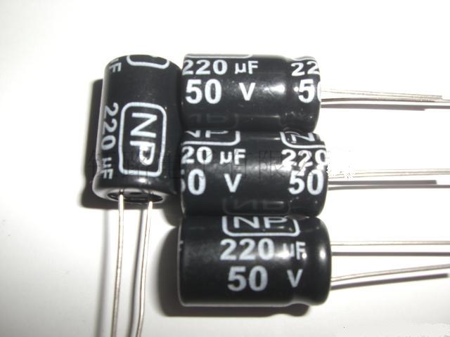

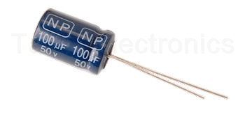

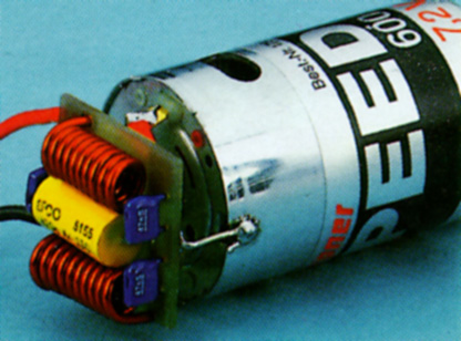

    good + lot of noise .... put 2 or 3 > 100uf/50V Non pole [NP] capacitors or higher in parallel with the motor to reduce the noise ... or some low pass filter coils in serial with the motor ...
    Non-Polarized-Electrolytic-Capacitors-NP-BP-220UF50V-Size8X21-.jpg ECR0192.jpg photo2.jpg
    why still not using Simtools ?:(

    hello thank you very much for the recommendation.

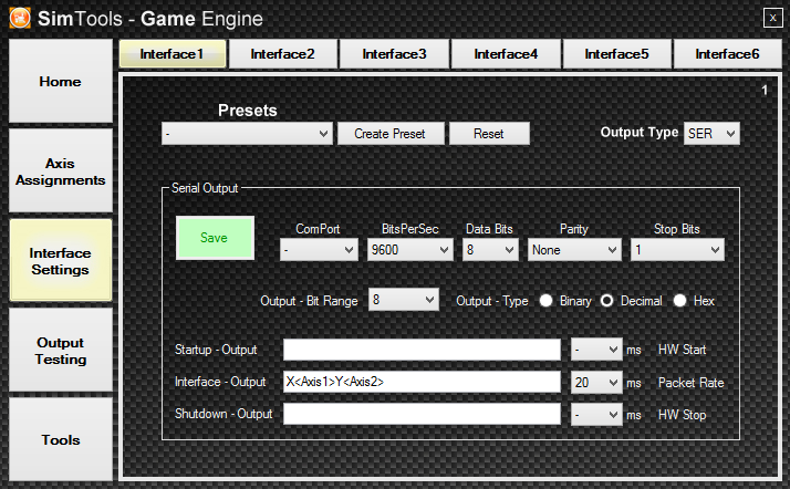

    @nicko_esx looking at your code this should work, just need to add your comport to the settings and save.
    Just checking noticed in the code you phrase it as x and y but code looks for x and s ?
    If it is yes then the output needs to be changed from y to s. Thats all.
    Plus we call lat force here a Sway DOF

    ok you just need to set axis correctly as in axis 1 needs to include yaw and sway only
    Then in the interface you just need the X<Axis1>
    On end you can do the S.
    If I get what ya mean.
