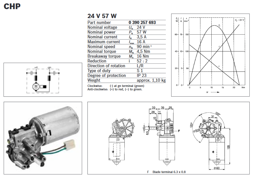

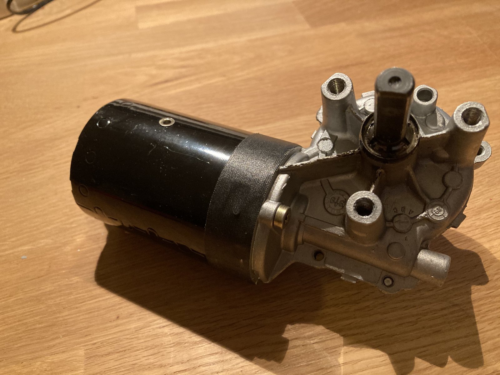

    I have used the following basic components:

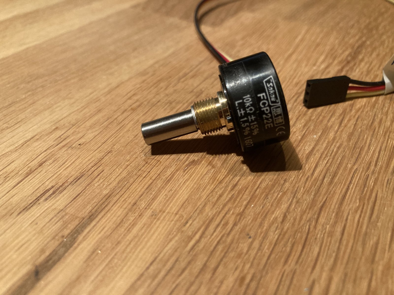

    3 x wiper motor BOSCH 0390 257 693 CHP 24V
    3 x potentiometer Sakae FCP22E 10K
    3 x BTS 7980B DC 43AH-bridge
    1 x Arduino Uno Board
    The truck wiper motors deliver nominal 4,5Nm and max. 16Nm torque. That should be enough :)
    The potentiometers have no mechanical stop and can be turned over more than 360°. This was important to use to avoid damage to the precision mechanics in case of hardware or software malfunction.
    The 43A motor drivers BT7980B do not reach their limits, because the wiper motors have a maximum current of 16A. This is safe.

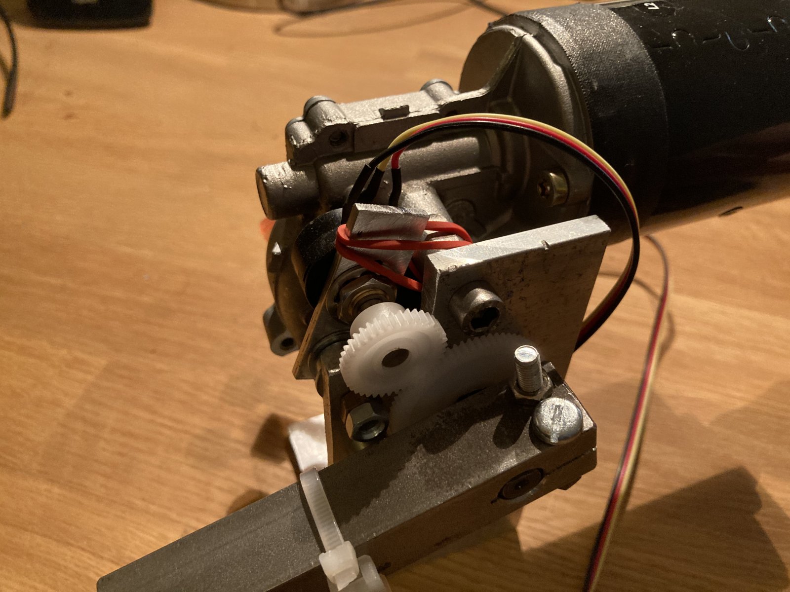

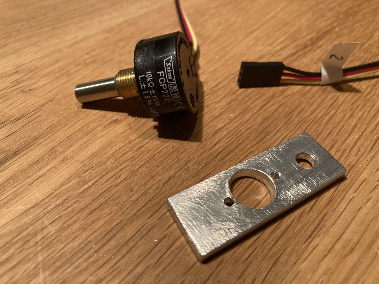

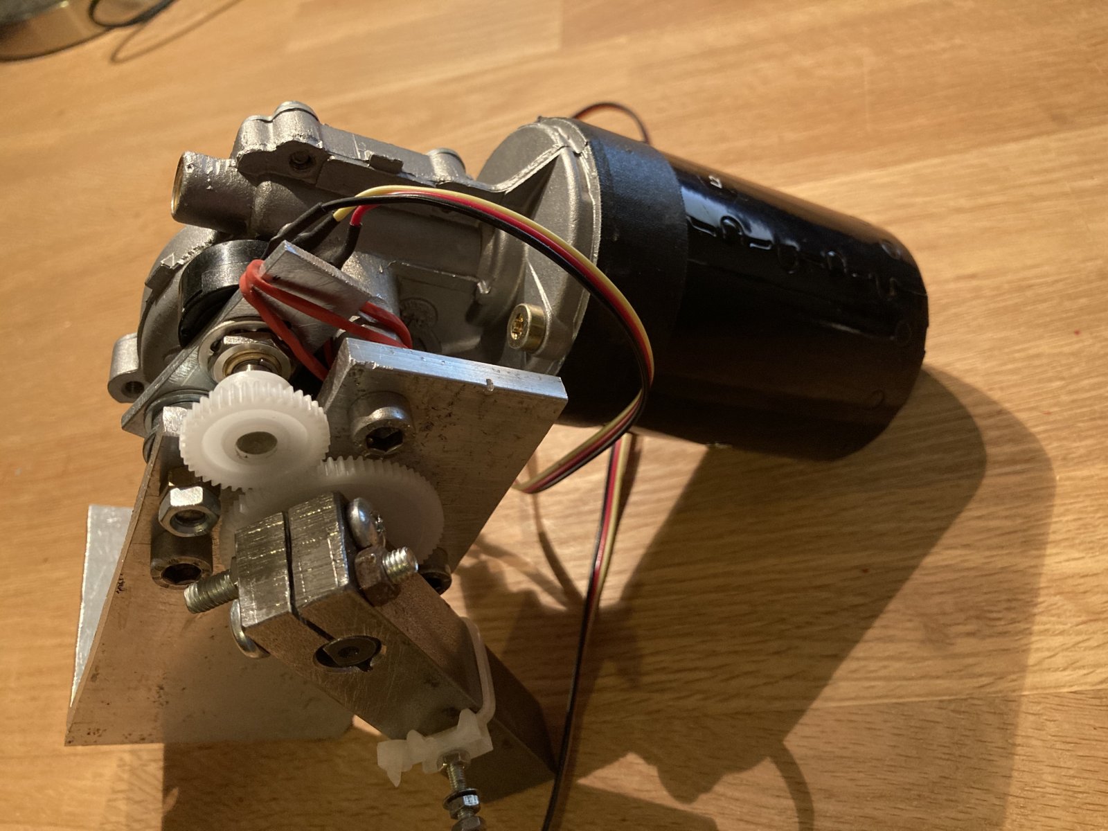

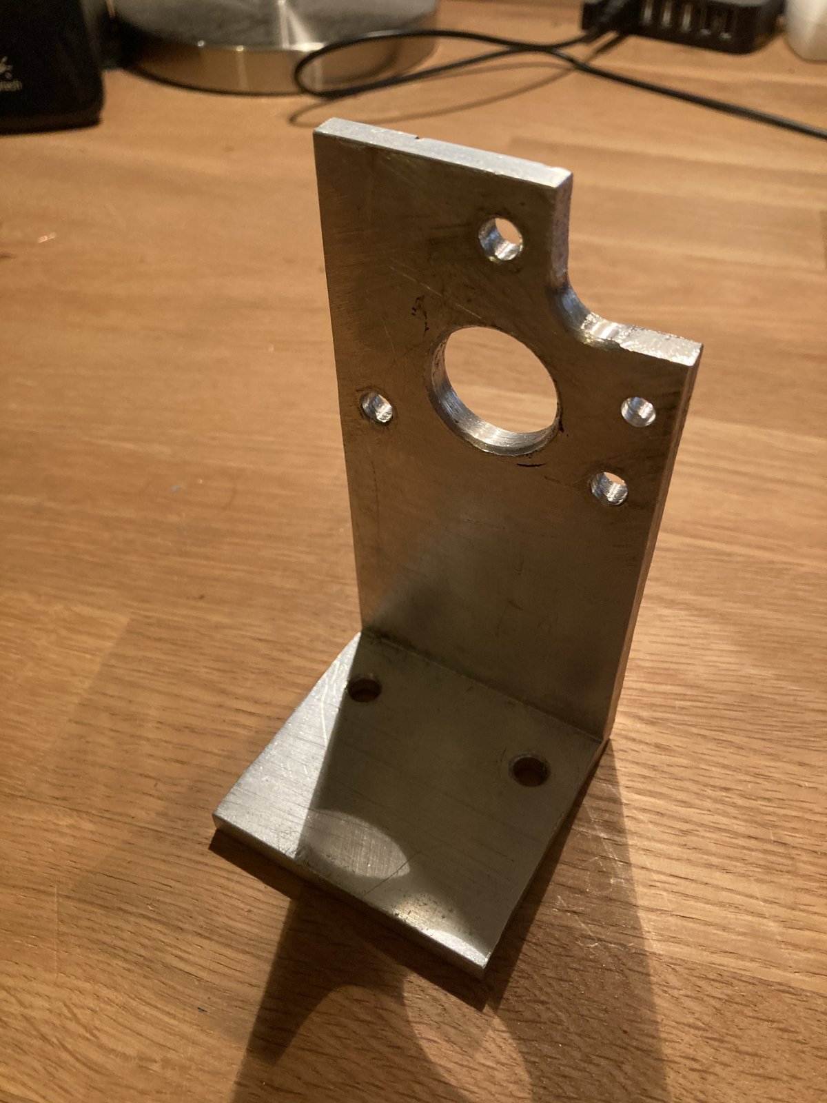

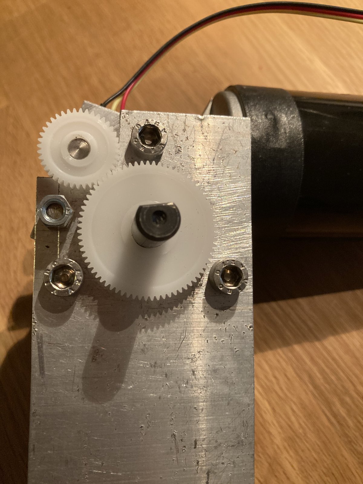

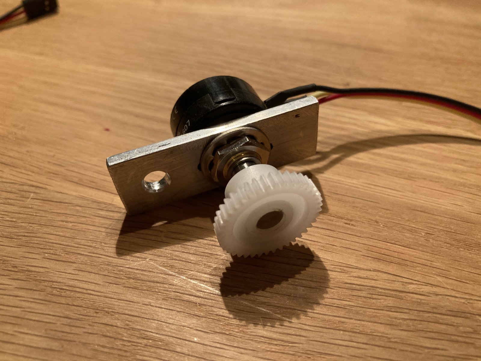

    I had initially tried to mount the potentiometers directly axially on the axes of the wiper motors. But this turned out to be difficult due to misalignments in the coaxiality. The bearings of the potentiometers are not very stable.
    Now I mounted the potentiometers on the side and they are movable. The lever arm of the potentiometer is preloaded with a small spring (at the moment with a rubber band). Another advantage was that I could adjust the relation between the wiper motor axis and the potentiometer axis by using gears.
    There are 72 teeth on the wiper motor axis and 40 teeth on the potentiometer axis.
    Thus the measuring range of the potentiometer is used quite well. With a rotation angle of 180° at the wiper motor I use 324° at the potentiometer.

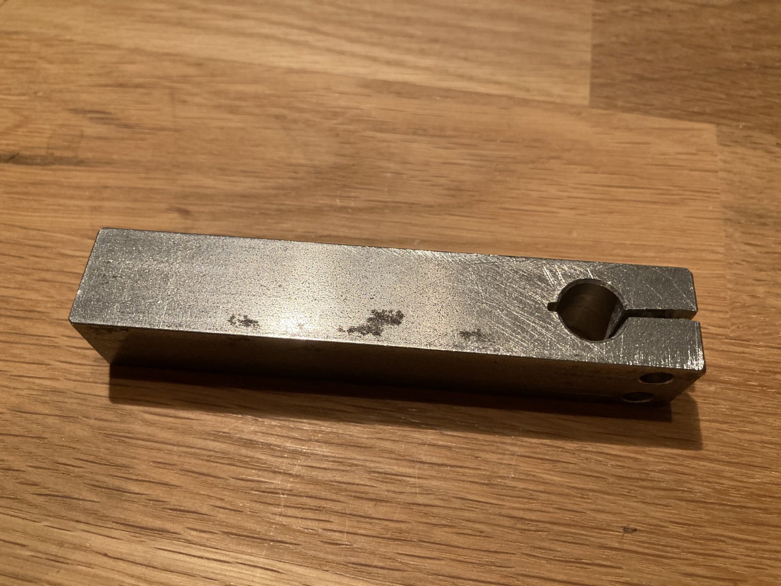

    The shafts of the wiper motors have a diameter of 10mm. On this I mounted a square steel 18x18mm made of a higher strength material C45K.
    The square steel is slotted and clamped with 2 screws M5-10.9. There are several online calculations for the slotted shaft-hub-connection in the net, for example:
    https://www.schweizer-fn.de/maschinenelemente/klemmverbindung/klemmverbindung.php
    At max. bolt pretension of the bolts the lever arm should not slip on the axle.

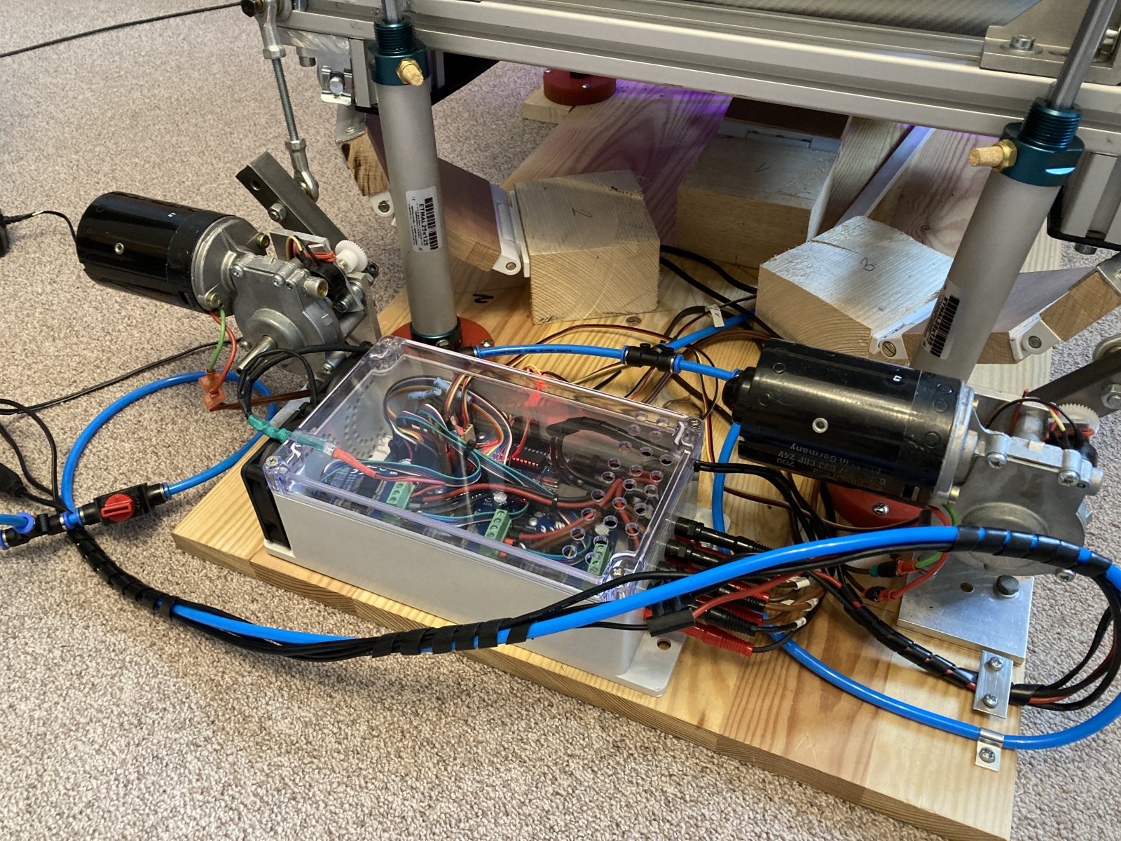

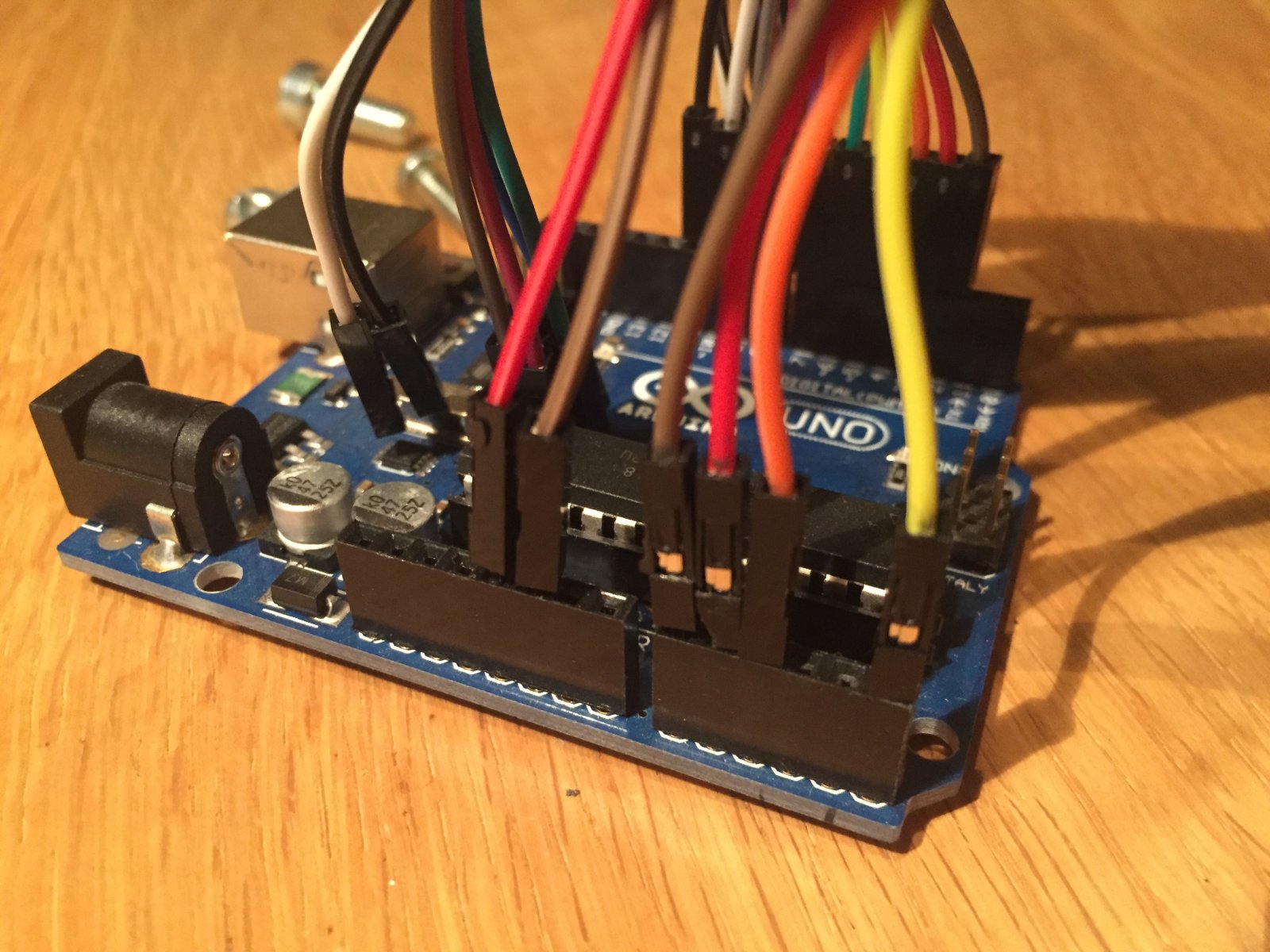

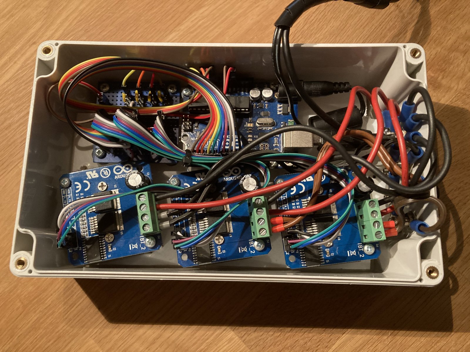

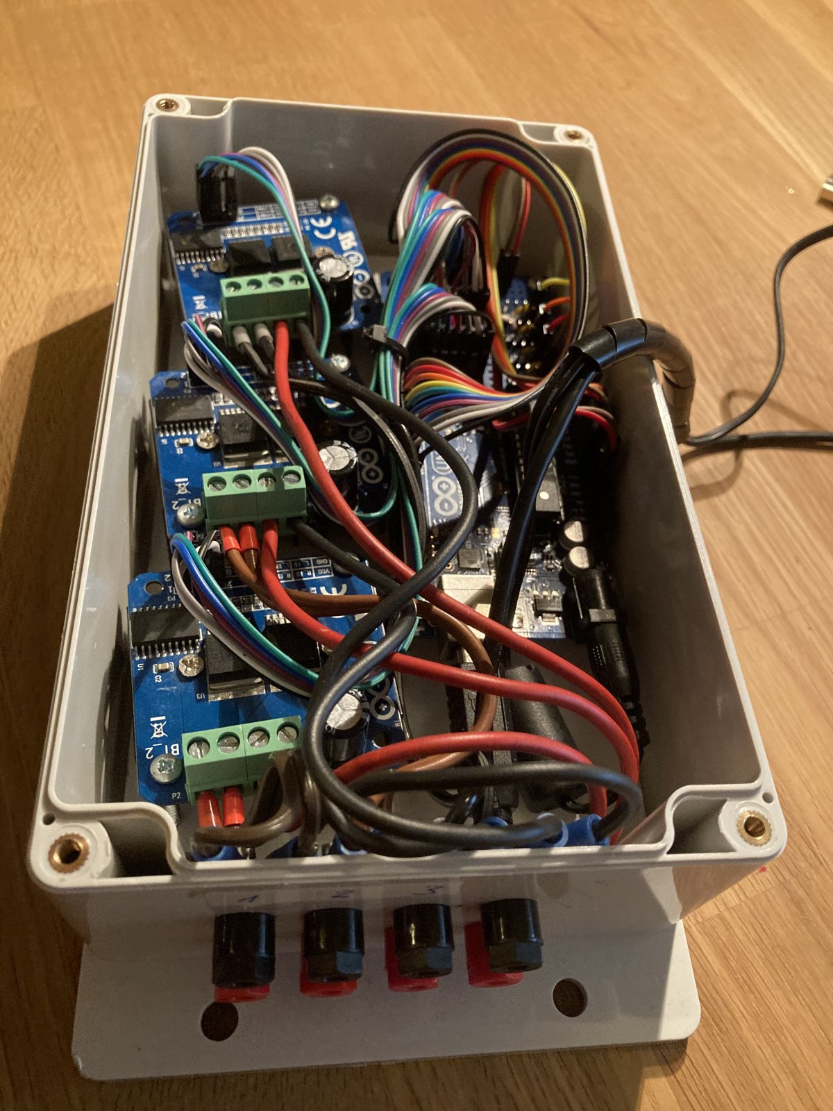

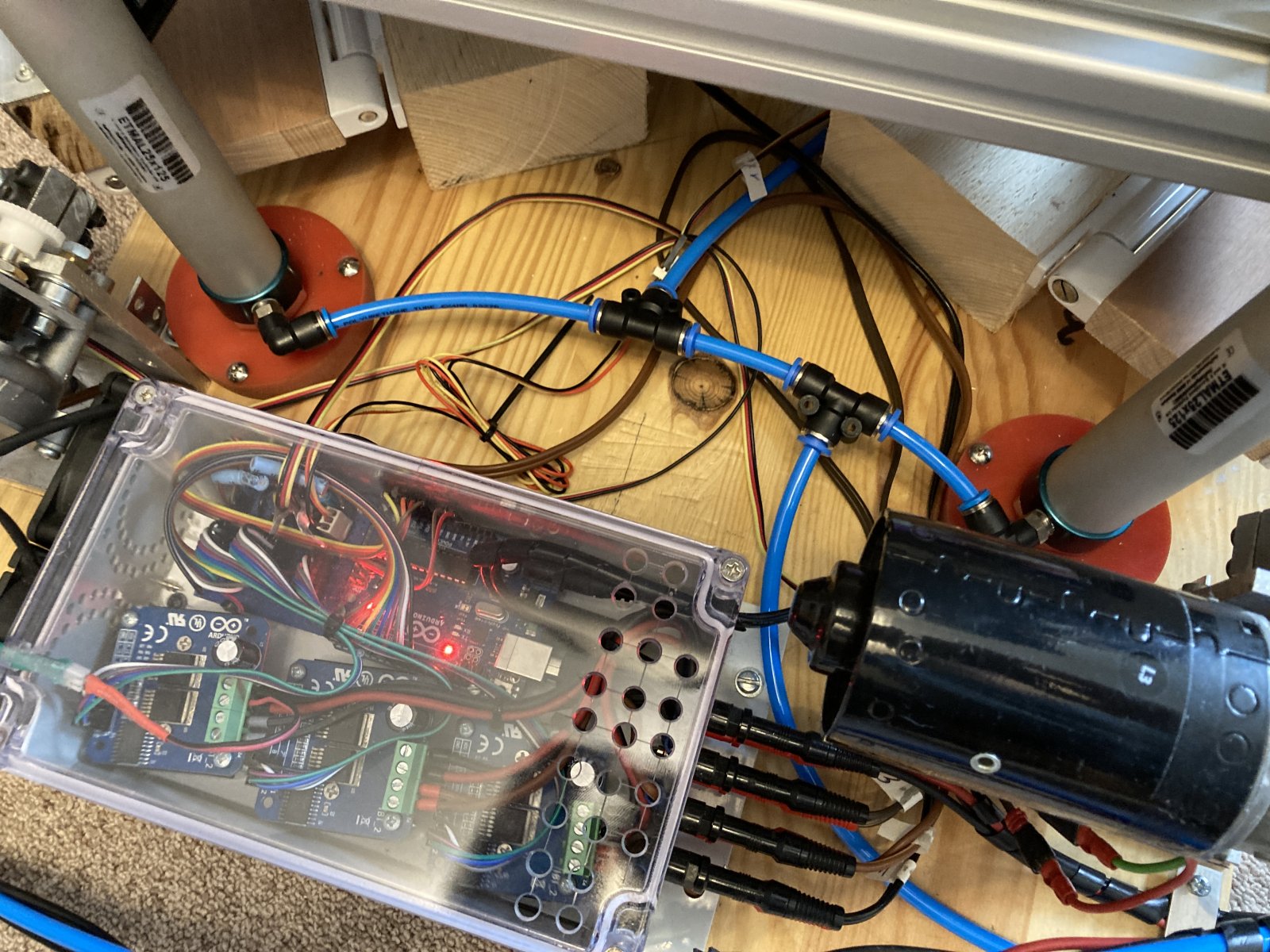

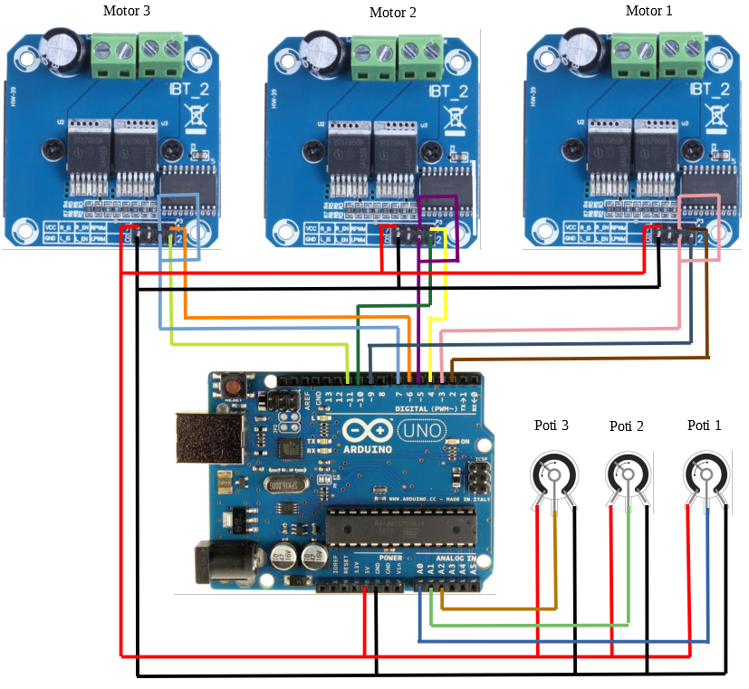

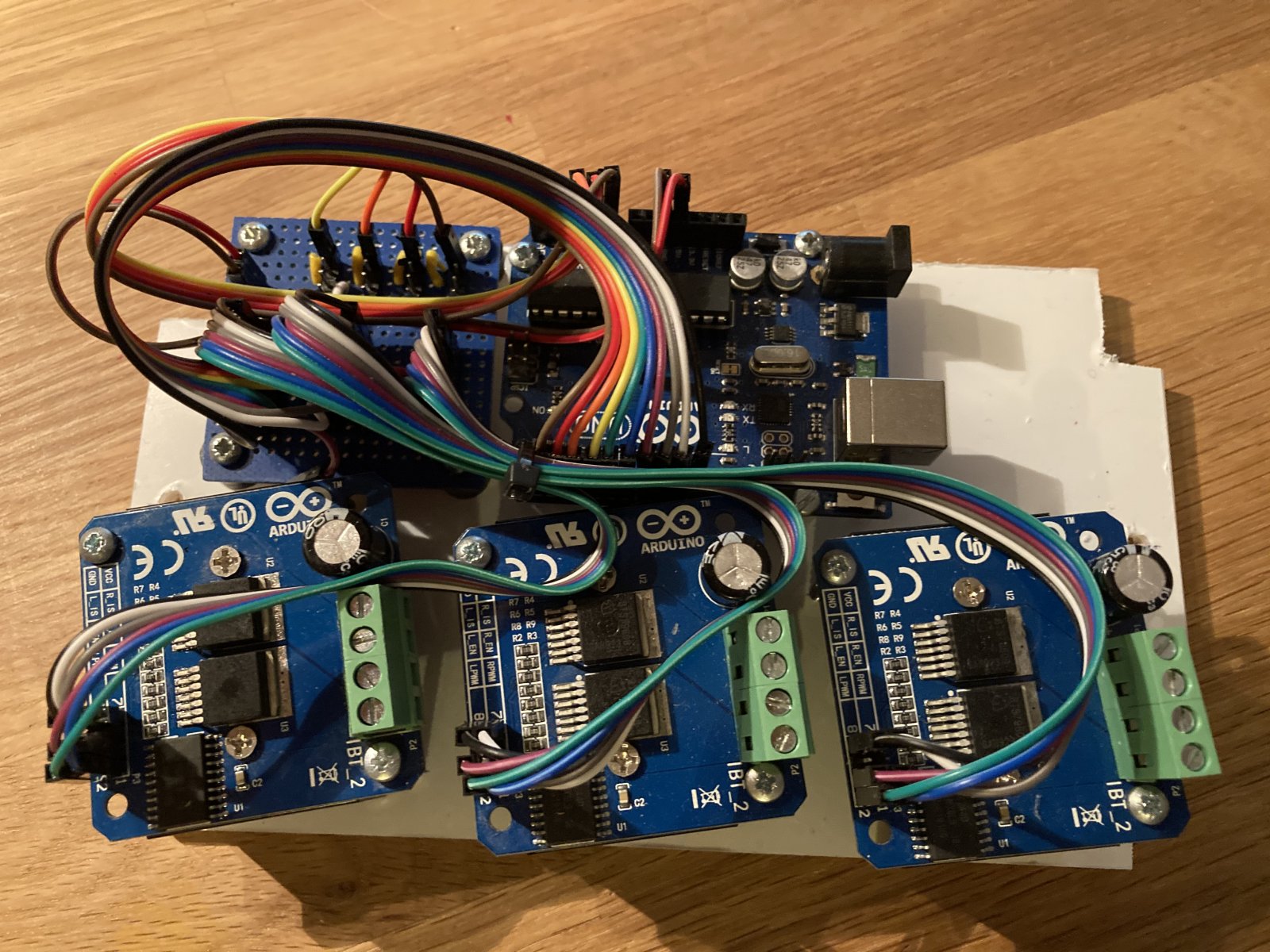

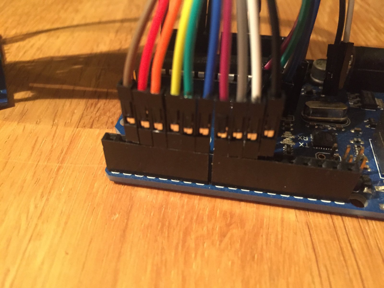

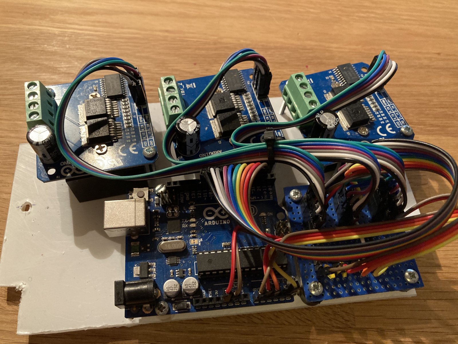

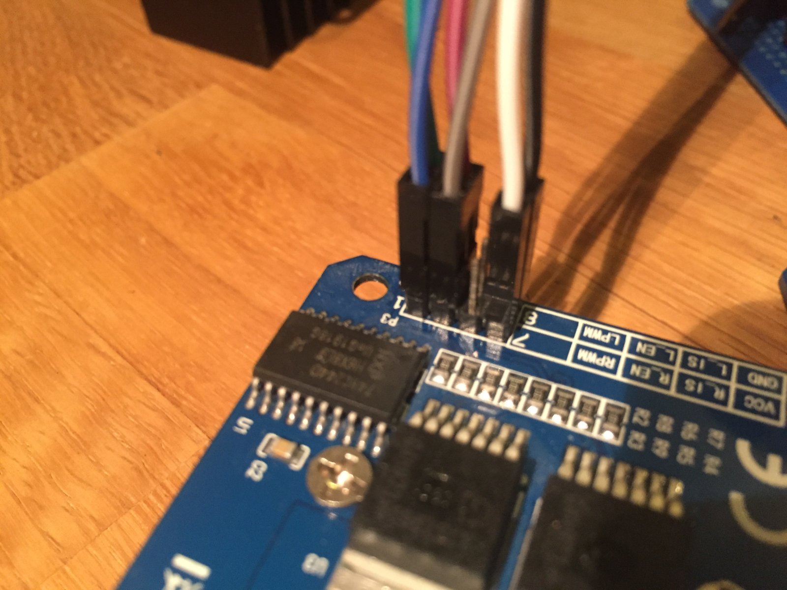

    For a clearer cable connection of the 3 motor drivers and the 3 potentiometers with the Arduino, I have created a small circuit board that contains all cable connections. Especially the GND and 5Volt connections of the Arduino are nicely distributed to the other components.

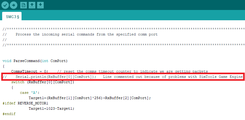

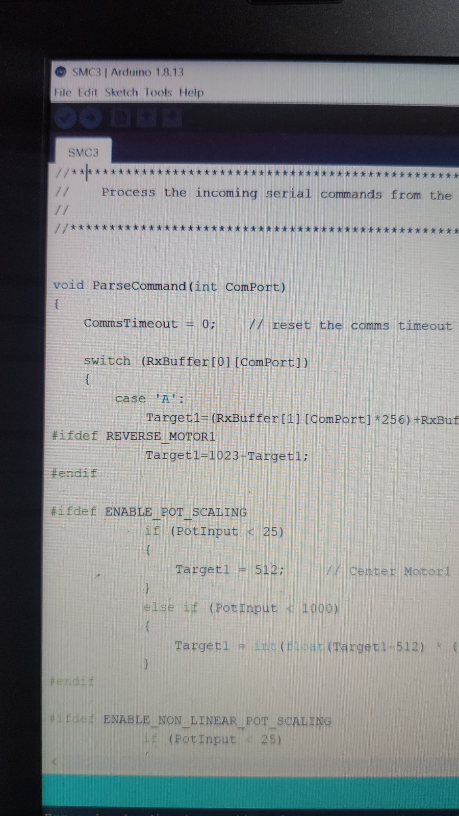

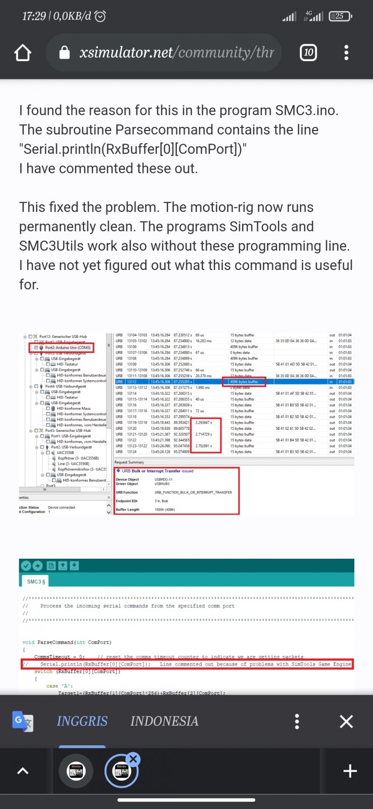

    My first test with one axis and the program SMC3Utils went without problems. Afterwards all other axes could be tested separately.
    Then I tried it with SimTools. With a little training I could link all 3 axes (Roll, Pitch, Heave).
    But here I had the problem that after about 15 seconds the movements of the motion rig were almost completely stopped.
    By using a USB analyzer I could see that the USB interface to the Arduino was the problem.
    The data rate dropped from 10ms to over 2 seconds.
    The Arduino board tries to send data to the computer at regular intervals and tries to reserve a buffer of 4096 bytes.
    I found the reason for this in the program SMC3.ino.
    The subroutine Parsecommand contains the line
    "Serial.println(RxBuffer[0][ComPort])"
    I have commented these out.
    This fixed the problem. The motion-rig now runs permanently clean. The programs SimTools and SMC3Utils work also without these programming line.
    I have not yet figured out what this command is useful for.
    But it works :)

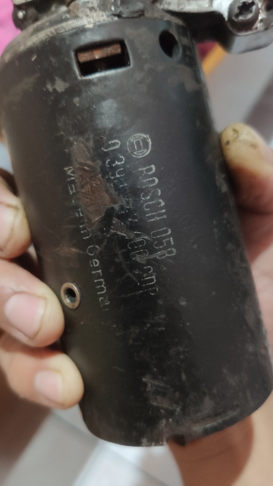

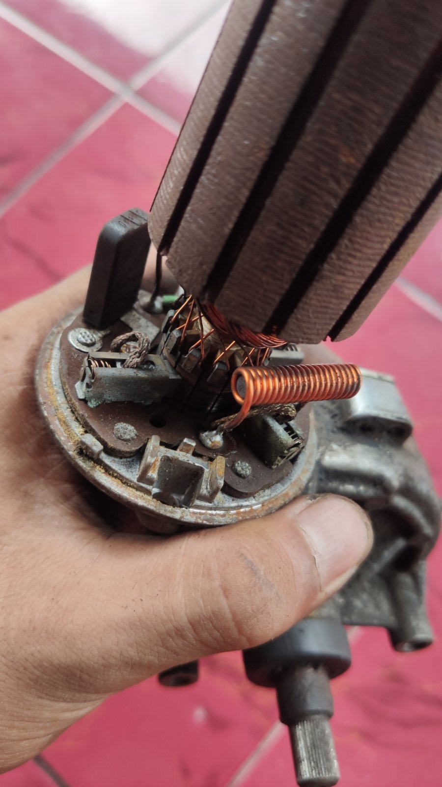

    Hi sir, very nice project, me too still build 2dof with wiper motor, and i too used wiper motor bosch, like this, how to wiring this? Because the wiper motor have 3 cold(carbon brush).

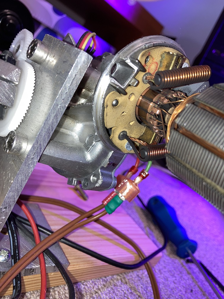

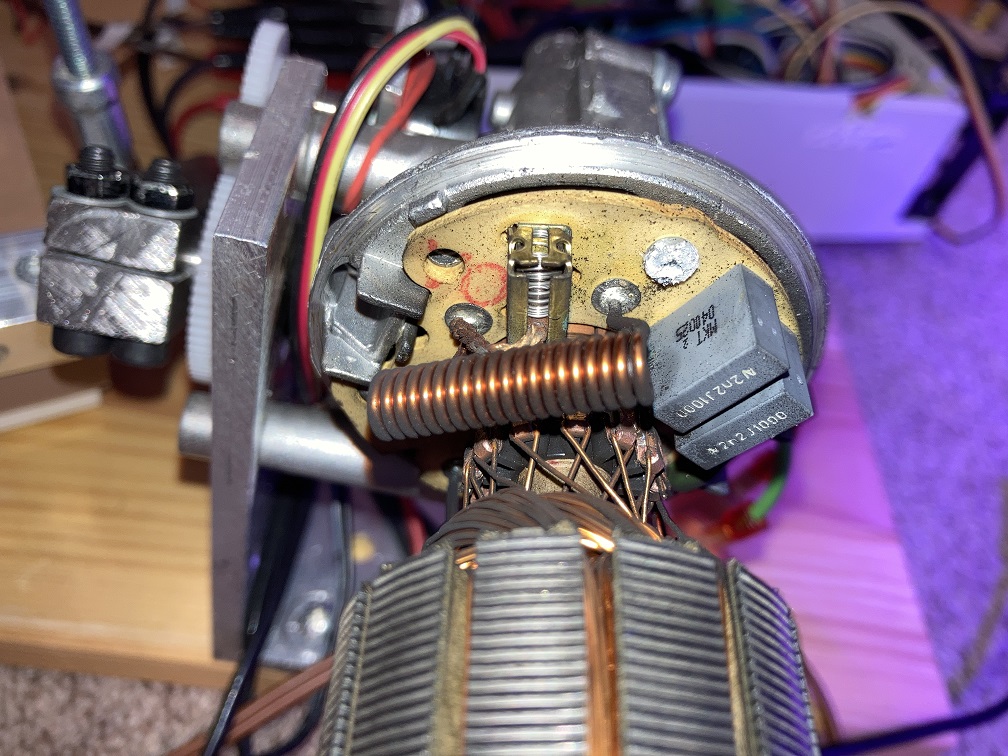

    sorry for late answer.

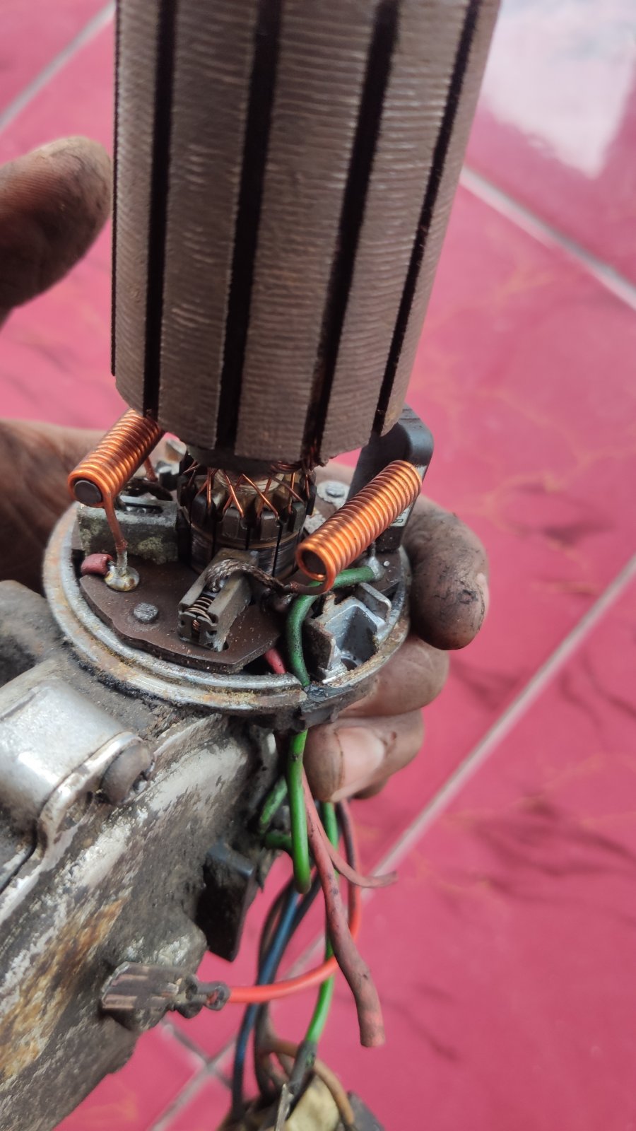

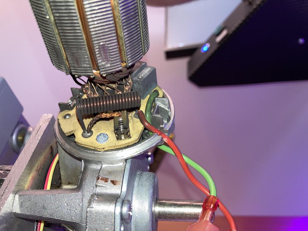

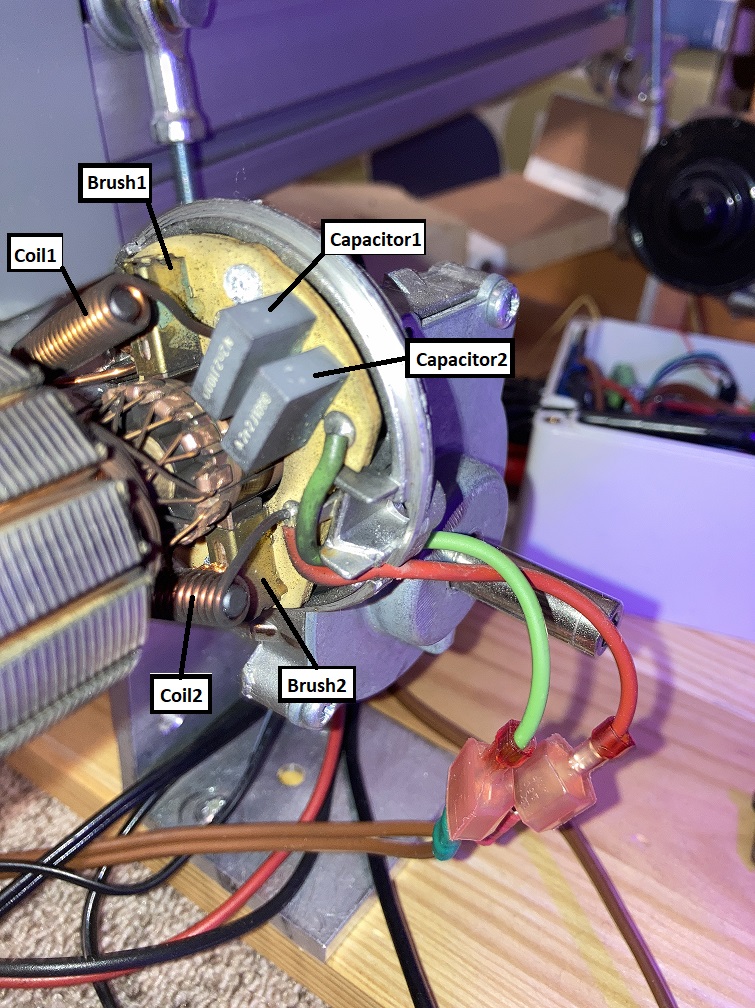

    Yesterday I disassembled one of my wiper motor. My wiper motors each have 2 brushes, 2 coils and 2 capacitors

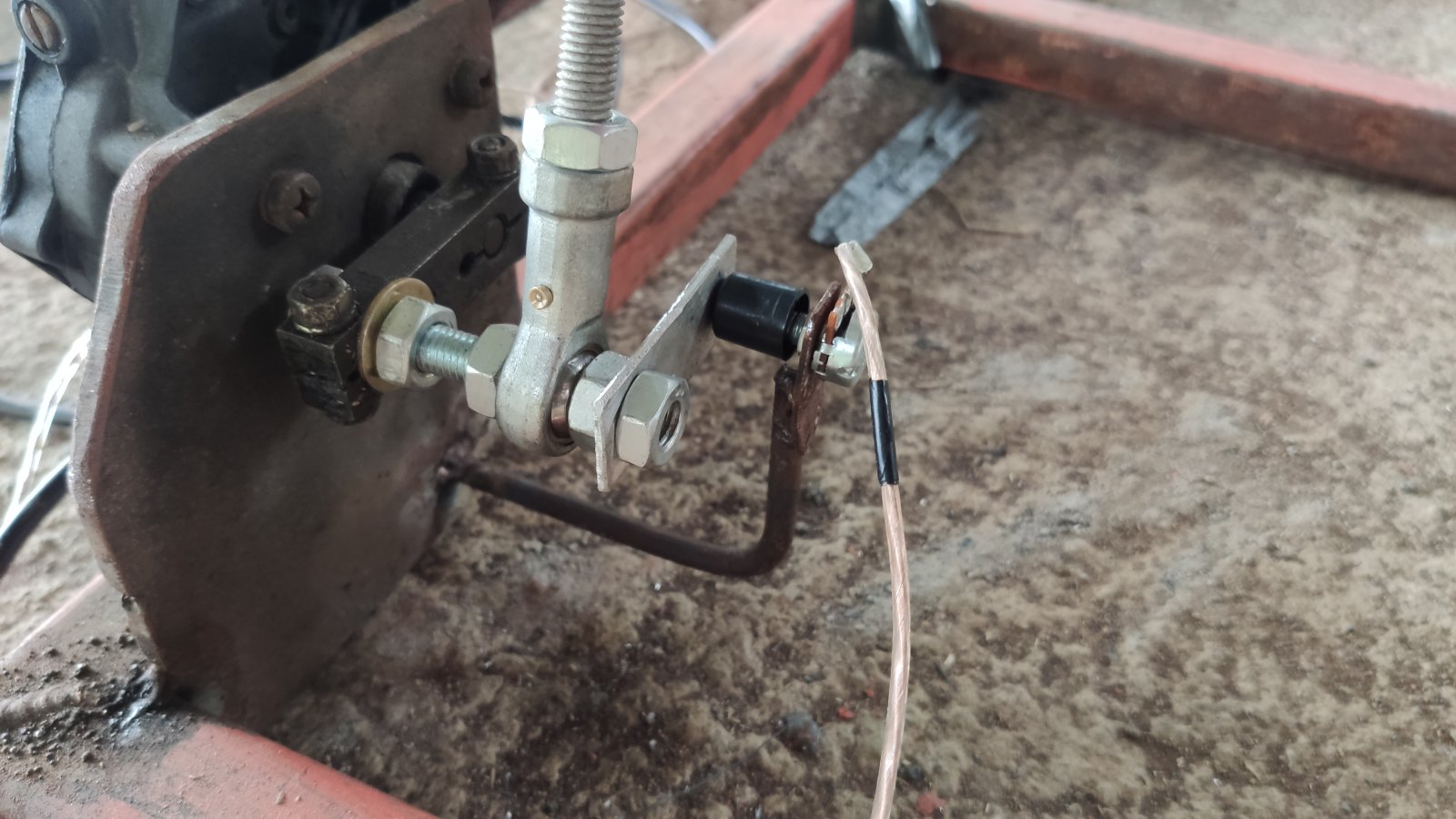

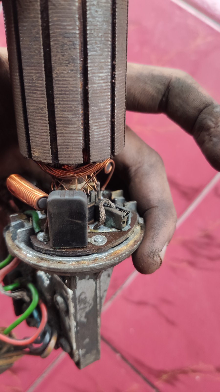

    Thank you for your reply sir, but i have cahnge my motor wiper too sir. But now i used 2 deffrent motor wiper ( deffrent body and rpm). But yesterday i found motor dc 24v worm gear( ex wire drive big MIG welding) , but the worm gear cannot selft locking sir. It is posible to use sir??
    But on motor wiper on the worm gear with selft locking sir.

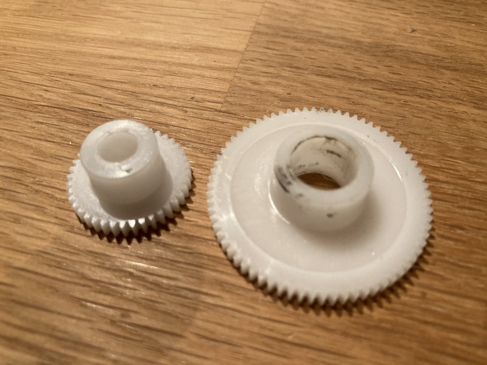

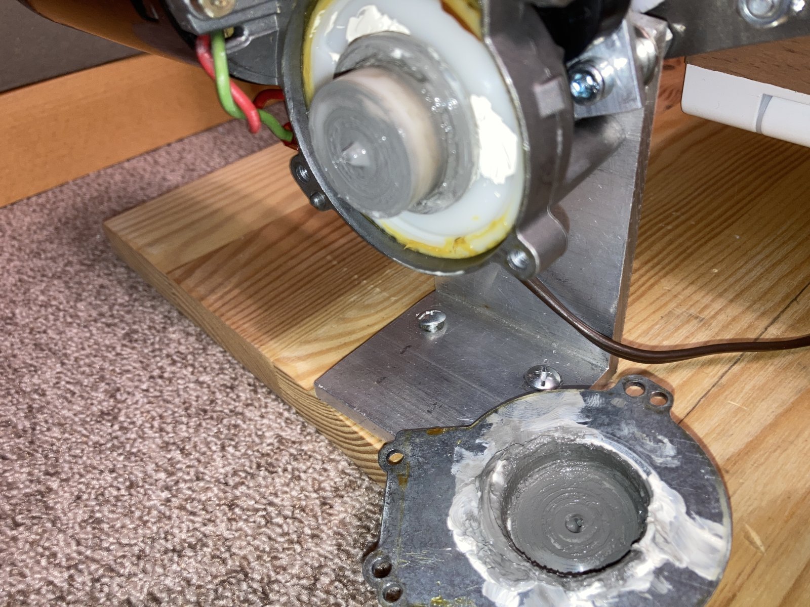

    I have removed the self-locking mechanism from all my worm gears

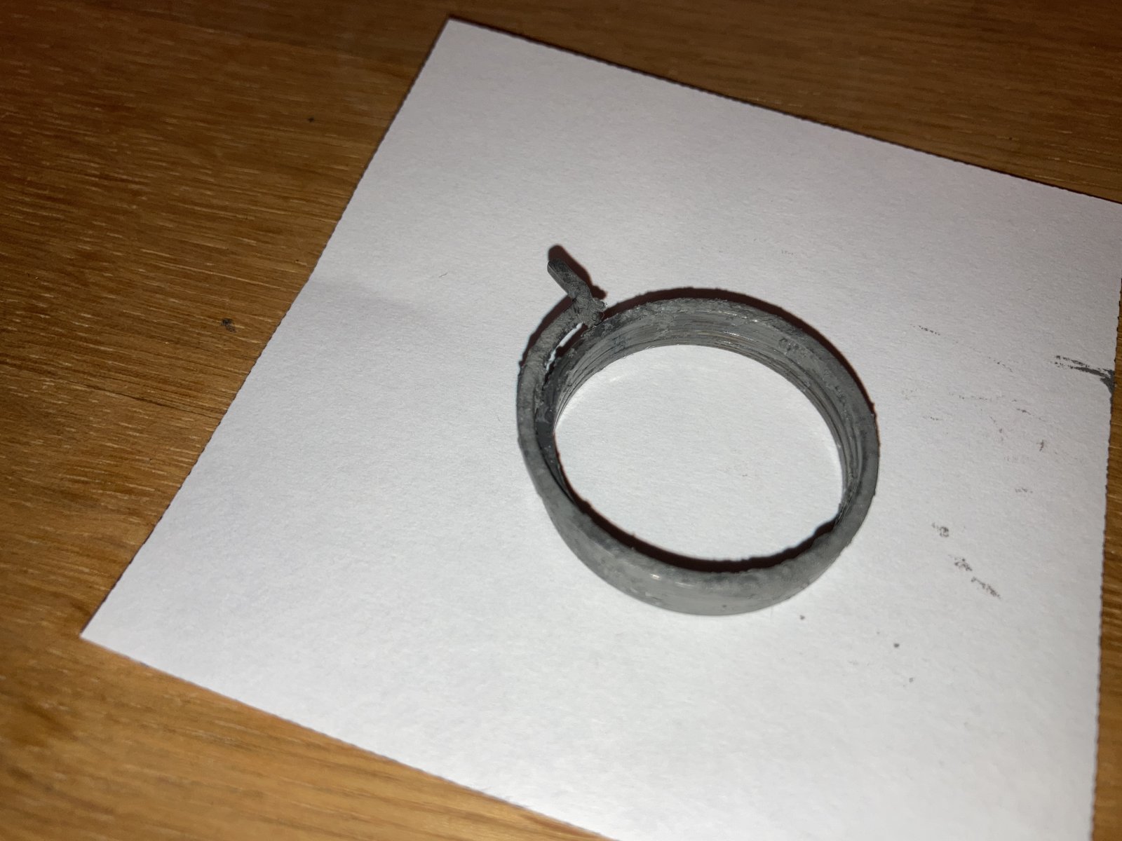

    I was meaning that I removed the mechanical selflock from the wiper motors (see pictures).
    The wiper motors usually only rotate in one direction and are secured against an external force in the opposite direction.
    You probably mean the software lock. You have to configure your motors with the SMC3 Windows Utility to prevent overturning.You have to prevent that the motors turn over the limit.

    sometimes the wiper motor doesn't move at all, after I checked the smc3 utility, the pwm feedback from the potentio is not detected (sometimes it happens on motor 1, sometimes motor 2, sometimes at the same time) I have to turn off the arduino, laptop, and others if I turn them back on . here I use bts7960. did the bts7960 shut down? I don't think so because pwm feedback is not readable in smc3 utility. after I carefully read your post again, I found this (see picture). maybe the problem is there??
    I have check smc code, but did't see that code to be comment sir.

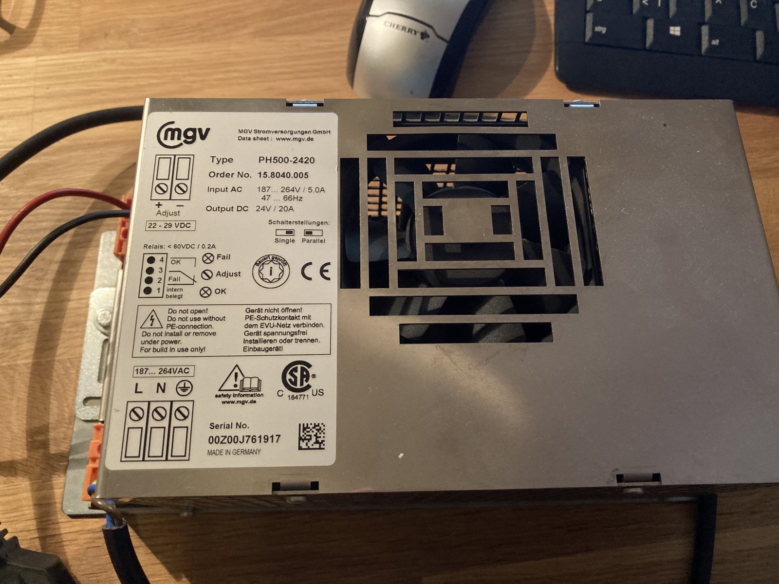

    However, I had to reduce the PWMmax value up to 150, because I often had short dropouts at one motor.
    The power supply also shut down for a short time and then turned on again.
    I have not yet found the actual cause.

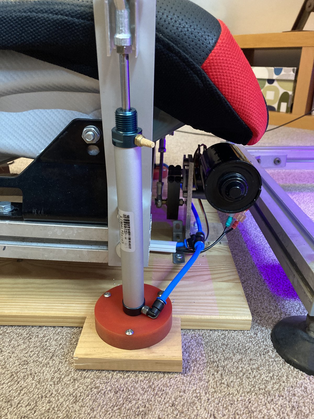

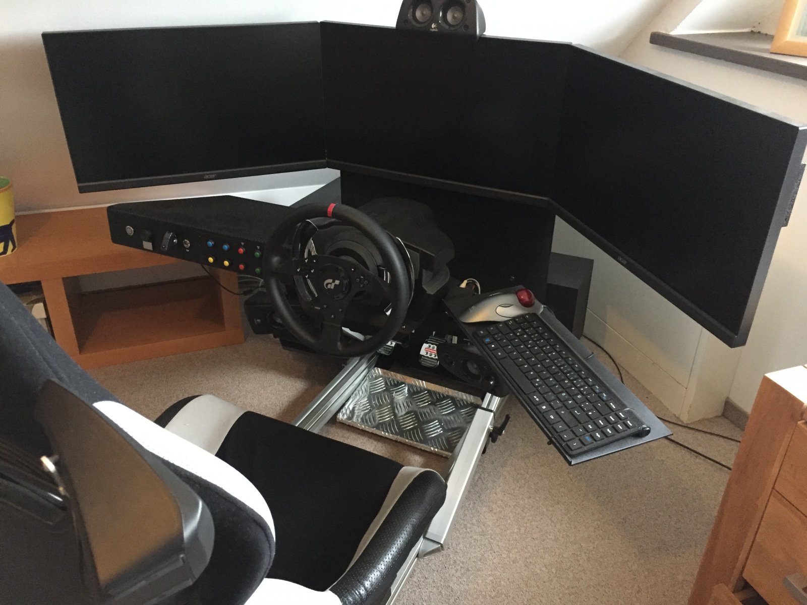

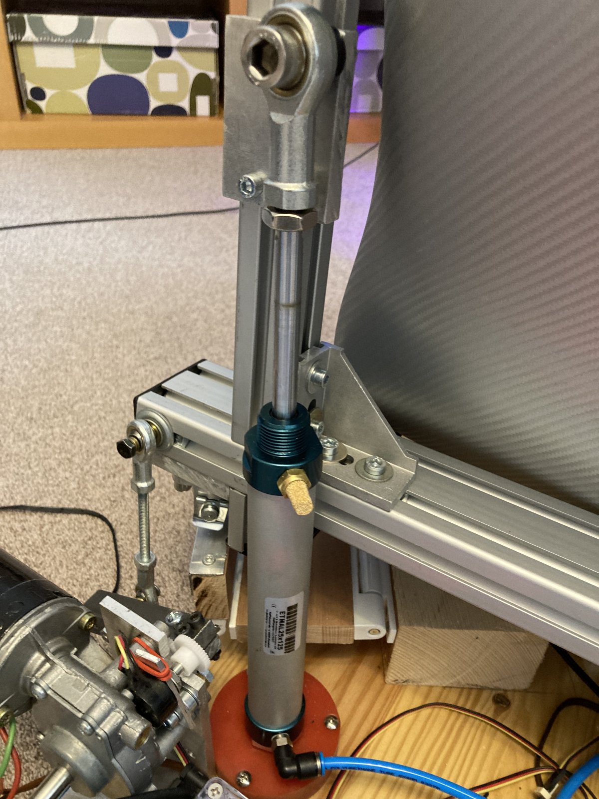

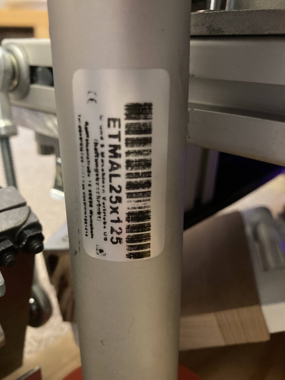

    I can now present you my finished racing seat.
    Since it is a 3-DOF seat, of course the whole body weight loads the wiper motors.
    For this reason, I have also installed pneumatic cylinders that compensate the whole body weight. In the back there are 2 cylinders D=25mm and in the front there are two cylinders D=16mm. The counterforce can be adjusted with the air pressure (approx. 6-7 bar).
    Thus the wiper motors are loaded only with the movement forces.
    It works well.
    A little more guide stability at the hinges is still to come

  18. RacingMat
    2,237
    21,020Coins
    Did you find a cylinder without damping? Because it'll go against the movement...
  19. krause-a
    krause-a New Member Gold Contributor
    Jul 23, 2009
    13
    46514 Schermbeck, Germany
    124Coins
    +27 / 0 / -0
    3DOF, Arduino
    Yes, I have chosen pneumatic cylinders without damping. When removed, they can be moved very easily
    Aircylinder ETMAL16x125
    Aircylinder ETMAL25x125
