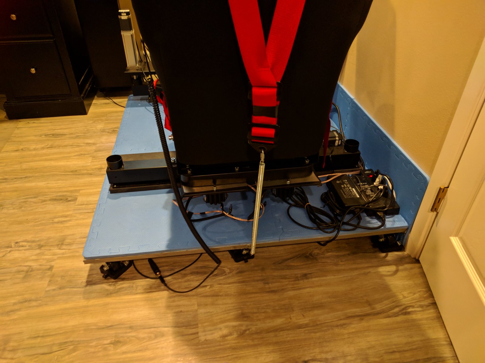

    I am researching adding tactile transducers to my T1000 3DOF system. My goal is to get maximum information possible from each car wheel (lock, skid, surface). The biggest question is, where do I mount transducers on my system?
    I am considering:

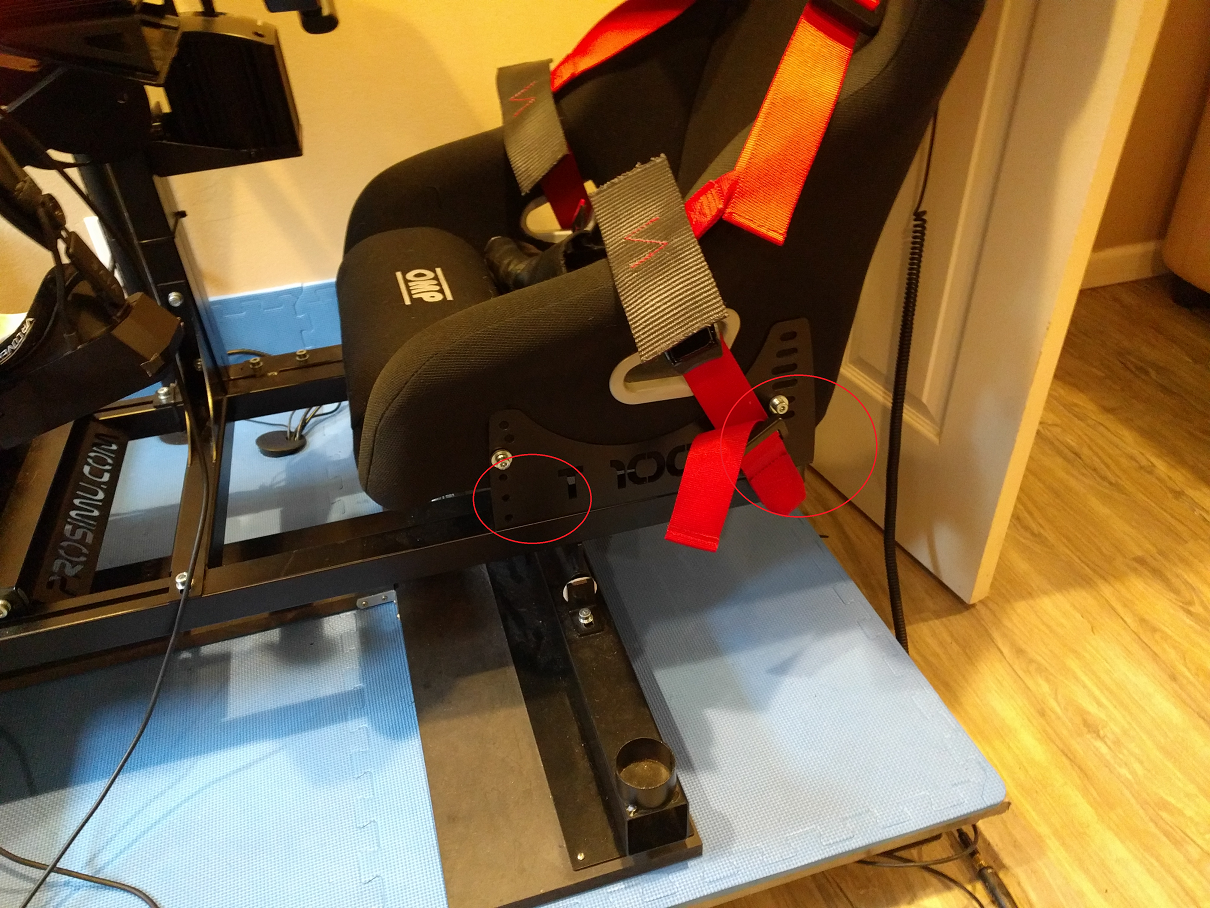

    * mounting them at the sides of a seat (as attached in picture), but I am concerned that since they will be close to each other it will be difficult to tell front tires from rear tires.
    * mounting 2 transducers near the front actuators, and 2 at the sides of a seat?
    * mounting all four actuators at the base of a platform my system seats on? How hard do shakers shake? If they are strong, that feels like most realistic approach, no?

    @PetroVitallini - could you be kind to tell me what diameter bolts/nuts I need to use to attach LFE Mini to the metal plate? I'd like to get hardware before I get transducers, I think they're ~M6, right?

    I'm not at home at the moment, but I believe I used M6 size bolts. This is a link to the mini-lfe manual: https://thebuttkicker.com/buttkicker-mini-lfe/ you find the PDF under specification tab. It says 1/4 inch holes which is 6,35 mm so M6 should do. If you want to get washers don't buy them to big or else you might get problems fitting them. I believe the buttkickers have sinkholes around the mounting holes as well if I remember it correctly.

    As for mounting you can increase the forces felt by mounting them counter levered. This might also change the resonance on your rig which might turn out great or lead to anoying vibrations. My old racing seat looked like swiss cheese after I was finished experimenting.

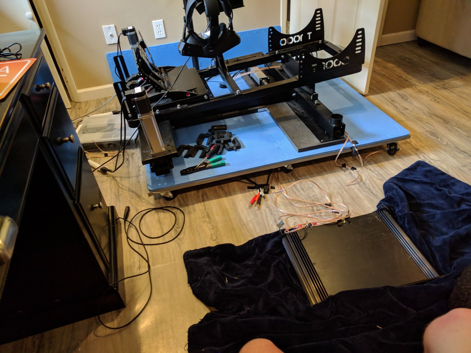

    Thank you Petro. Could you share frequency ranges you used for Vibes in Vibe Creator, and maybe share explanation why?
    Meanwhile, upgrade in progress.

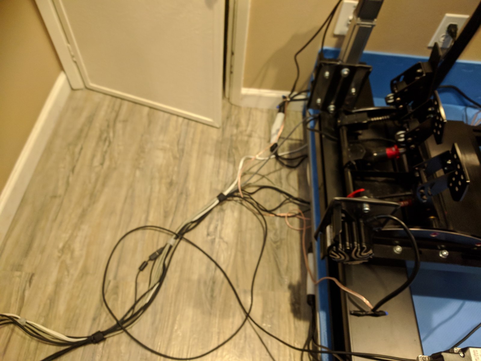

    Ah! You start with cable management right away. That is alot smarter than what I'm doing. My rig looks like someone dropped a bowl on spaghetti on it hehe.

    Nice you noticed my approach, I typically do a lot of planning, reading, thinking before I do anything. Screw ups are still unavoidable (had to go to hardware store 3 times rather than once, for example), but that's just the way I roll.

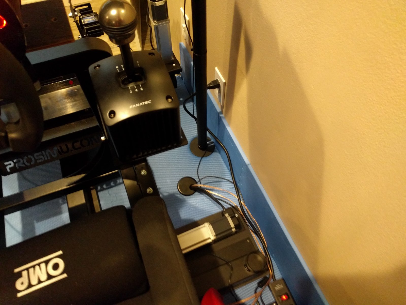

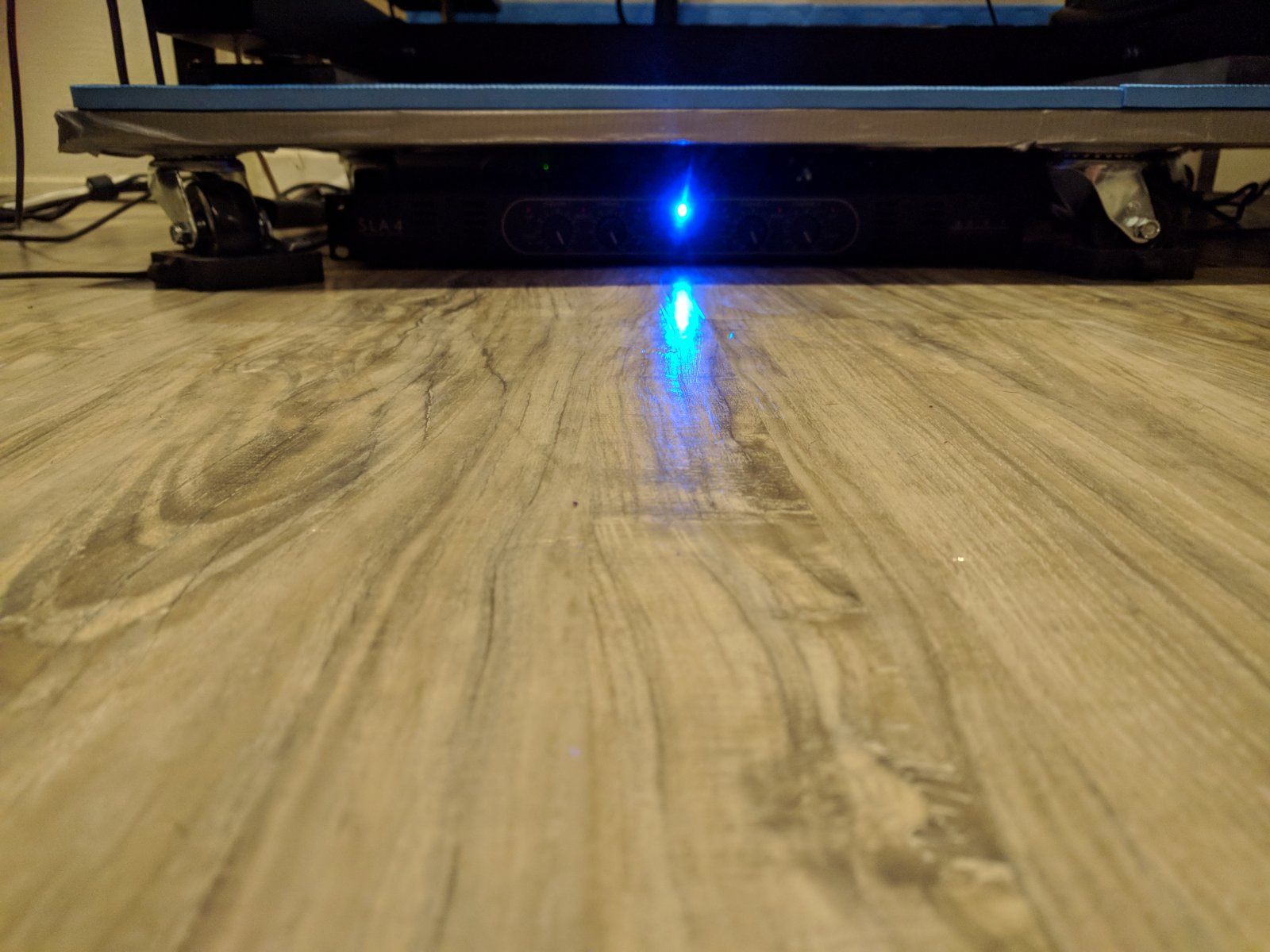

    Well, more wires and stuff added to my rig, but now everything is tidied up, aside from maybe a bit of cable straps here and there. Also, the front mount is temporary, until I move to another type of pedals. When that happens, I plan to move transducers onto the pedal plate. The whole process of figuring and designing all of this was really fun and satisfying :)
    So, what do I think about transducers? Well, it depends on whether rig has motion capability or not. When I turn off motion, I must admit shakers add quite a bit of detail and feel of being actually in the vehicle, honestly I did not expect that.
    Now, with motion it is different. In my setup, I already get engine vibration, shift punch, road feel from the game physics via motion. And in my subjective opinion, that feels more realistic than what is coming from the vibro motors. For example, in motion I can tell which way engine rotatres. I would say transducers are a nice touch, but 97% of the info I get from the motion, and remaining is just a cherry on the cake. Probably the biggest improvement is that now when I am going over bumps/kerbs, I get more feel of the rear, like stuff is happening behind me. Probably, this is especially big deal to me, because my rig is 3DOF. RPM/Shift effects are nice, but I am realism freak and I do suspect those effects are somewhat artificial. I spoke to a driver who drove GT3, and he confirmed that there's not that much engine vibration (it is not 1932 after all), what was impressive is the sound of the engine (although one might argue vibration is the sound as well).
    Two lowlights is that to my surprise, neither Game Vibe nor SimVibe (from reading manual) communicates wheel lockup/skid. Those are the very effects I needed from the transducers. However, I am 100% sure wheel lockup can be implemented and will reach out to devs. Another lowlight is that 3D separation is not very clear, but I think this is just how real life physics is.
