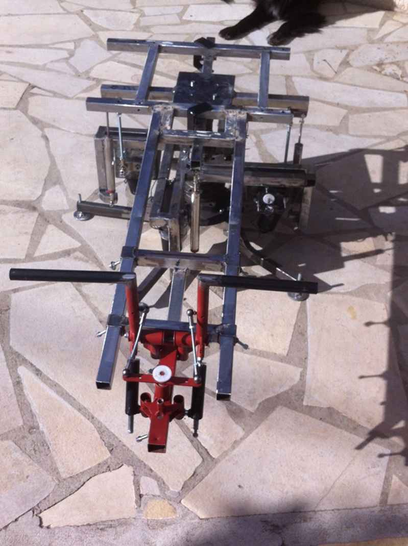

    Hello everyone,
    First, excuse me for this english issue from Google.
    Thank you to all those who have come here to share their projects, they were valuable sources of inspiration and mining information.
    We recently patented PPL and piloting of DR400 and dr500.
    We wanted to create a dynamic simulator, to prolong the pleasure mania here.
    The frame is welded, made by honey.
    We chose an angle of 10 ° for pitch and roll. Yaw set.
  2. tian
    tian New Member
    Nov 30, 2014
    9
    30250
    357Coins

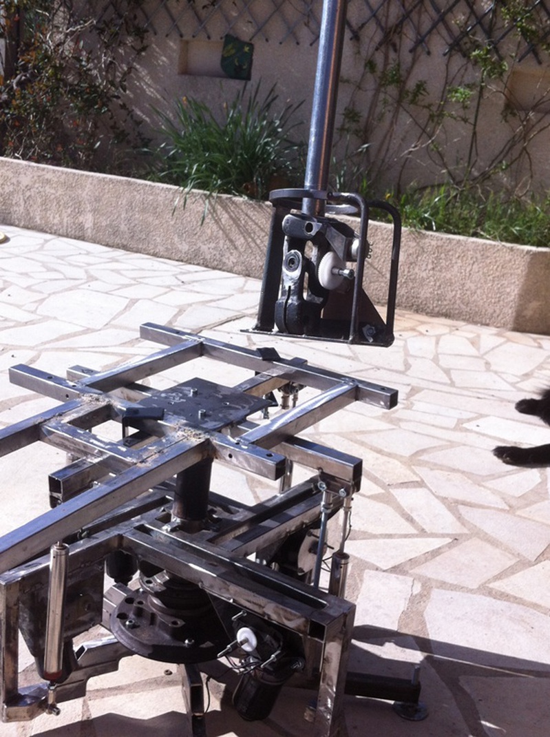

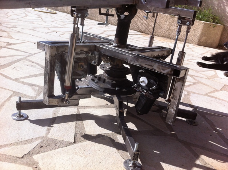

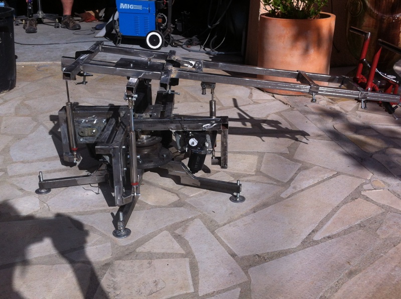

    We use the following material:
    1/2 transmission shaft (pitch and roll)) and a front hub (yaw) Land Rover.
    4 wiper motors 12V 48W (recovery). cams 4 cm. alpha 10 °. Maximum weight 130 kg
    Engine torque estimated at 9.16 NM
    A big thank you to Richard for his presentations and computational assistance by email
    The forces to be calculated: 130 x sin10 ° = 130x 0174 = 22.6 KGF
    Lever arm: 4 / tang10 ° = 4 / 0.176 = 22.70 cm
    Distance 4.53 cm
    Spring force: 196 Nm-20 Nm
    Maximum diameter spring for insertion into tubes available: 18.5 mm
    4 springs retained C 183 220 1016 Vanel has ordered from springs (stiffness 0.391 / mm x 45.3) = 177.1 Nm
    16 Rod ends type steel UNIBAL ordered from ECMU-CSR (8 of 8 and 8 of 6)
    A car seat bacquet
    Imagination, scrap metal, a sewing machine (welder

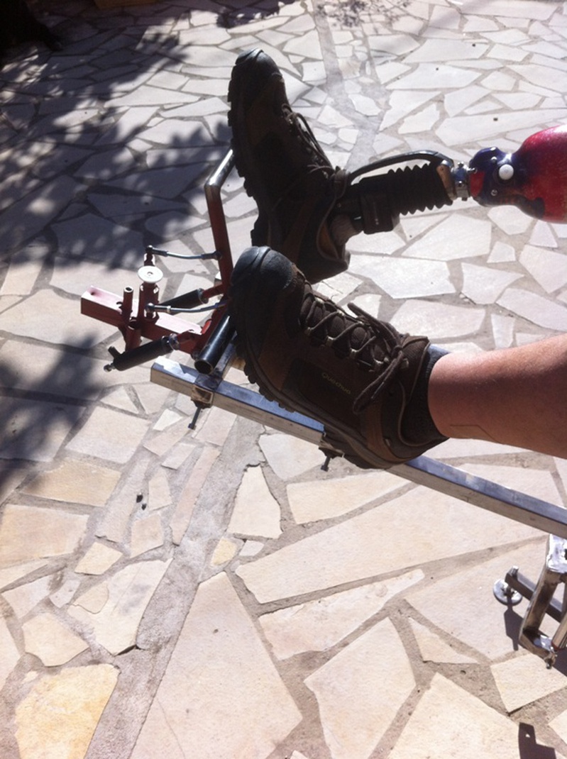

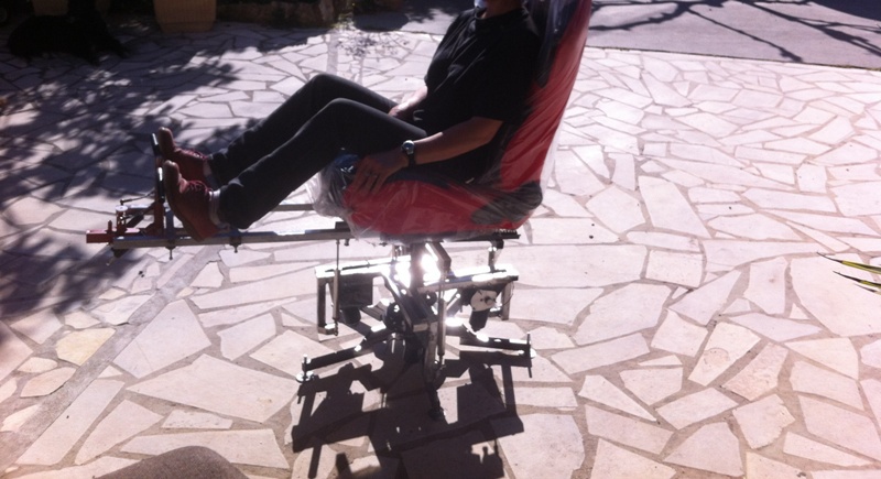

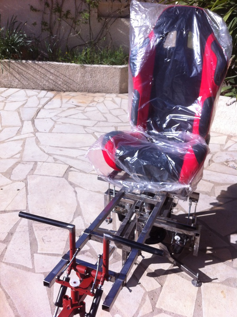

    We are back .
    This project is definitely very time !! Well, the springs are mounted , settings and effects about right , we can now have fun on flight simulator !
    We tested this morning the handle connection and rudder , made possible by hacking a ew3170 mdr.gif joystick ( photo ))
    Sir told me I 'm the only girl he knew who accepts the mess caused by all this love.gif
    It will then be the screen door dedicated to the dashboard , boxes for gas , brake , mixture , no variable, you name it. I need to order an additional joystick ew3170 .

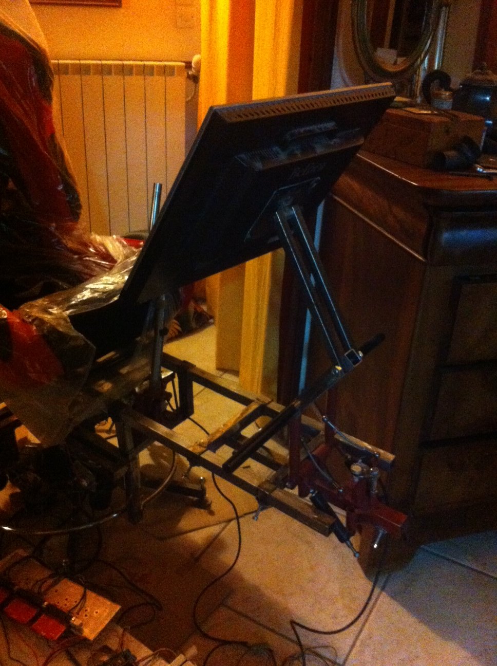

    Here
    The adjustable screen support
