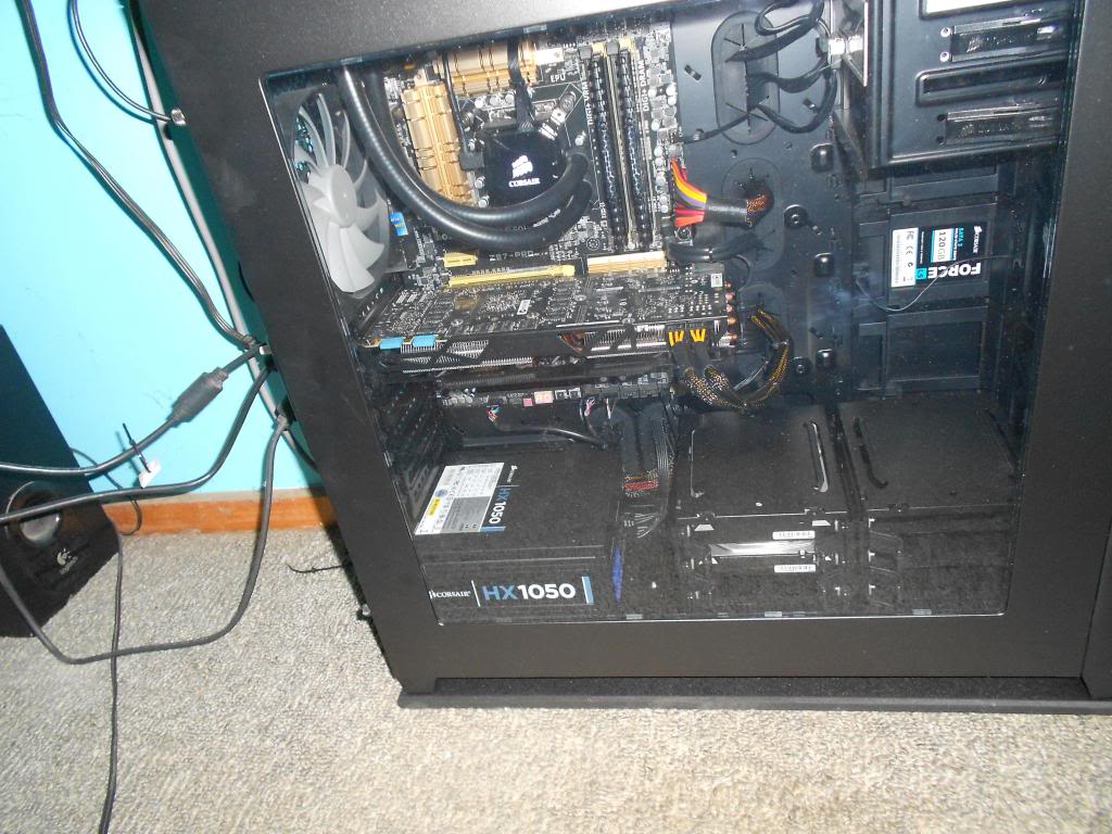

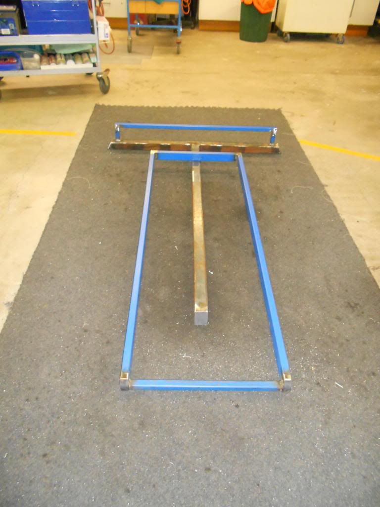

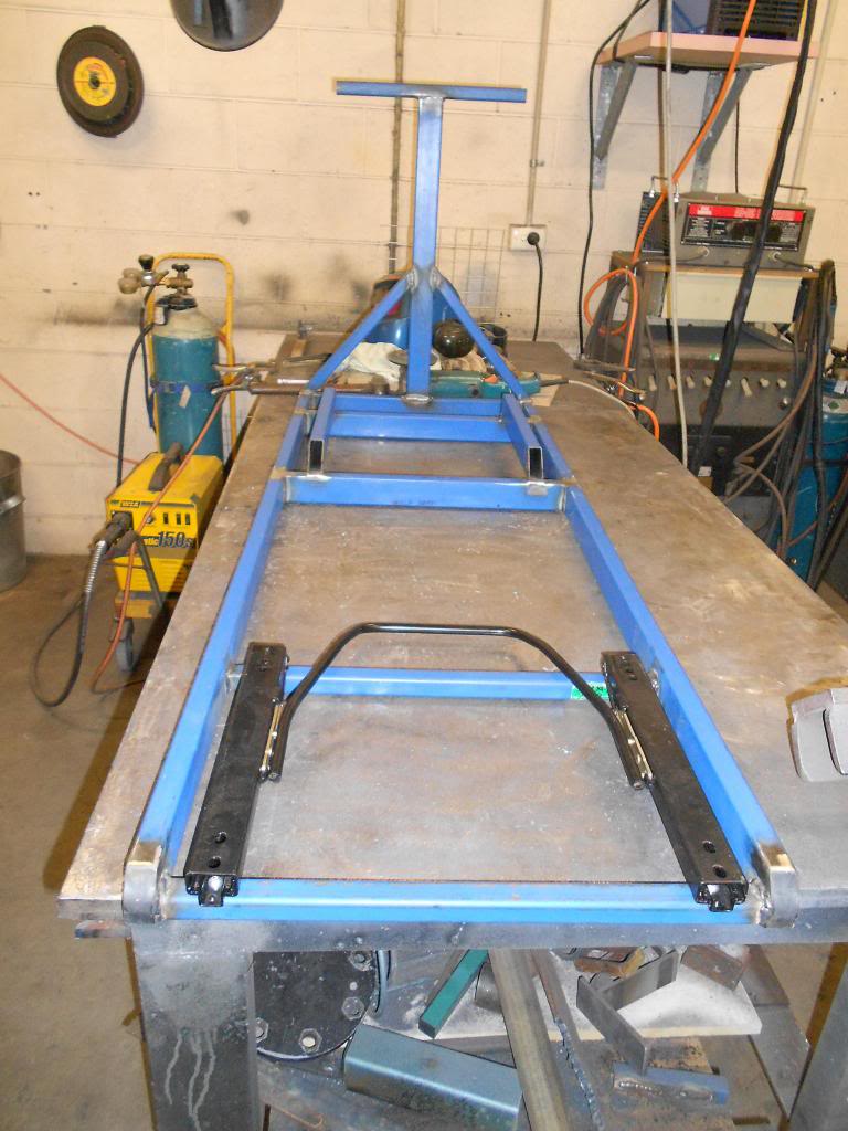

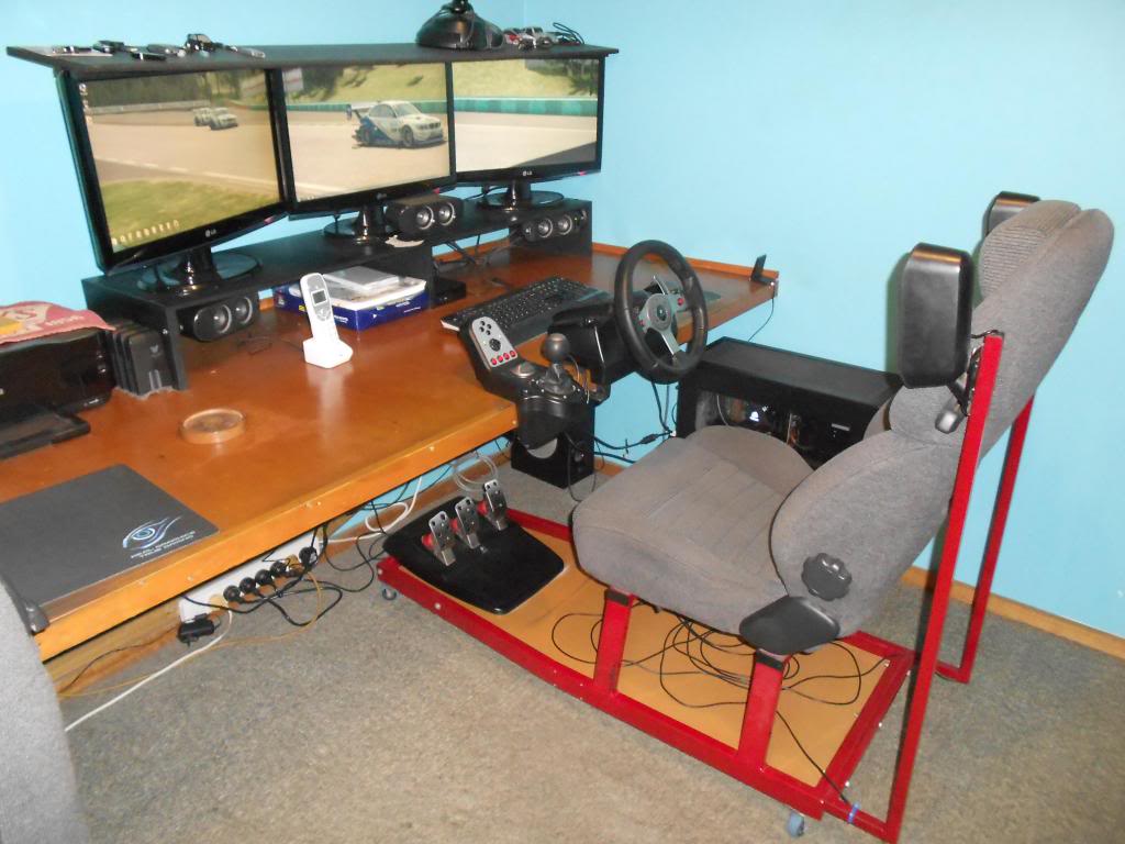

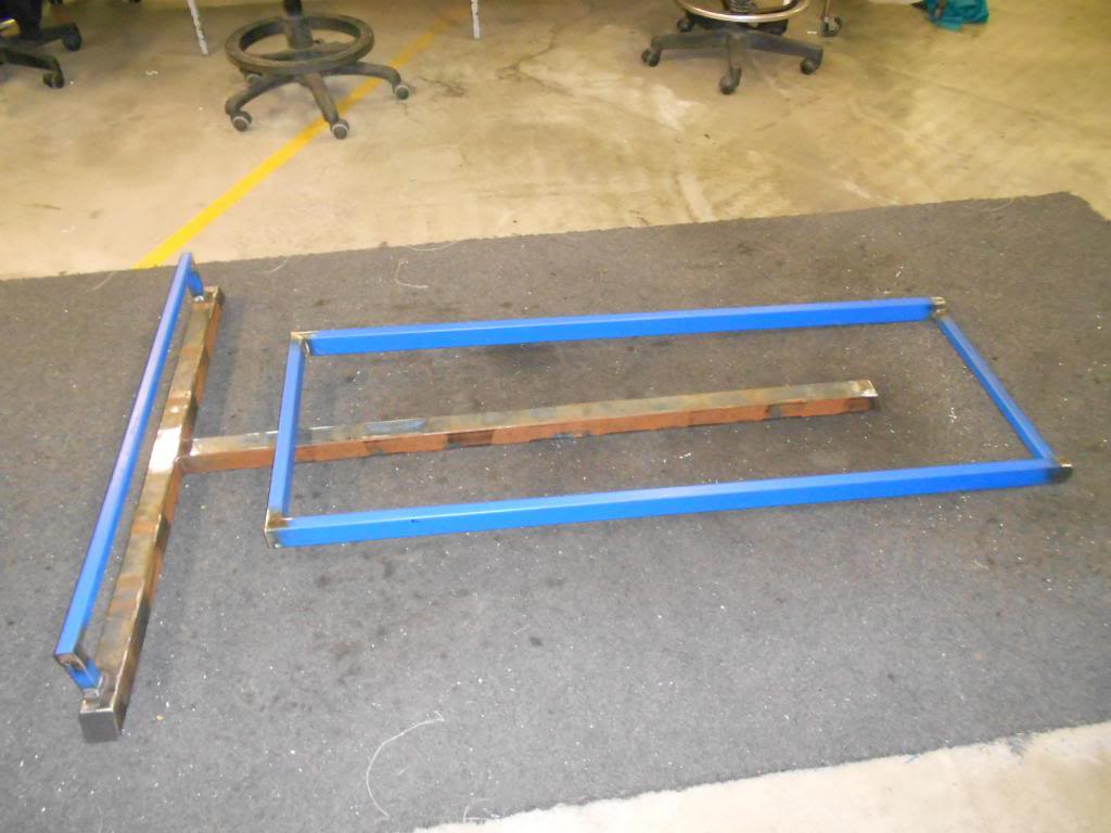

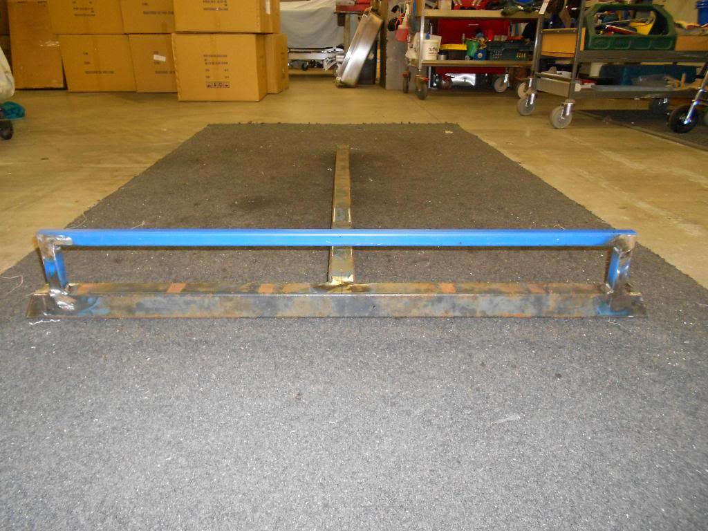

    Hi all Just started yesterday on the rig :) its just early shots atm and some pics of the system whats going on to it :)
    the old rig
    the system
    as I said I only started yesterday !!:D

    ANy progress is good news mate, Build away and enjoy.:thumbs
  3. bsft
    shoulder mount seat mover with big worm gears will move 130kg, i tested a mate on it earlier, no probs whatsoever

    Gday eaorobbie & bsft !! I am still trying to learn the lingo/terms of the bits here LOL but I am looking at this guys set up (Donald Landreville) but wit the added tree monitor set upon the rig as well so i will have to work out the balancing point
  5. bsft
    perhaps dont have screens moving with rig, they tend to fail
  6. eaorobbie
    20,468Coins
    +1,686 / 23 / -2
    Sorry I dont know this system, is there a link to his , thanks.
    Mounting 3 monitors and getting it all correct is fairly tricky, one little trick is to lessen the roll and sway in your Axis Assignments as the extra mass above the c.g of the rig can cause a major wallow action or could stress the body of the scn5 too much, after some use most have found damage to the bodys of the scn5. The kit is designed specifically for a seat mover application.

    Ok so he finished it, lol needs to learn to profile thou, its uses the same concept , as in a tbar on the back of the seat, so yes to your other question, it is setup like the seat mover I build and has the wheels and pedals connected to the sim only , I can not recommend connecting the monitors too, to me will stress the scn5s too much and could fail quickly. Sorry.

    Cheers for that !! So they way he has made it would be OK but not with the monitors on it even if I bring the seat back a bit to compensate for the weight the monitors are under 2kg each
  10. eaorobbie
    20,468Coins
    +1,686 / 23 / -2
    Balance is the key yes, as an object get further away from the c.p point its mass that applies to the fulcum is a lot greater than its overall mass.
    So try and be careful, make sure its on the balance point on both axis, meaning its balanced front to back as well as left to right, you might just have to suck and see.
    SCN6 would have been better choice as they will hold twice the weight, but in turn can be a little slower, but if you get it all spot on you should see between 150mm/200mm/s out of the actuator which will result in a fair movement, not as harsh as it could be as a seat mover but still fairly impressive.
    Balance is our key, gravity is our enemy. Take your time to get it right, be worth it in the long run.

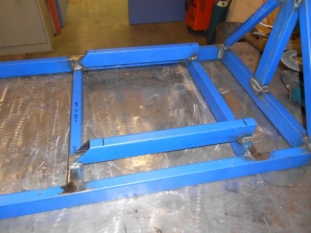

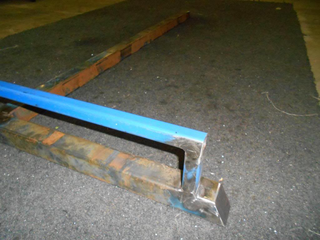

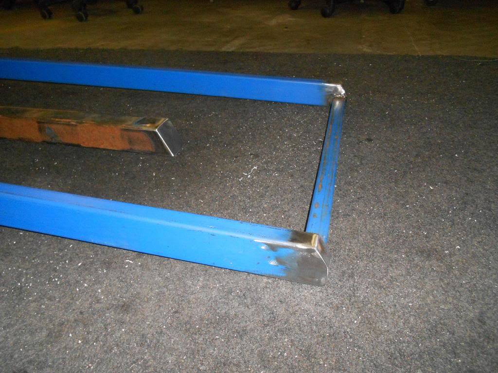

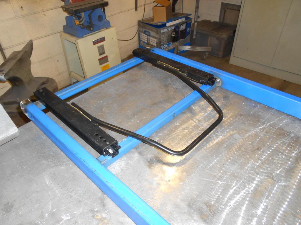

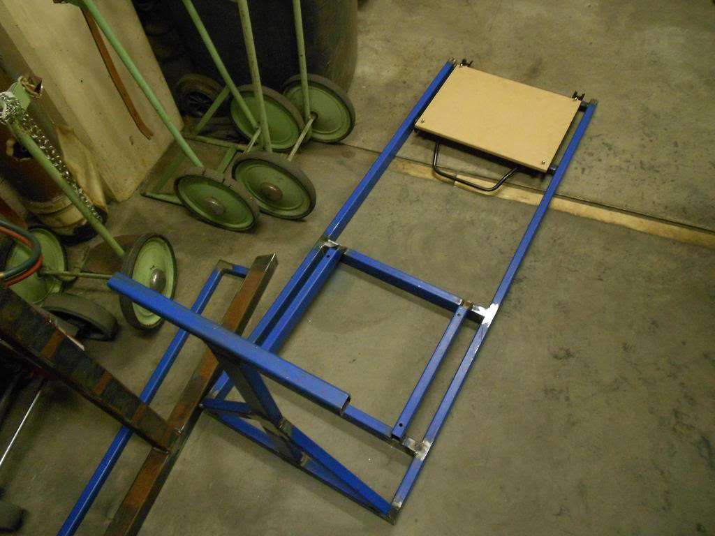

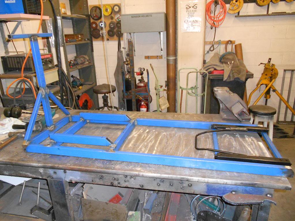

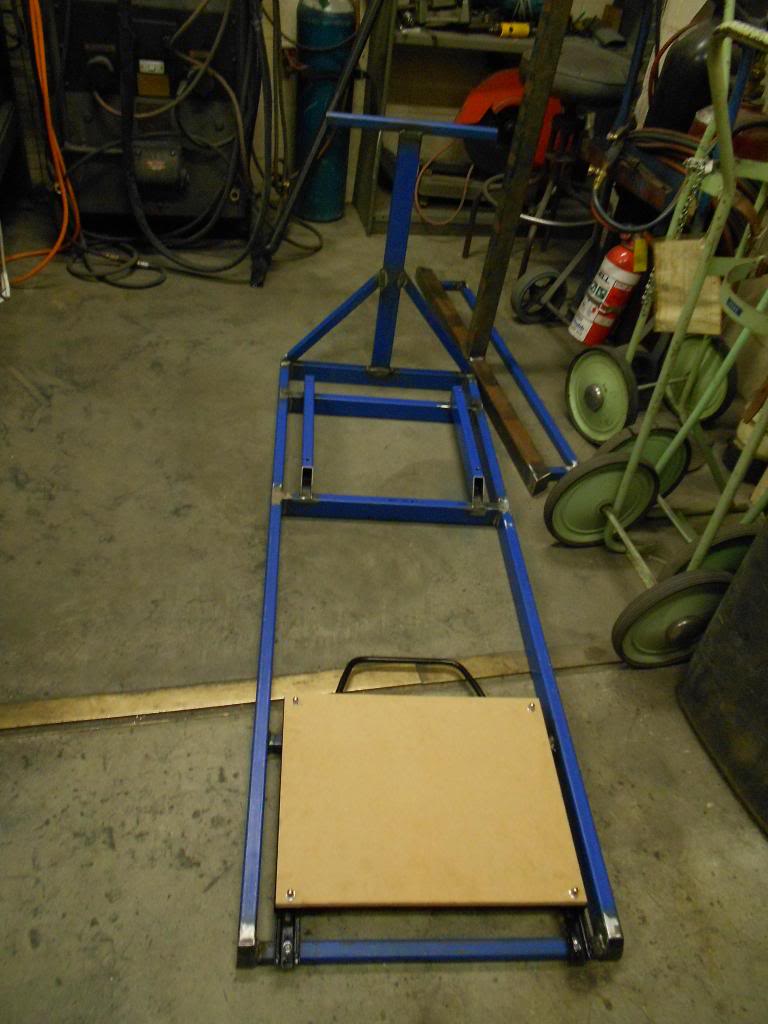

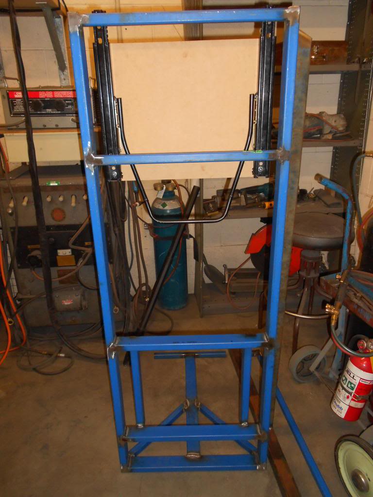

    Latest update :)
  12. eaorobbie
    20,468Coins
    +1,686 / 23 / -2
    Looking heavy, poor scn5's gunna have to work hard.
  13. bsft
    *warranty void*

    Gday eaorobbie and bsft !!no I am not going to fit the monitors to it (they are just the new monitors) and the seat is very light and it will all be balanced :)
  15. RaceRay
    Nov 8, 2006
    4,657
    Hamburg, Germany
    23,876Coins
    +2,042 / 13 / -0
    Your are doing fast progress!
    When its well balanced it will work fine..., even with SCN5.
    I did a similar design with 25 x 25 mm square metal, which have been very heavy at the total weight but with a small seat platform and short lever the scn moved it very quick.

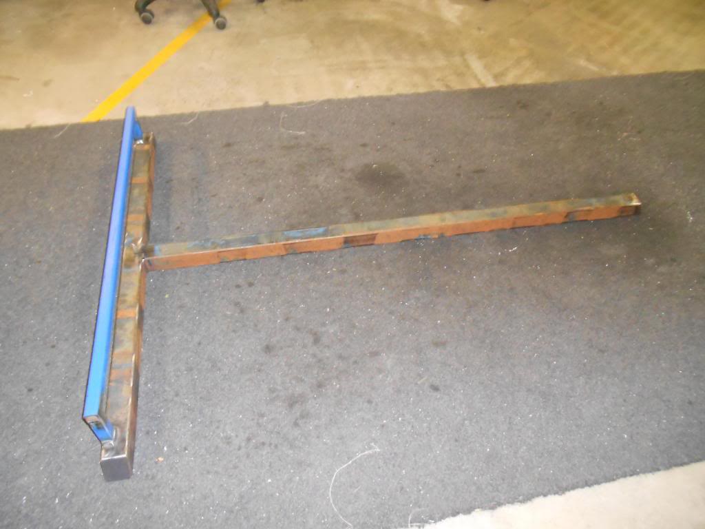

    Is it not a regular SCN 2 DOF design? I wonder why the T-Metal piece is soldered to the base platform and not to the moving upper one to a later timepoint.
  16. K1FF
    K1FF New Member
    Dec 16, 2013
    21
    723Coins
    +20 / 0 / -0
    SCN5
    Hi RaceRay!! if you go up a bit to the vid that is what I am going to make . that what you see on the bench is what moves as in the vid

    Ah ok, now i see.
    I prefer to have the pedals fixed on the base plate and not moving, (thats why i were confused to see the pedals mounted to the motion platform.)
    Gives me a better stimulation of muscle contractions in back, bottom and legs for more realistic immersions of gforces, but thats a personal question...i can only suggest: you should try out both systems.
