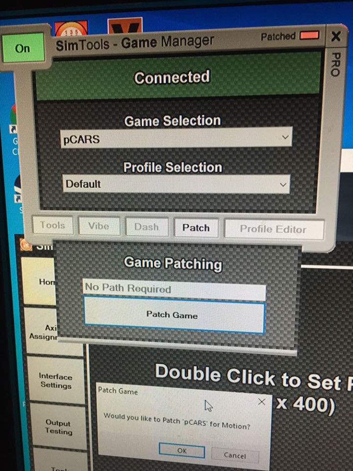

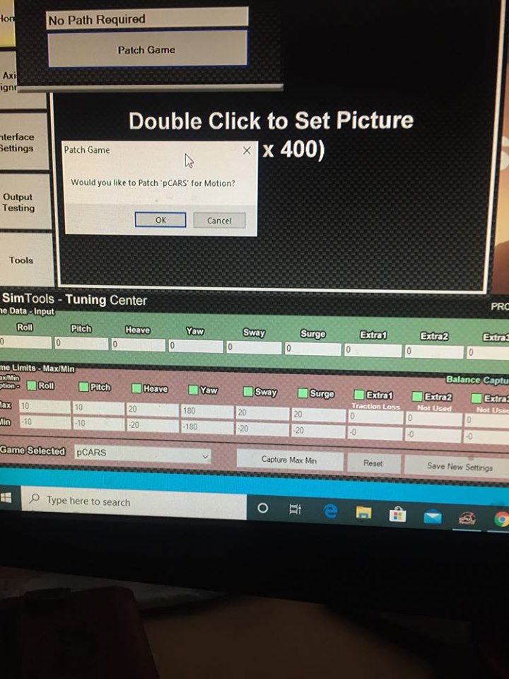

    Hi guys,
    I have Assetto corsa/iracing working with full motion and gamevibe. I cannot get PC2 to produce motion or gamevibe at all. I have the Project cars UDP PC plugin.
    I can get pc2 working with just motion with an old plugin but I so want to feel vibration whilst playing. I have contacted YoBuddy and he has suggested to turn on vibe after game has started but that has not worked. I have no coins to try another plugin (used them all on weeks pass).
    Any help would be great.
    Neil

    I think the Project cars UDP PC plugin is a manual game plugin meant for consoles? (Xbox - PlayStation version of the game)
    Anyway, when you select the plugin in game manger does a play button show up?
    If so press that then play the game and it should work buddy.
    Let me know how it goes,
    20,549
    145,112Coins
    +10,778 / 52 / -2

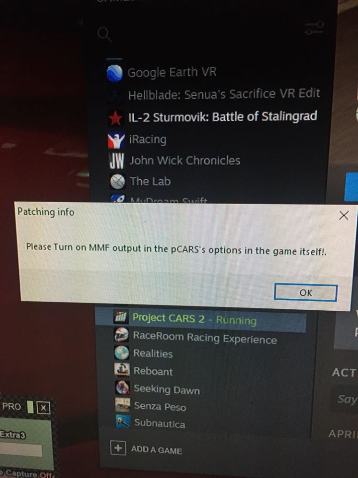

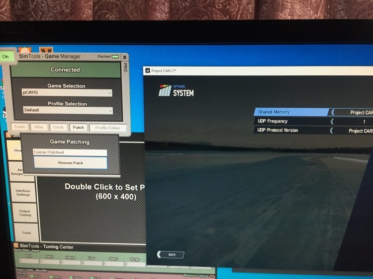

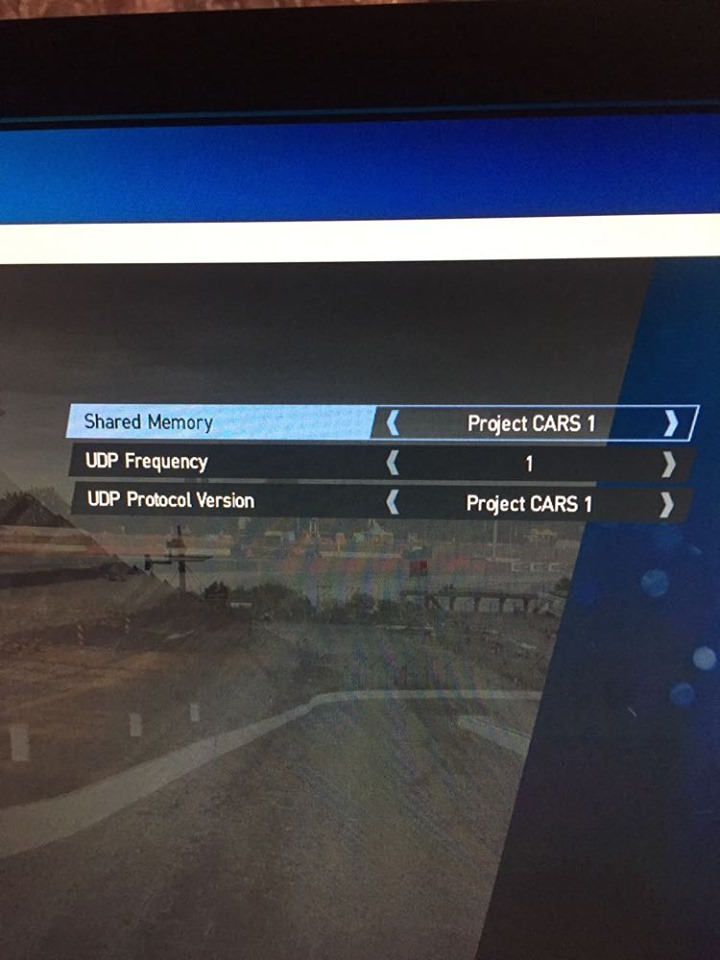

    Have you done the required settings in ProjectCars, see here for details: https://www.xsimulator.net/community/faq/projectcars.188/

    No play button I can see and yes I think it could be a console plugin :-(
    Motion is working great on old plugin but I need vibe like I have with iracing and Assetto.
    Let me know what you advise next.
