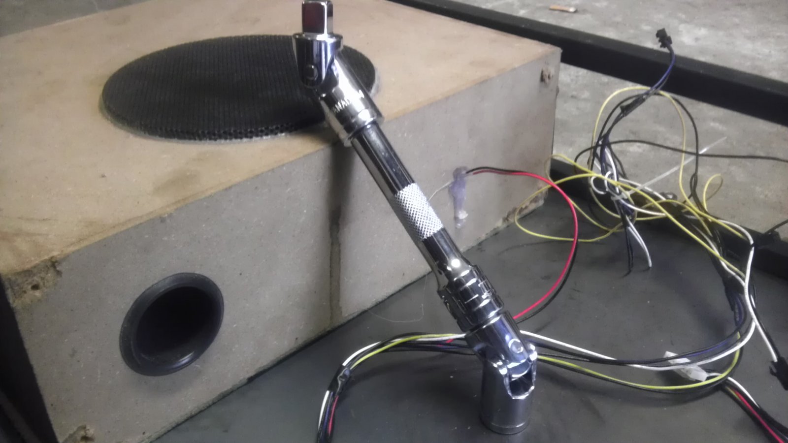

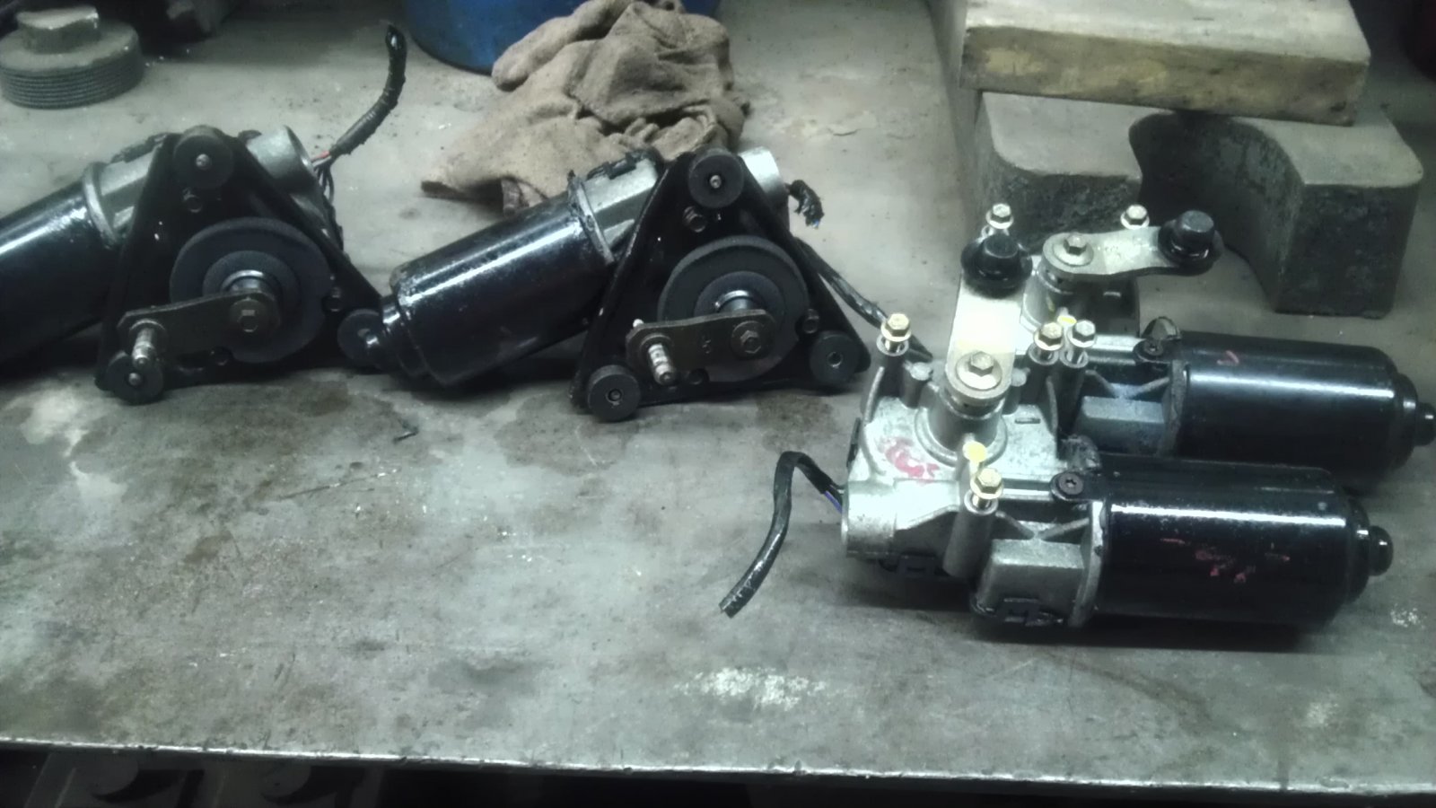

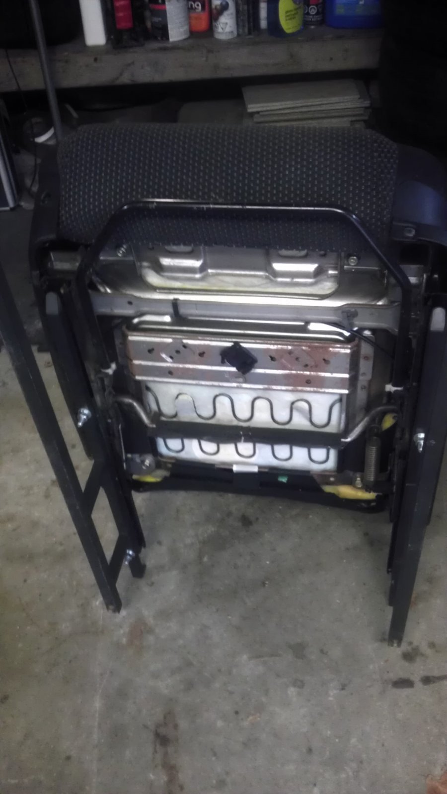

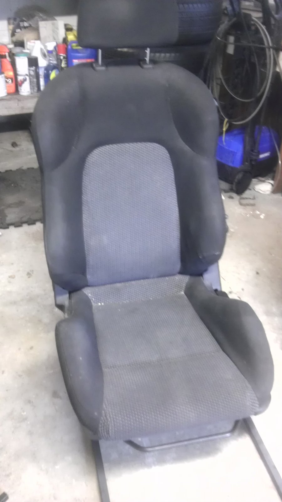

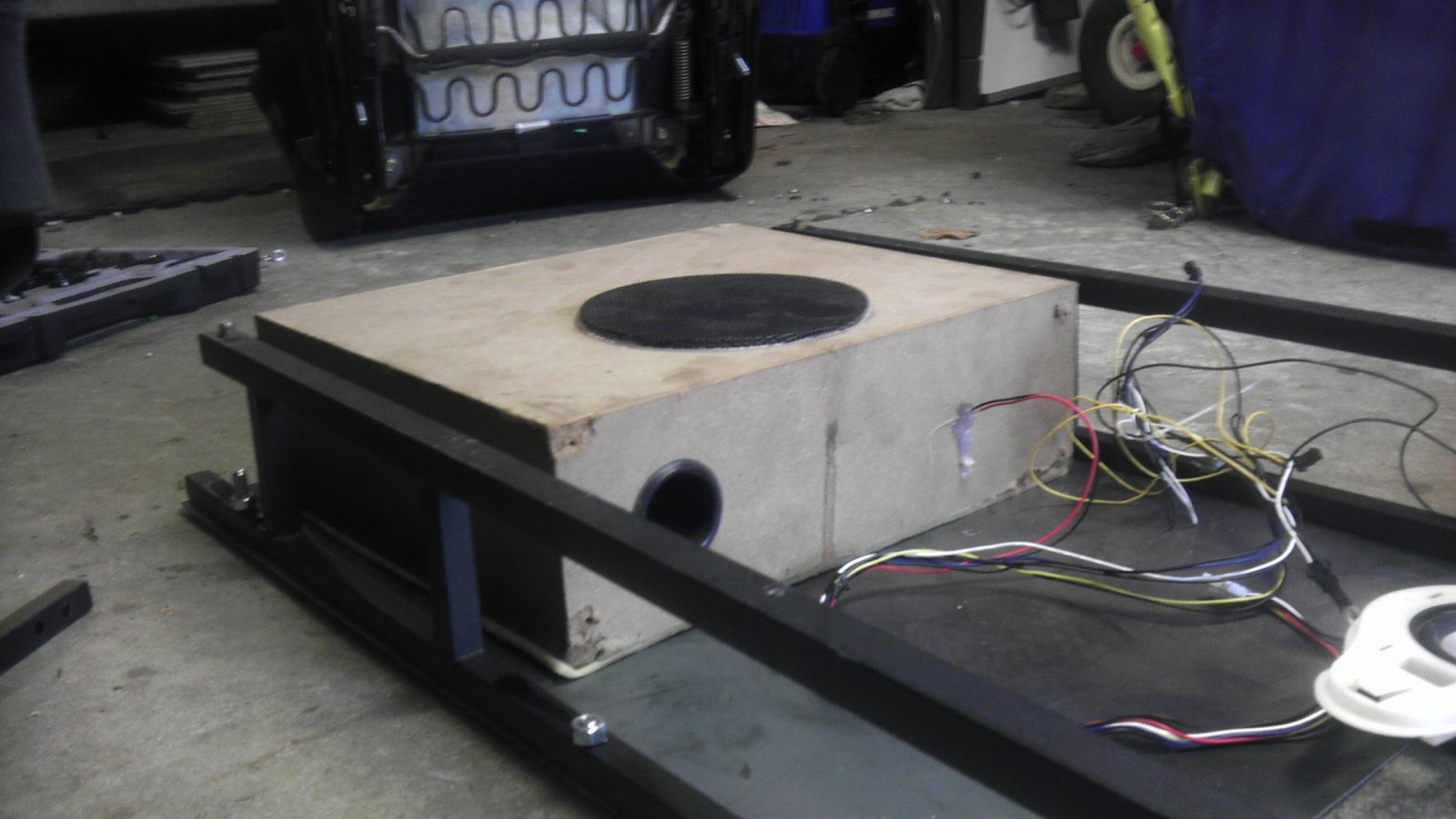

    The motors are from. Ford explorers. The seat is from a hyundai tiburon. The framing is from a old 10x10 cloth Gazebo. Which saved me a lot of welding time. I have a local metal shop cut me a 17x24 inch plate. The sub and audio control is for vibration effects. And the shaft is. 2 socket 1/2" drive u joints connected with a 5" extension. For easy disconnect. All parts are local and can be replaced fast.

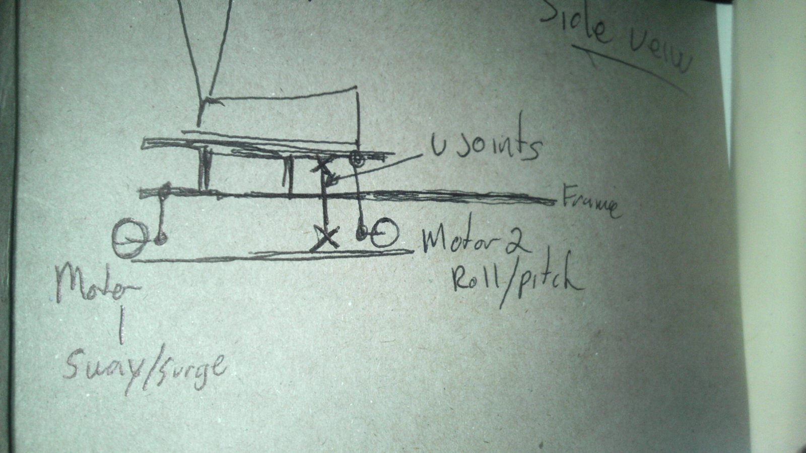

  9. bsft
    can you do something with pencil and paper and scan it?

    Here's a quick sketch on what I mean by dual ujoint for motors. Motors 2 will be located very close to the ujoint shaft and connected to the upper frame rail in hopes to give the ujoint on top more support until needed. It will be slightly ahead of it though. Motors 1 will be at the back and on the lower rail. Hopefully most of their effects will be directed at the lower joint.
  11. bsft
    yep, got ya there now. Thanks for the drawing.
    Problem I can see is when surge motor goes down, unless you program some movement into the sway motor, its going to pull against it. Causing motor problems.
    Maybe put sway motors on the top frame and keep surge motors on bottom, then they work independently of each other and do not conflict each other.
