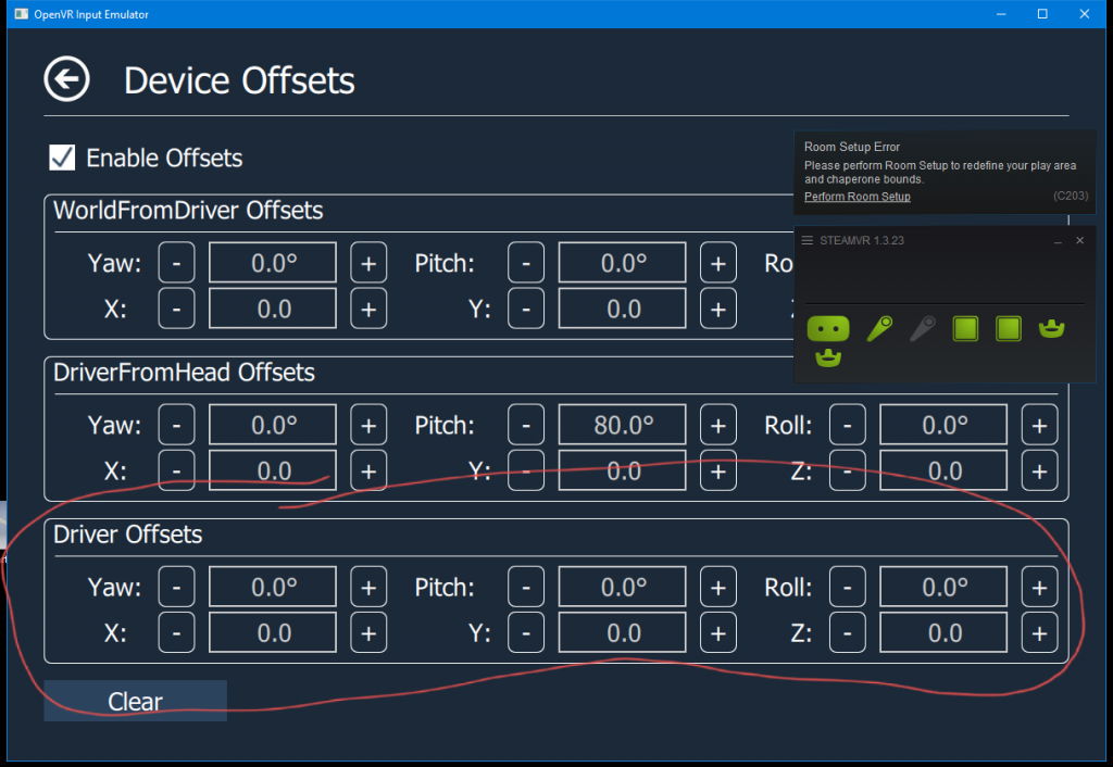

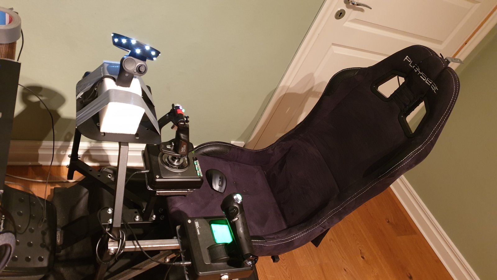

    UPDATE 2020-01-22 (Ok setup, not great)
    Tested using DCS + SteamVR Beta + Windows mixed reality beta.
    1. Mount the WMR controller as picture below. (I use foaming for damping)
    2. Start SteamVR and startup the game.
    3. Setup OVRIE: Select the WMR controller installed in front of your seat as "Motion Compensation"-device.
    Issue1: When looking away from controller picture could jump.
    Short look forward resets the view
    Issue2: WMR controller falls to sleep.
    Wiggle the controller and it wakes up again
    (Keep the controller alive is a solution but I haven't found a way that works yet)
    BELOW USING VIVE TRACKER (Fails randomly)
    Ok, my progress so far.
    To get the correct motion compensation I have tried to move the WMR HMD (Reverb) to match the Vive Lighthouses.
    This makes the rotation center position of the Vive Tracker rotate correctly when selected as the motion compensation unit.
    1. I do not match WMR Space in OPVSC (OpenVR Space Calibrator) with the Vive tracker or controllers.
    2. Select the Vive tracker in the OPVIE (OpenVR Input Element) as the motion compensator.
    3. Select the WMR HMD and adjust the position using "DRIVER OFFSET" to match the Vive Lighthouses + Tracker. (Tricky but after som positioning I use the Vive Controlls to adjust the menu as WMR Controllers move further away)
    4. Go back and "Save" the profile.
    Problems:
    I tested this with DCS but when starting DCS from within WMR menu it greys out.
    Could be something with the WMR HMD position that corrupts SteamVR.
    At least the motion compensation is getting more realistic.
    I will continue tweaking and update this thread as more findings are made.

  10. Onslope
    Onslope New Member
    Dec 23, 2019
    25
    211Coins
    Yes, I use Open VR Input Emulator and select 1 WMR controller. This is then attached in front on my motion platform.
    It works better if you have a it stuck in some firm foam as it will be less shakey See picture above
