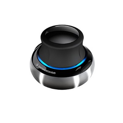

    Great thing :) Another idea of a 6DOF controller :
