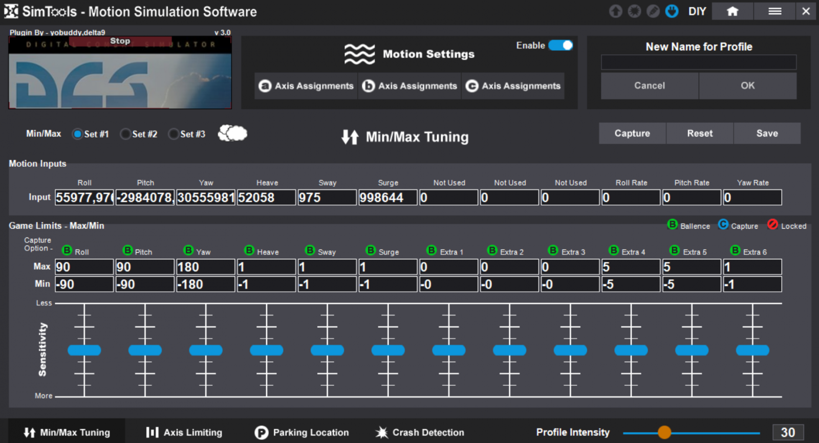

    Hello, I have a problem with the DCS telemetry, SIMTOOLS V3 receives values very different from zero when the plane is on the runway. I have reinstalled the plugging but it remains the same. It does not show zero when the plane is on the ground and I cannot use it or on land or in the air. In the Flight Simulator it works fine, it shows zero or close to zero in the ground telemetry and I can fly it without problems.

    Solved by changing the country to USA in Windows
