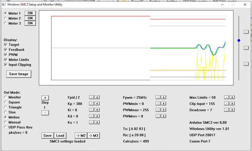

    Hello there, finally i start to setup my 6DOF Simulator the first time
    i was able to wire up everything correct. i have a 6dof with 3 Arduino uno and 3 Sabertooth Modules.
    so i have COM5 + 6+ 7

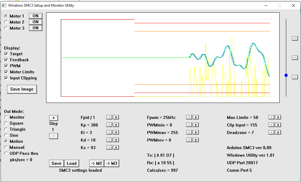

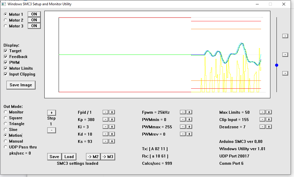

    in SMC3 tool every Arduino works as it should
    COM5: Motor 1 and 2
    com 6 Motor 1 and 2
    com 7 with motor 1 and 2
    i have to setup all values to the same later but fot testing it works !
    so all motors moving with the test values or in manual mode as they should !

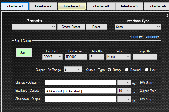

    BUT in Simtools Engine i have Problems with COM7. these 2 motors doesnt work as they should they randomly go up and down ... i dont know what it is: config for test:

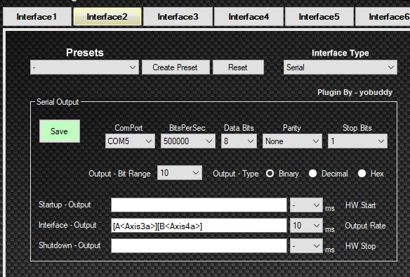

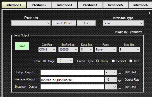

    Interface settings for the 3 Ardunios:
    all the same with different Axis :
    Interface 1: [A<Axis1a>][B<Axis2a>] works fine
    Interface 2: [A<Axis3a>][B<Axis4a>] works fine
    Interface 3: [A<Axis5a>][B<Axis6a>] does not work !

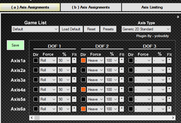

    test with roll and Heave:
    Axis 5 and 6 does nothing else then randomly go up and down.i cant see a logic to the movements ...
    Does anybody have an idea whats going on there ????

    Set Output Bit Range to 10 on the com port 7 Interface settings.

    Argh... Iam so stupid. Didnt noticed this difference. Ill try it tomorrow I hope it works
