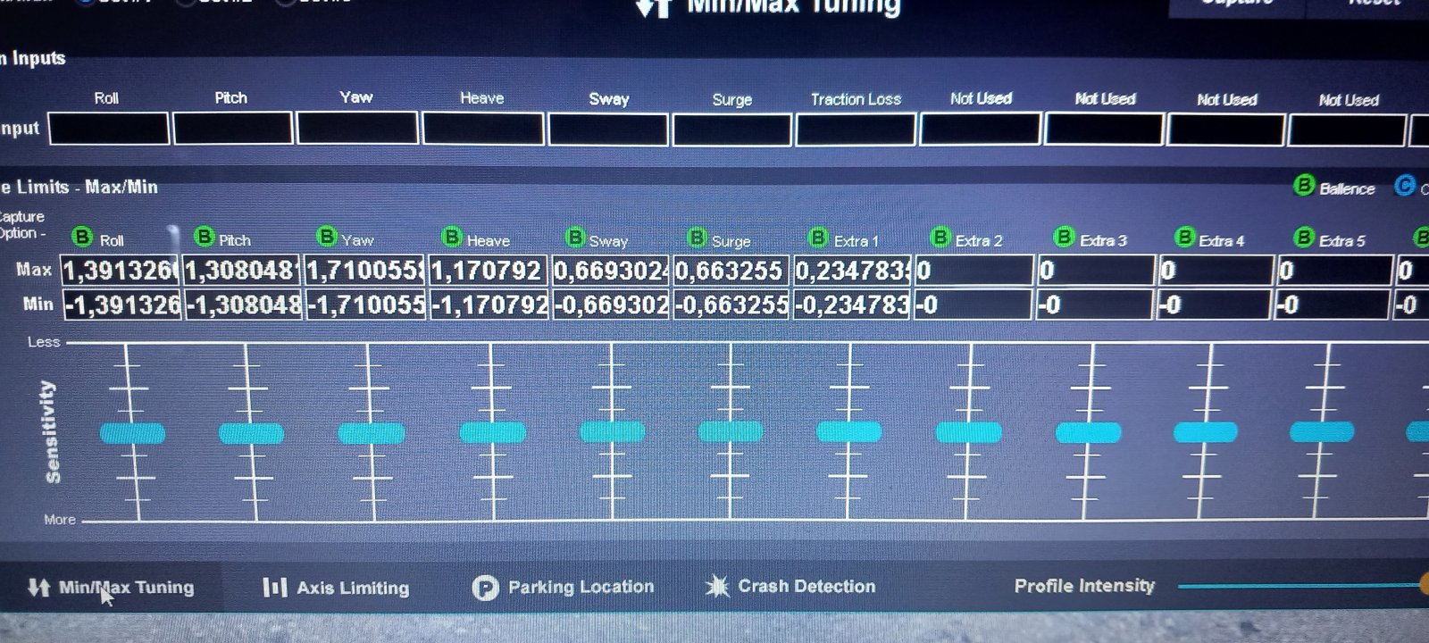

    Hello, I have the njmotion movement platform and I use it on PS5 with Gran Turismo 7, and I have a problem that when you least expect it the Sim Tools application closes, I have uninstalled the application and reinstalled it, I have changed the hard drive from the computer and it's still the same, does anyone know what to do?

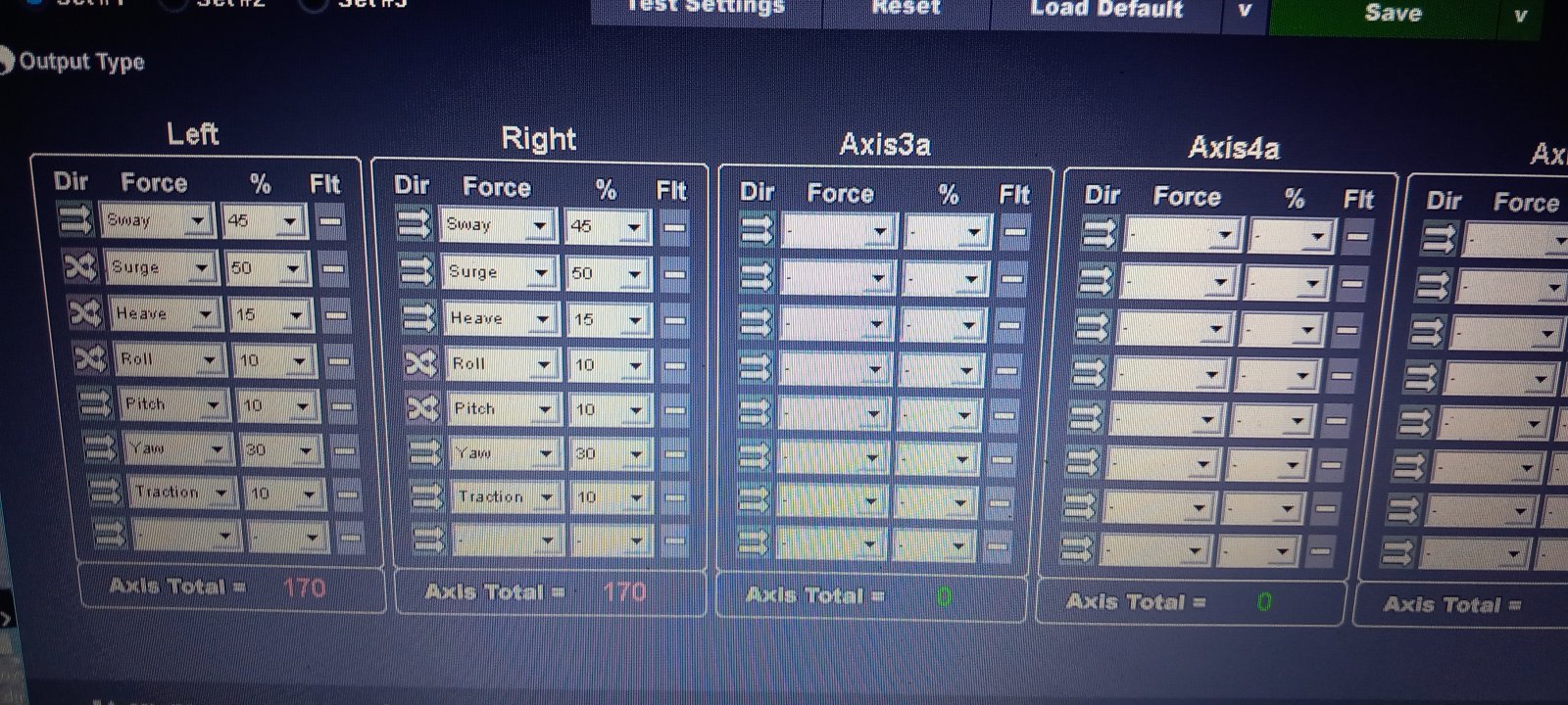

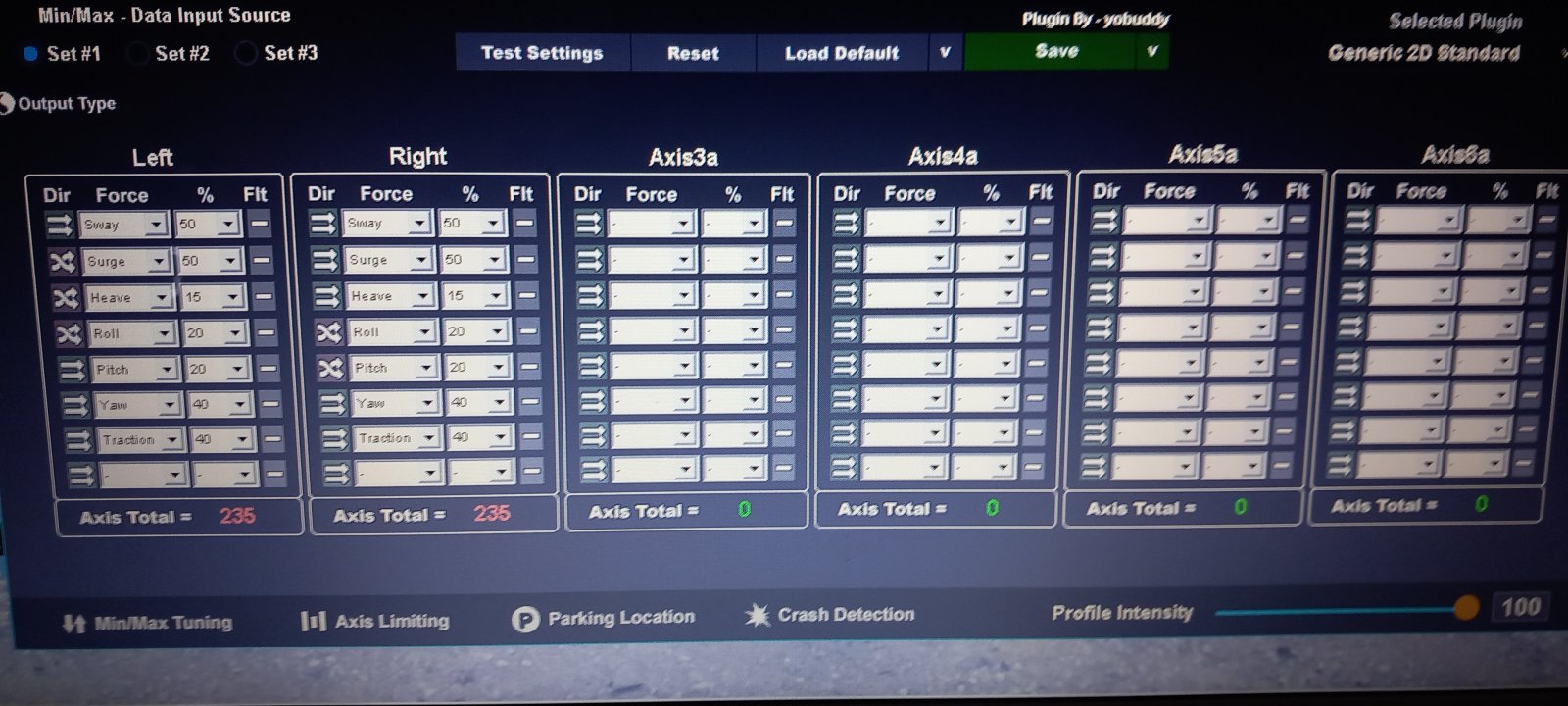

    It looks like your Axis Assignment totals are way too high.
    Do you have a properly configured motion profile for Live For Speed and if so does the issue occurs with it as well?
    Are there any error messages or sound notifications?

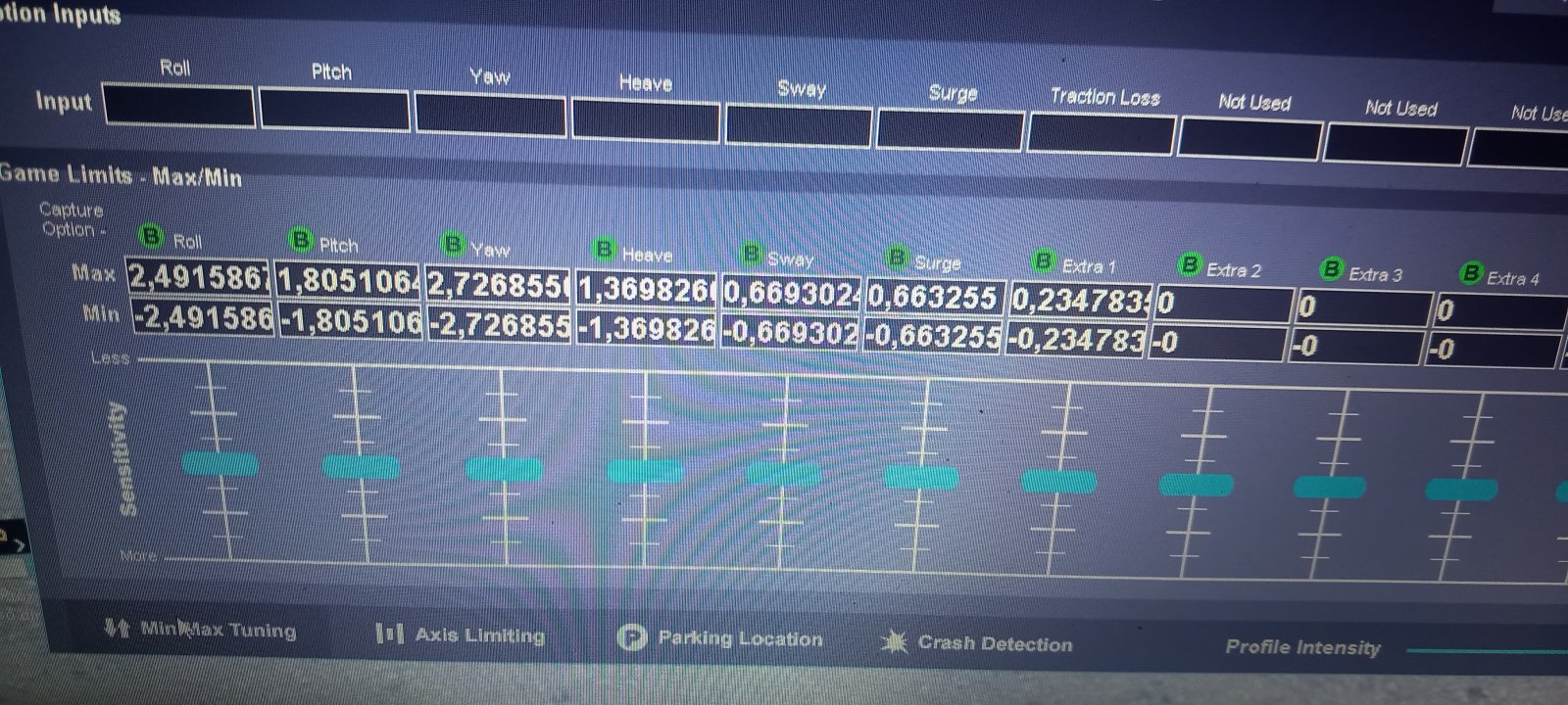

    These are my settings, I only use them on Gran Turismo 7, and even if I set them lower or higher, almost every time I press the stop button, the Sim Tools application closes. I have videos so you can see what happens, but it won't let me send it because it doesn't let me send it. He says they are very big, I have one that only lasts 7 seconds
