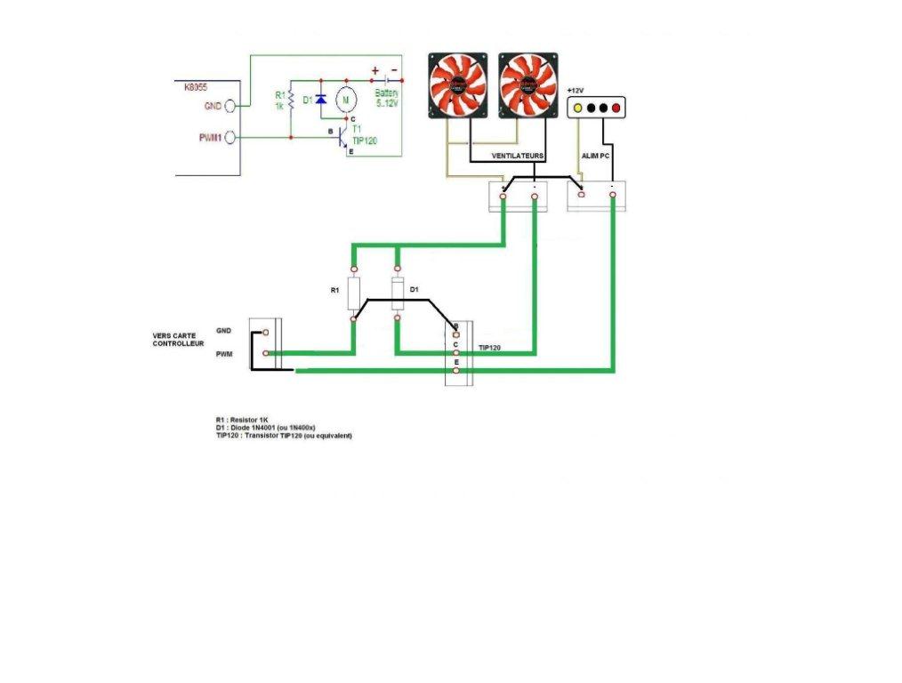

    hello,
    j'utilise des ventilateurs brancher sur une vm110 avec une interface
    le probleme c'est que le voltage demarre directement à 7v
    je ne sais pas comment faire avec x-sim pour que ça demarre à 0v
    avec le logiciel de la K8055 ça demarre bien à 0v
    ps: l'effet est inversé car j'utilise un tip120 au lieu d'un tip125
    merci de votre aide.
    I use the fan connected to a VM110 with an interface
    the problem is that the voltage starts directly at 7v
    I do not know what to do with x-sim so that it starts at 0v
    with the software for the K8055 it starts well 0v
    ps: the effect is reversed because I use a TIP120 instead of tip125
    thank you for your help.

    What happens when you adjust the Calibration offset of this axis?

    c'est pareil, ça demarre toujours à 7v. j'ai aussi testé gtr2 et c'est pareil
    is the same, it always starts at 7v. I also tested GTR2 and so is

    hi,
    make on number 1 in your profil velue 57 (engine round) with min 1 and max 100 than you must
    set the right invert, you must test both sides.with 100 % and with the right invert you start by 0 volt.x.sim are can go + and - but you want only +. the blue slider in the sender math setup
    must start on 0 now you see 50 percent from the blue slider.

    it does not work. it always starts at 7v soon as it accelerates. i don't understend

    you have on your velue 56 overwride result velue,but you must make add result velue.on all effects.

    I tested but it is the same.
    what is the problem, I do not know

    thank you thank you and thank you nima for your help :cheers: :cheers: :yes: :thx: :thx:
    i try an another hbridge
