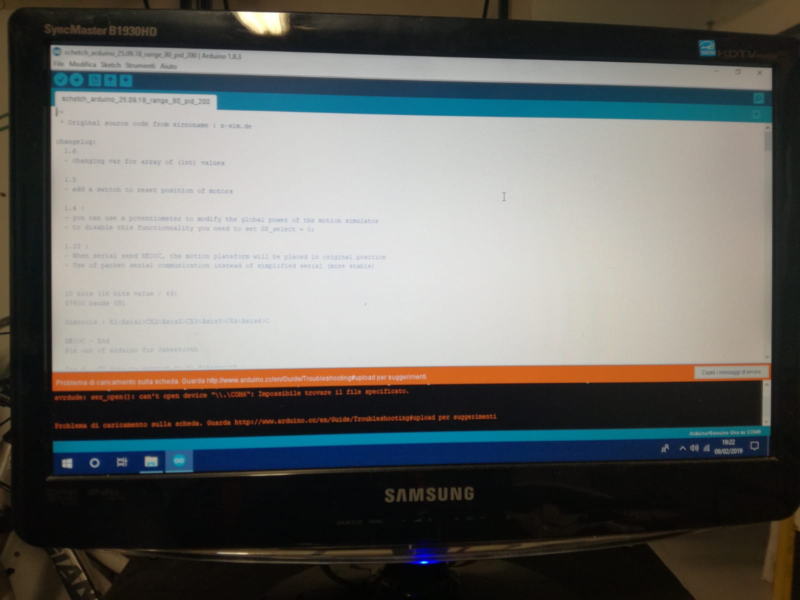

    Good evening to everyone.
    I have this strange problem.
    In my simulator I use two 2x32 sabertooth cards interfaced with 2 Arduino Uno clone cards.
    Also I use Simhub for shakelt with 4 small vibration motors. For this I use a Dk Motor Shield card interfaced with another Arduino Uno clone board.
    The 3 arduino boards are connected each to a usb port of my pc and everything works perfectly. Simtools and the 4 engines managed by the 2 sabertooth + 2arduino clone works, simhub managed by dk + Arduino Uno clone works. It happens however that if the Arduino board clone that manages simhub is disconnected when I start simtools the program gives me a "beep" and one of the two Arduino boards does not work, consequently the two motors do not work either. I tried to:
    - uninstall and reinstall simtools
    - uninstall the CH340 dirver necessary for operation of the Arduino Uno clone cards
    I also noticed that when this event occurs if I try to open the program and Arduino to install the schetck on the card loading is blocked because it is impossible to open the card .... place a picture for greater clarity.
    I think it was a driver problem, but I can not really understand why even if the arduino board that runs simhub is connected then everything works?
    If I close Simtool, the reconnect the Arduino Uno clone boars of simhub all come back to work perfectly.
    how is it possible that by disconnecting the arduino board a clone that deals with simhub also blocks an Arduino Uno card clone (connected to the sabertooth) that deals with the movement. What relationship exists between the 3 cards? Last thing, to make the problem even more extravagant .... The Arduino Uno that stop work is not always the same. Sometimes one, sometimes the other ,sometimes both. But always happen only if i disconnect the Arduino board that manages simhub.
    I thank in advance who will give an explanation to this strange phenomenon for me, helping me to solve.

    By the symptoms it sounds like you're usb isn't able to supply enough power at some point to keep everything working. I'd try adding a powered usb hub if not already using one.
    20,551
    145,124Coins
    +10,778 / 52 / -2
    Have you tried swapping out usb cables and ports, and do you use clip on ferrite magnets to help manage interference?

    Hallo Norbeast,
    ...The night brought advice and I understood the problem. I set up auto-start for simhub. Therefore when simhub starts if it does not find the dedicated arduino board it will disturb the other two arduino boards that deal with the engines and work with sim tools. It was enough to disable the automatic start. If the simhub arduino board is not connected to the pc then simhub should not be started otherwise this problem happens
