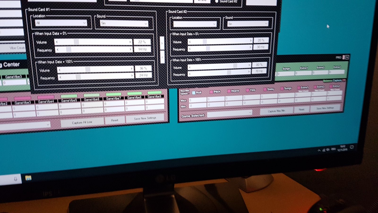

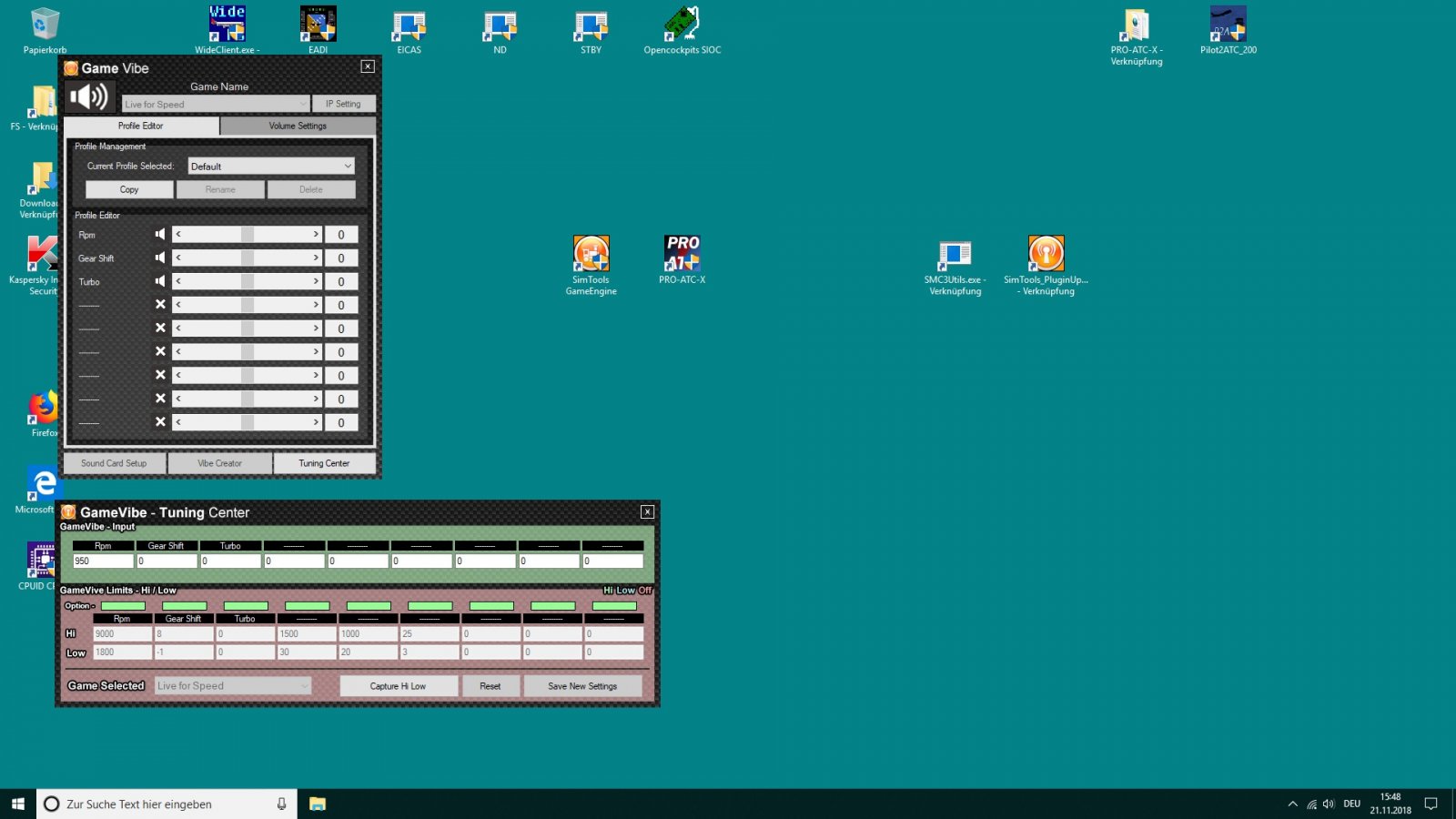

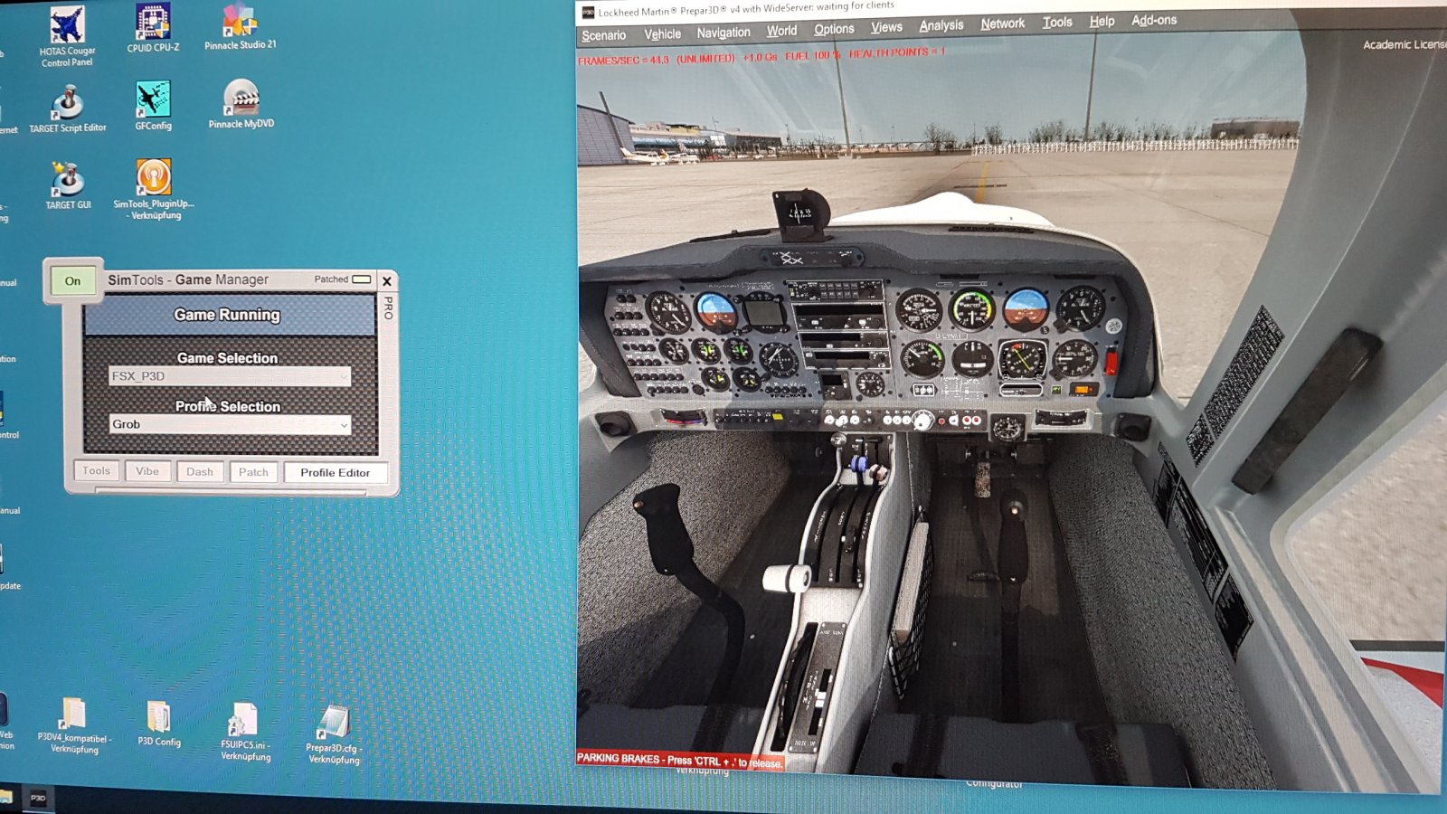

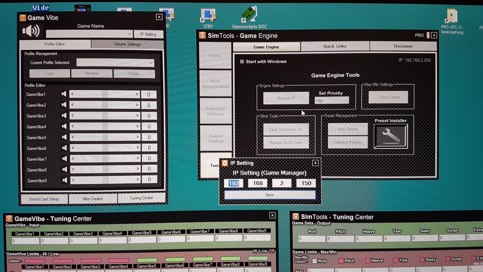

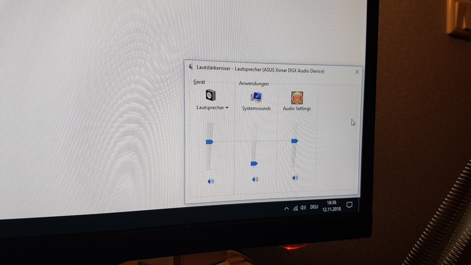

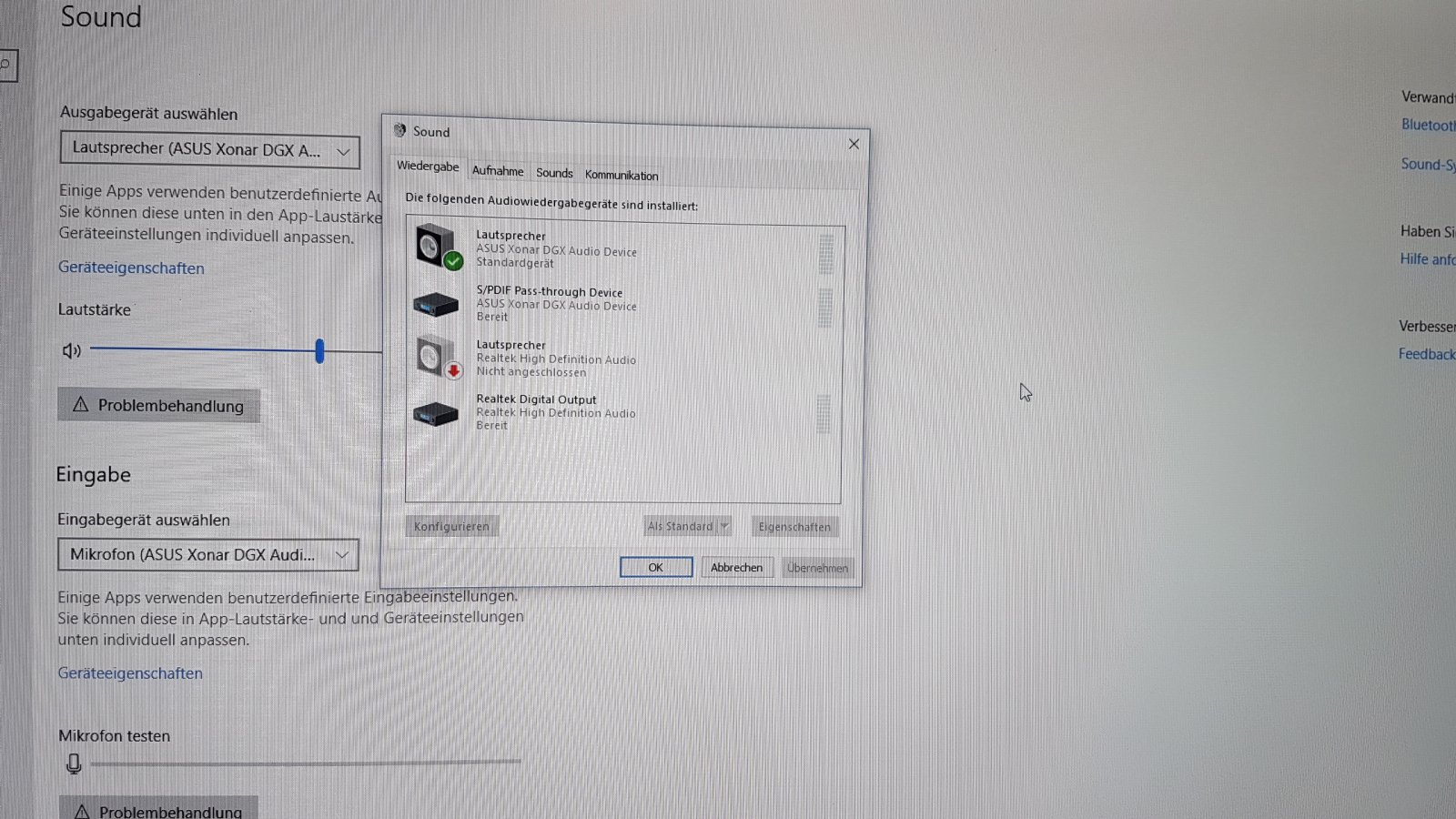

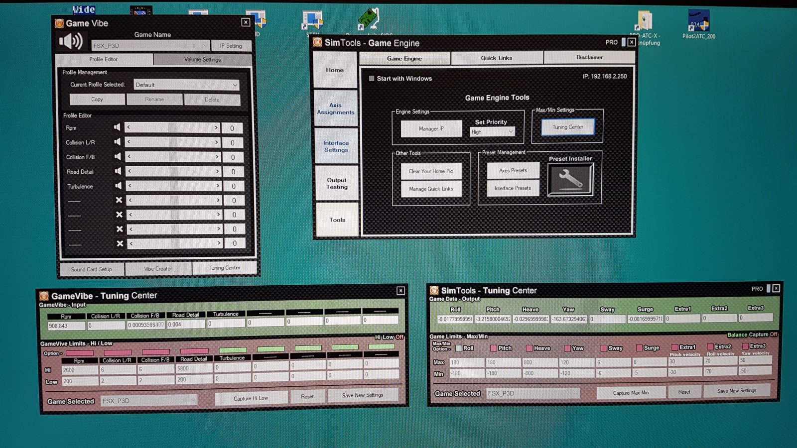

    As described in another post, I have no sound output during a game (example P3DV4.2) with GameVibe despite receiving data on my 2nd PC. Installation and setup went smoothly.
    GameVibe and Game Engine runs on 2nd PC.

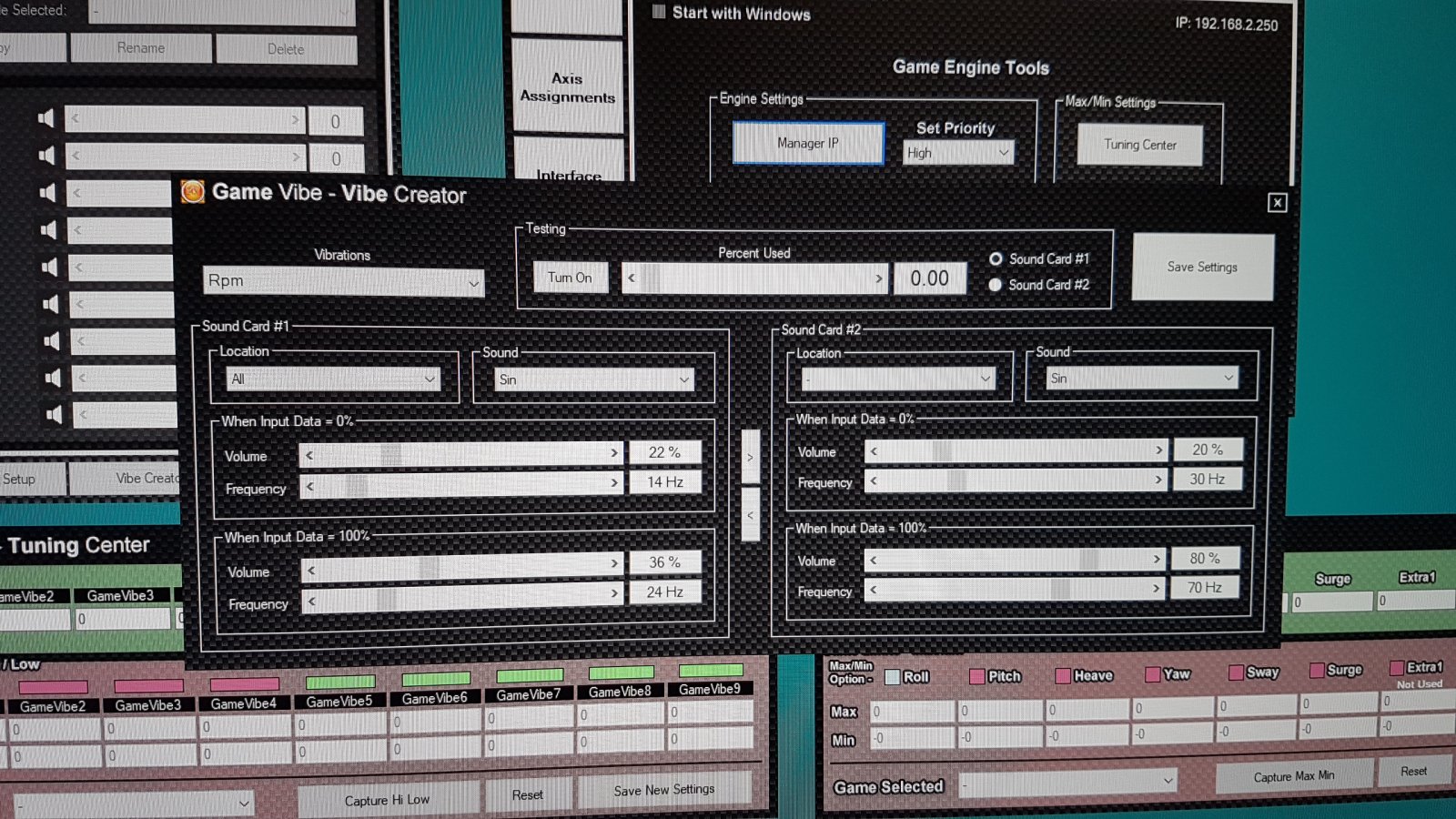

    When creating vibes, I have sound output on my LFE shakers.
    In the tuning center data is received and I have MIn and Max values
    created.
    I use Simtools 2.3, also the latest versions Game Manager and GameVibe.
    The experiment with LFS also had no positive result.
    All tips from the forum to this problem I have followed.
    Here are some pictures of my settings:

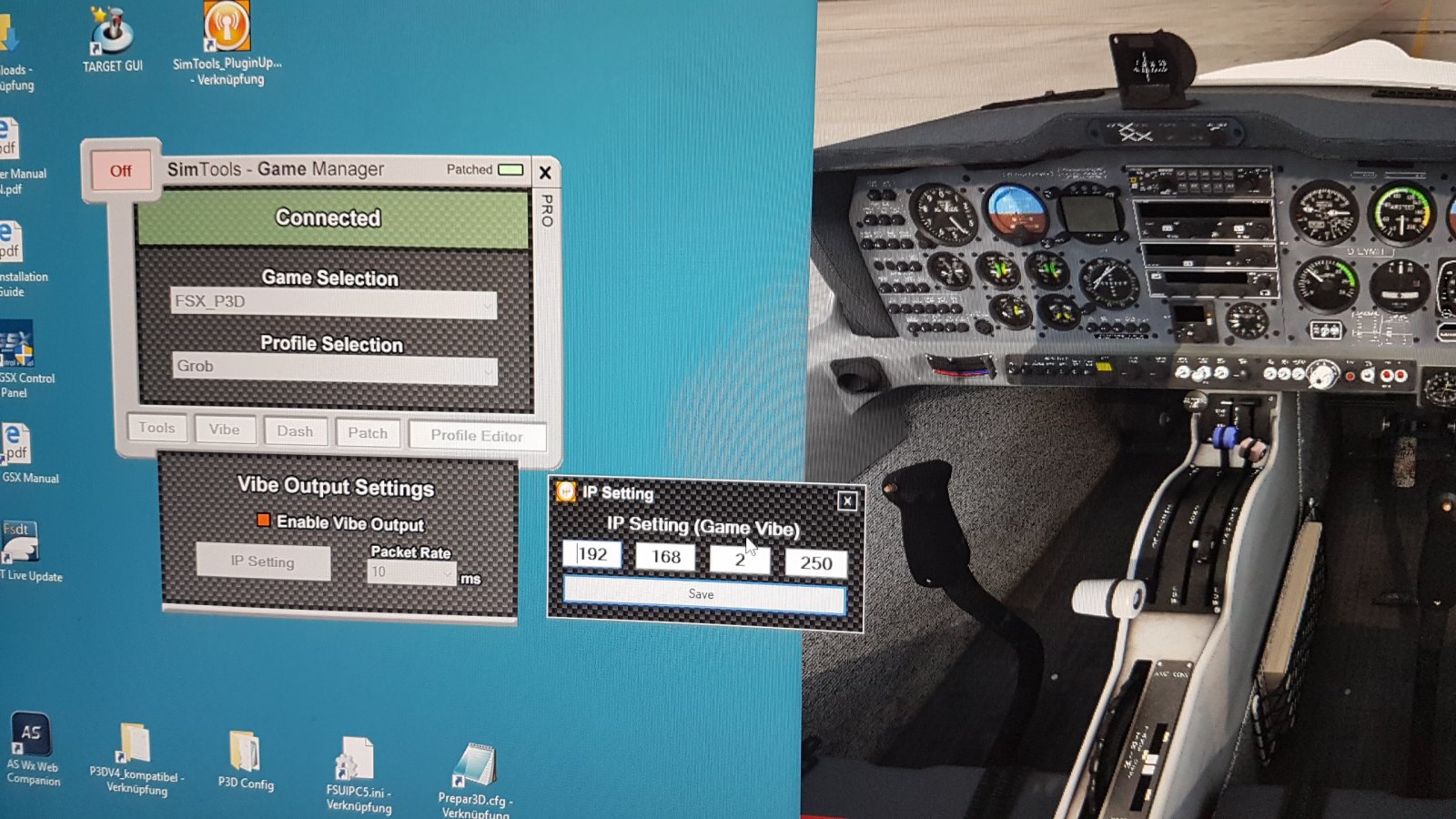

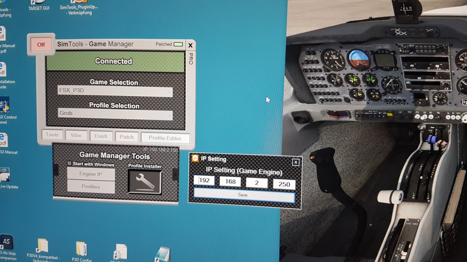

    Setup looks correct for a 2 pc setup.
    Could I see you settings for Live for Speed?
